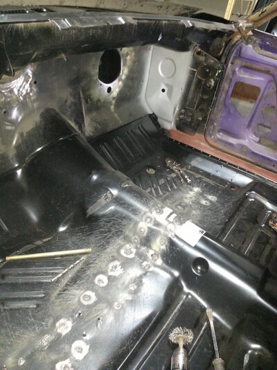

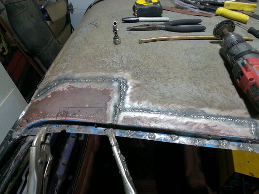

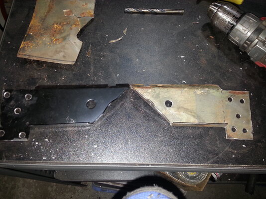

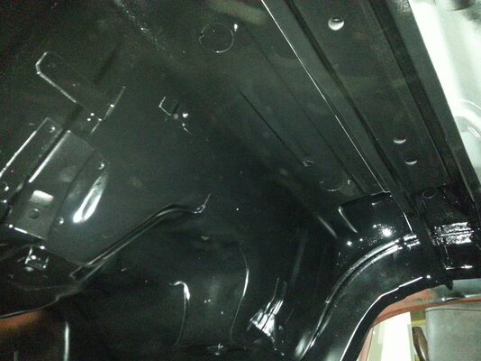

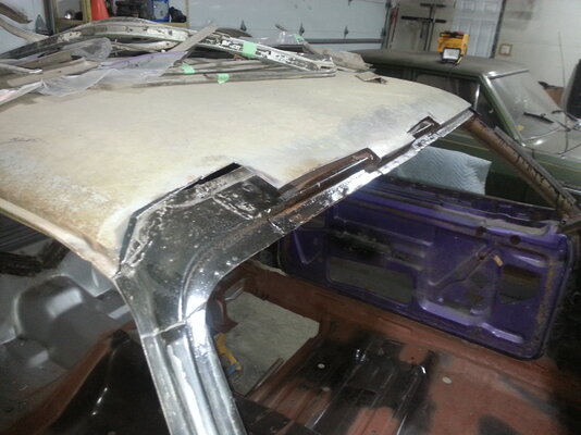

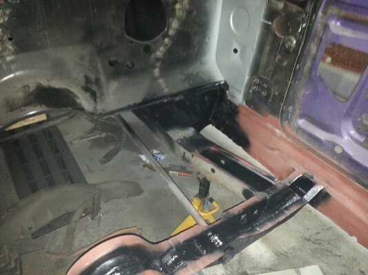

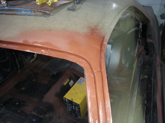

Update:

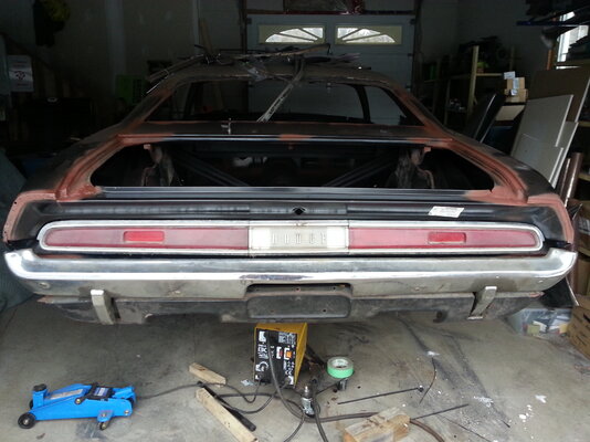

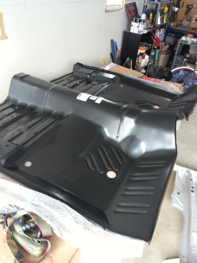

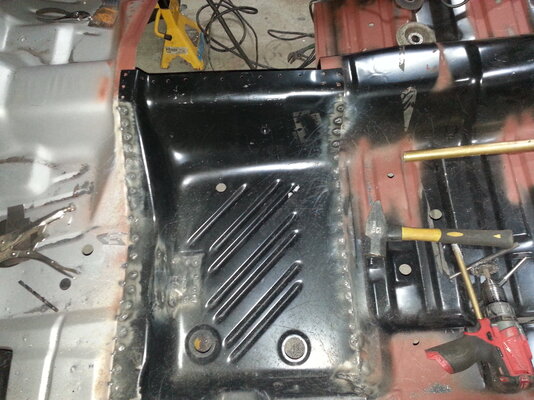

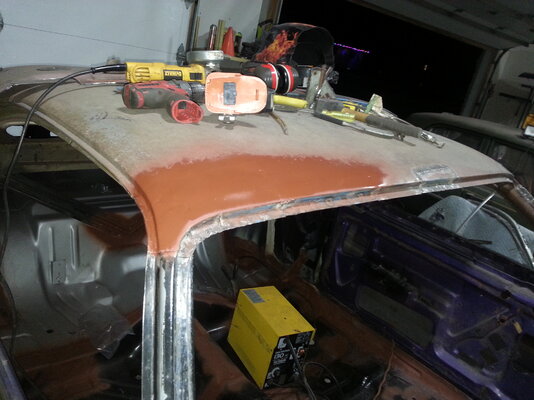

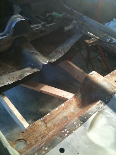

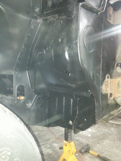

I have ground down all the welds on the rear panel and have been working on the frame and floor pans. also cut out the back window rot. more pics. I had to make some panels because the backlog seems to never end:
All i can say is this AMD floor panel seemed to be not to spec with floor dimensions. So i had to cut a small section and extend it. no big deal- but just added work. The small part i had to fabricate was the second pic on the right. thank god i had extra steel and patience. table vise and a metal working hammer formed it.
Today in Canada its -28 degC so I will be grinding all the welds down today. keep myself warm! haha more pics to come.

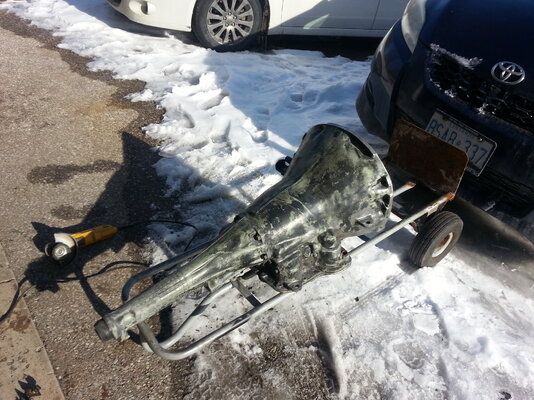

ALSO! built a used motor and transmission! Picked up the transmission with a good friend of mine and picking up the engine in the spring!

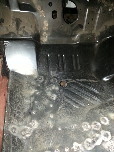

Update:
Grindfest for 3 hrs today. primed the spots and now I can move on and work on the rear footwells!

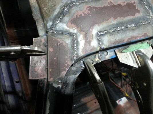

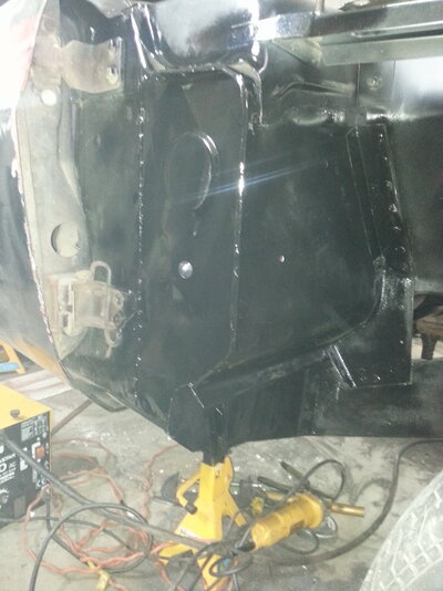

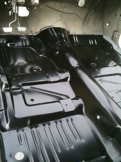

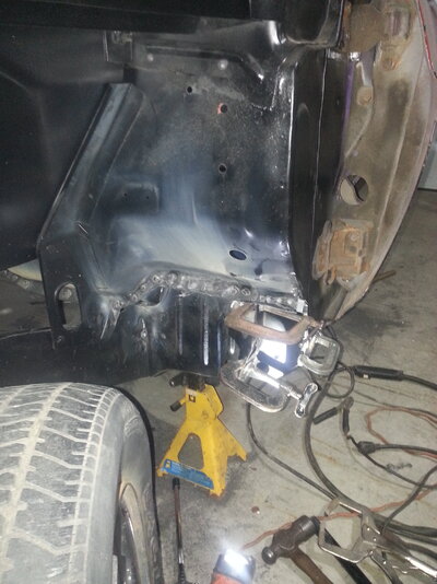

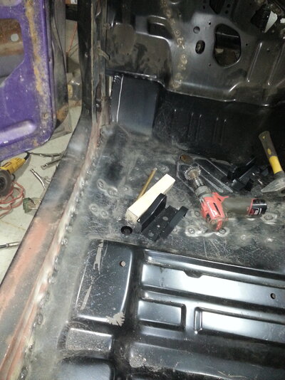

update: another late night but got one rear footwell tacked in and finished the front end welding! 1 more off the list of things to do. some pics below. I had to make some rocker cover plates and a few other parts. :) tomorrow is grinding down welds and than work on the trunk. (leftside rear footwell is on back order.....)

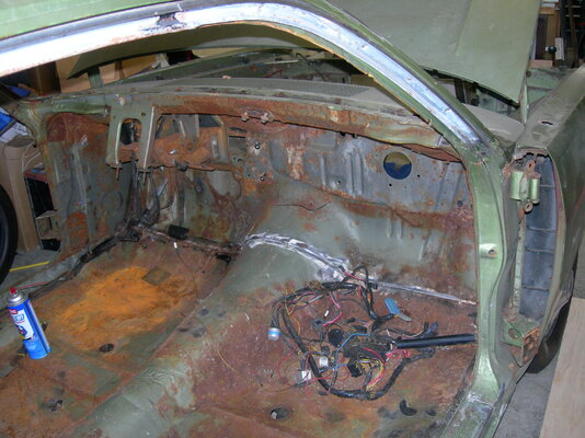

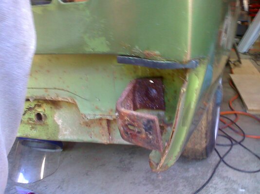

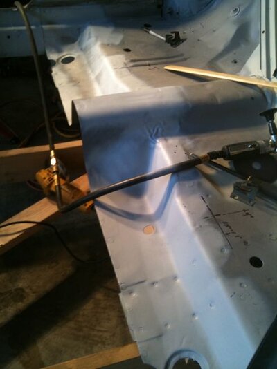

Good progress enforcer. My 72 Demon was same factory color (!) and had to come back from similar condition

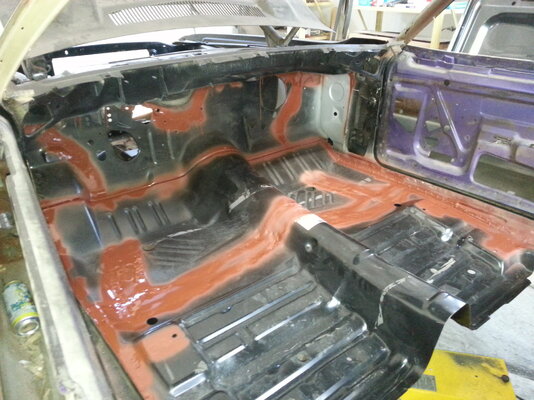

Just can update! So much body work and grinding my head has spun! Car is 99% rust free. Fixed the front windshield channels etc etc. I have pics and will upload when the body is done. I painted the underside of the car and want to mount rear suspension next week! Im excited and my wife is too... because she gets her parking spot back haha stay tuned for pics.
thats awesome! my car was an old drag car so trying to fix all the twists and warped parts has been tough. I can see the light and almost done the body!!!!

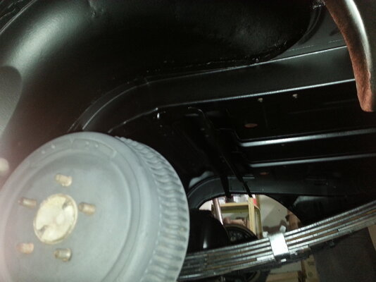

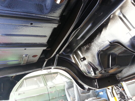

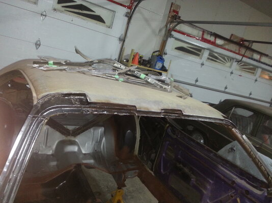

Hey guys more updates!!! Look below- back end is all cleaned up and mounting rear suspension.
among other things!

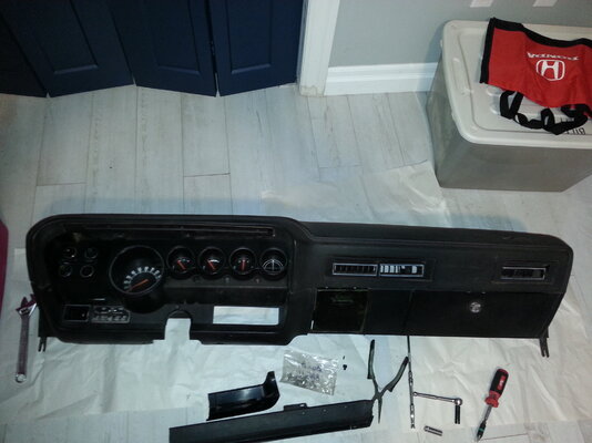

so rear diff rebuilt, transmission has been wirewheeled and priming it soon when weather can be above degc.
Dash is together, and floor shifter brackets all welded in.
Need to fix a spot on the rocker and the car is ready for body work and paint. been a long 6 months of work. but im there! this car was so bad with rust I was doubting I could fix it. Feeling like a big milestone!
