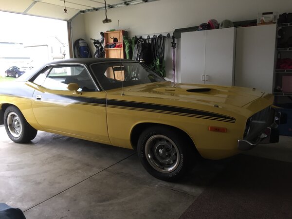

I have just finished my 392 install into my Cuda and am here to advise of my events leading up to and into it. It's not easy but planning and execution would have been much easier if I had a mind to lean on from time to time. Well now I can help you
General Description

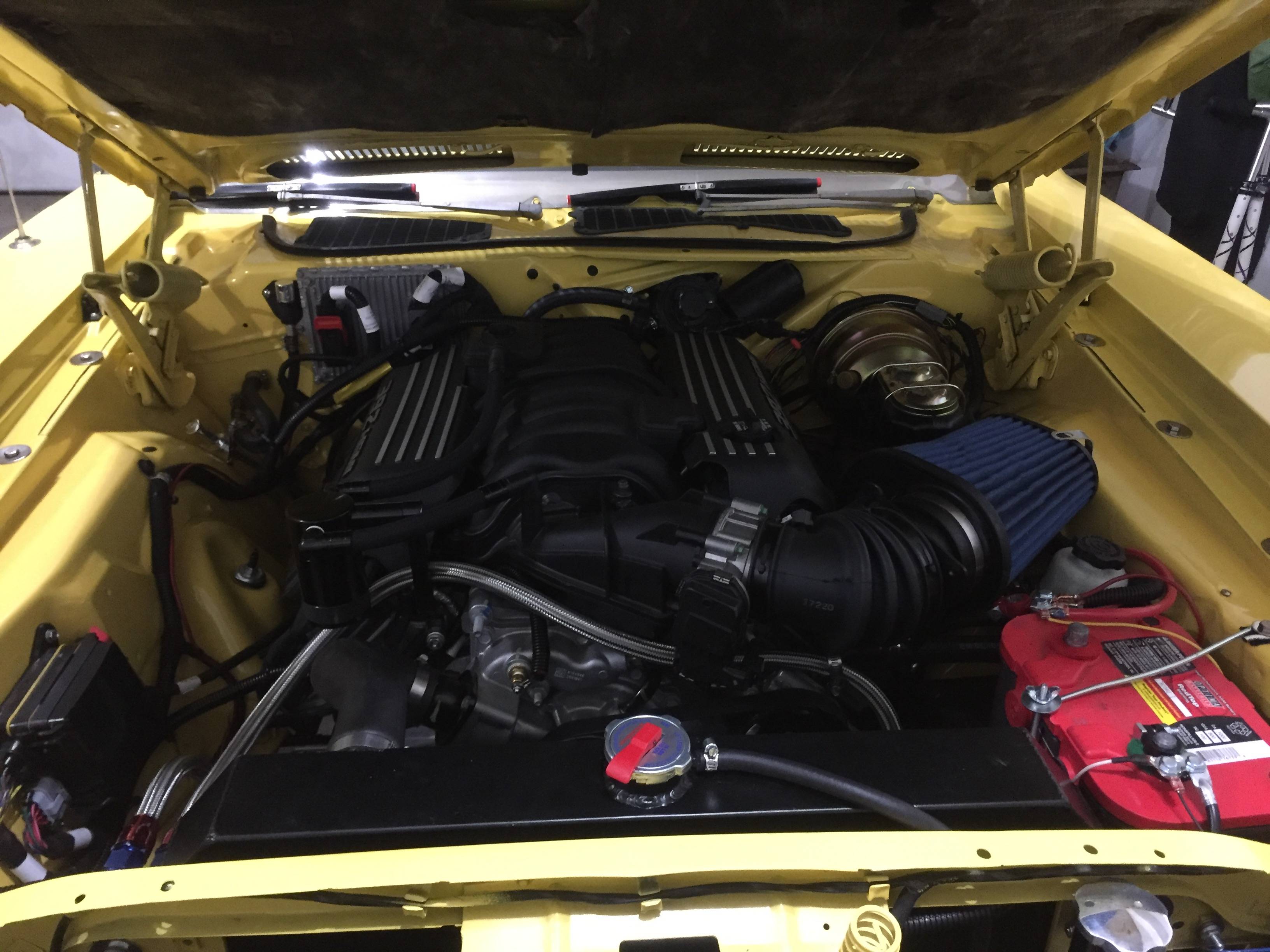

1973 'Cuda Gen 3, 392 upgrade. Everything is new. Whew. Started March 3rd and traveled half the time until today when she went on her maiden voyage. Break in time. Be warned though these new hemi's like to throw oil out the back. The dealer said it should "calm" down once everything is seated. Gesh. Plus the fact that we won't have catalytic converters helping burn the oil mist it's more noticeable than a new car.

Lots of stories. The oil smoker was actually a bad #2 cylinder. Chrysler does not cover labor for the rebuild but only parts. So I told em to send me a new motor. And they did. Now the second one does not use a drop of oil in 1000 miles so far. Bam.
I'm not sure I understand what "box" I used. The crate motor I ordered through a Chrysler dealership. Easy warranty coverage and shipments. I used a buddies discount and saved 2k.
