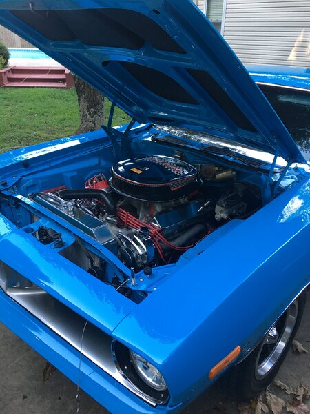

General Description

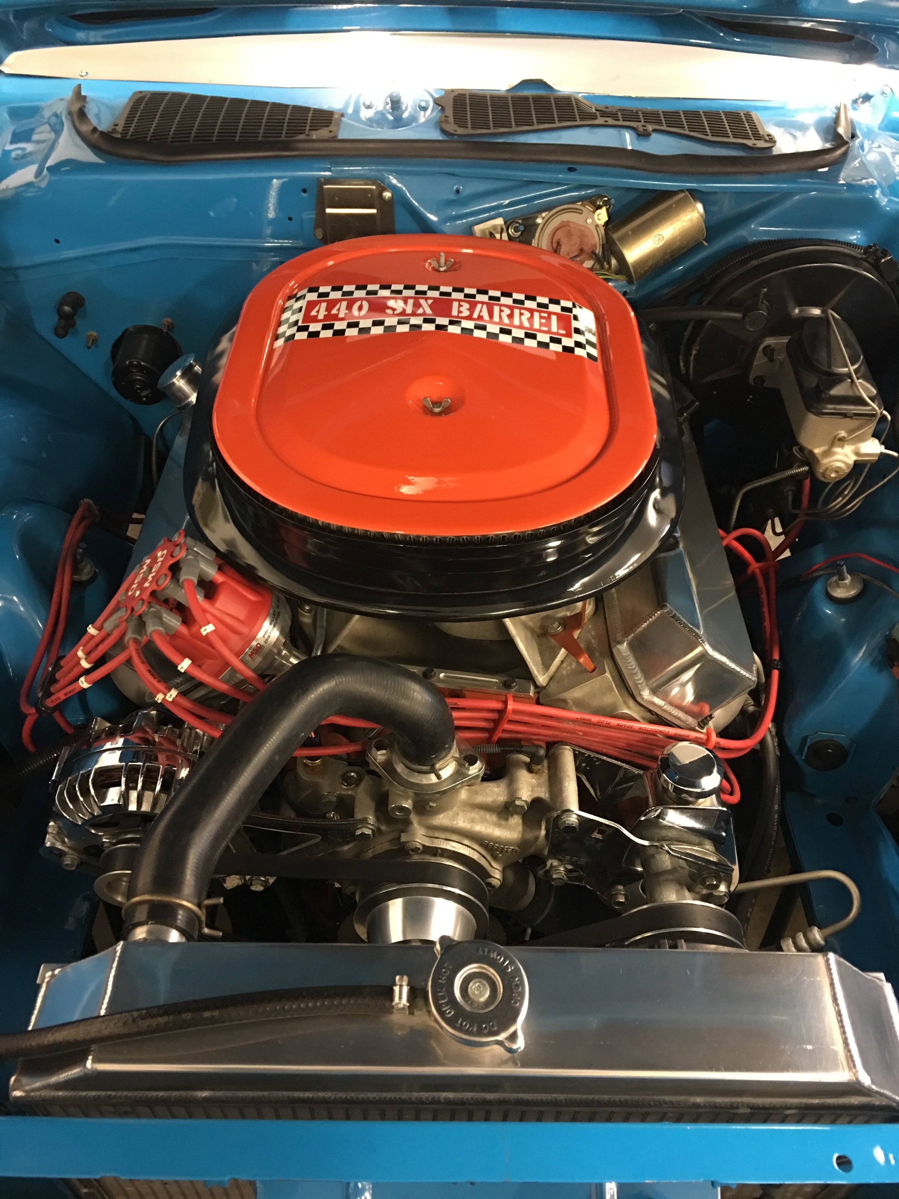

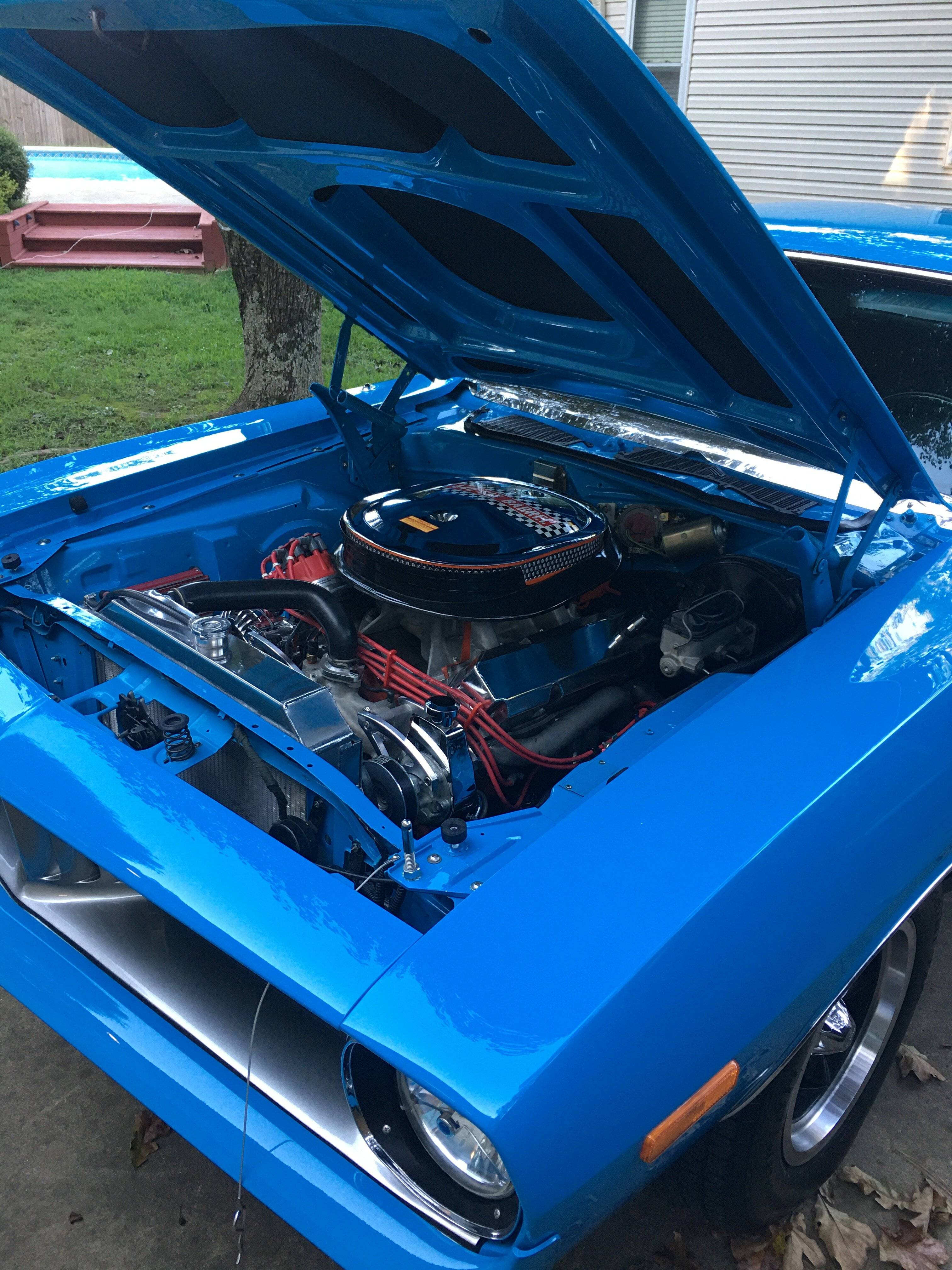

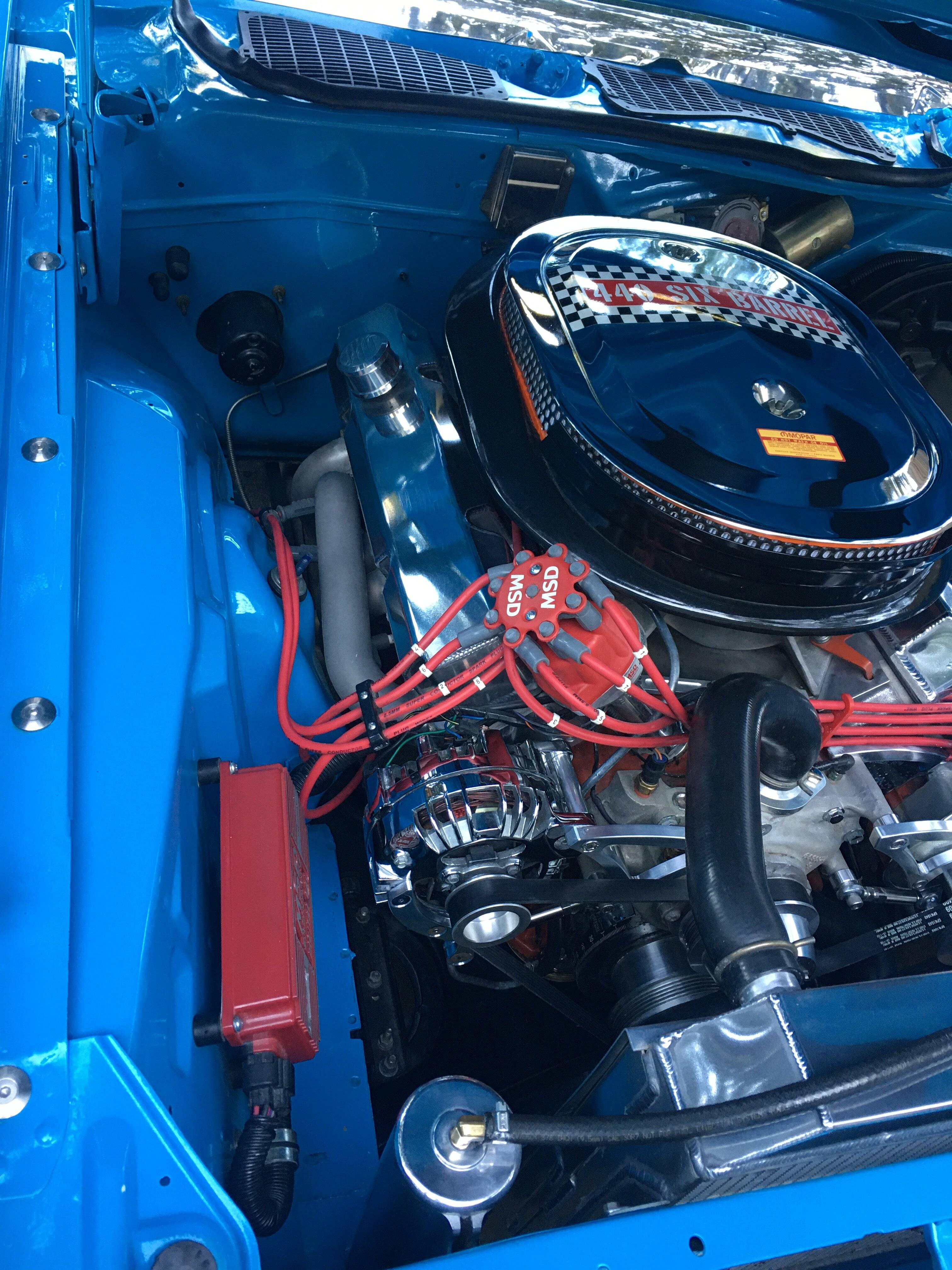

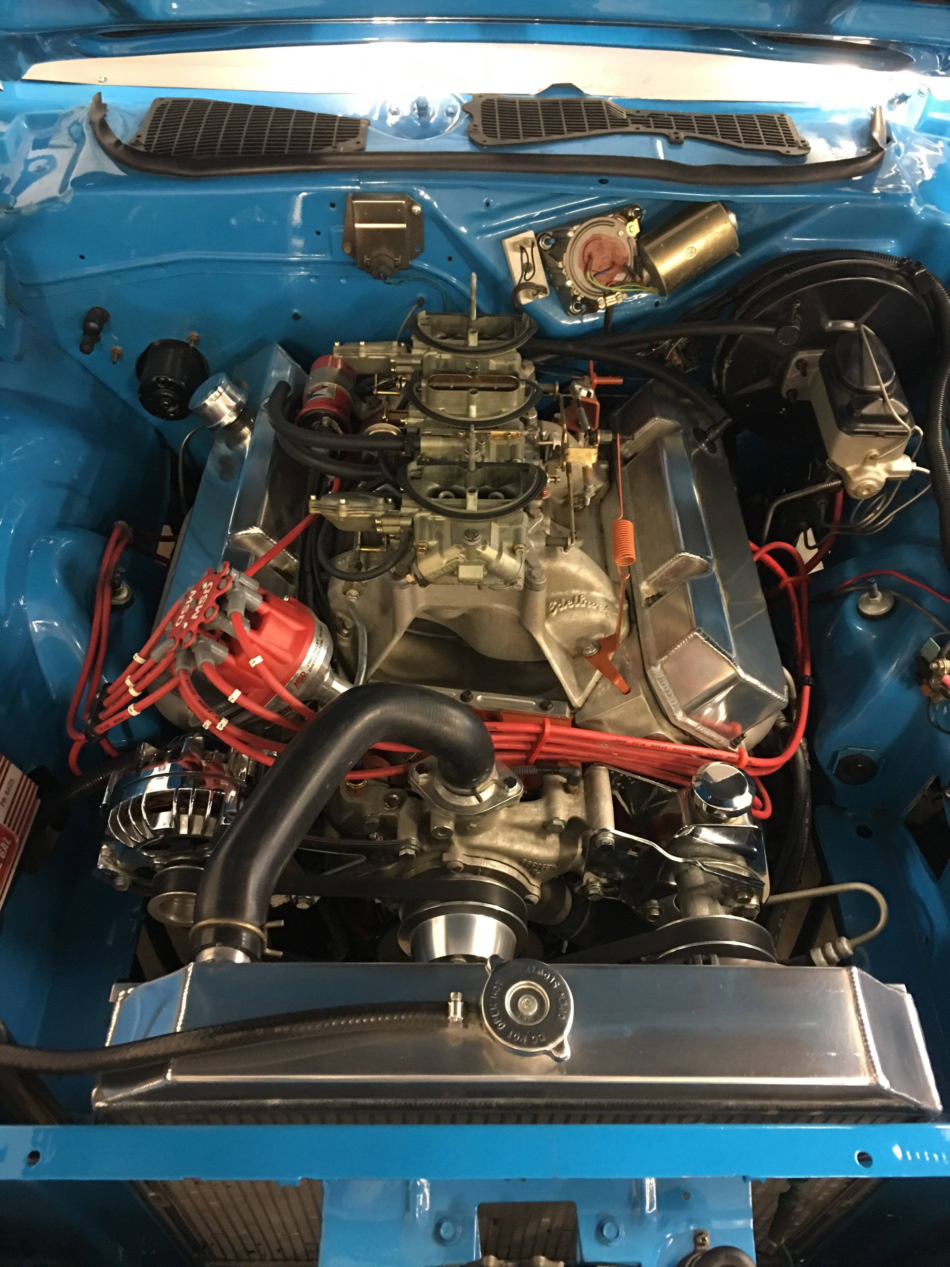

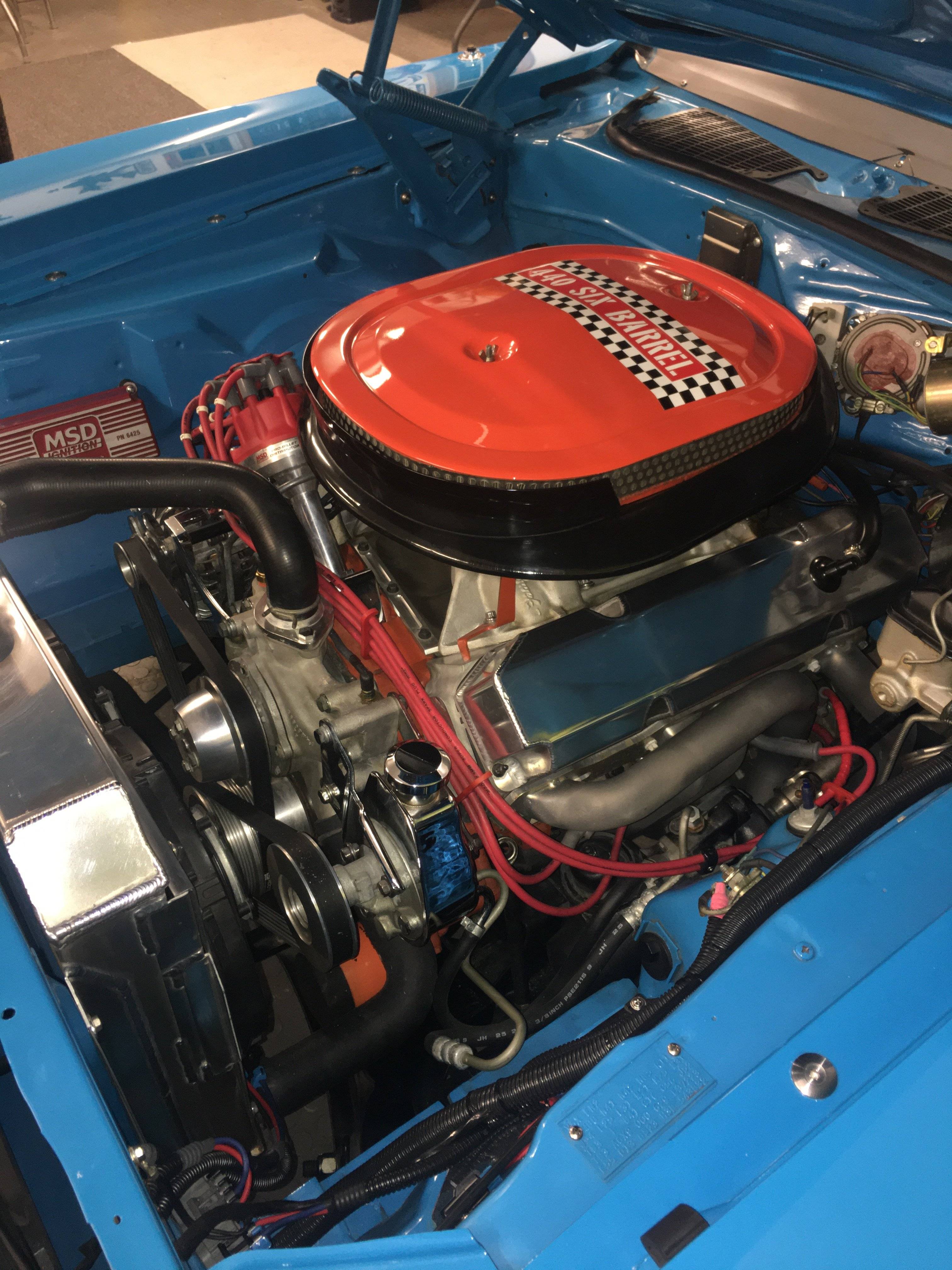

94AAF304-4571-4F01-8B52-FEE6E4225C0C.jpeg 94AAF304-4571-4F01-8B52-FEE6E4225C0C.jpeg 3A861412-DF38-4F44-8620-696514867DC0.jpeg 1B16FCDE-1CEC-480B-A02C-F273212F3A44.jpeg AFDAFCA4-BC5E-4336-A05E-8ABEE564AFB9.jpeg 6E8FDA49-8103-468E-AC2F-396E88F5F266.jpegA79CD02C-0D75-4410-A420-666FD9167D10.jpeg6E134389-AAA5-4BB9-B0BE-788561FBC20B.jpegCE02E8D2-5C9E-47E3-99D7-FAE5E684177F.jpeg36420658-A5B1-4D01-8E94-F26ED1A958B1.jpeg38BD68DA-645C-4A53-8B00-06651A302A3F.jpegView attachment 67047 94AAF304-4571-4F01-8B52-FEE6E4225C0C.jpeg 3A861412-DF38-4F44-8620-696514867DC0.jpeg 1B16FCDE-1CEC-480B-A02C-F273212F3A44.jpeg AFDAFCA4-BC5E-4336-A05E-8ABEE564AFB9.jpeg 6E8FDA49-8103-468E-AC2F-396E88F5F266.jpeg A79CD02C-0D75-4410-A420-666FD9167D10.jpeg 6E134389-AAA5-4BB9-B0BE-788561FBC20B.jpeg CE02E8D2-5C9E-47E3-99D7-FAE5E684177F.jpeg 36420658-A5B1-4D01-8E94-F26ED1A958B1.jpeg 38BD68DA-645C-4A53-8B00-06651A302A3F.jpeg View attachment 67047 Machined oe 440 block, 4.375 bore

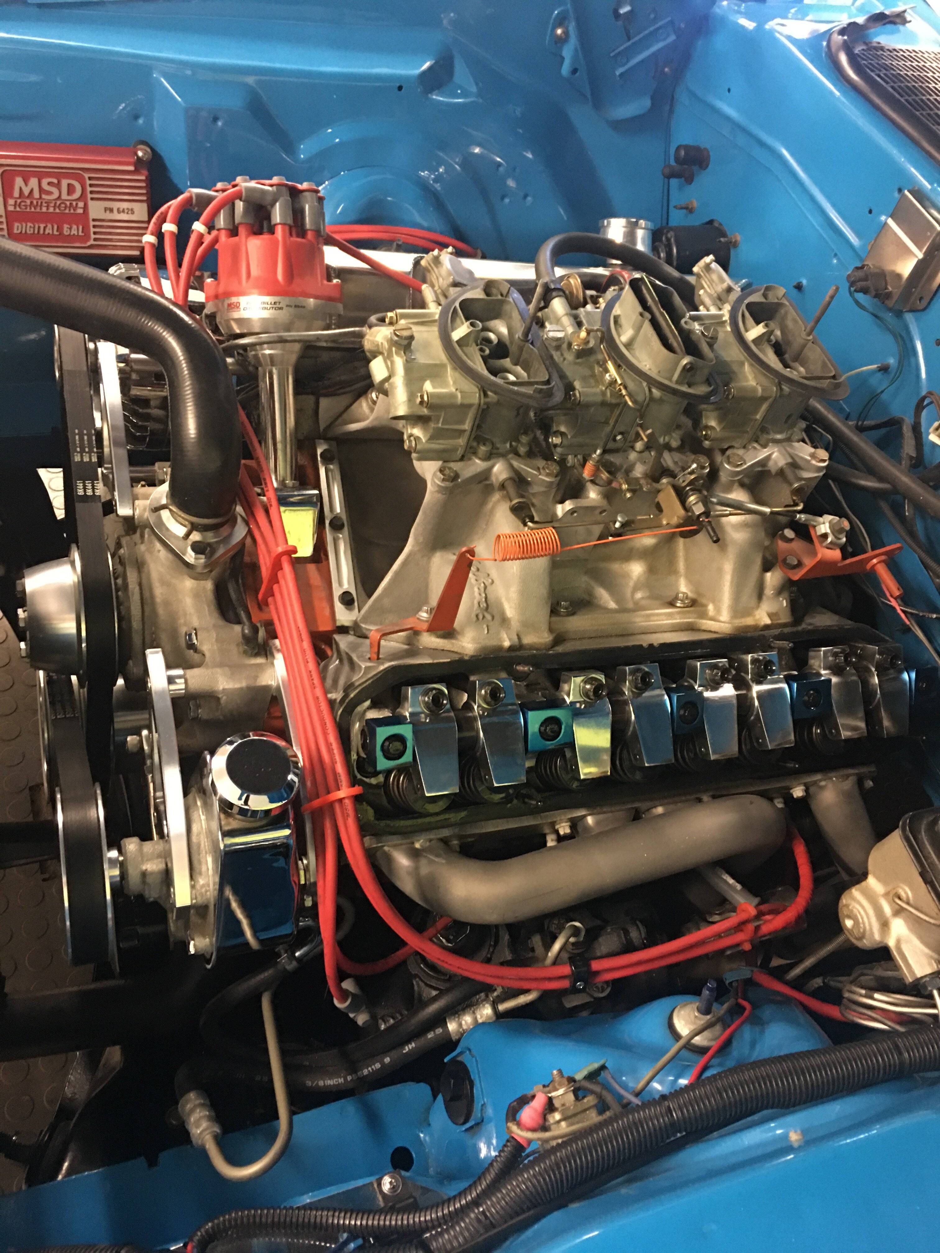

Eagle steel crank 4.15 x 2.375, Eagle 3D H-beam rods 6.760 x 990 pin, Forged Wiseco flat top pistons, Comp camshaft 0.545 lift hydraulic flat tappet,
Eddy aluminum heads 84cc, 440 source roller rockers 8.905 push rods. Factory six pack set up. MSD 6AL, MSD billet pro distributor, blaster 2 coil 8.5 wires, serpentine pulleys, TTI headers, dual spal electric fans with entropy controller.
Tremec TKO 600 5 speed trans (pistol grip) with .64 overdrive, Wilwood pwr disc front brakes, 3.91 suregrip 742 case.

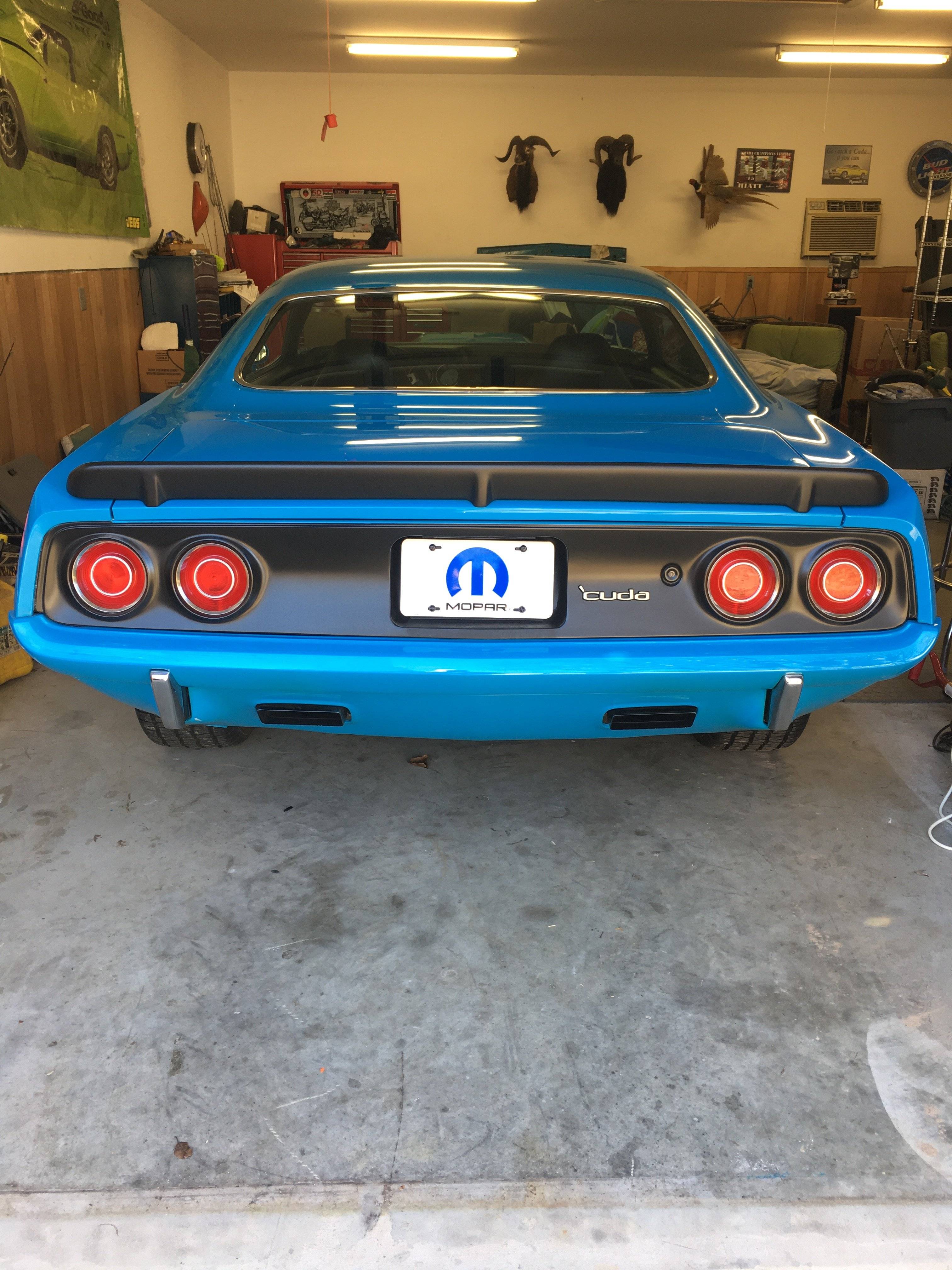

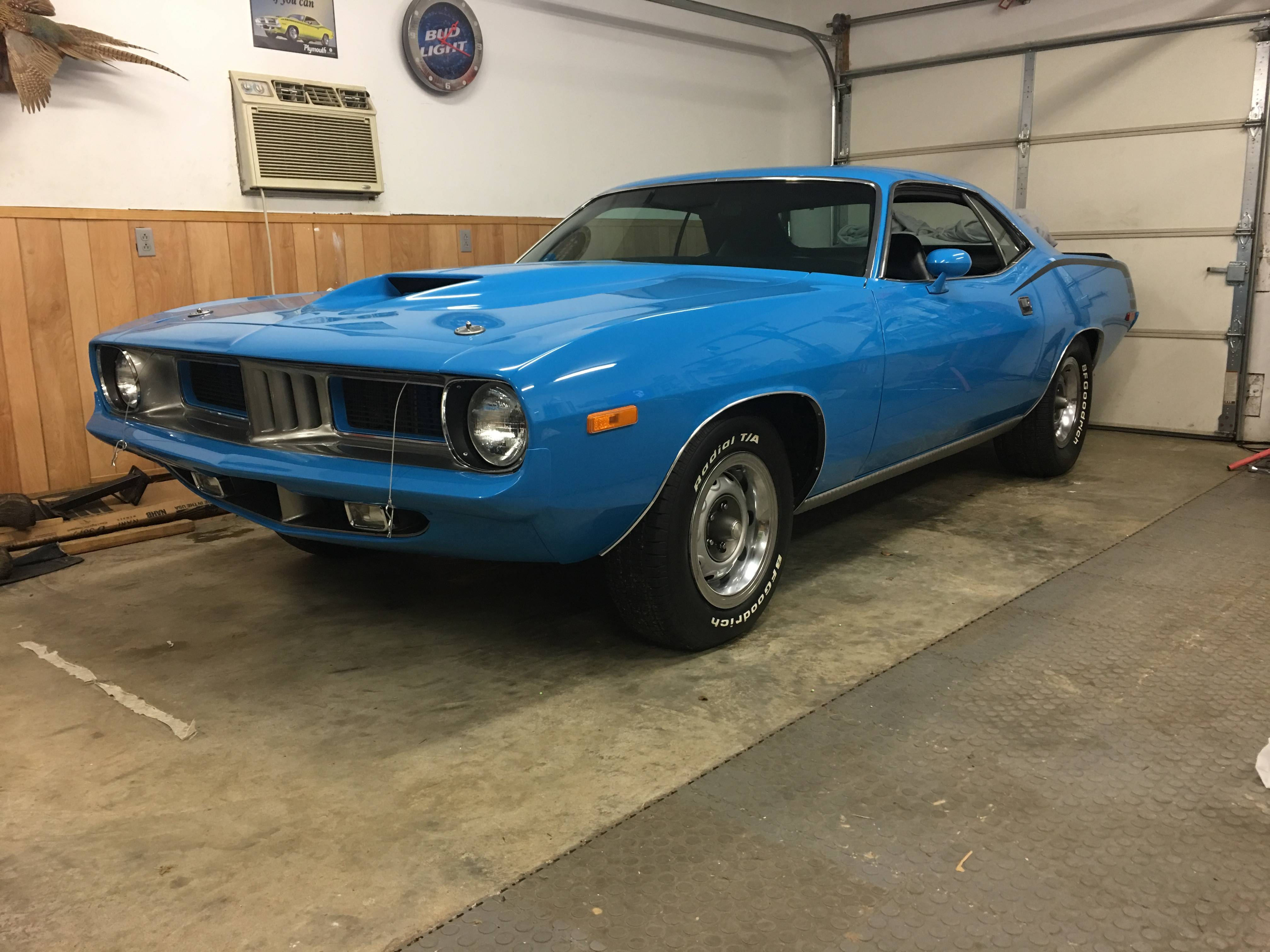

AAR hood and deck spoiler,Elastomeric bumpers fr & rr. Car painted it’s original petty blue in base coat clear coat.
Thank you for letting be a part of this site! Here’s a few pics.

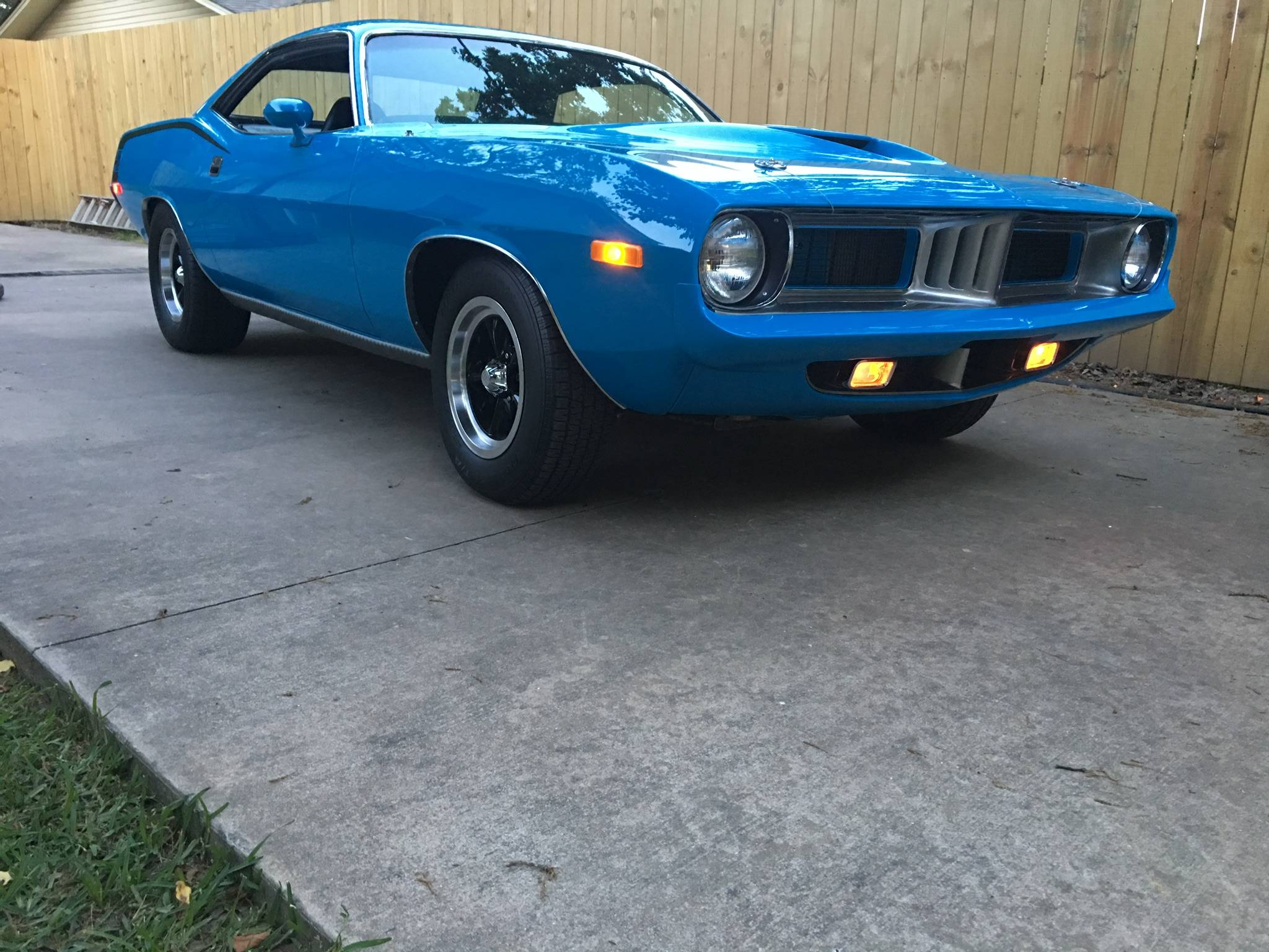

Elastomeric Front Bumper
Hello, Is that a repop or an original elastomeric front bumper? Did your stock front bumper brackets have to be modified?
robert power
robert power
really nice good job
fasjac
fasjac
Thank you! They are reproduction bumpers (pricey) and 70-71 bumper brackets.
fasjac
fasjac
As far as different, I don’t know of any, they just have the river/elastomeric coating on them. And no openings foe a bumper jack.

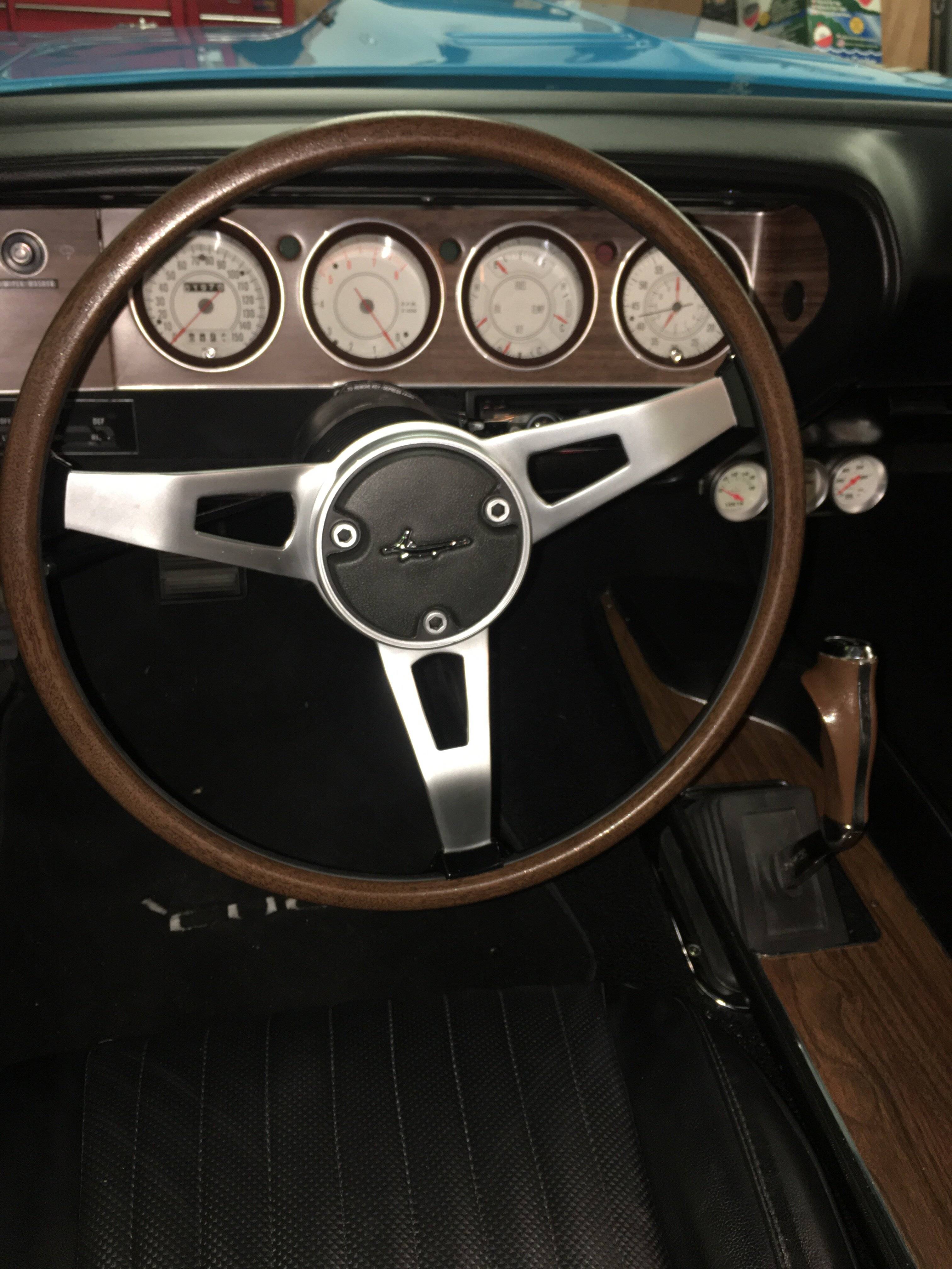

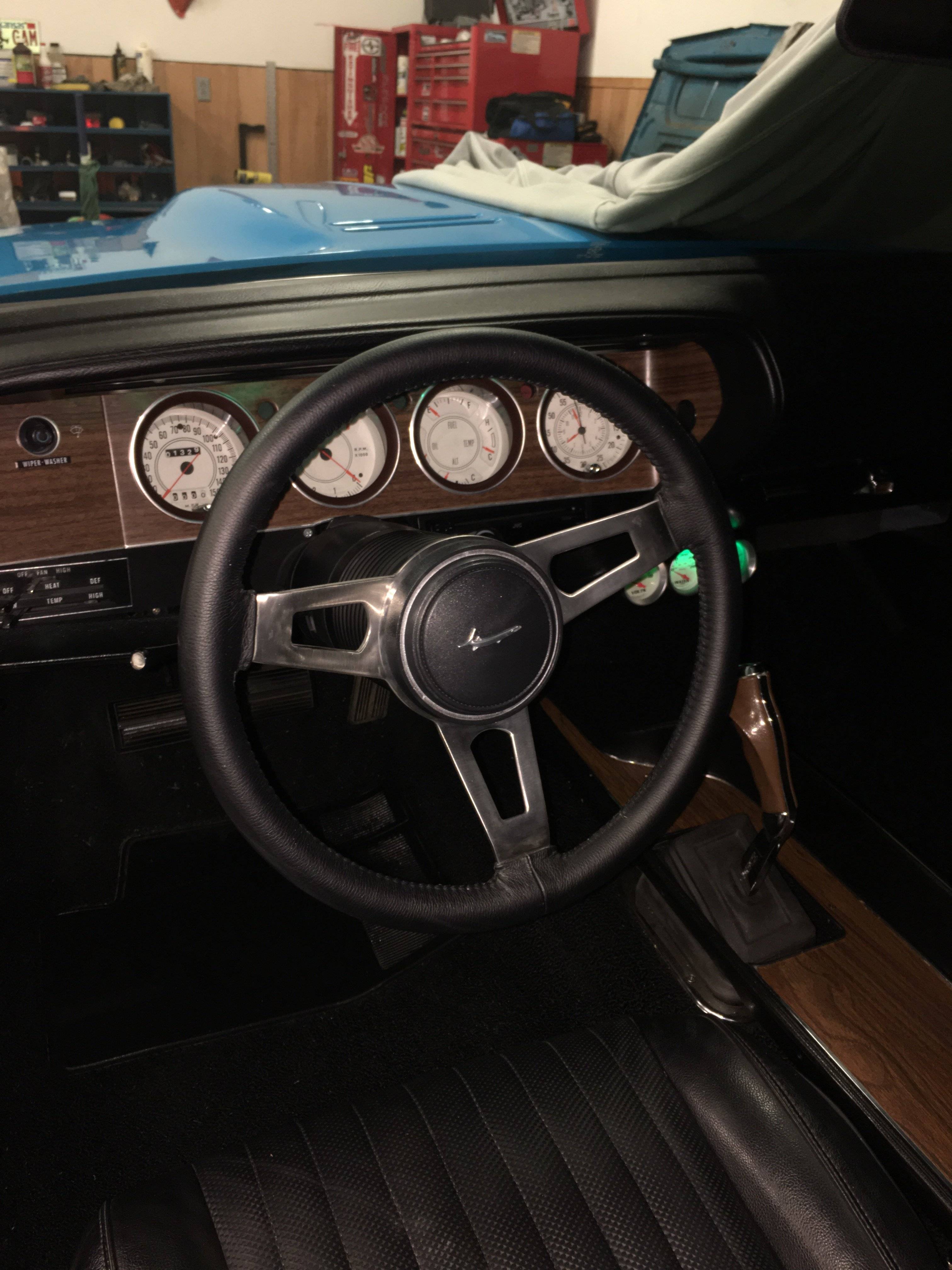

Hey fasjac, I really like your steering wheel, looking for one for mine. What brand and size is yours?
Thanks
Thanks
It’s a repro of the tuff wheel. I can look in my file and see where I bought it. Classic Ind comes to mind. I think around 150. I also bought the fish horn button for 40. My paperwork is at work in my office but, glad to share it with you. I have an original hanging on the wall in my shop now. I want to say it’s 15”. I can check it for you this weekend.

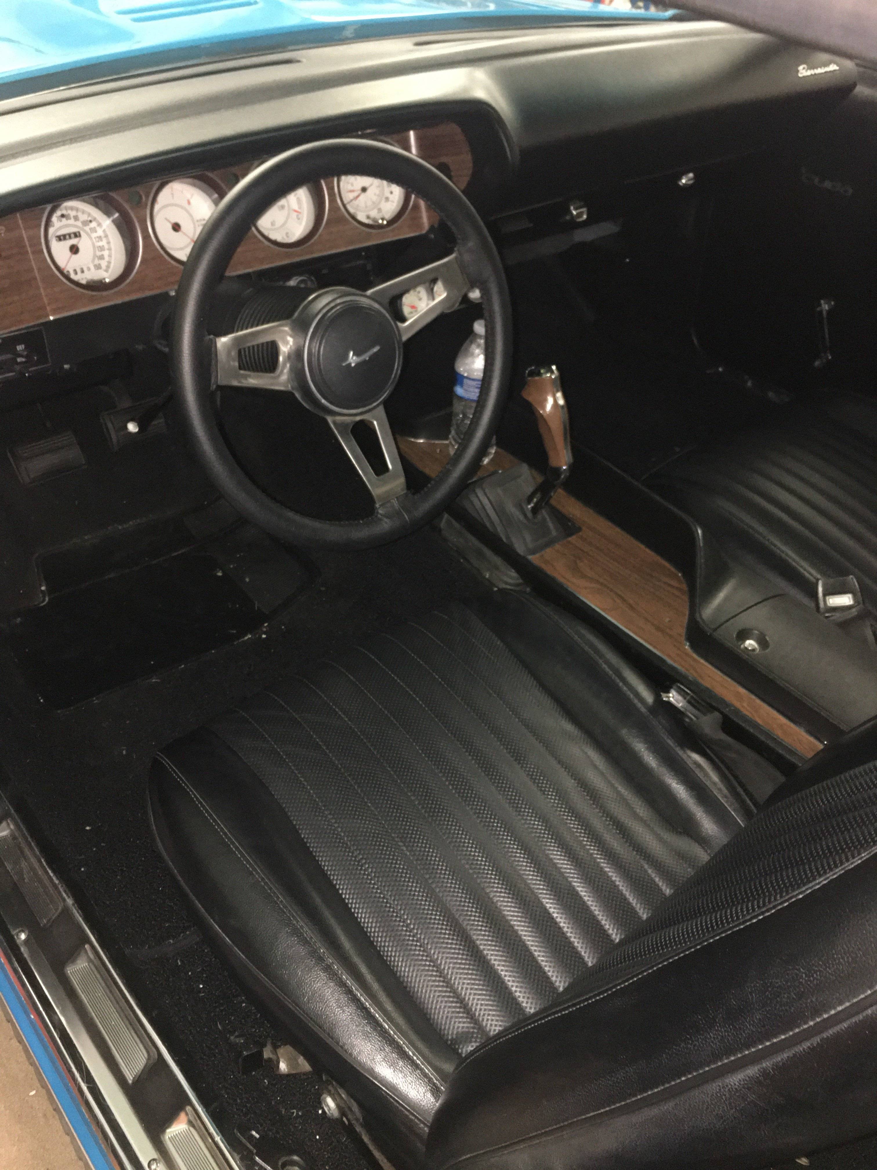

Do you like the tremic?
thinking of changing
Man, I love it. As I’ve said in the past “best upgrade I’ve ever done to a Mopar muscle car”
Last Saturday I’m cruising on I-40 headed toward Ft Smith. A newer mustang pulls along side and wants to play/race?? I’m sure he didn’t think I had an extra gear. So, I give him the nod. He steps on his and pulls out about 1 car link. I simply shift to 5th and continued to pull way away from him. I looked down at 145, and said to self, don’t be stupid. Best part is cruising at 70-75 w/2500 E’s.
