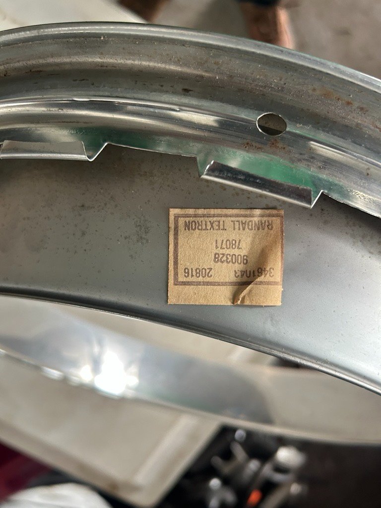

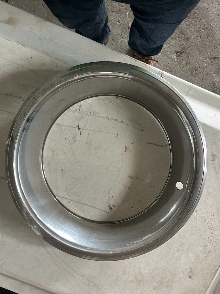

I had forgotten that I had a set of these stashed away. Can anyone comment on if these are original from 1970 or if they are from the 80's/90's? These came with my car in a pile of other parts when I bought it so I don't have any history. They are polished. I posted a pic on Facebook and the comment was that the sticker looks like it was from 15" x 6.5" that were sold in the 80's and early 90's with the 15" X 7" part number.

I believe I read a post from some time ago that stated OEM trim rings had a oval valve stem hole and later remanufactured type had a round hole.
I don't know so I am not attacking just a discussion point.
The hole on the bright chrome is oval. Is that what they are referring to?
The pictured trim rings, with the part number 3461043 on the label, are not 1970 original rings. These are the later re-issue and are likely the rings for 15" x 6.5" Rallye wheels, although numbered for 15" x 7" Rallye wheels. The pictured ring was made March 28, 1990.

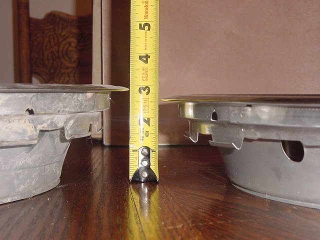

To check the actual wheel fit, measure as shown in the following image:
The deeper ring pictured on the left is for 15" x 7" wheels and the shallower ring pictured on the right is for the 15" x 6.5" wheels.
The shallower ring can be used on the 15" x 7" wheels, but leaves a gap at the inner portion.

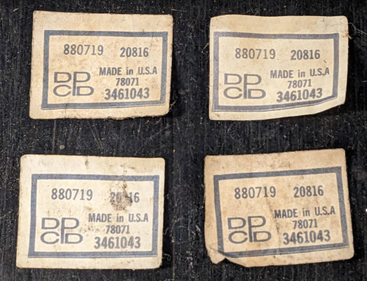

The following image shows the tags from the trim rings that I bought new at Chrysler in 1988 to use on a set of 7" wheels, and were listed for the 7" wheels, but are actually for the 6.5" wheels, which is where they reside today on a set of 15" x 6.5" wheels on my Duster.
