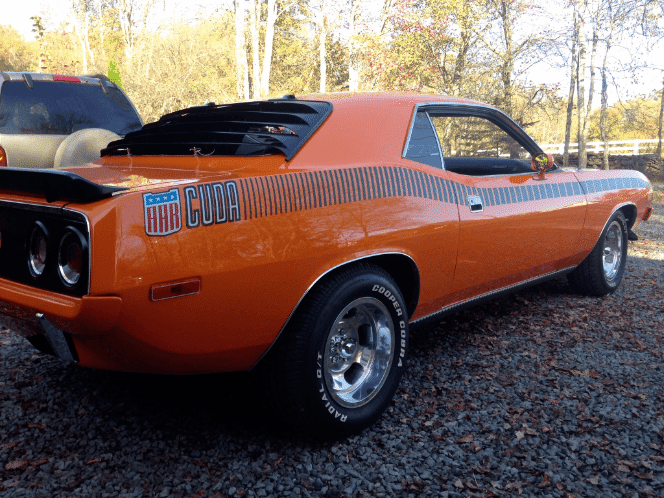

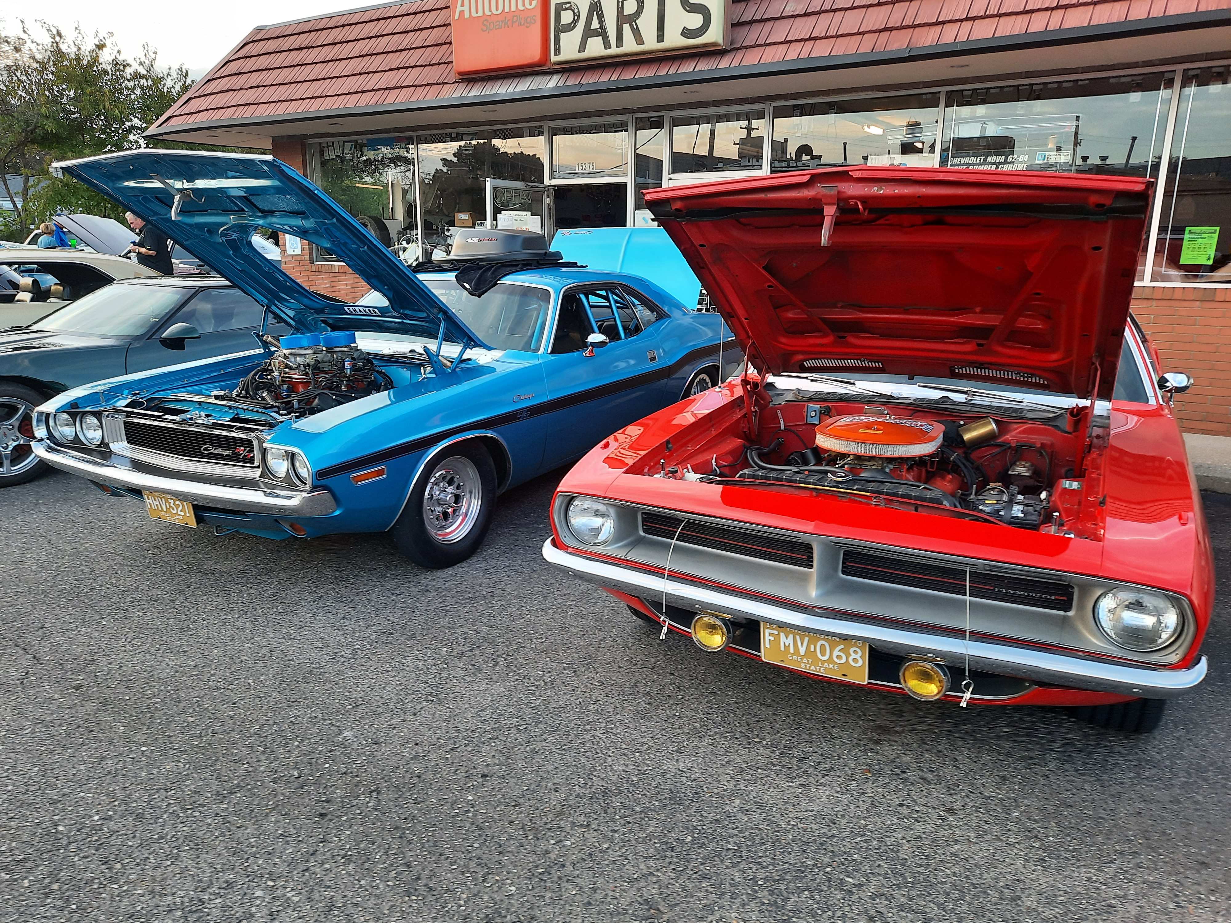

I run 235 60 15 front and 255 60 15 rear on my cuda with zero clearance issues.
racerkilla
Sep 12, 2010
89
37
pic

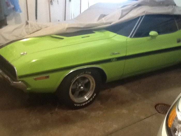

I use 15 x 7 front with 235/60-15 and 15 x 8 rear with 245/60-15 on my 70 Challenger. No rubbing issues.
bc3j
Oct 17, 2013
98
52
Cleveland, Ohio

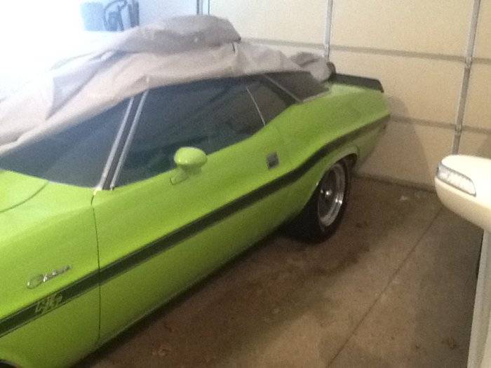

Doubleyellow, Just a couple of pix. A lot of snow here. Angles aren't that good.

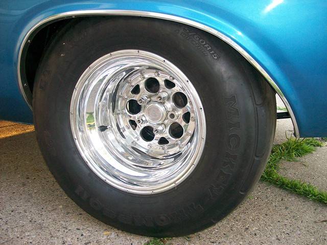

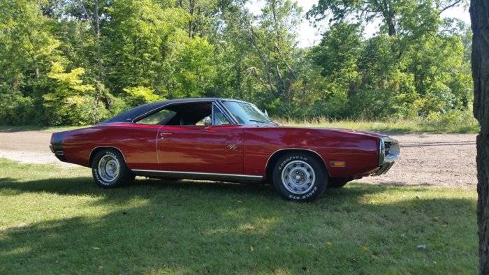

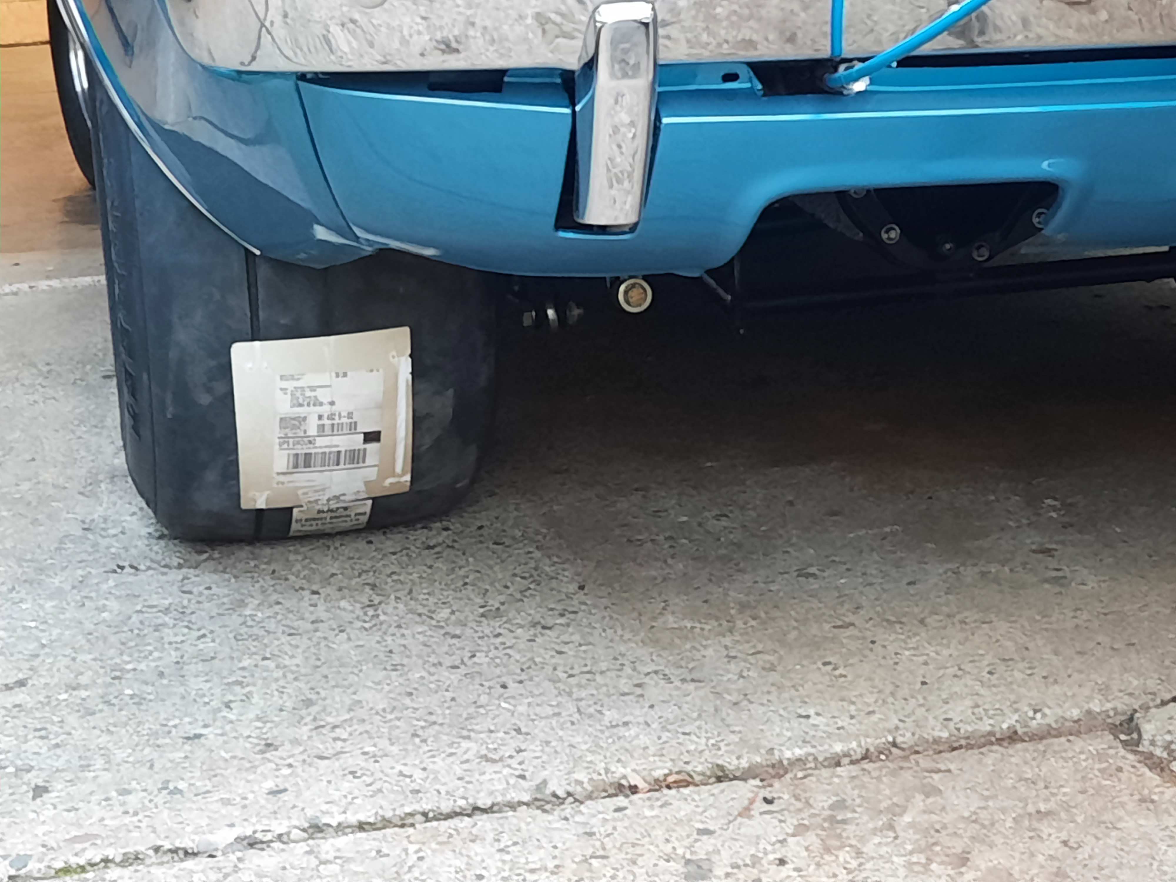

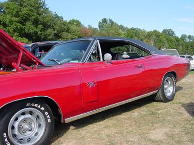

I have 235/60 on 15X7's on the front & 295/50's on 15X8 Rallye's (currently on my Charger, first two pics). They fit nice on any stock suspension wheel opening Challenger also.

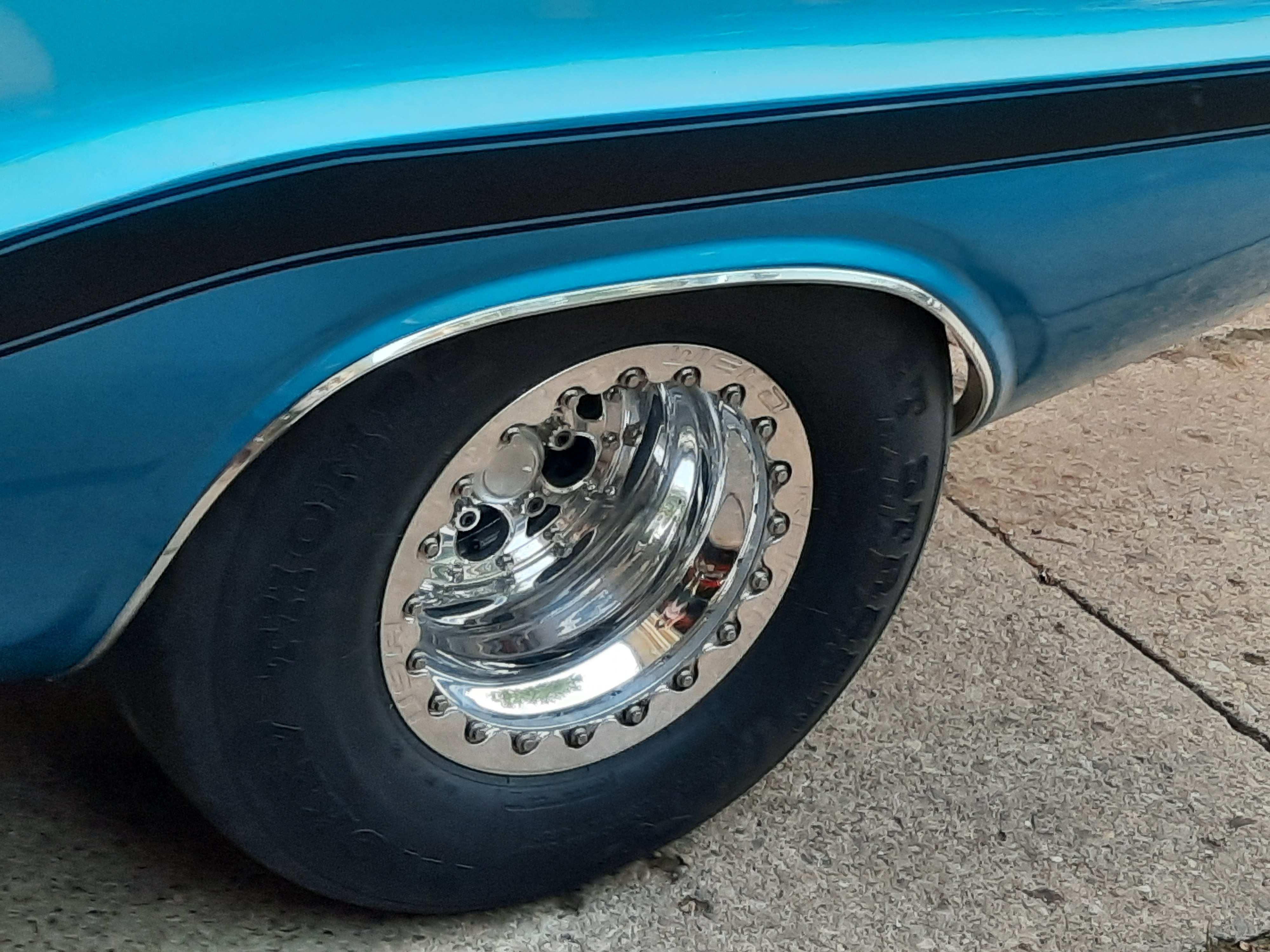

Yes, as mentioned 12" will not fit on the rear of a Challenger without a mini-tub. My Challenger is now mini-tubbed & the springs moved inboard 3" with 15X12 wheels (third pic).

I can’t see the first number on the Challenger tire… What size is it?
6PKRTSE
Feb 3, 2010
898
477
I run 316/60/15 Drag Radials or 29.5x10.5Wx15 slicks on these 12" wheels. Been updated since. They are now also bead locked.
