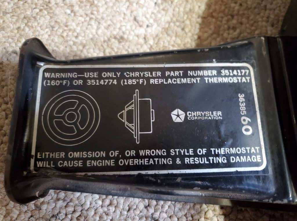

Are you using the right thermostat? Your cooling system was engineered to work with a particular thermostat design. It was so important that in some instances Chrysler put a decal in the engine bay to make sure the correct 'stat was used. This style isn't available through regular channels anymore.
The "Robertshaw" design shown, now called a "high-flow" unit, is what came new in every single Chrysler V8 built during the musclecar era. It was a part of the system design. They're still available NOS (break out the parts books!) and through EMP/Stewart Water Pumps (although NOS are cheaper). The orifice area is at least twice as large as the junk we sell at auto parts stores. If it doesn't look the like one on the decal, it's not the right one no matter what the supersession or parts person says.
I have a 10.5:1 iron-head W2 340 in a '69 Valiant with a factory-style 22" radiator, a stock water pump, clutch fan (no shroud) and an NOS Mopar 2808631 (180°) thermostat. The engine bay is more cramped (less airflow) than an E-body. It stays right at 180° even on days in the high 90s. Traffic, idle, racing? It doesn't matter, the needle doesn't move.
Don't underestimate what the right thermostat can do. Always try the right thermostat before wasting money on anything else.
Thanks for the info on the thermostat. I missed the link the first read, and was having no luck finding a NOS unit... I thought from earlier research I did that that type of thermostat was more typically found in recreational vehicles and industrial vehicles that had the bypass built into the water pump. But after digging deeper, I think its a no-brainer to give it a try it if will flow that much better.

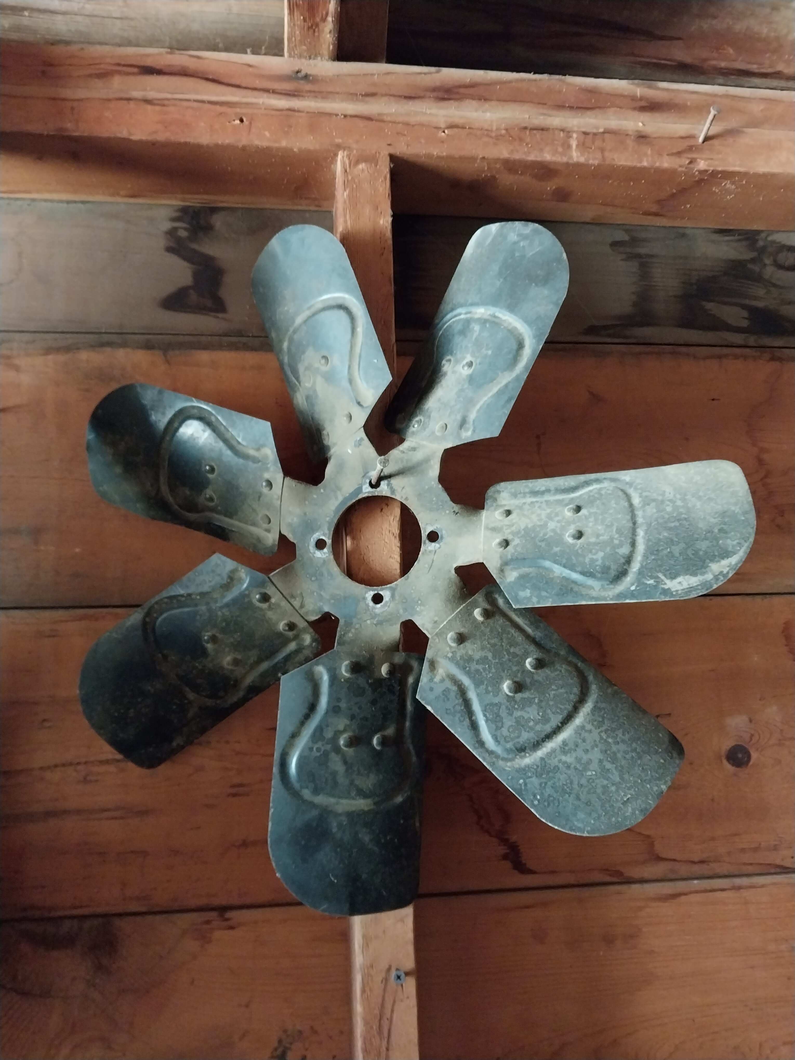

Can you expand further as to why the flex fan is a no-go? I have a 7 blade fan hanging in the garage that is the same diameter as the flex fan, just not sure if it is the correct OE fan for this application. Any suggestions on identifying the correct OE fan for this? And I hear a lot of talk about using the thermostatic fan. Any advantage to that other than it doesn't rob HP when the engine is cool?

I'm pretty certain that the fan diameters varied from make to make, radiator width and engine size. I've seen 20", 19", 18.5" and 18". There are probably other sizes. Obviously the shroud opening would vary as well. So if the fan shroud fits the aluminum radiator well, and the 19" fan looks too close to the shroud opening, I'd look for a 18.5" fan first or 18" fan second. Another thing that helps are the new motor mounts with the internal metal tabs that don't flex as much or break. This would allow a closer fit than oem.

Approximately 19" diameter
With the blade pitch, that fan is an excellent air mover. Like Xcudame said, the challenge now is to find a shroud to fit your rad, or a smaller diameter fan to fit a shroud with adequate clearance. A properly fitted shroud is key to air movement thru the radiator to provide idle/low speed cooling. He also made an excellent point about the engine mounts.
