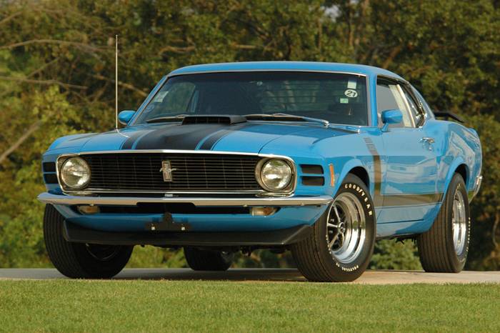

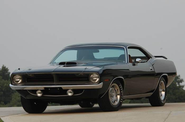

The last few projects were built to OE specifications. We are doing this one with the same mindset. Below is an example of some of the past restorations.

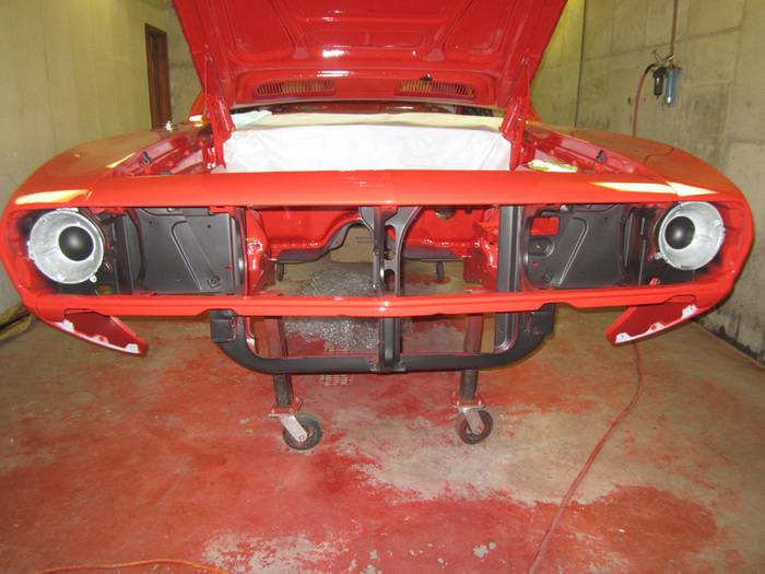

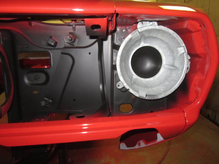

Spending money on a car that never existed is not "easy". A better adjective might be crazy! (lol) Here are a few addition pictures from a while back. I'll try to get some updated photos soon.

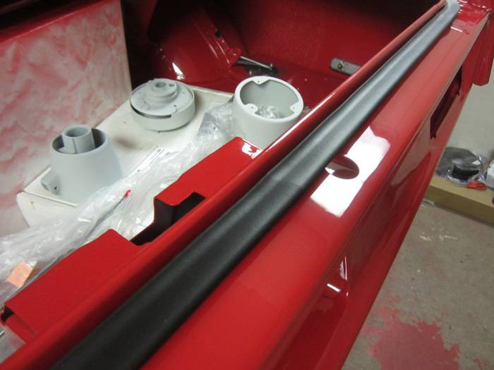

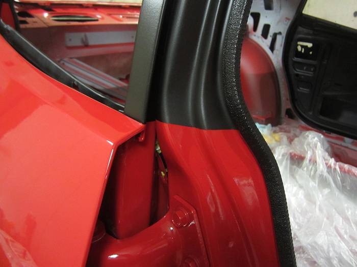

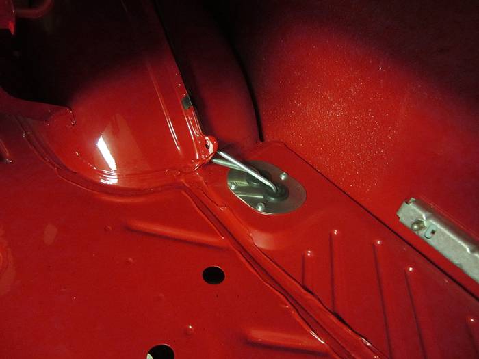

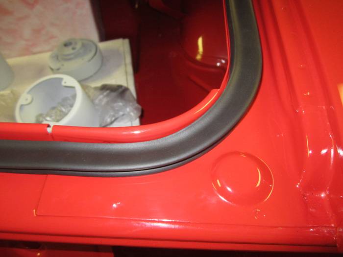

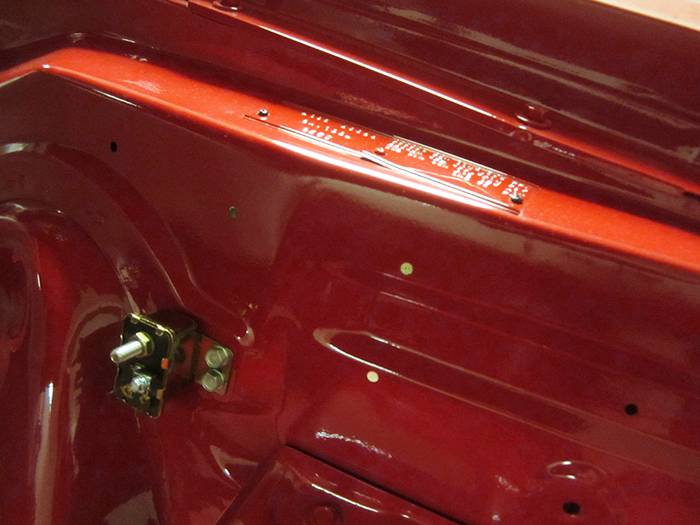

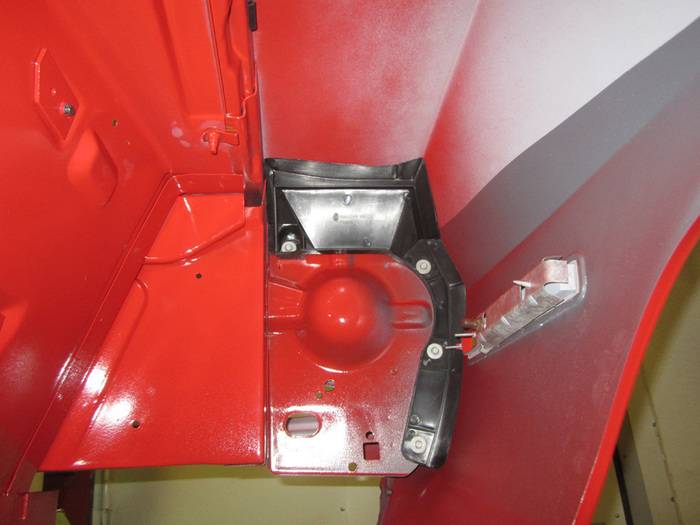

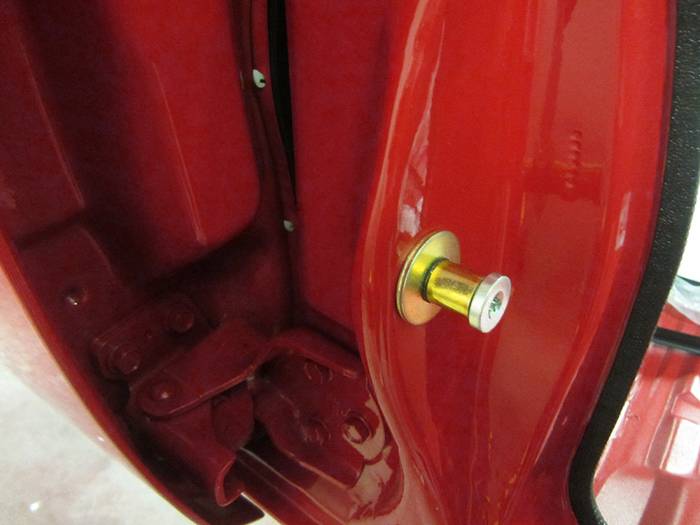

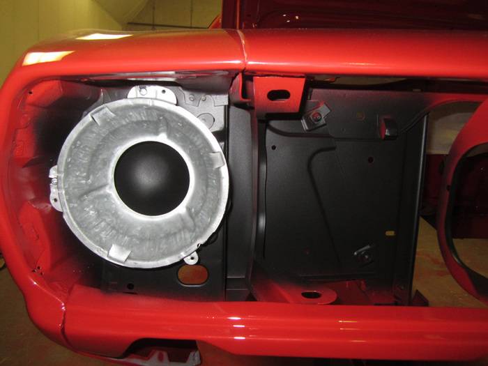

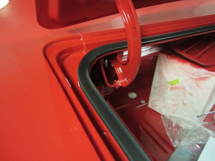

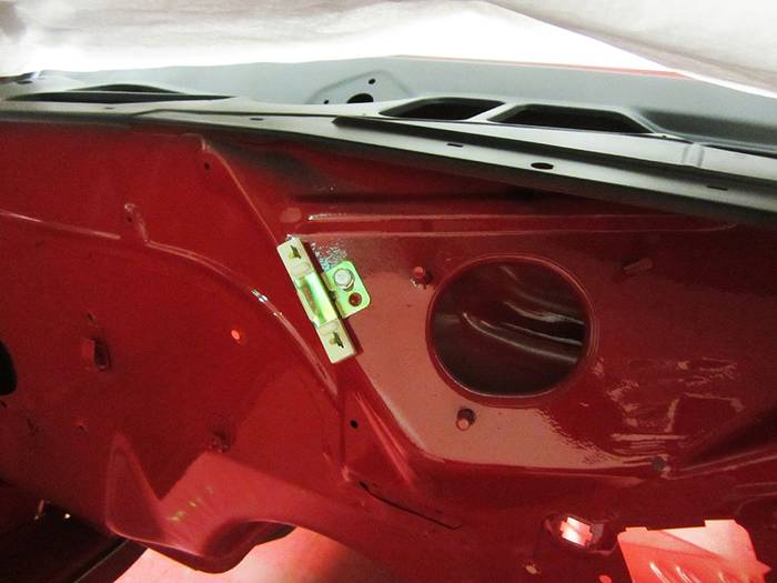

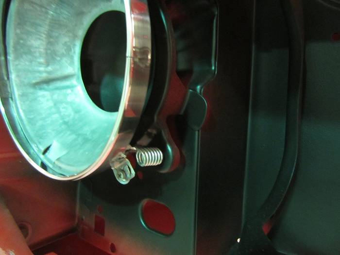

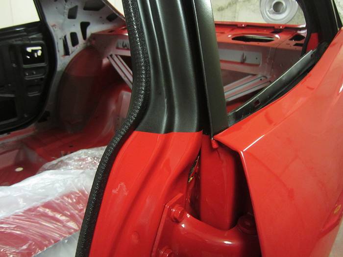

Here are a few additional shots of the Door Jams and some other photos.
I love those details. Keep sending the pics. Thanks

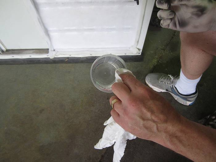

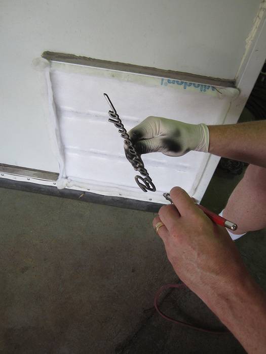

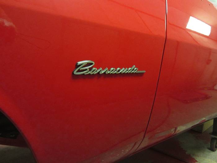

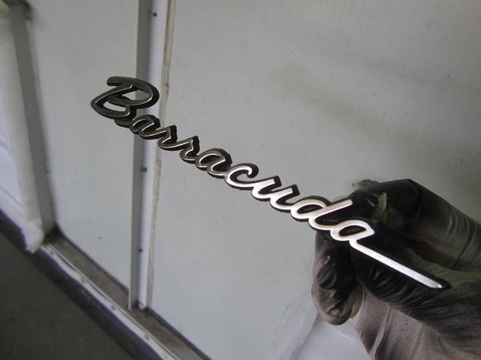

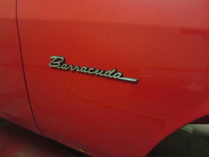

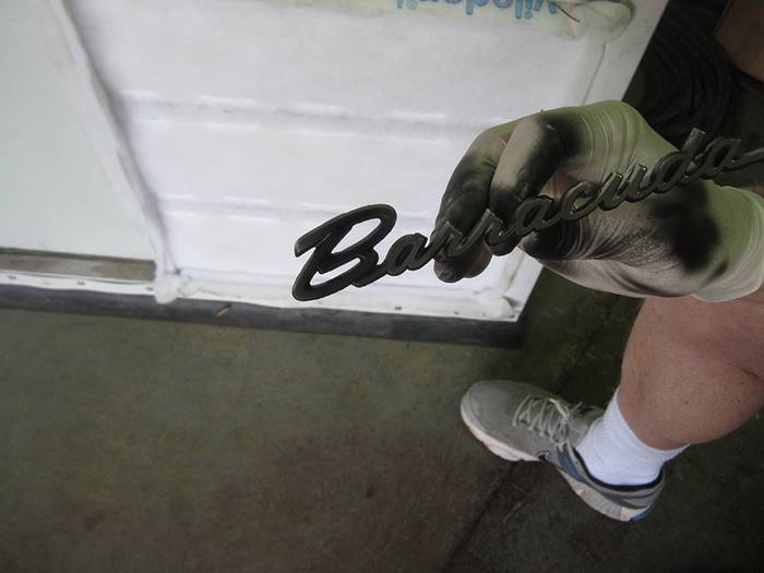

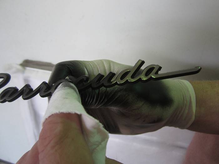

Here are a few photos showing the process for restoring/detailing the original style Barracuda emblems. After removing the old worn out paint around the perimeter, I polished the top of the lettering to look new again. The entire piece was then cleaned in lacquer thinner and painted black using an airbrush. I tried to keep from spraying the top sides of the lettering and the airbrush allowed pin point (even) spray control. After the black was applied, I used a remnant of T-Shirt material, stretched tightly across my finger tip, to remove any over-spray. I would dip the tip of my finger in lacquer thinner to dampen the T-Shirt material before rubbing over the top side of the lettering. This allowed a very clean & defined paint line without removing paint from the sides of the lettering. The results turned out just like the Factory originals and they looked new again.

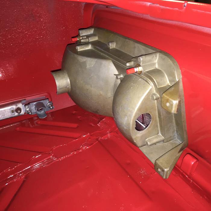

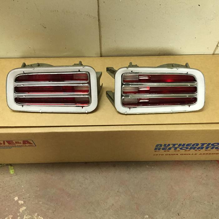

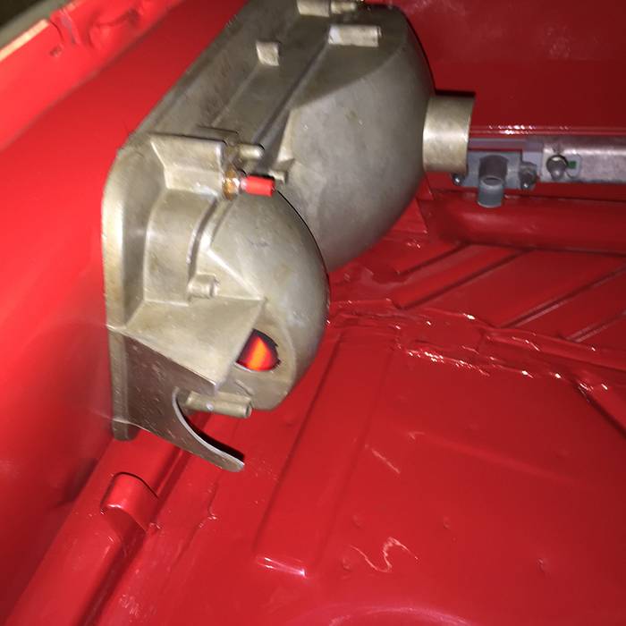

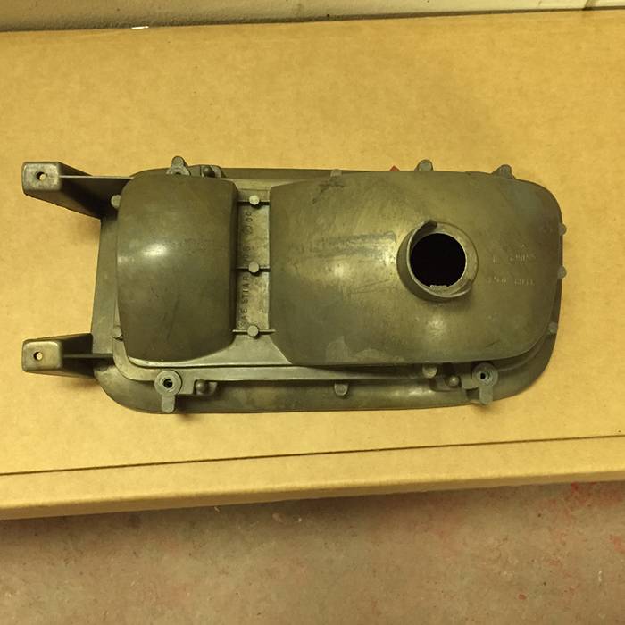

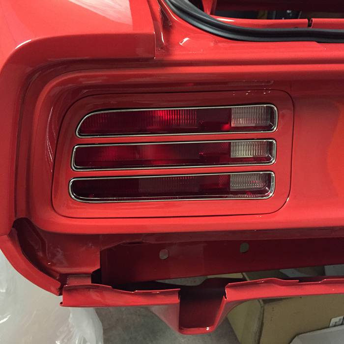

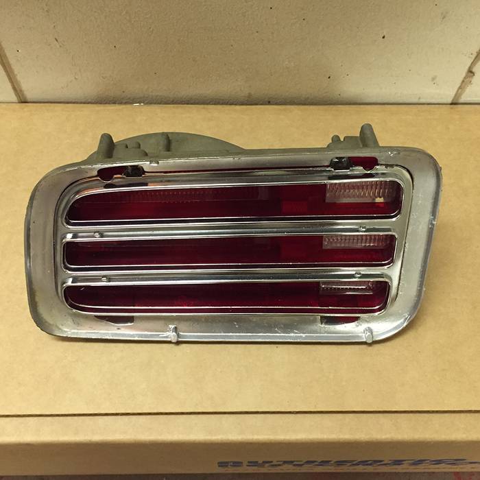

Here are a few of the Tail Light Assemblies.
