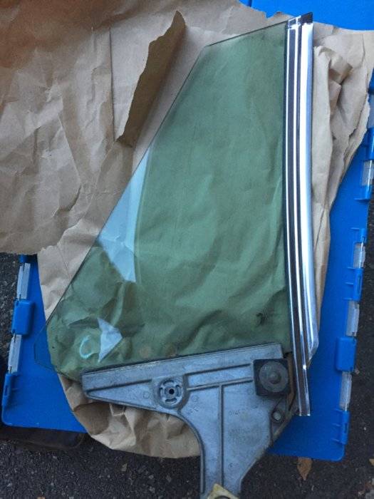

I finally found the extra convertible tinted glass that I stored years ago. Have a left and right rear quarter glass tinted, and a driver's side door glass. Only missing the passenger's side door glass in tinted form.
My A66 currently has non tinted glass (replaced the cracked windshield with a tinted version)
I will eventually install the tinted glass in the car. It all appears to be in good condition overall for the age.
Had luck with these stored parts: glass date codes decode as 9th month of 1969 for my October 1969 SBD Challenger.

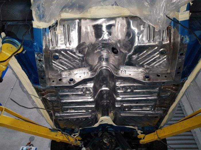

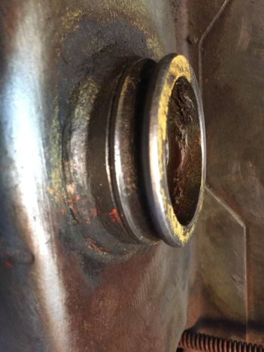

Completed cleaning the rear wheel well, stripped, cleaned rust proofed. Took another member's suggestion and used a commercial heat gun. Did a great job of removing very brittle old undercoating.
Need to reseal and put back seam sealer in the welded seams.

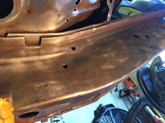

Fun job
Cleaning up the torsion bar cross member, frame and floor.
Found original orange and yellow assembly markings on the torsion bar cross member.
moparlee
Jul 25, 2011
3,317
1,478
Mid Michigan
You are doing a fantastic job on cleaning up those surfaces. How many wire wheels have you gone through? Looks like you found a couple of small rust holes in that floor pan.

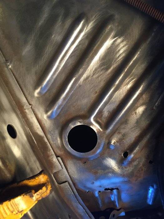

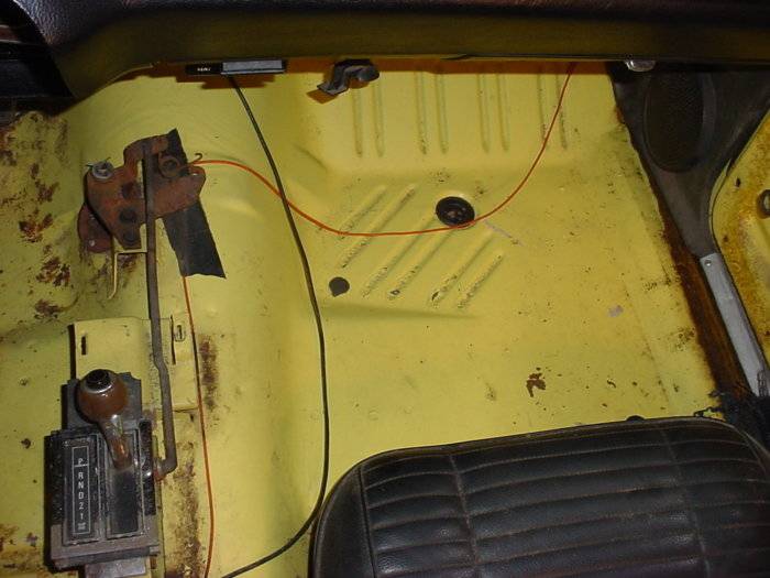

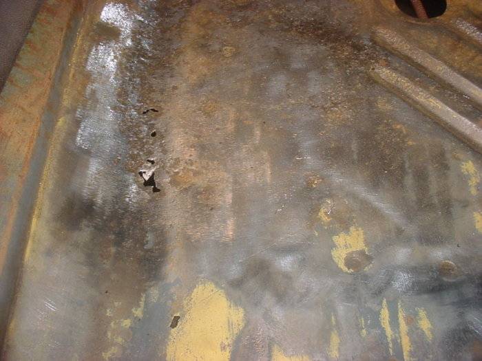

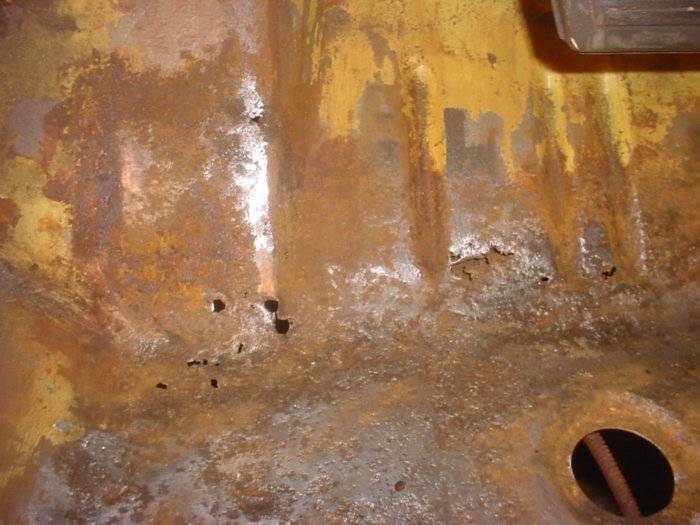

I buy the cheap Harbor Freight wire wheels for about 3 bucks a package and throw them out when they wear out.
Have to make sure you wear safety goggles; the wires from those cheapo wheels fly all over.
They are cheap and they work ok.
Luckily, the underneath is cleaning up easily.
Yea, the holes were visible from the top
Only holes were in the driver's side front floor pan. (the trunk pan is also shot)
I was pretty aggressive in sanding the area down on top to see what would need to be replaced (belt sander with 60 grit)
The strange thing: the metal is still very strong and intact around the holes; I physically tried to enlarge them to see the extent of the damage.
I have a new AMD floor patch panel for the area if needed, I wanted to see if some of the holes could just be welded up and ground down?
I will probably fit in the front section of the new pan from the torsion bar brace forward to the fire wall seam. Looks to be the best repair option.
The right side was mint and still had factory paint on it.

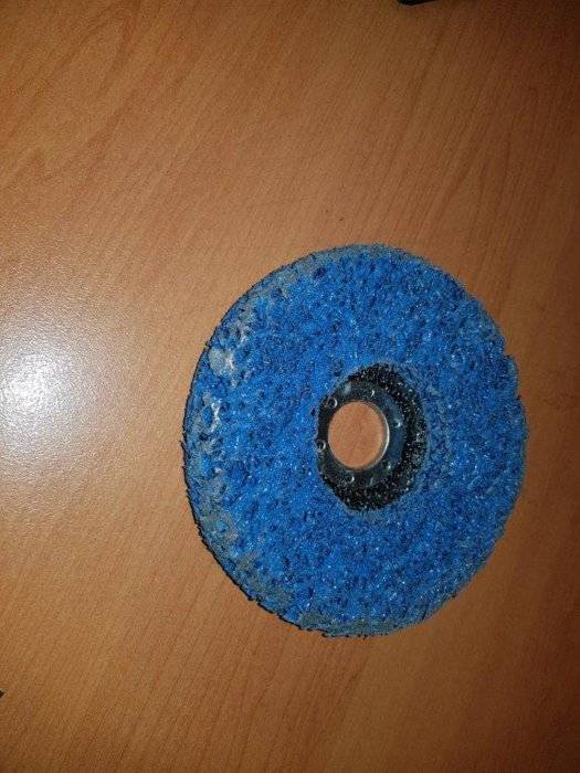

Great Job might pay to get some cuts off an old floor rather than full replacement

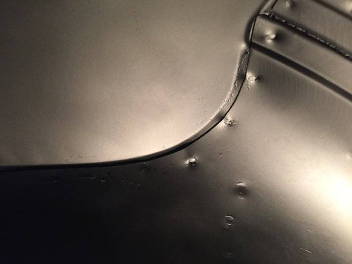

You could try these Poly strip discs they take off the undercoat & Paint without damaging the metal
I used a Milwaukee battery grinder just make sure the disc is rated to the grinder speed first 1 i tried a put on a powered grinder the disc exploded thought i was missing a couple of digits all good.
Also used a heap of cheap wire wheels in a high speed drill the good thing is when they get tired you reverse the drill & get extra life
Second pic is the finish with a poly disc i was lucky the floor had been done 12 years ago & protected with some good etch primer

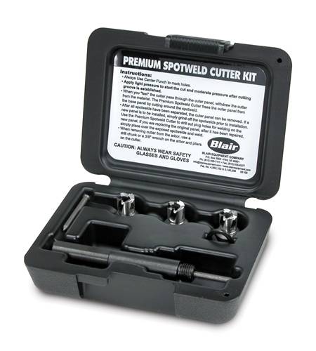

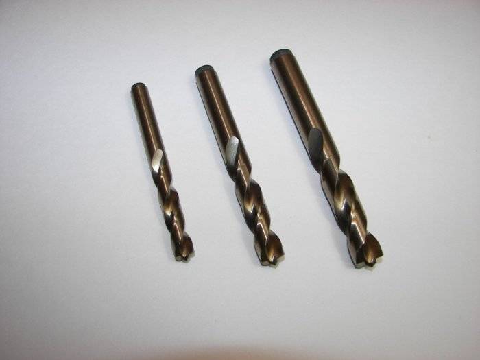

I hope you didn’t buy the spotweld cutters at H.F..
Looked for quality with both the cutting discs and spot weld cutters
Purchased these already from Amazon; American made, thought I would start w these. Never worth buying cheap with this kind of item.
Kester's Services
Spot Weld Cutter Drill Bit Set of 3 Cobalt Made in USA
Professional quality, Long lasting, Made in the USA
js29
Aug 5, 2012
671
153
lee center ny 13363
I use the Blair bit's. Center punch the spot weld, use an 1/8th drill bit and drill A pilot hole. I try not to go all the way through. slowly drill the spot weld keeping the bit straight. when you see the top of the blades disappear you are through the first layer. I like doing this instead of drilling all the way through. My 2 cents!
