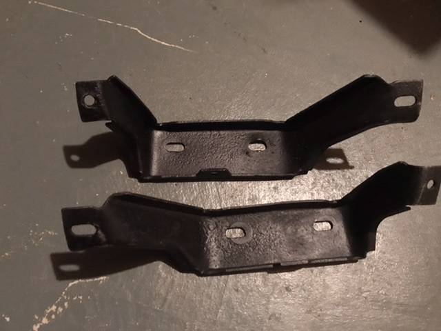

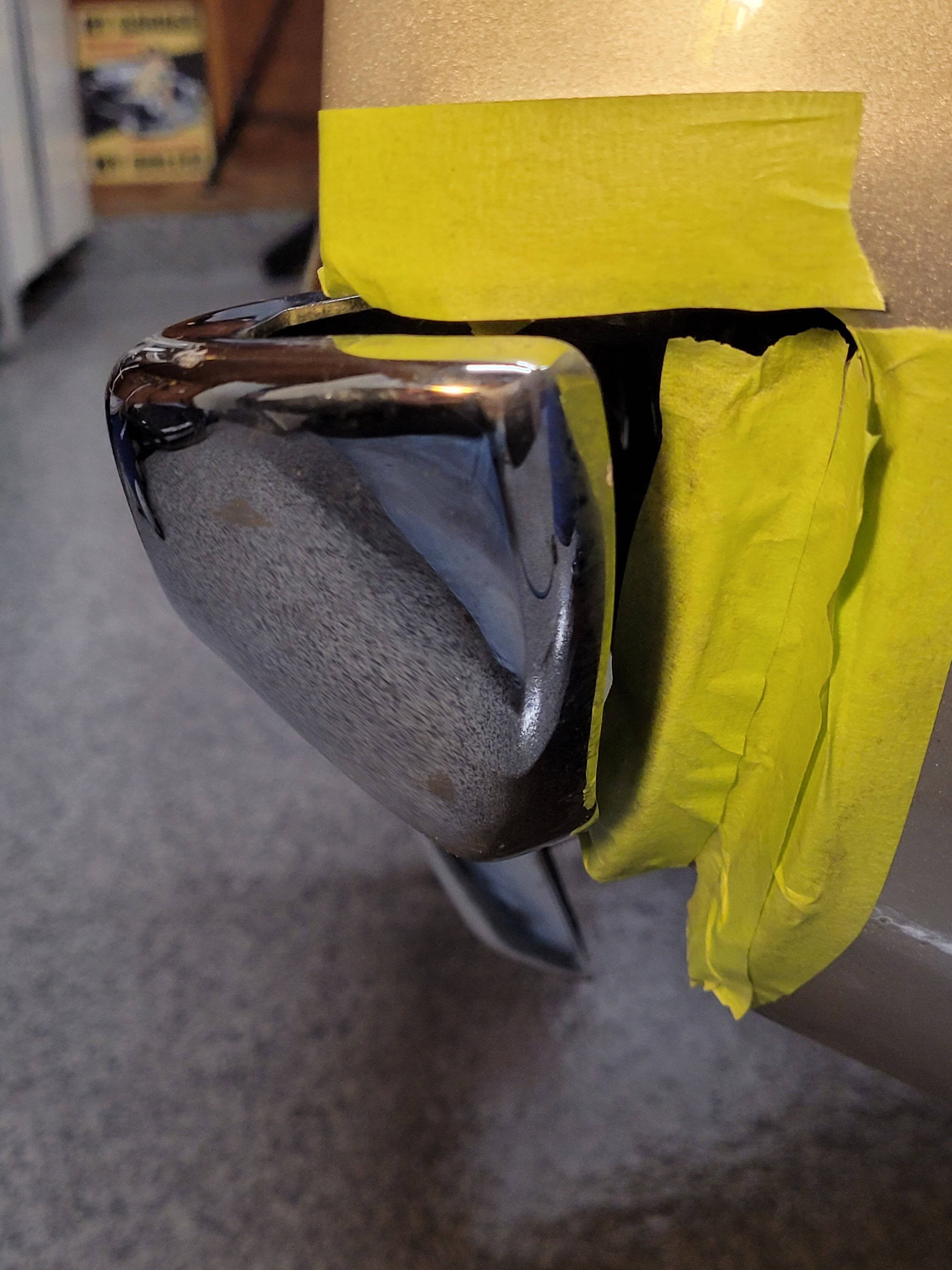

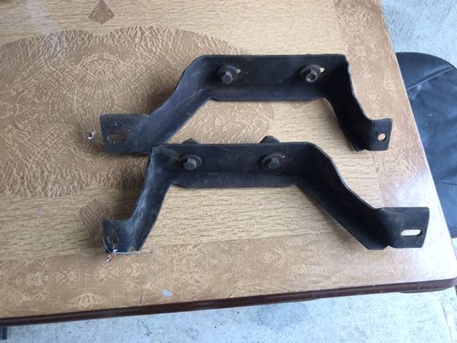

Hi guys, I'm a fairly new E-Body forum member and have referenced many of your threads as I restore my '74 Barracuda. Like many have done before me, I've decided to ditch the ugly protruding '74 style Rear Bumper in favor of a cleaner looking '70-'72 style Rear Bumper.

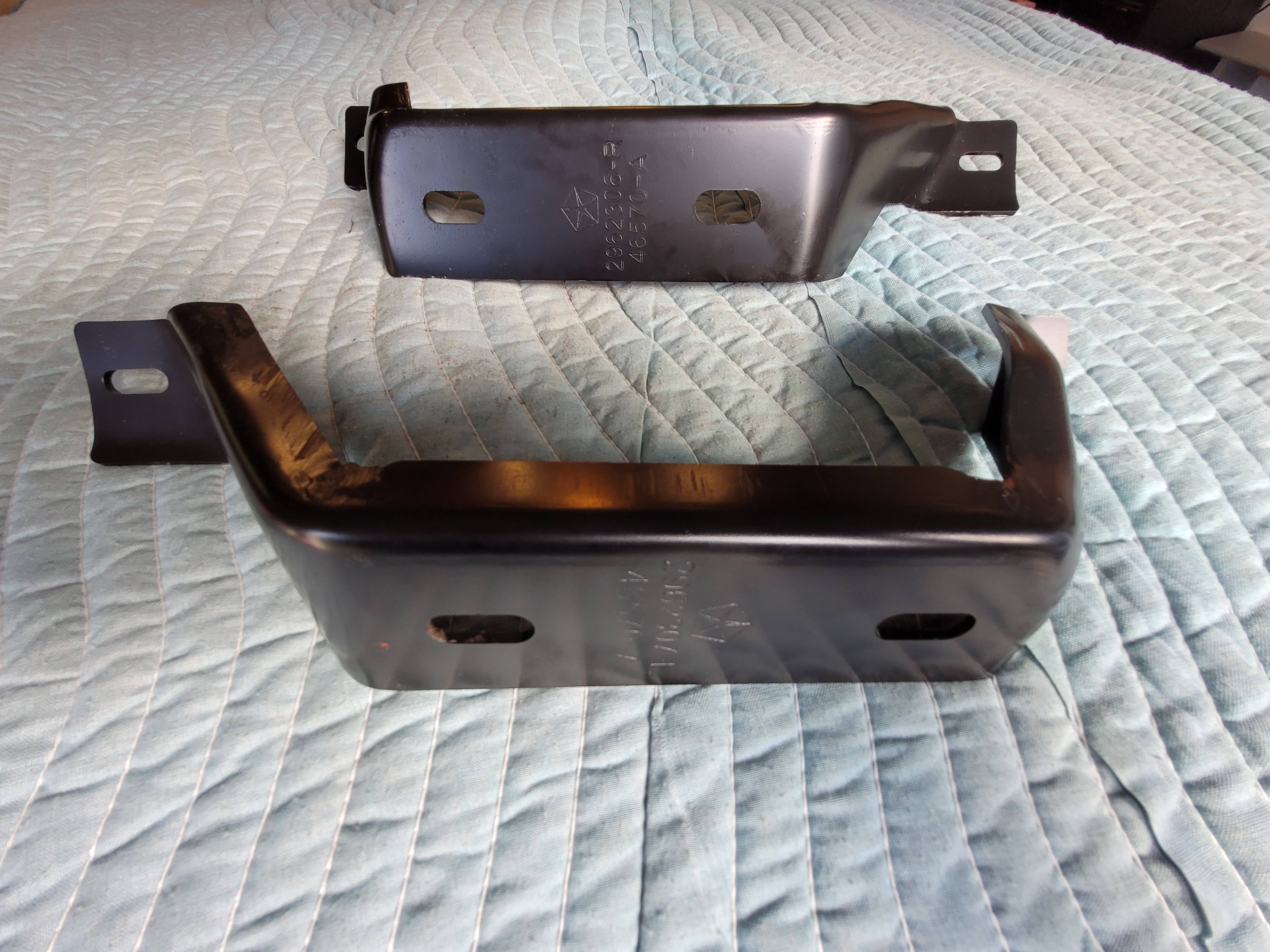

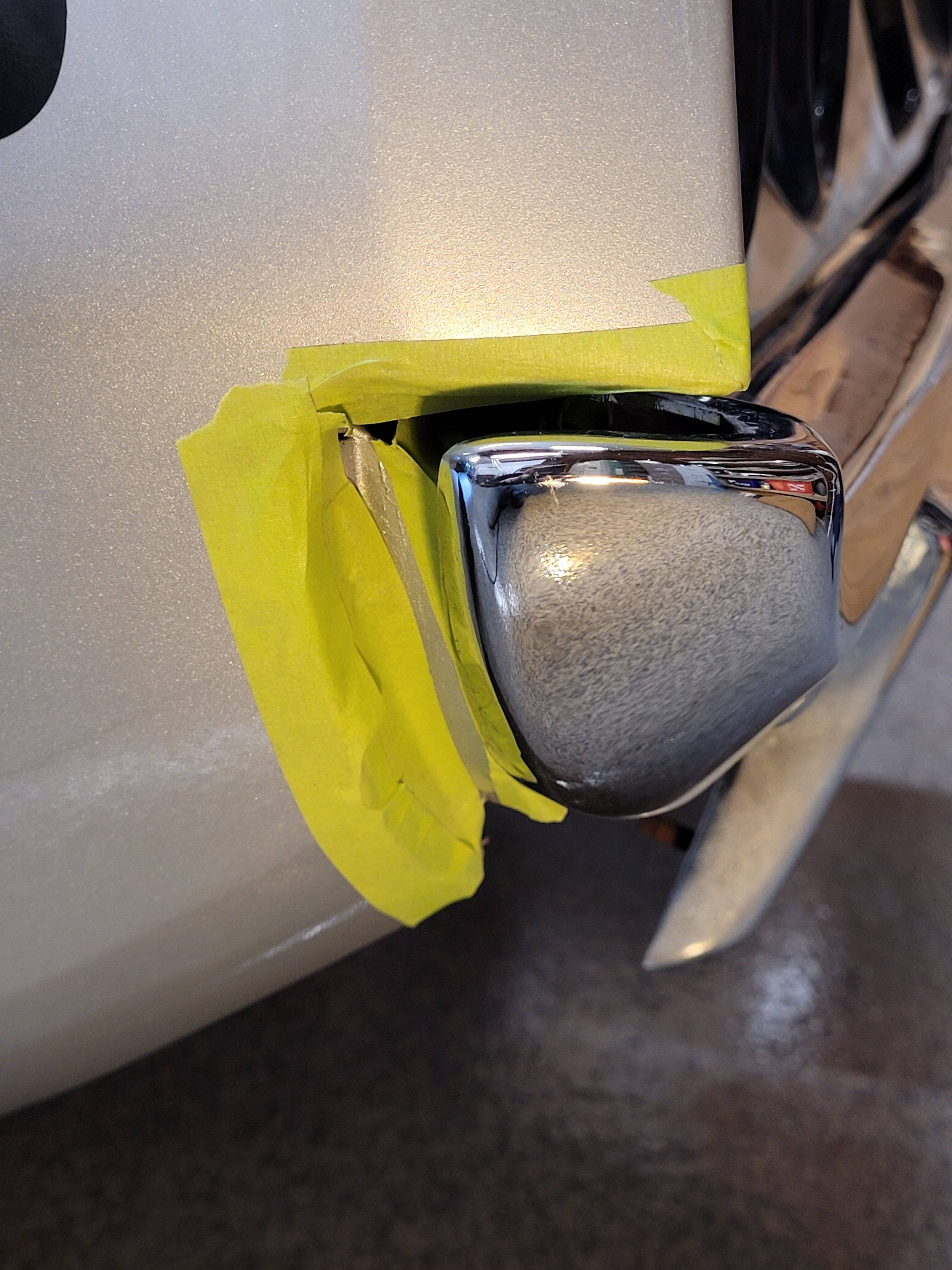

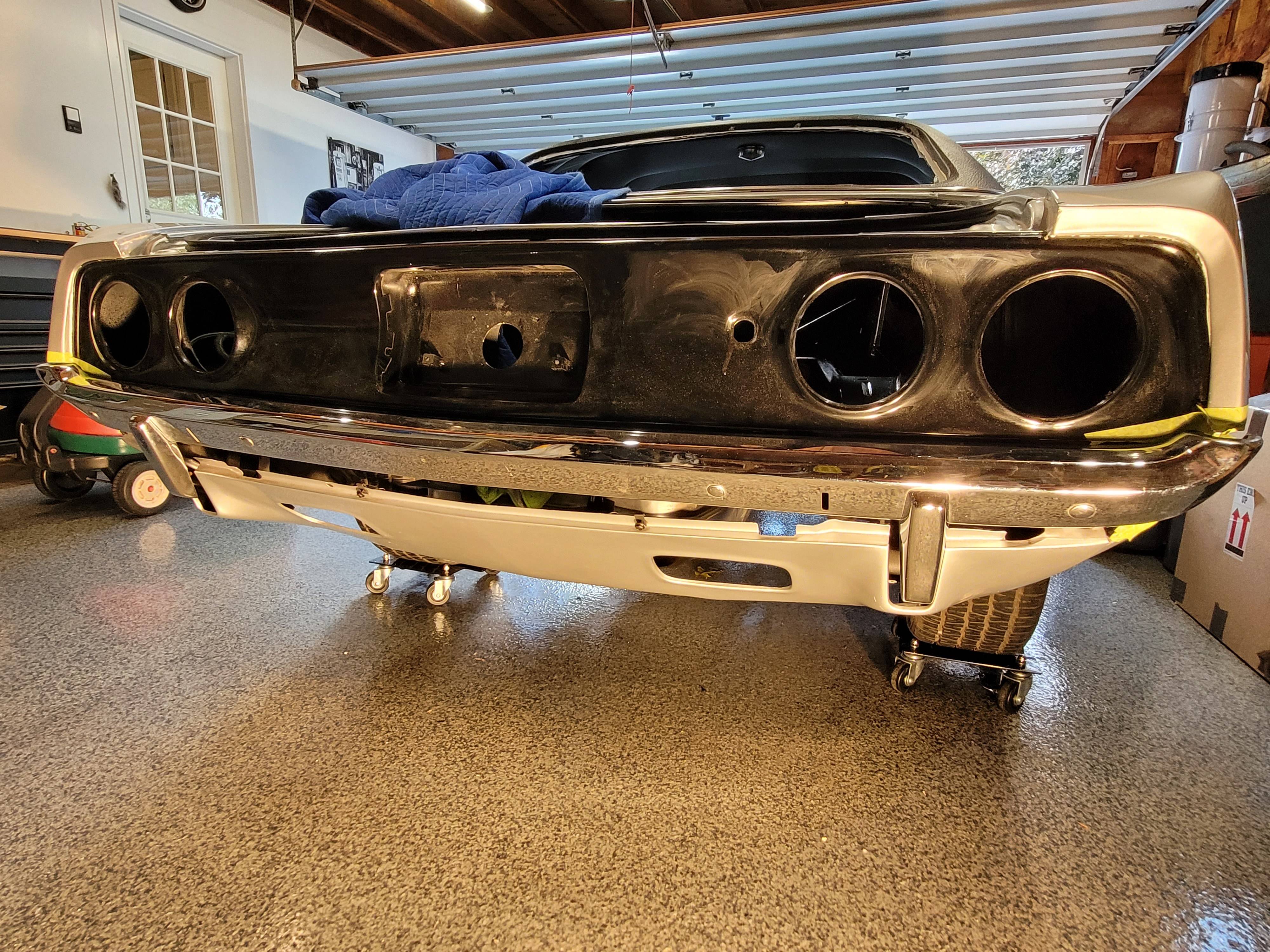

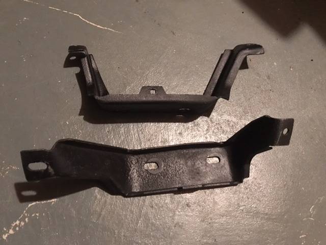

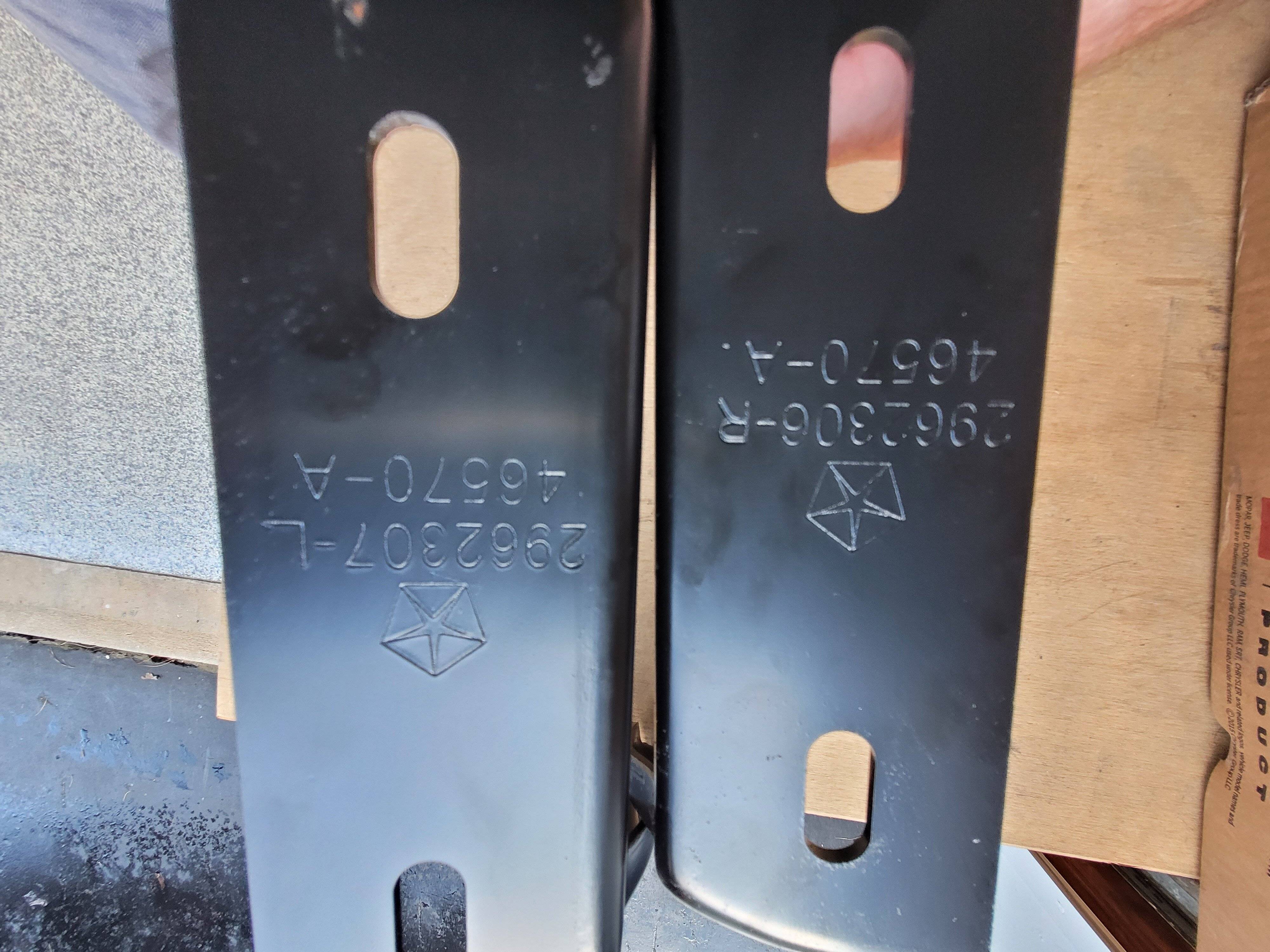

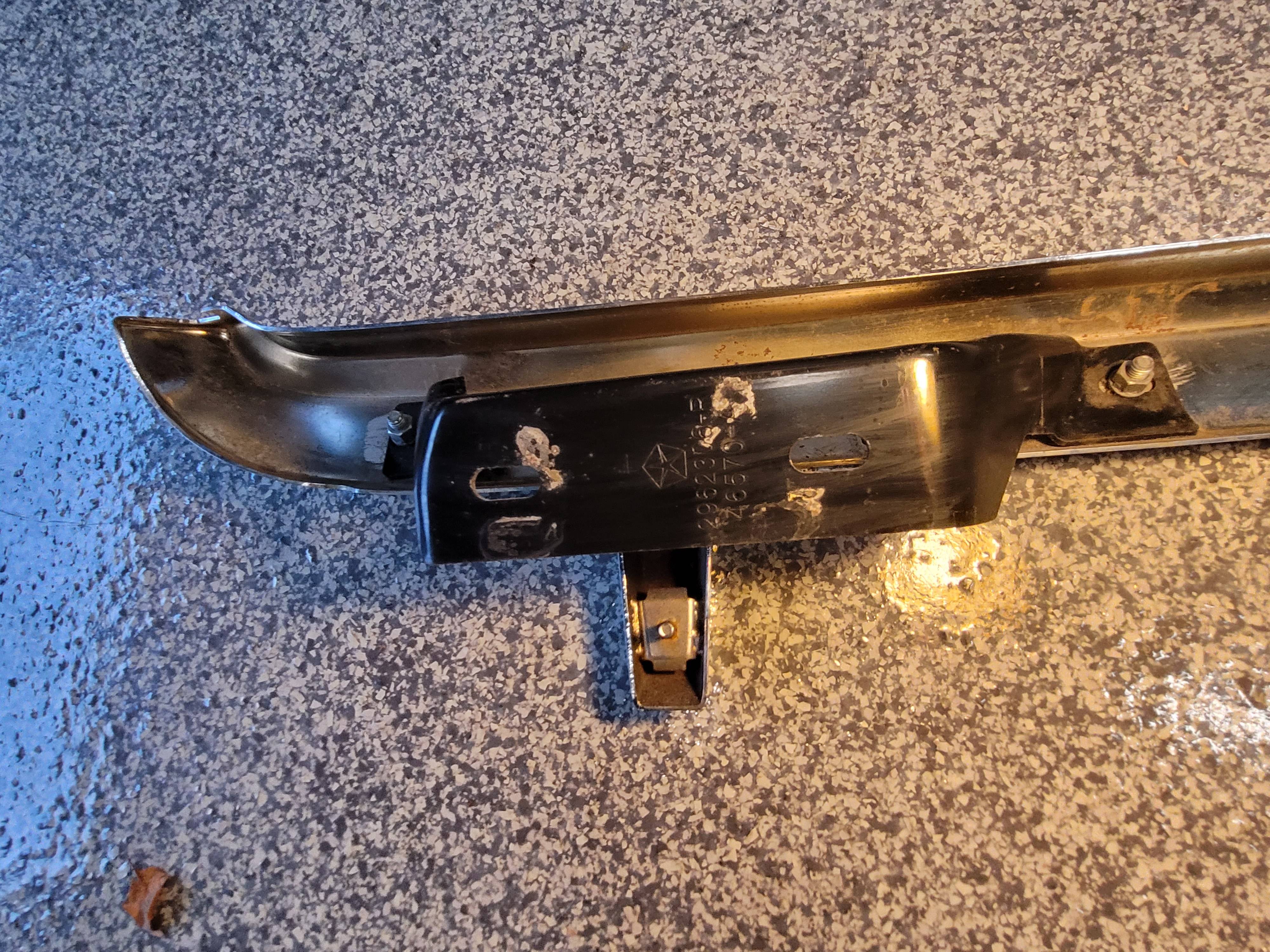

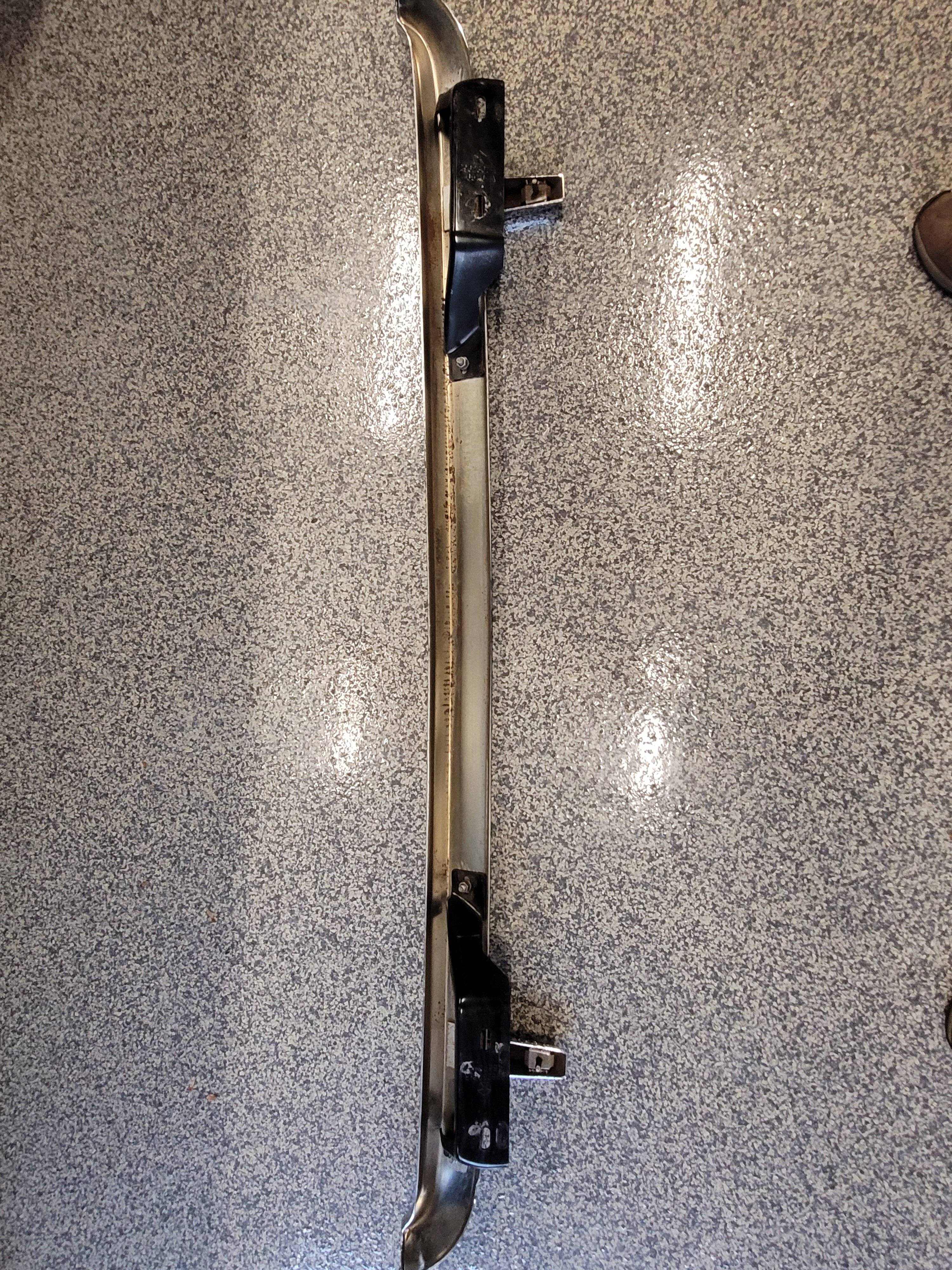

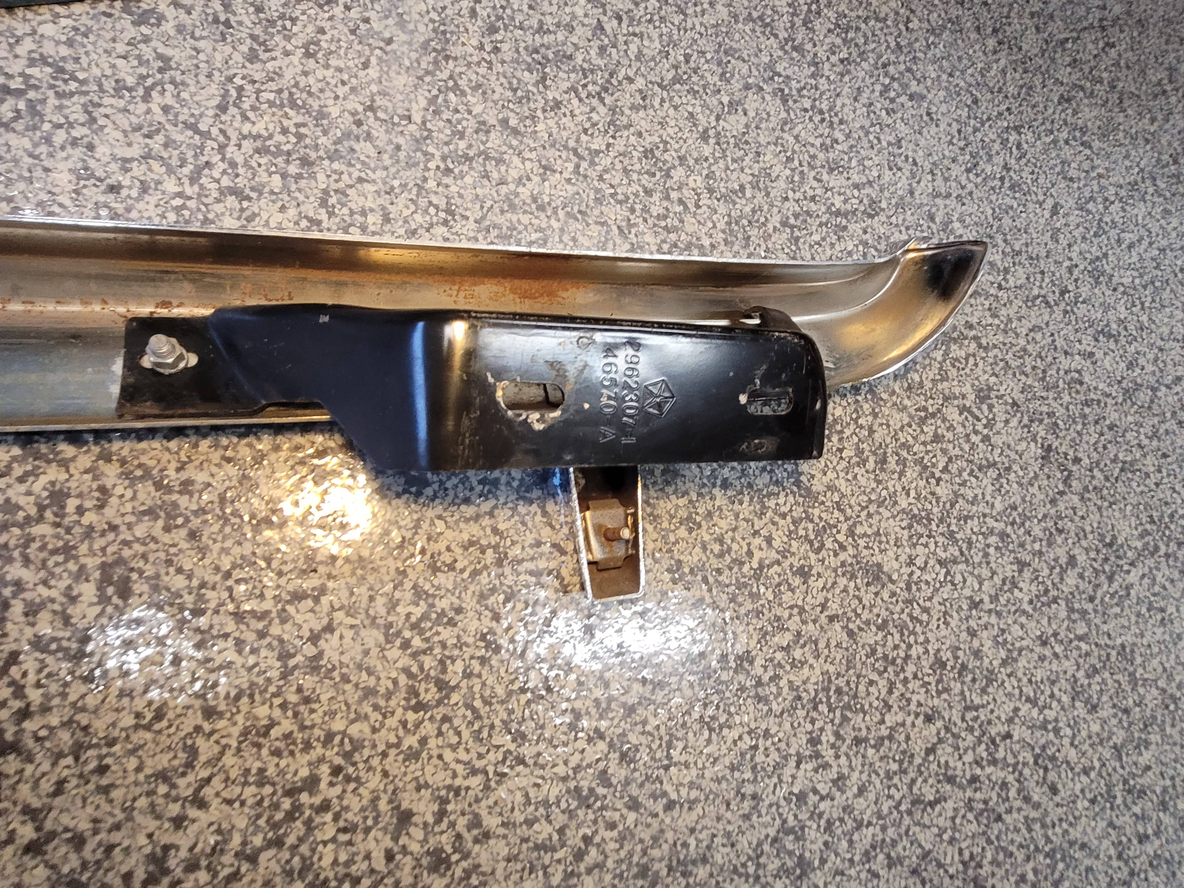

I bought a '71-'72 Rear Bumper with Slots and what I thought were '70-'72 Rear Bumper Brackets. As you can see by the pictures I've posted, the Bumper won't get any closer to the body and I have large gaps, and there's also a lot of space between the Bumper and dual exhaust Rear Valance.
The Rear Bumper Brackets I purchased a while back, and tried to install, are Mopar PN 2962306R and 307L. According to "moparman31" microfiche research info above, these appeared to be incorrect Brackets (Challenger) and should actually be PN 2768604R and 605L Brackets (Cuda).
I contacted AMD to see if they could cross reference their PN 970-1570-S '70-'72 Brackets with the Mopar PN and of course they claimed they could not? I placed another order for a set of Cuda '70-'72 Brackets but rec'd the exact same Brackets I already had??

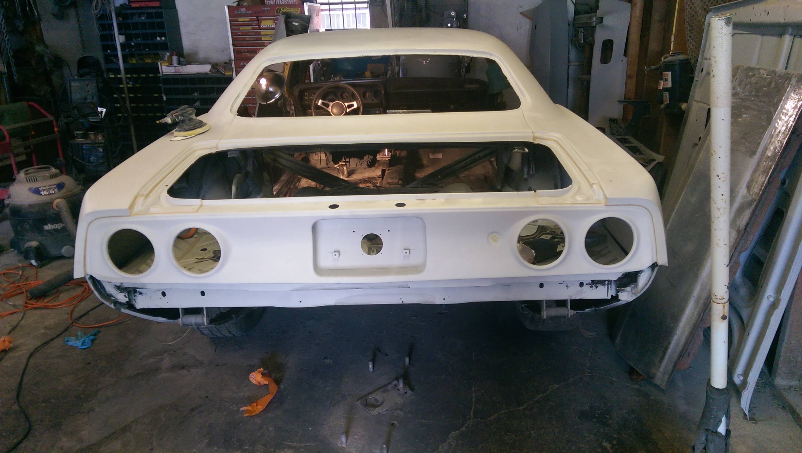

The car did have a fair amount of body work done at a shop, with a lot of my own help, which included new Rear Quarters and Tail Panel, but the Rear Crossmember was never replaced.
Does anyone have any ideas on what the issue might be?
Thank you.
