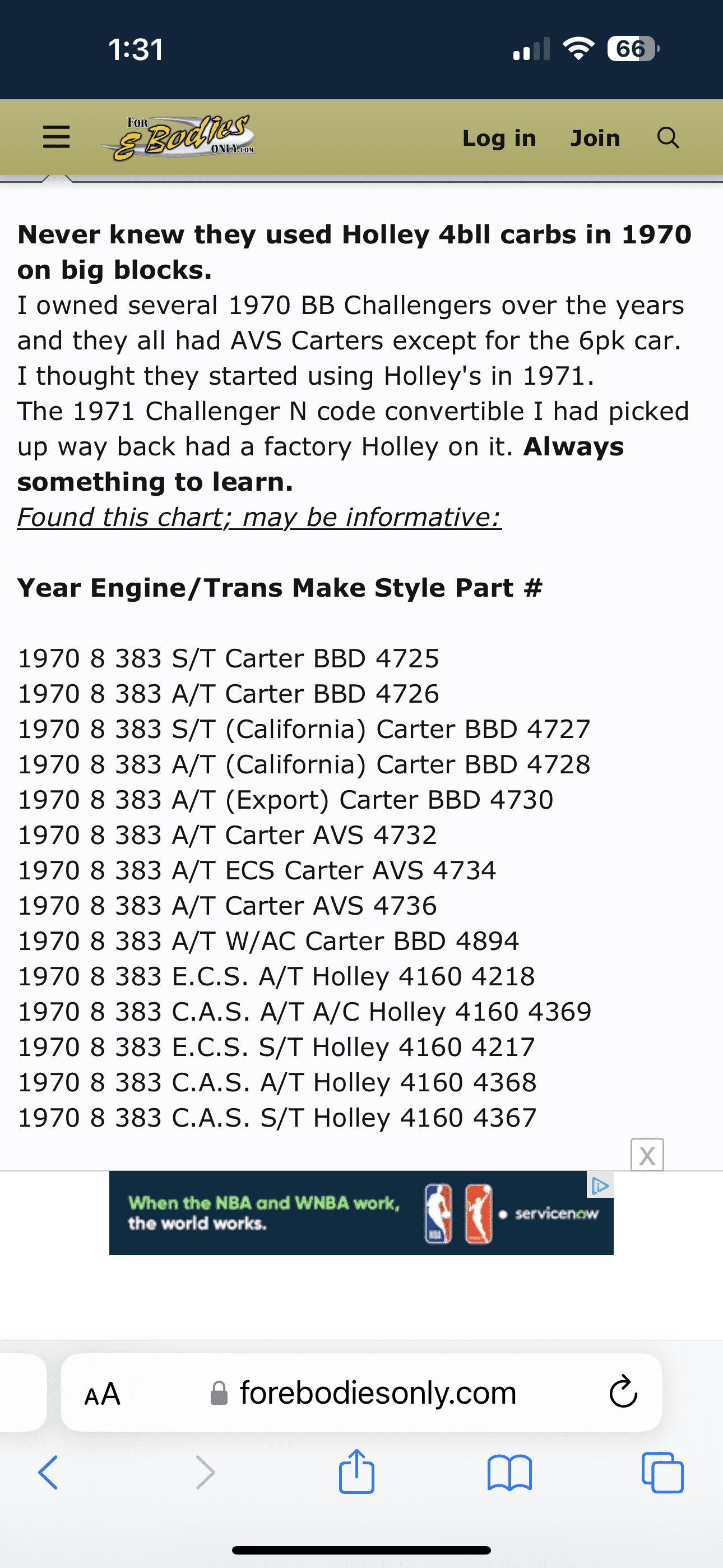

Hello… I am new to FEBO and just posted on the Welcome Wagon.
I was hoping I could get some help determining the correct factory carb for my 1970 Challenger R/T Conv. 4 spd car with no A/C and built in Hamtrack (JS27N0B). It is a numbers matching car with the exception of the carb. I received the car in the late 1990s with a Carter AVS 4966S on it which has run well go the limited miles driven but I would really like to put the original carb back on. After my research, I could only find the Carter BBD 4725 listed for my 383 and then the 4737 for the 440 4spd. Can anyone confirm the correct carb? Thanks. John

For 1970 383s, Carters were only used on the blue engines. JH/BH cars. Orange engine 383s - JS/BS - came with Holleys originally. So for a 383 magnum with a 4-speed you need the one a little further down the list, the Holley 4367.

ECS stands for Evaporative Control System, which basically means N95 California Emissions. For a stock 383 the 625cfm Street Demon should be fine. The original Holleys were right around 600 cfm if I'm not mistaken.

That's a decent price for a 4368, and the minor differences between the 4368 and 4367 are in the metering block, if I'm not mistaken, so not seen. It should work fine on your car but then again if you're looking for the right # carb for your car then it just isn't it.
Tony's looks to have a true 4367 but of course they tend to be more expensive because they're harder to find.
