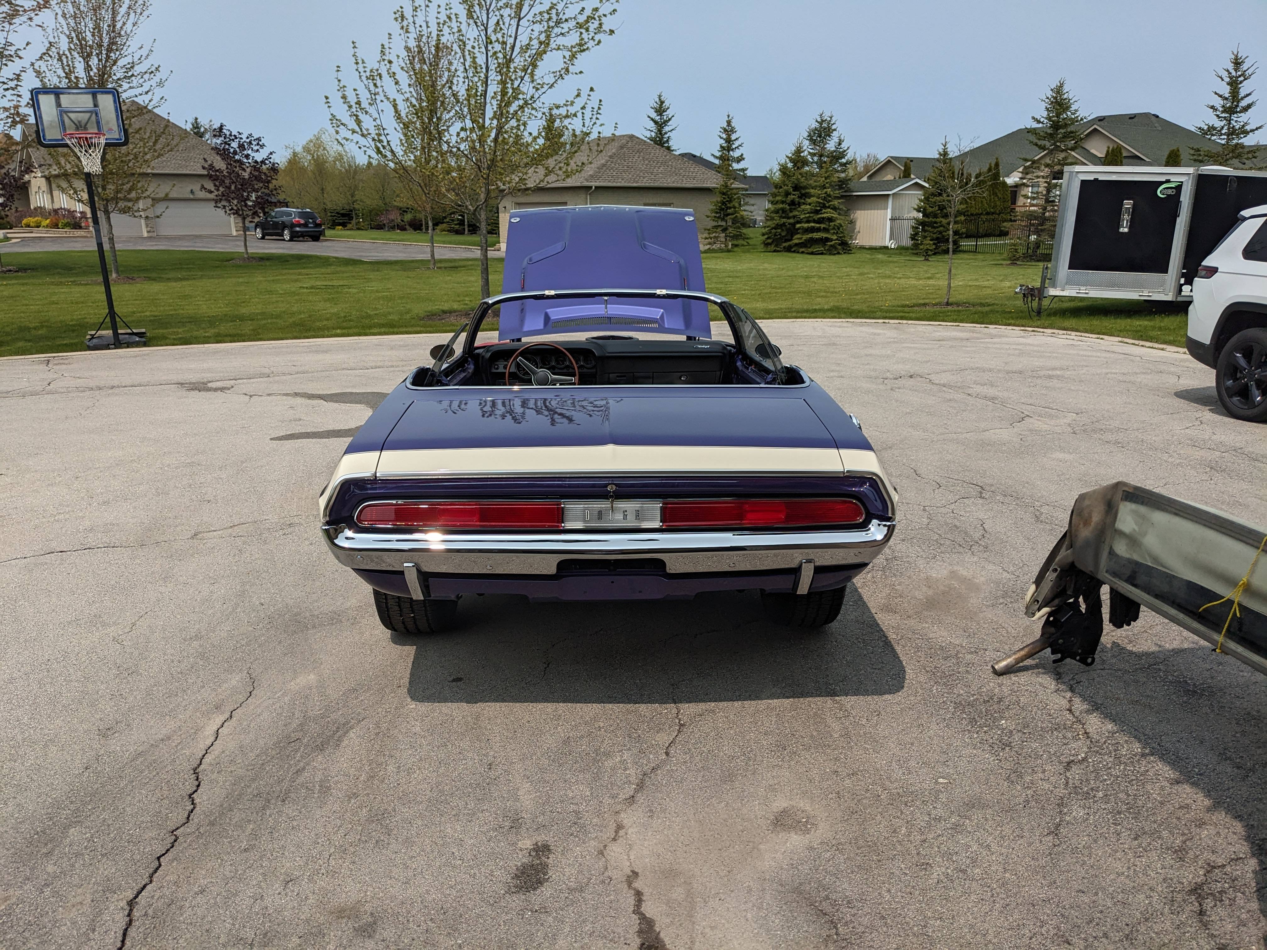

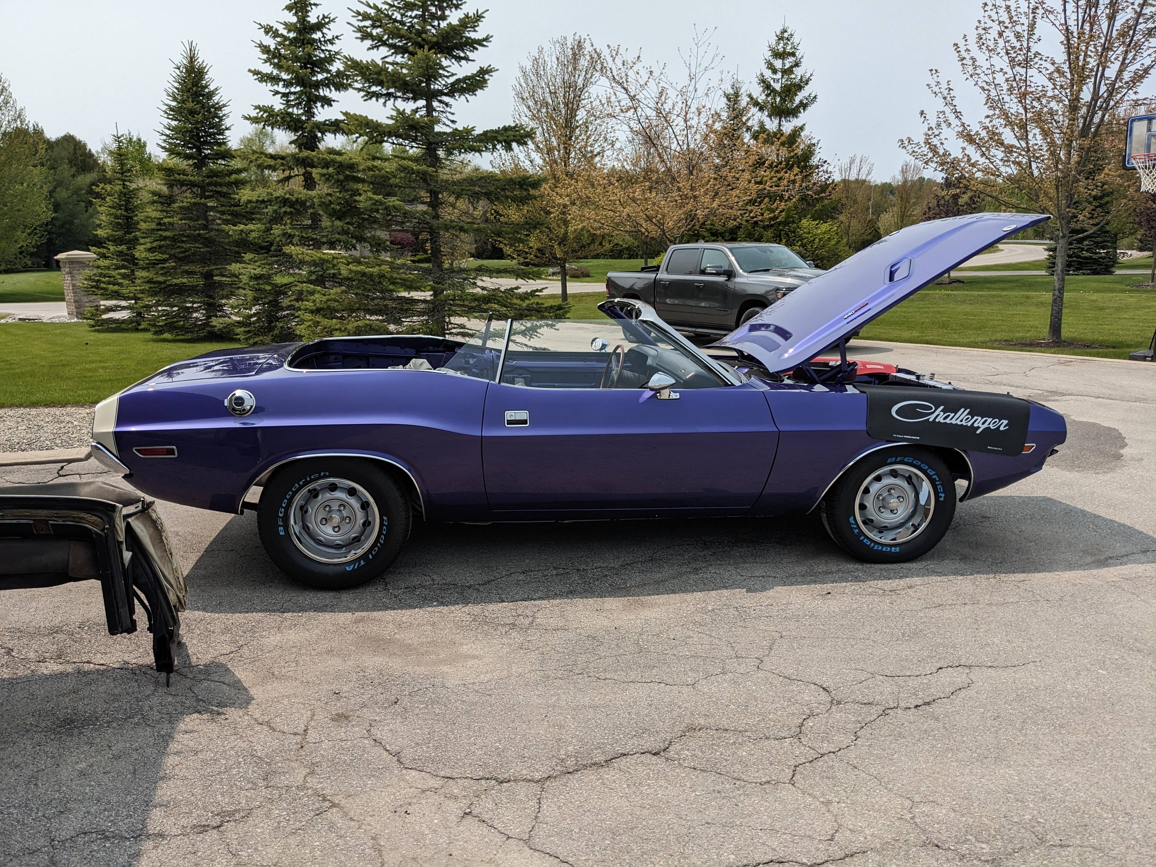

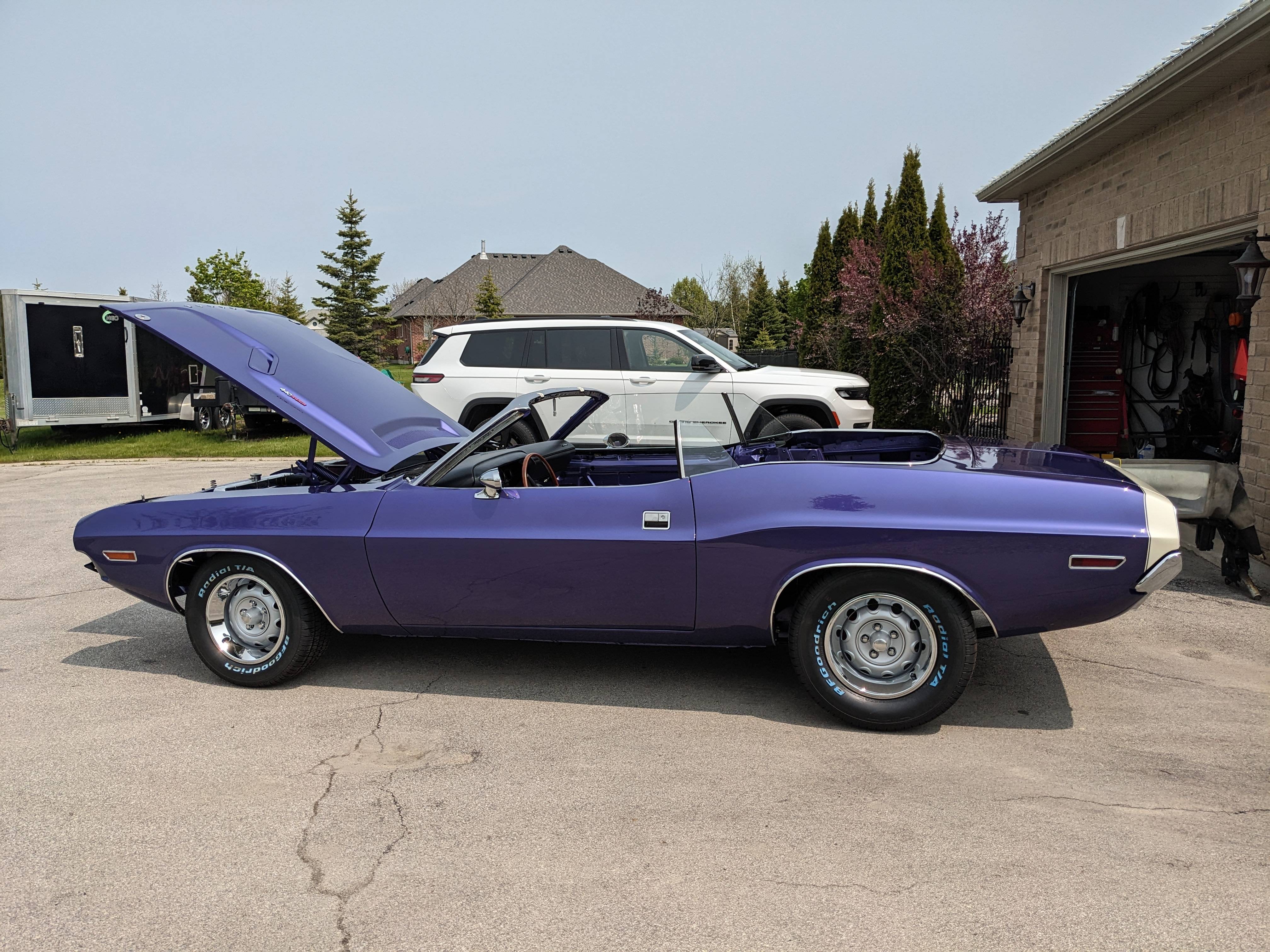

This is my baby that I've been working on for a very long time. I'm new to the site, has anyone ever changed a power regulator spring without removing the regulator from the door?? Any info would be great.

Welcome to the forum. Nice looking ride.
