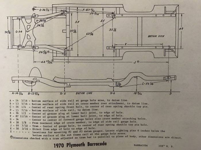

Does anybody have the frame specs for a 1970 Challenger? Exactly like the barracuda specs posted below. I have the alignment specs for a 1970 Challenger but I need the frame specs exactly like the barracudas Except for a 1970 Challenger. I am building a frame/body/datum jig. I need to know once I have the car sitting on all four center points on the frame jig what is the height from the front and rear supports coming from the jig to the bottom side rail of the frame.
Thank you
