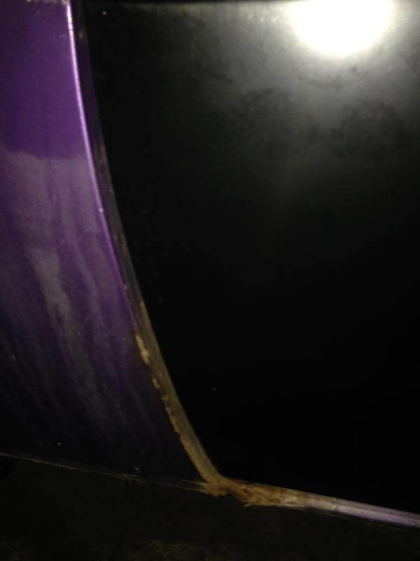

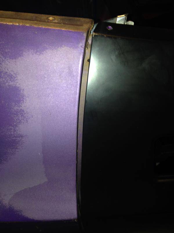

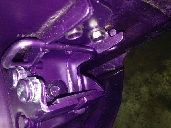

Undo the lower hinge where it connects to the door and pull the door out a little until it lines up. You may have to loosen the upper hinge. If you have to lossen the top, lossen it just so it is enough to move the door. By the pics, you really need to loosen everything and start over. Your gap is too large. Go to Home Depot, Lowes, Ace Hardware, or equivilant and get the plastic shims that are used to shim cabinets, door frames, etc. Get the ones that are wedges. Get plastic. They slide out of the jamb easier than wood and don't distort under the doors weight. When you loosen the door hinges, put the shims in around the door to gap it where you want it. Then you can tighten a few bolts and remove the shims to see if that is where you want the door. If not; adjust again. The striker adjusts also and changes where the door sits when it is closed.  Ues the correct star tool to adjust it.  If you use vice grips, they flatten the striker edge and can damage the way it functions.  It can become misshappen and cause door drag when you open the door.
