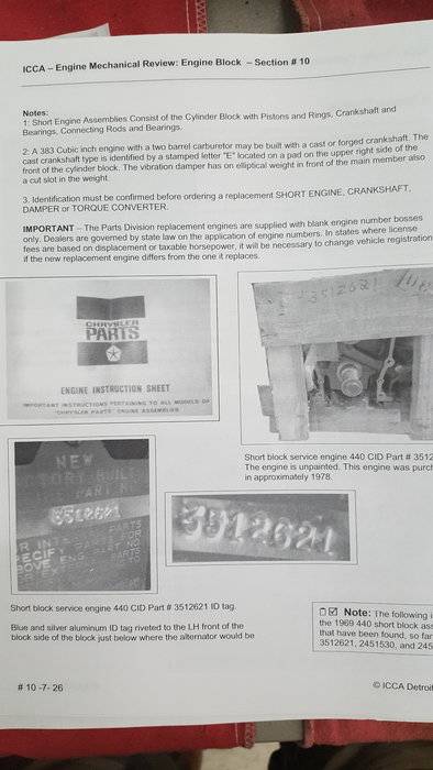

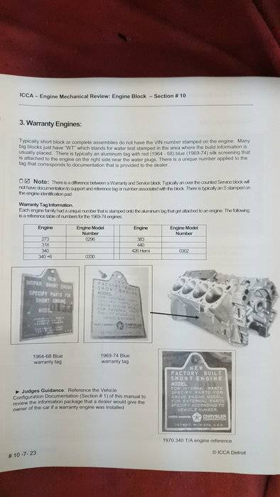

Lately I have been looking for a 70-71 Challenger R/T that is #'s matching. Read in the Challenger & Barracuda Restoration Guide the following: " You may also find the upper engine pad blank, which indicates that the original engine was replaced under warranty. Warranty engines usually have a tag riveted to the block just above the freeze plug." This is on page 12-13. Last week I backed out of a 70-71 Challenger R/T auction because of fraud being committed...I was high- bidder and reported it and was allowed to retract my bid. The Challenger was removed from the auction site.

If it has no VIN, to be a real "warranty" block for this car it would have to have paperwork saying so. Without this proof, it is just a "warranty" block or an "over-the-counter" replacement block (or faked block) that could be from any car. I would highly doubt a Jan 7, 1969 assembled block would be in a 1970 (especially if car SPD is in 70).
-Just to be sure, the casting number should be 2468130. What is the casting date?
-The top pad stamp numbers lacking an "S" (or "E"), and with a "69"? Could have been stamped by a dealer during replacement. But on 383s it is easy to deck the stamp pad because of location.
-When you say "no VIN plate" are you talking about the boss milled on the lower passenger side of the block is blank? And no VIN stamp where the transmission bolts up (for later 68s)?

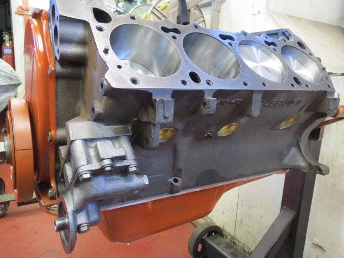

I'd look for the casting date next, here's my '71 383 and you see I just behind the engine mount on the driver's side.
