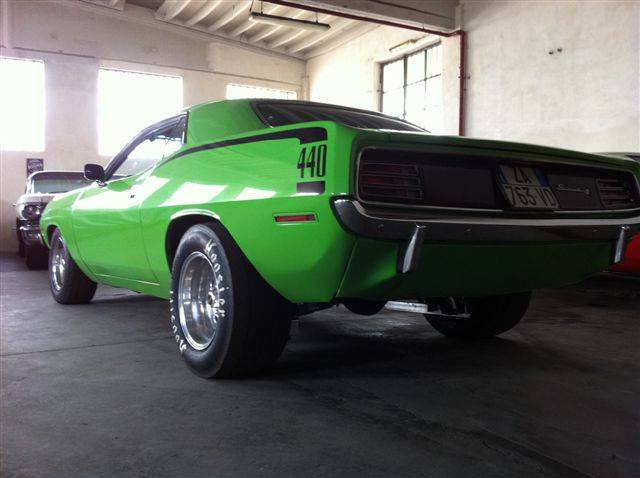

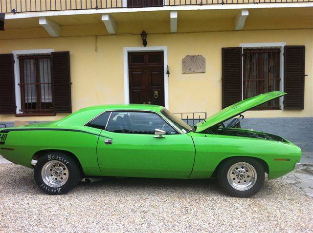

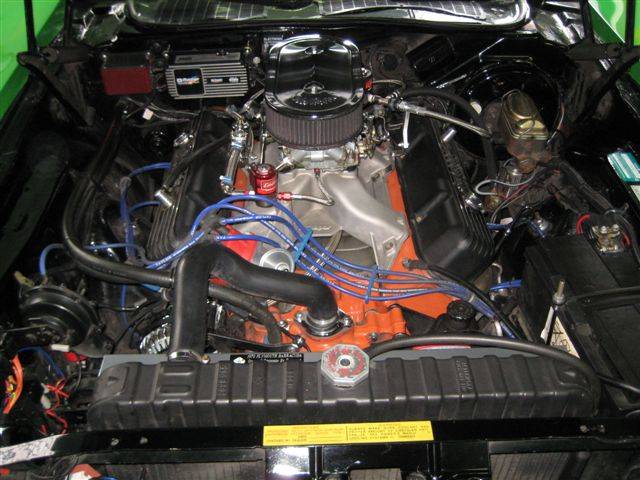

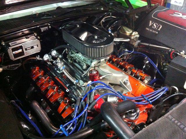

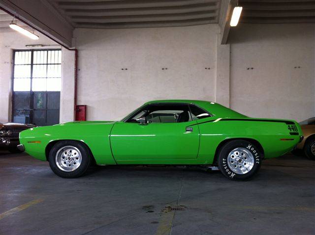

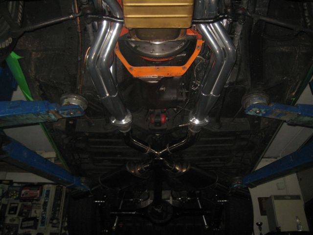

hello ! Thanks for your post ..i have converted the transmission from 4 speed to automatic 727 .. With 5000 converter and all billet drum and manual valve body reverse pattern , same caltracs adjust ..same engine specs .. Et dropped at 10,52@135 1,56 60 ft !! No nitrous because the nitrous holley pump give me a problem .. Very hot hot and fuel pressure dropped low .. Now im looking for A2000 pump ..generally you need a soft setting on the shocks so weight will transfer start with 4 clicks from lightest so you are set close . As for the Caltracs I only worked with one car that had them , it ran 11.72 before the caltracs & the best we could get was 1.72 60" with them no matter where it was adjusted . I have found ladderbars with floaters far more effective , my street car ran 1.42 -1.38 with the front wheels over 2' up.
