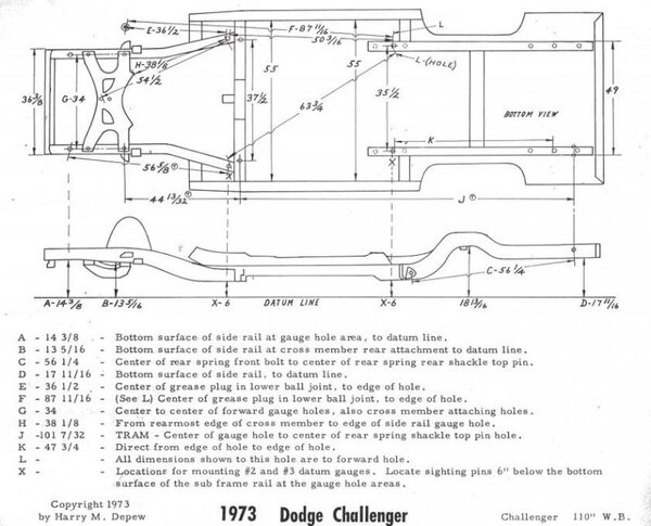

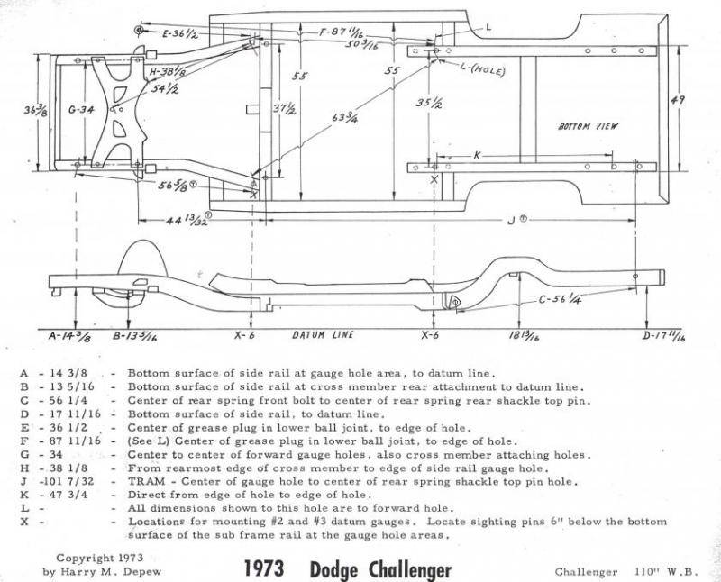

Jul 17, 2015 #1 V VRSCD Member Joined May 13, 2015 Messages 11 Reaction score 0 Location VA beach 1970 dodge challenger hi all is any one that can get me copy of the 1970 dodge challenger frame and Body measurements thanks smile emoticon

Aug 7, 2015 #2 H hemitwist Member Joined Nov 1, 2014 Messages 9 Reaction score 0 Location Florida Side measurements up and down or complete underside front and rear or just front, rear?
Aug 7, 2015 #3 J js29 Well-Known Member Joined Aug 5, 2012 Messages 671 Reaction score 152 Location lee center ny 13363 I just saw them on e-bay for less then ten dollars.
Aug 7, 2015 #4 moparleo Well-Known Member Joined Oct 17, 2011 Messages 7,333 Reaction score 2,128 Location So. Cal. Riverside area Moreno Valley Does this help?
