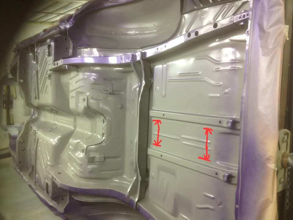

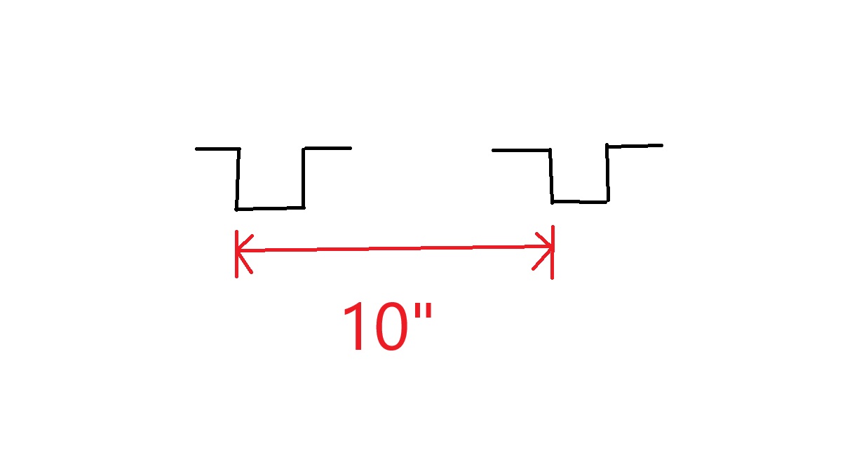

Looking for dimensions for where to put the trunk floor supports off of the frame rails (front and rear measurements) or distance between them if they are centered from the fuel filler hole? Are they parallel or do they taper in or out at all? Any help would be appreciated. Thanks
BTekulve
May 14, 2025
4
6
United States, Indiana
This image is not my car, but shows what measurements I am in need of.

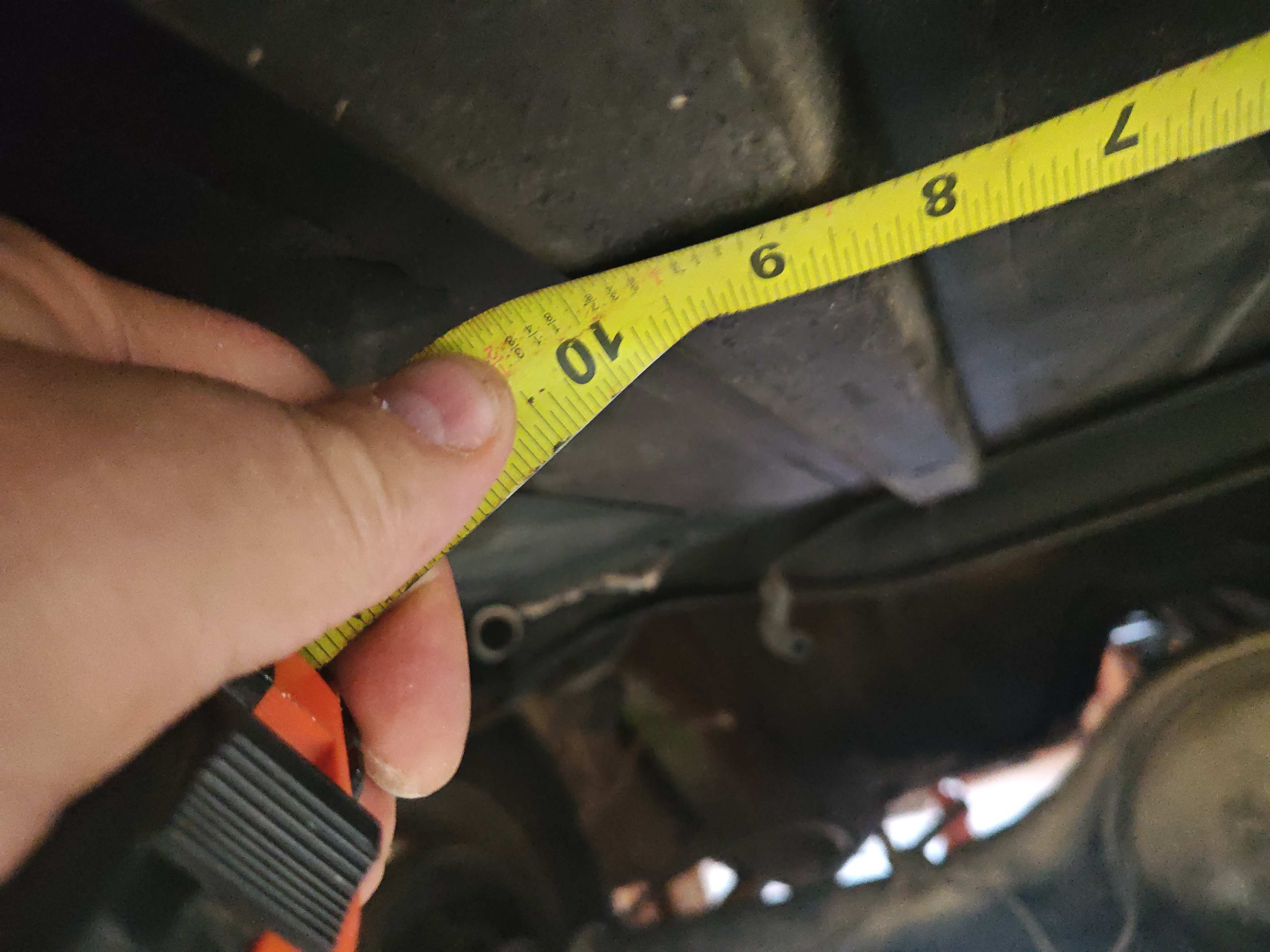

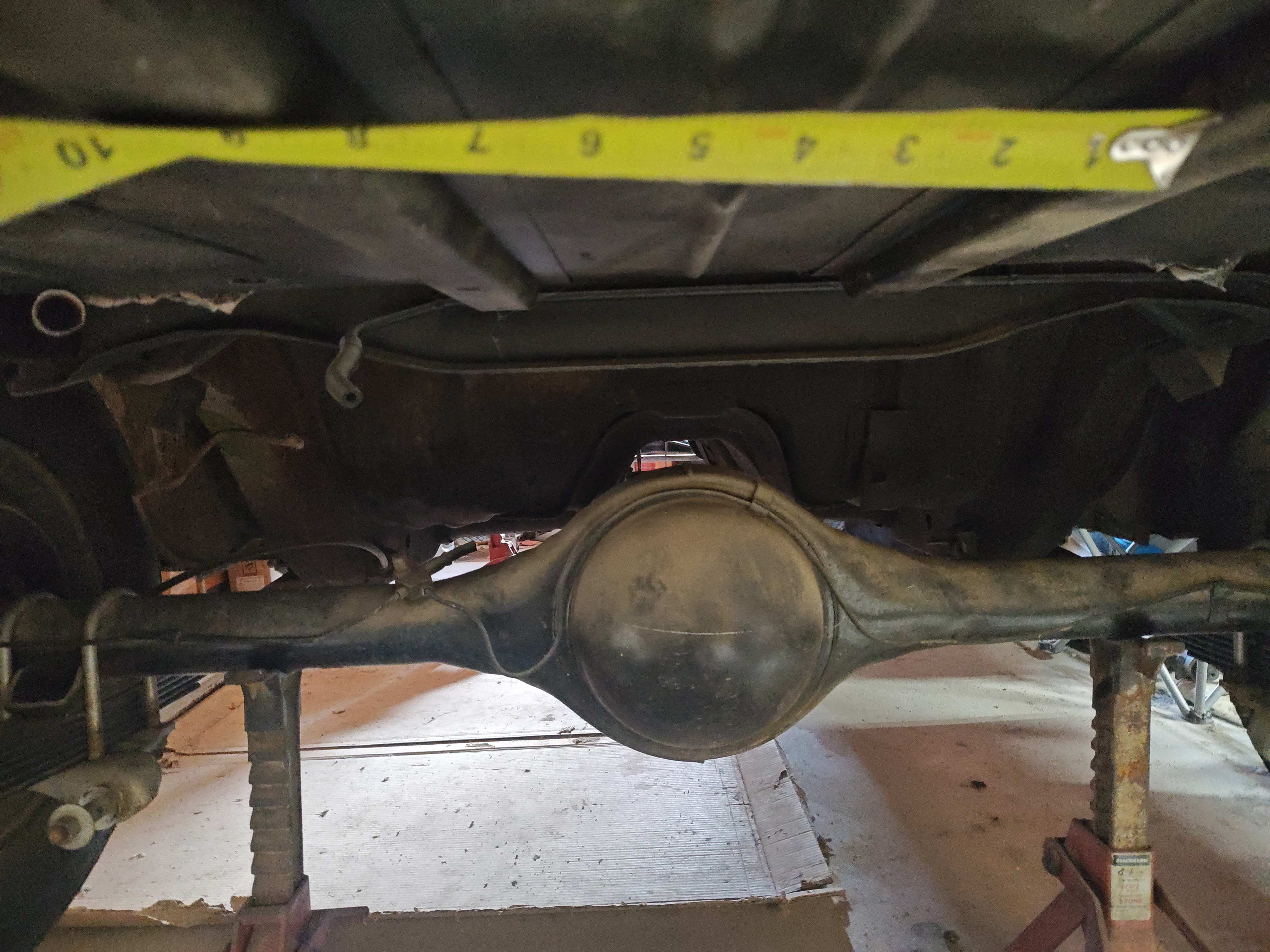

If you would measure the gas tank where the straps go. It would be the same. Center of straps. The gas tank hangs from there. That's what I thought you meant but a picture explains a lot.

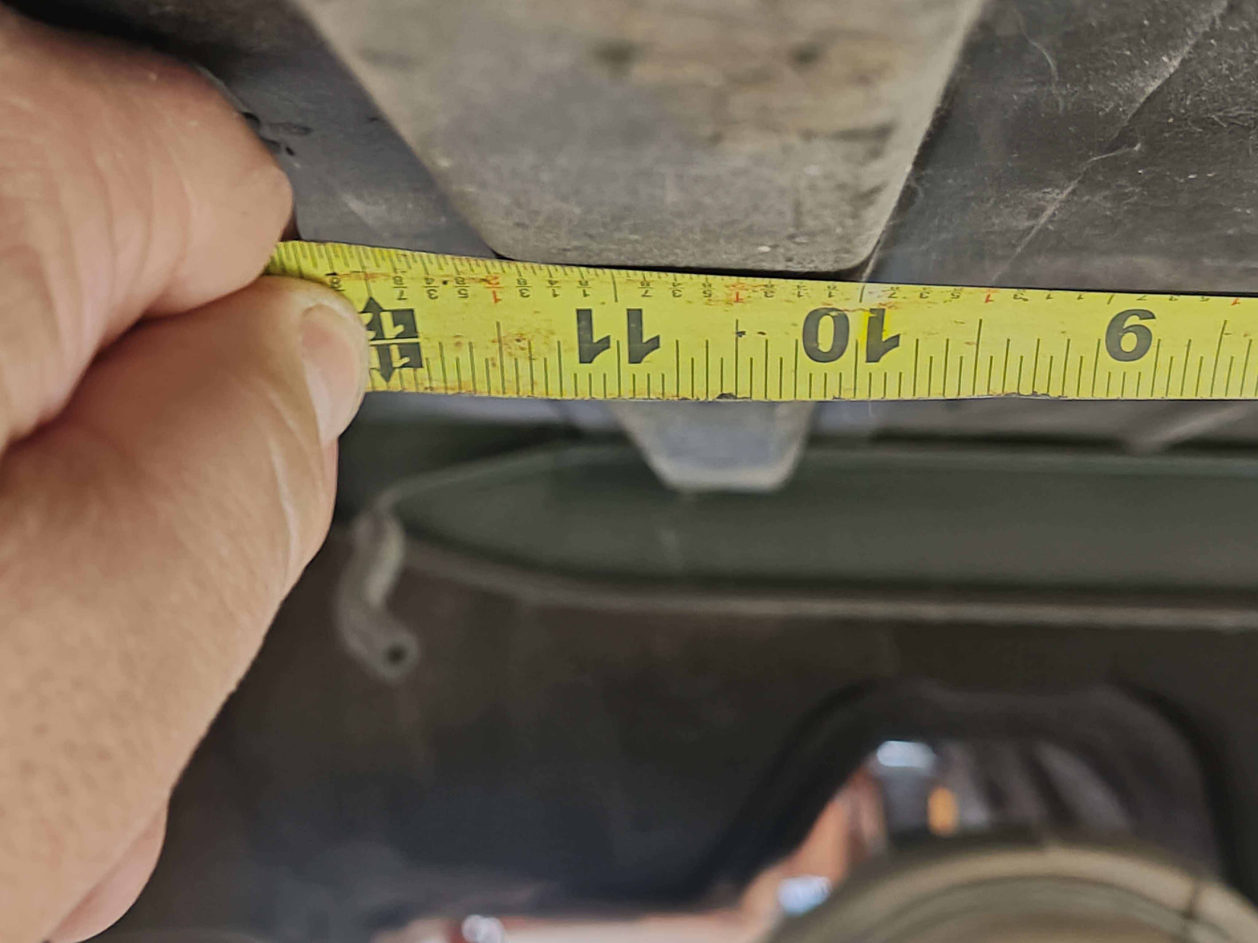

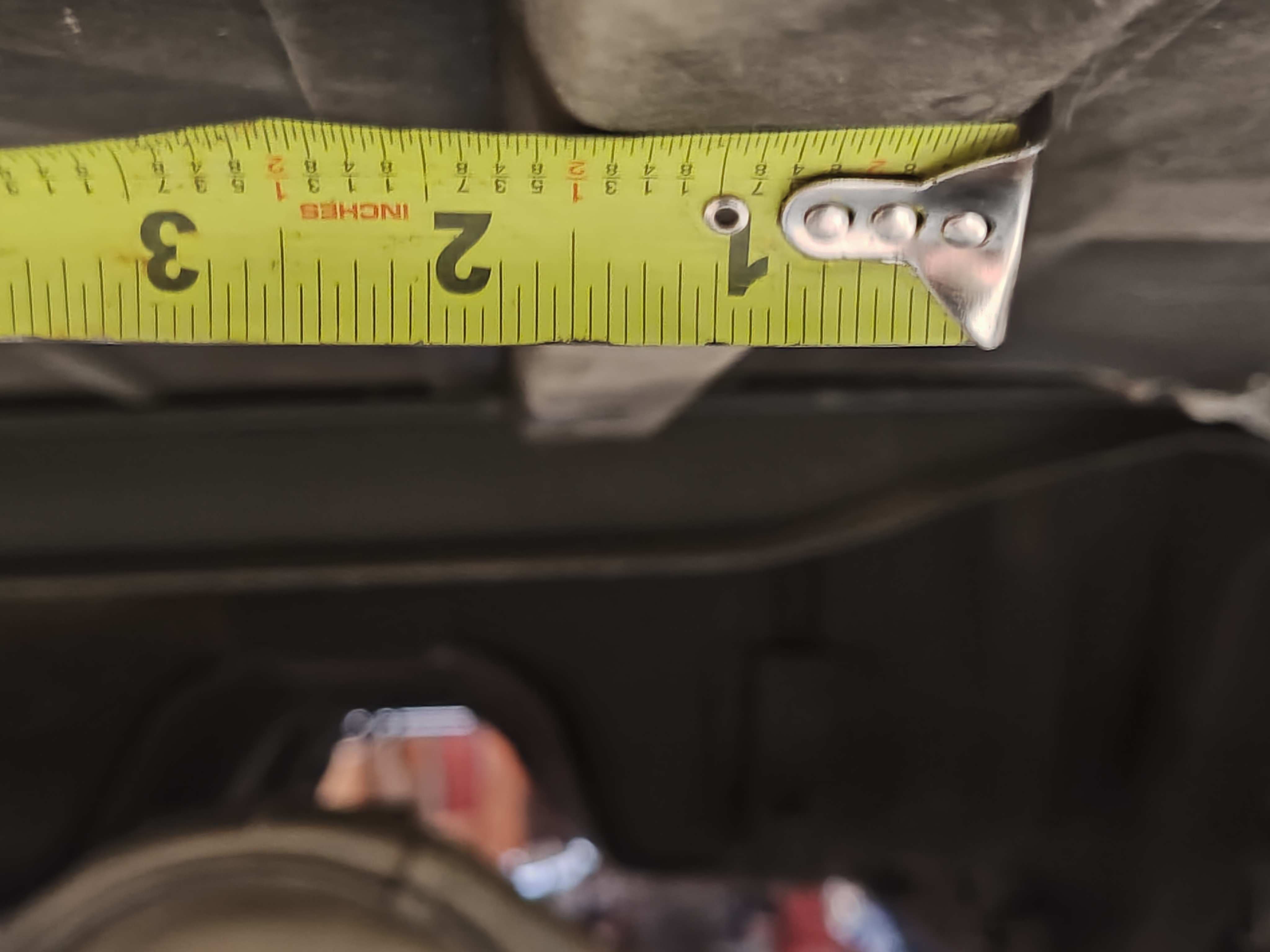

Thanks for the measurements, that's is exactly what I was looking for.

It was hard holding the tape measure with one had and take a photo with my cell phone in the other hand. 🙂

Just wanted to make sure you didn't need another picture or measurement.
