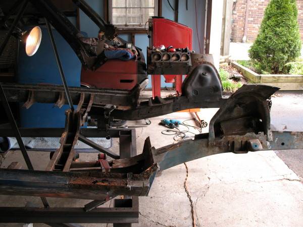

I would build a jig to hold the car in place and together, take a lot of measurements and pics before you
start cutting it apart. Mine had a lot of rust and was hit in the passenger side. Had to replace the passenger side frame rail as well. Hope this helps

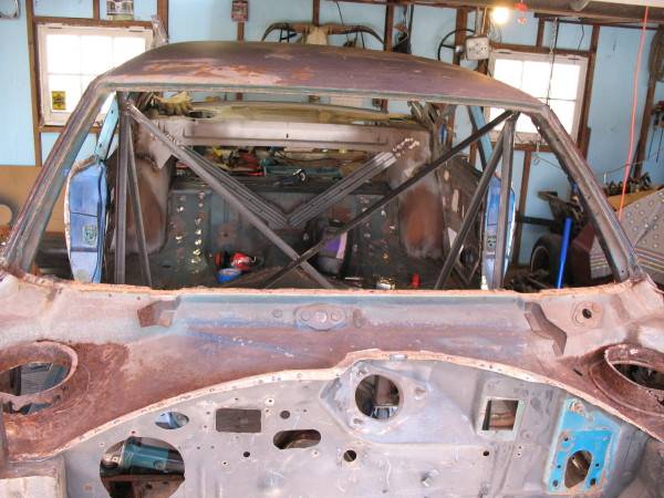

That's the only way to do it! I used more falsework when I cut out and replaced the cowl, firewall and A-pillars on my RR. When I completed the last cut to free up the cowl section from the base of the windshield pillar I could feel the tension that the unibody was under and I was glad I added all the crossbracing.
