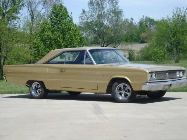

So originally I decided I was just gonna do what I did when I painted my Coronet... Keep the K-Member and all that on... Decided this would definitely be worth building a rotisserie over, and thats exactly what I did. More pictures to come!!!
Coronet Restoration

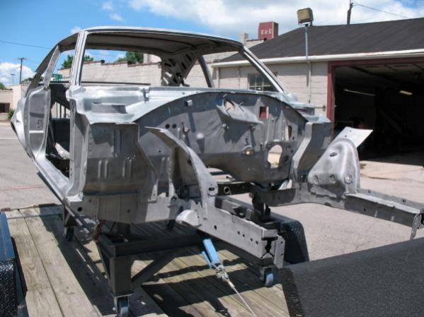

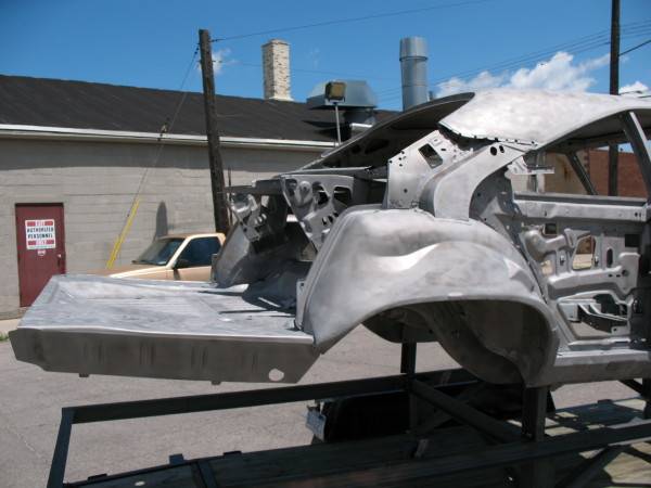

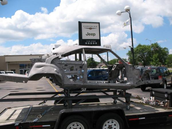

I suppose so... Just if I could afford it, way too expensive... Are you gonna media blast outta your garage or have someone else to do it? Outta curiousity, how much does it cost to have the chassis blasted? If ya don't mind me askin'
I pay to have it done and have a guy that I take all my stuff to. I had my `68 Road Runner stripped apart not quite as far as you do and it was on a body dolly that I made up. He charged me about a thousand to do the whole car including fenders, doors, dash, Engine k member, but not hood or trunk lid. Now is the perfect time for you to do it as it looks like you have stripped all of the rusty metal off. If it was just the chassis being blasted for now my guy would probably do it for around $700. I had already replaced alot of what you see in these pics, including the rear clip and the A-pillar and cowl assembly before getting it blasted. One thing I could never do is pay to media blast a bunch of rusty metal you're just going to replace anyway. Let me know if you want to check out the resto thread over on FBBO and I'll post a link to it.

i blast for the hod rod shop,, a FULL car, is about 1200-1500,, just the body, no roof, about 500-700, just depends on if your removed all the floors, or what gets blasted, and if its rolling or on a rack. ,, $100-125 / hour, :toothy2:ps its NOT a fun job!!

$100-125 and hour is cheap 68427vette, but, I've told you this before too!
Donny
May 6, 2015
65
16
San Antonio
And Matt got a good price for that especially factoring in the Doors and Fenders. With me, I go over the Fenders first by hand, removing as much of the 'gunk' as possible before blasting -- makes the blasting go so much faster, etc.
