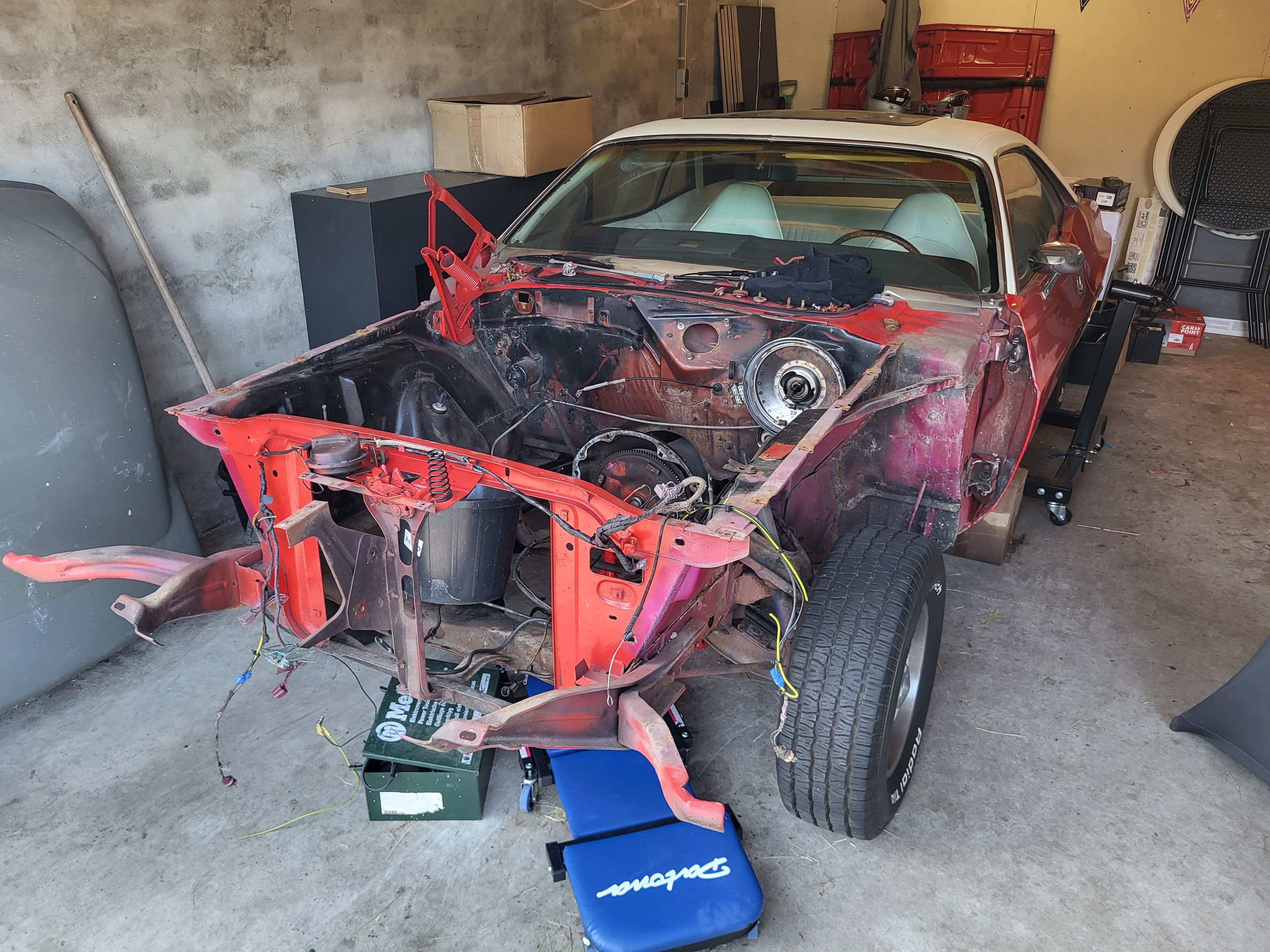

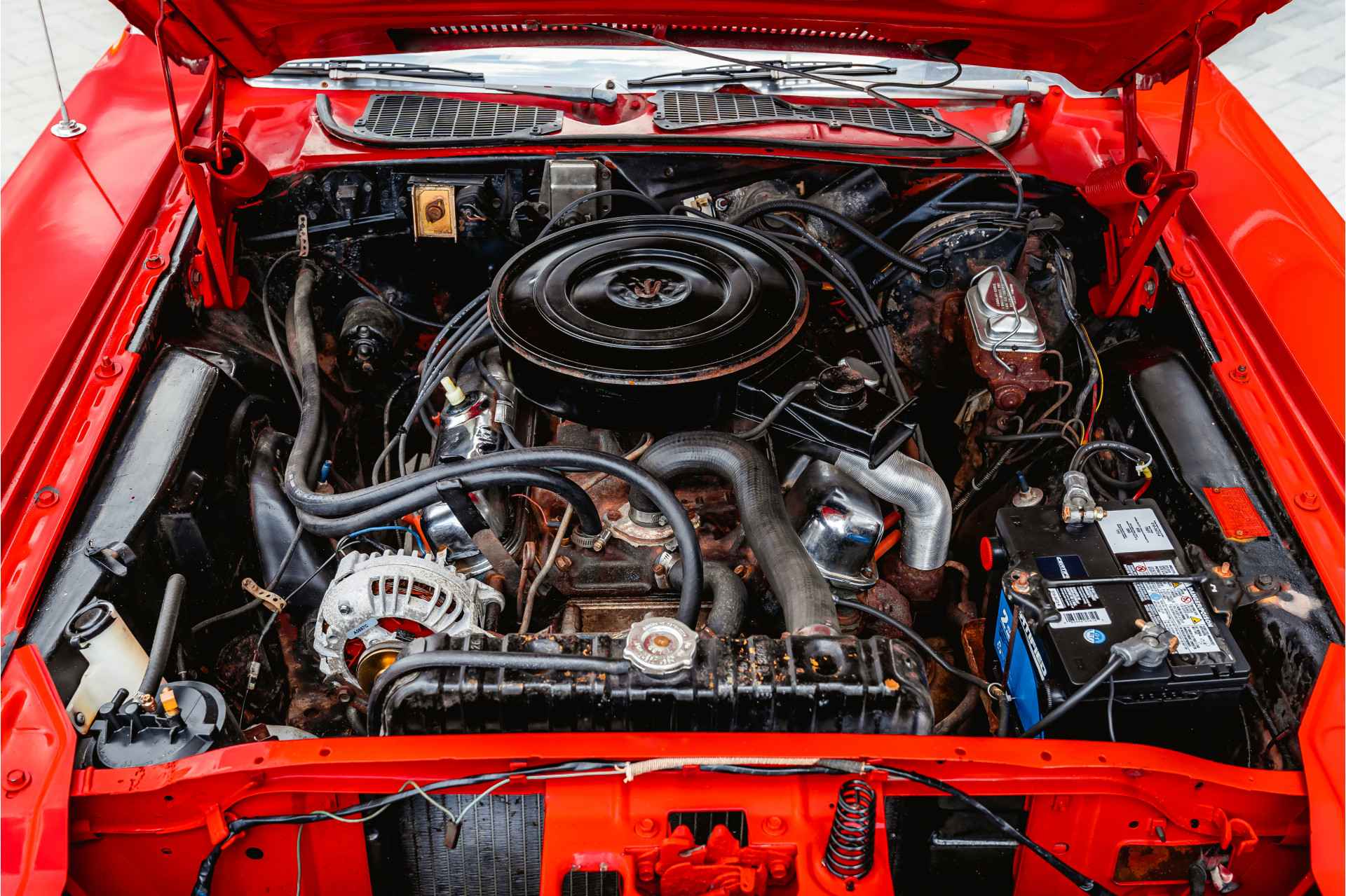

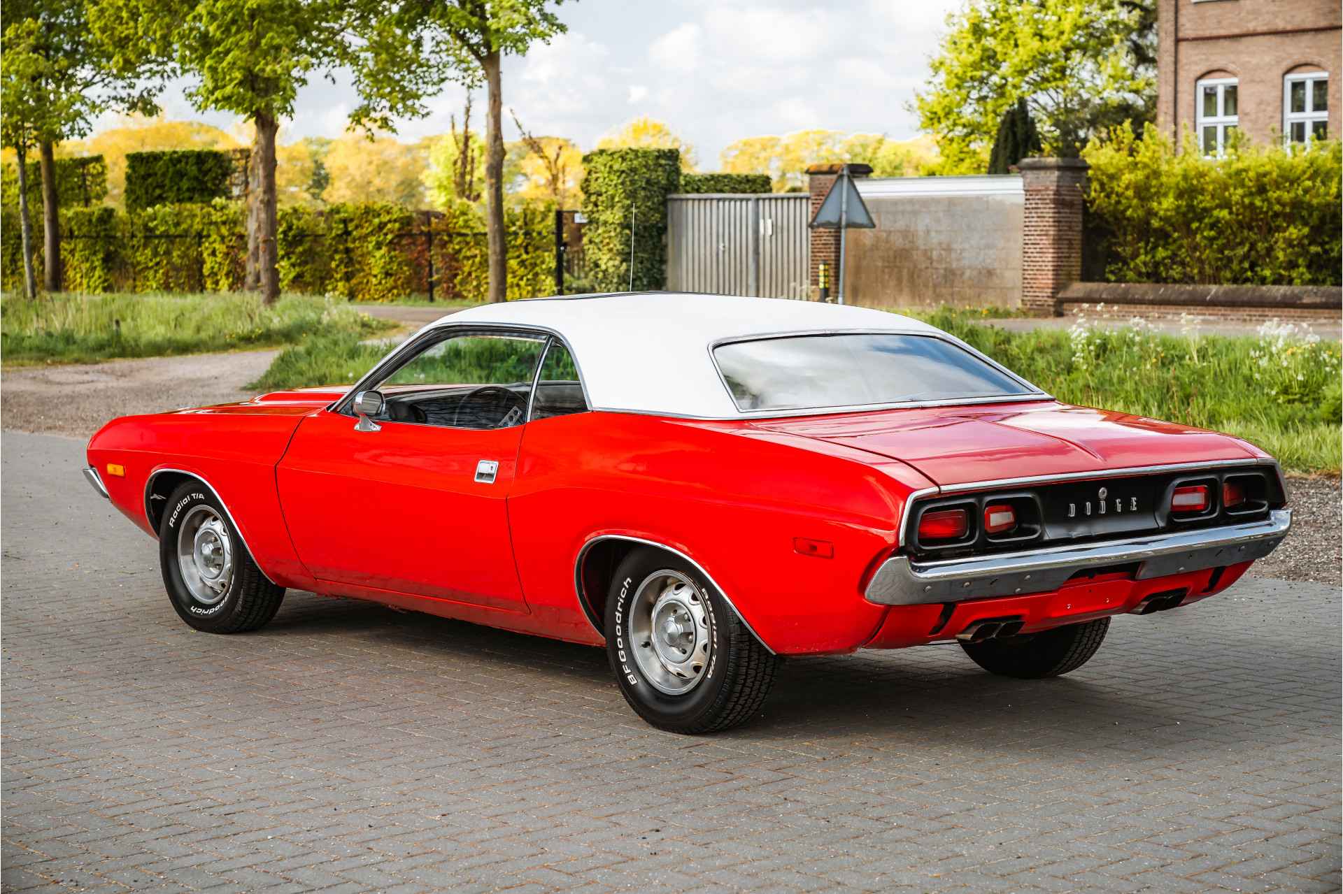

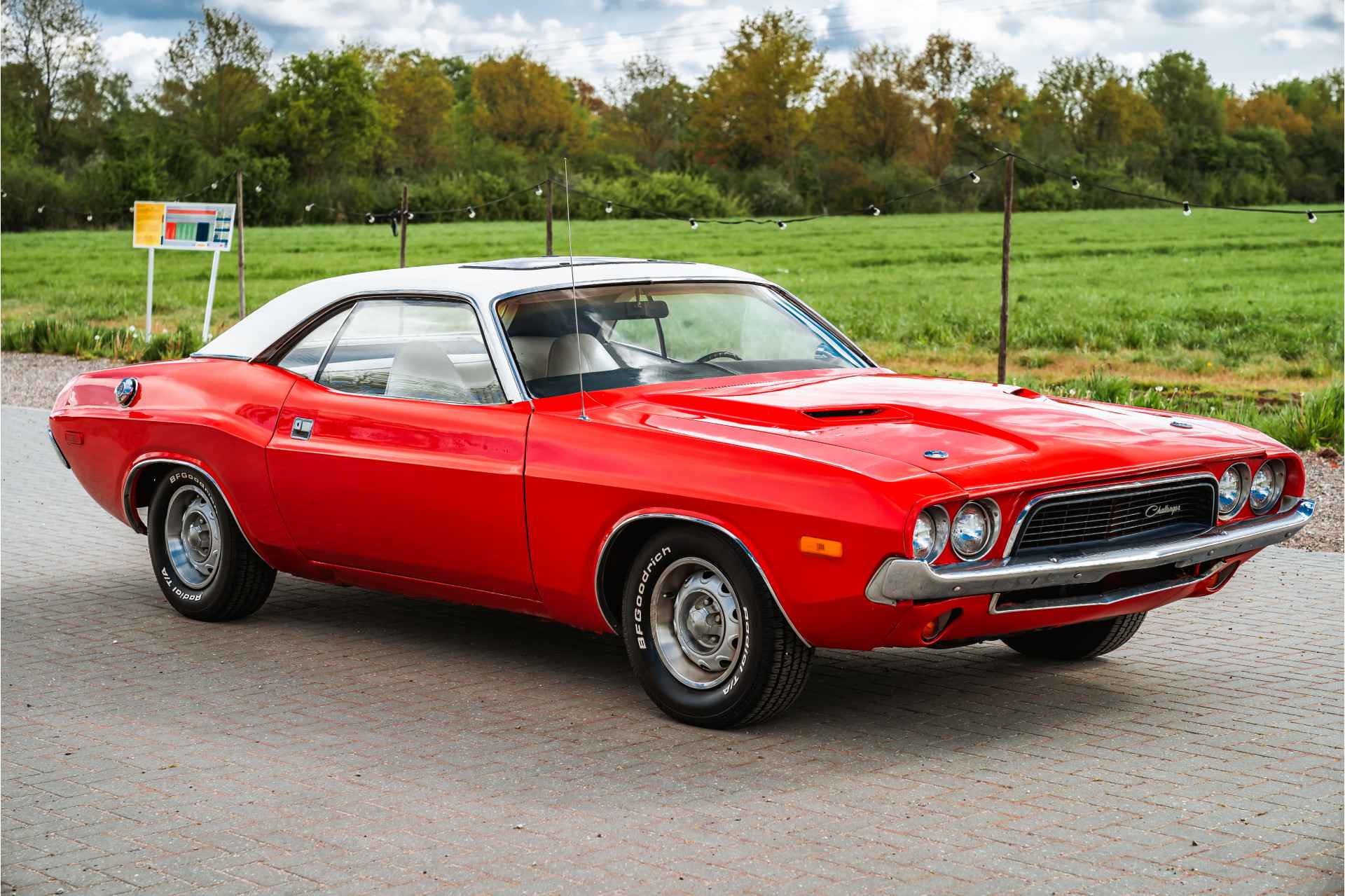

Almost 2 years ago i traded in my BMW for a 73 number matching Challenger with some work.
I let a friens of mine who's a mechanic check the car and found out that 2 cilinders have low compression issues. After consideration i decided to first fix the engine before starting on the other things i would like to restore. It quickly become clear that i want a perfect engine so a total revision became the outcome. The engine is removed and checked as we speak, the complete engine get's checked and machined. The block is torn apart i can instantly replace parts for better performance parts like cam, pistons, intake and carb.

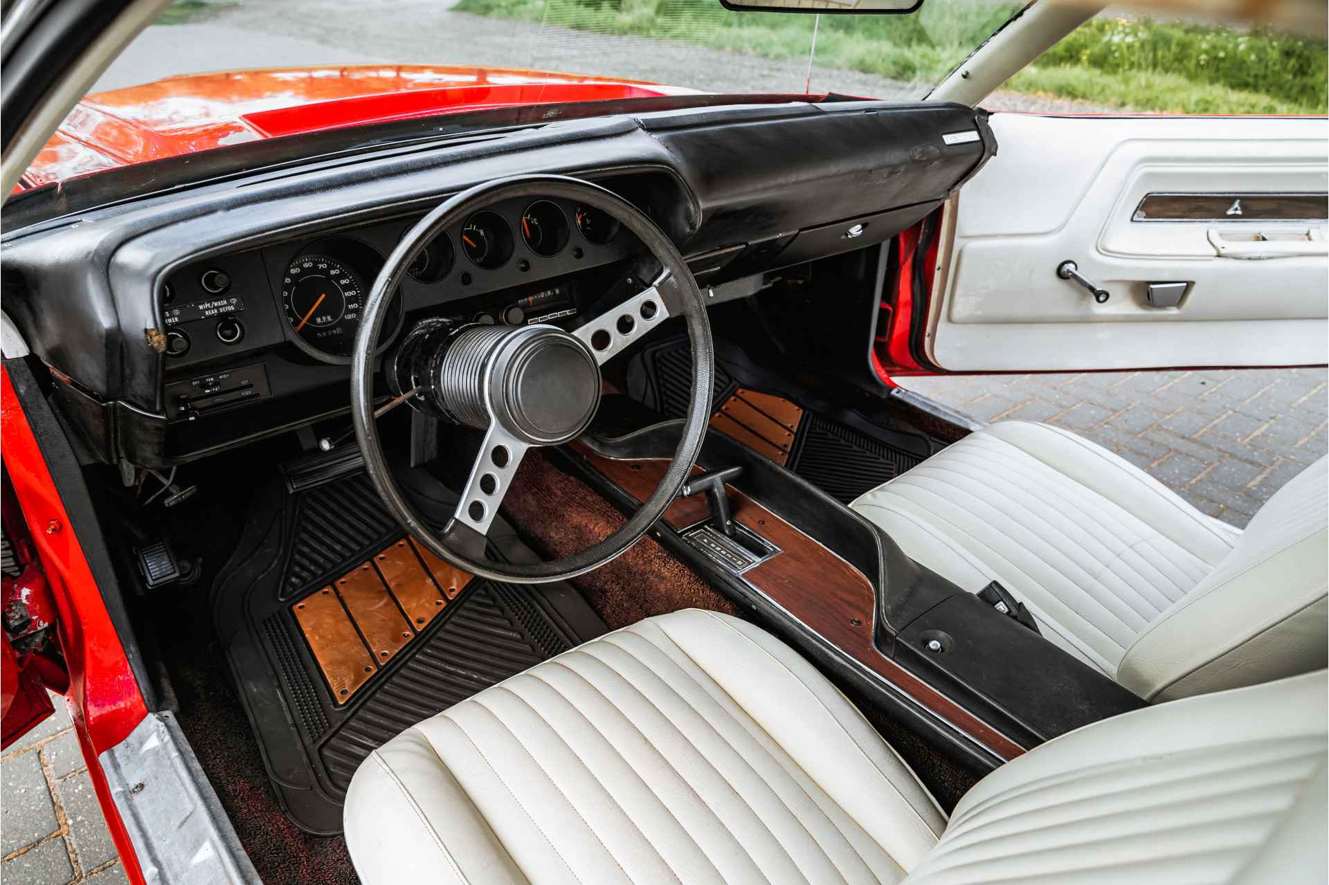

Yesterday i removed the front en sides to remove surface rust and repaint the inside of all the panels and enginebay. The trans is still placed but i wanne remove it so i can redo the underbody with a new coating.
The car will get a new paintjob and a new white vinyl roof. The dash, doorpanels and pillar covers gets replaced and the seats a new upholstry.

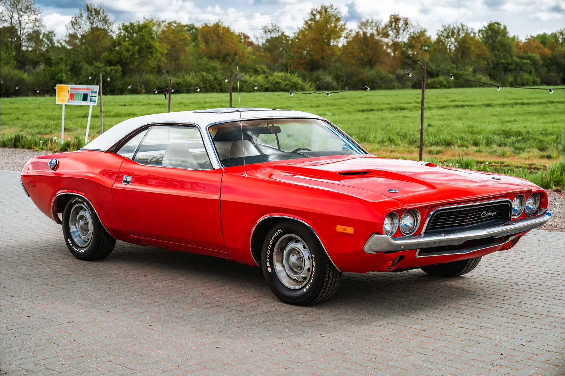

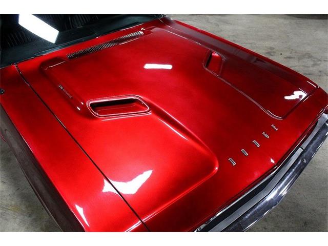

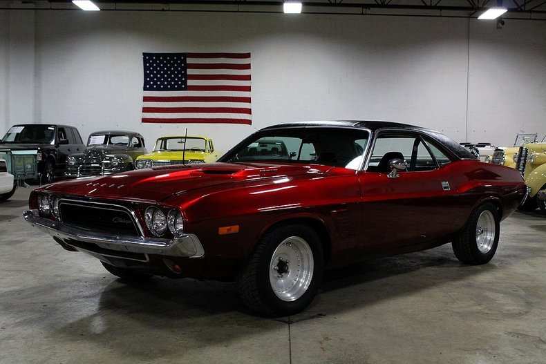

when i was looking at colours for the new paintjob i find one with an amazing colour that i really loved. Not an original mopar colour but in my opninion really stood out. Below a couple of pictures of the car and the colour i think about doing.

Is that a factory sunroof car? The bottom picture is a beautiful color?
Builderguy
Feb 9, 2019
51
23
It's a retrofit, one of the things i wanne remove. U don't think it's a beautiful color? Brandywine

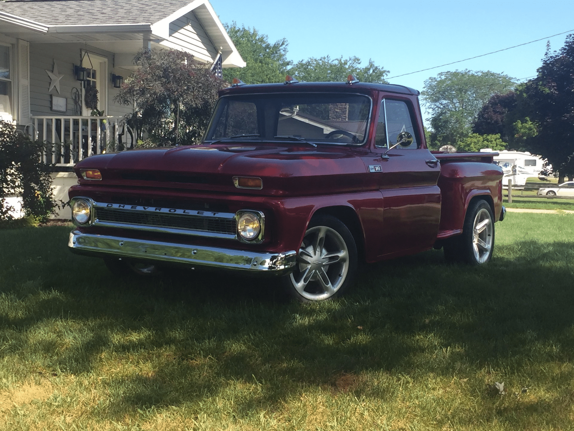

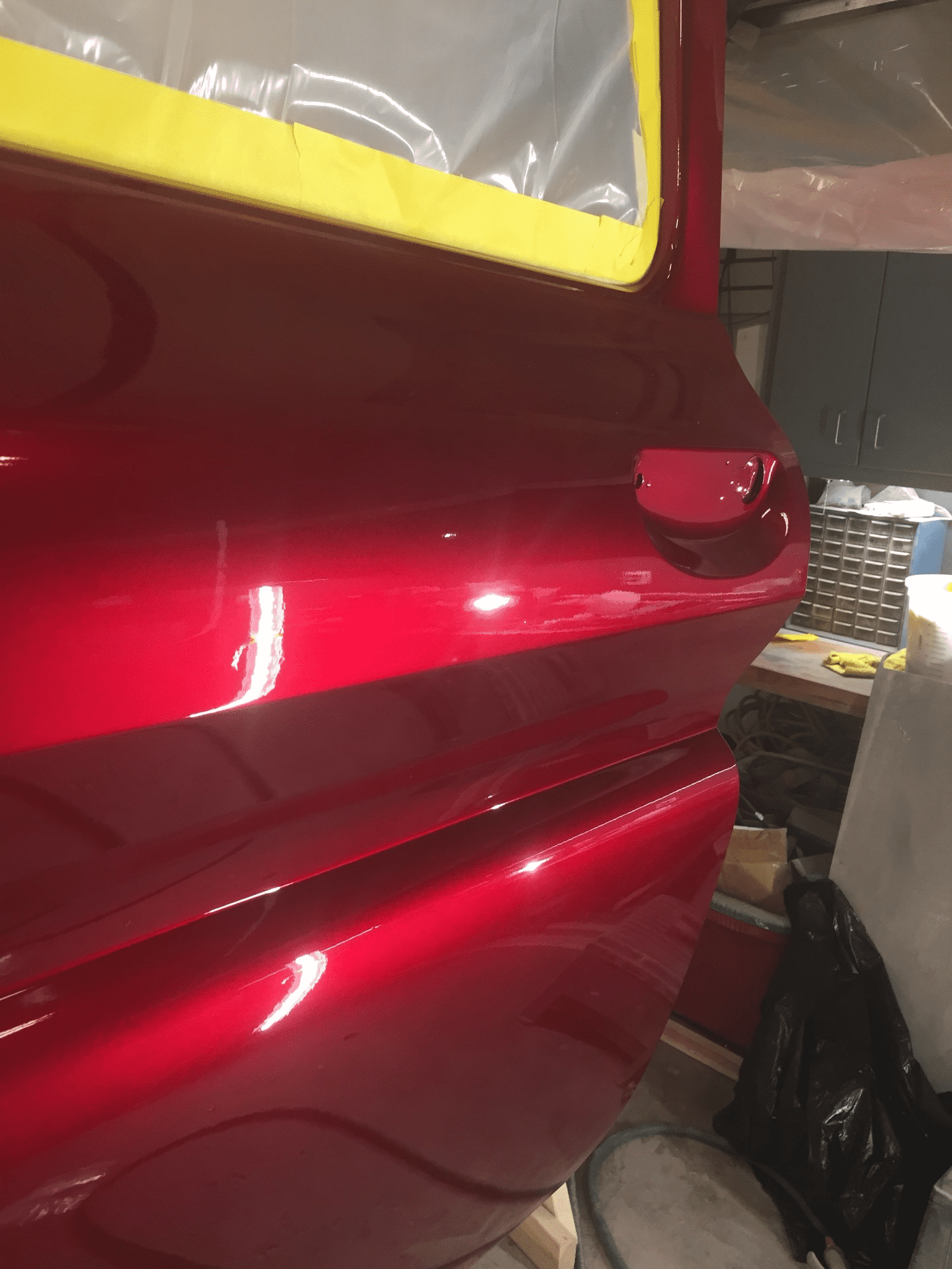

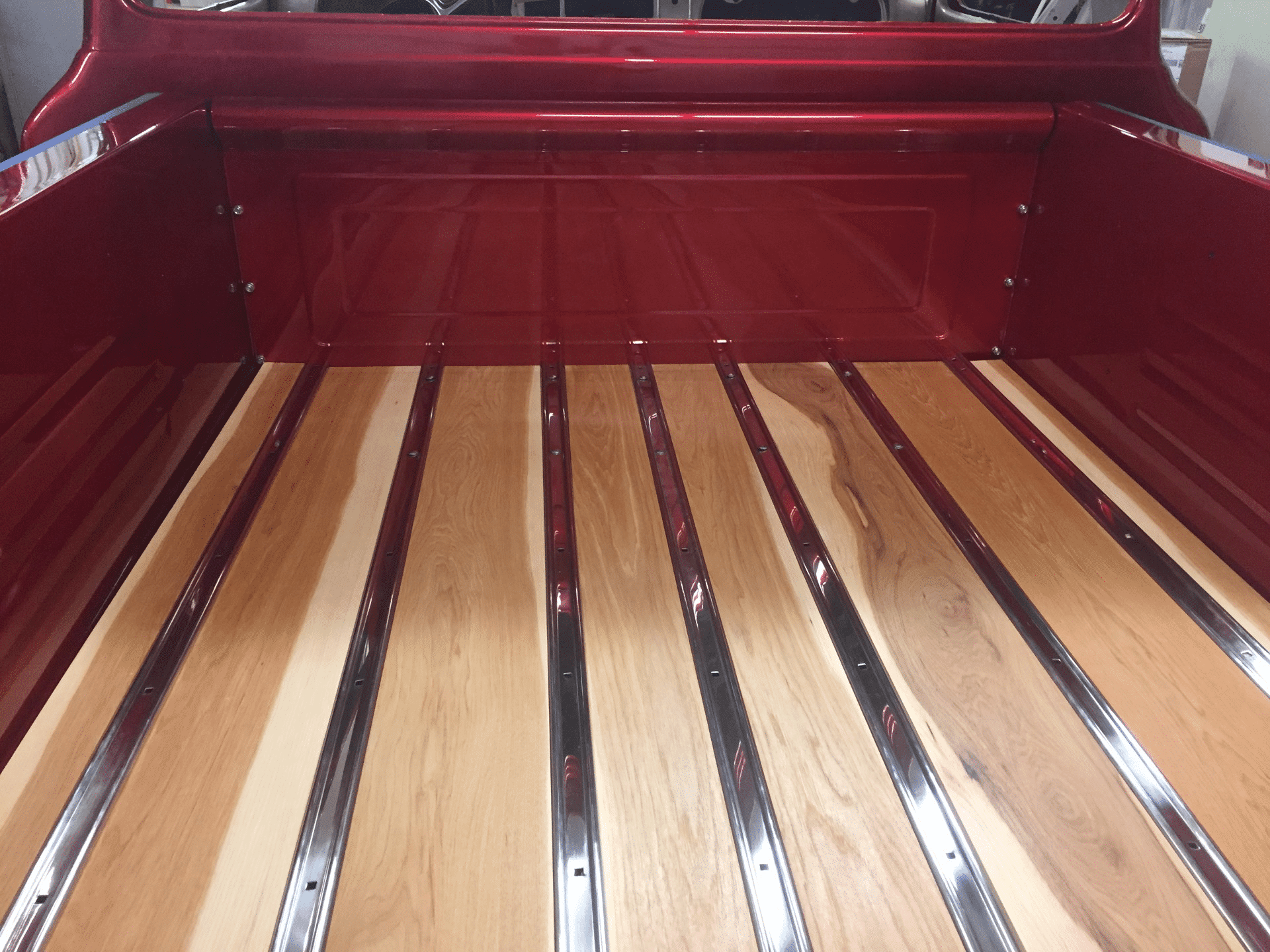

I sprayed a '65 pickup in Tri-Coat PPG Brandywine. Looks great but is a lot of work and very difficult to spray to perfection. I see now that there are some BC/CC versions of Brandywine that look pretty good without all the fuss. Best of luck with your rebuild.

Thanks for starting this thread! It will be great to follow your build! I like the Brandywine color!
The engine bay (inner fenders, firewall and radiator support) should be body color. The front of the radiator support should be sprayed flat black so the color can't be seen when standing in front of the car.

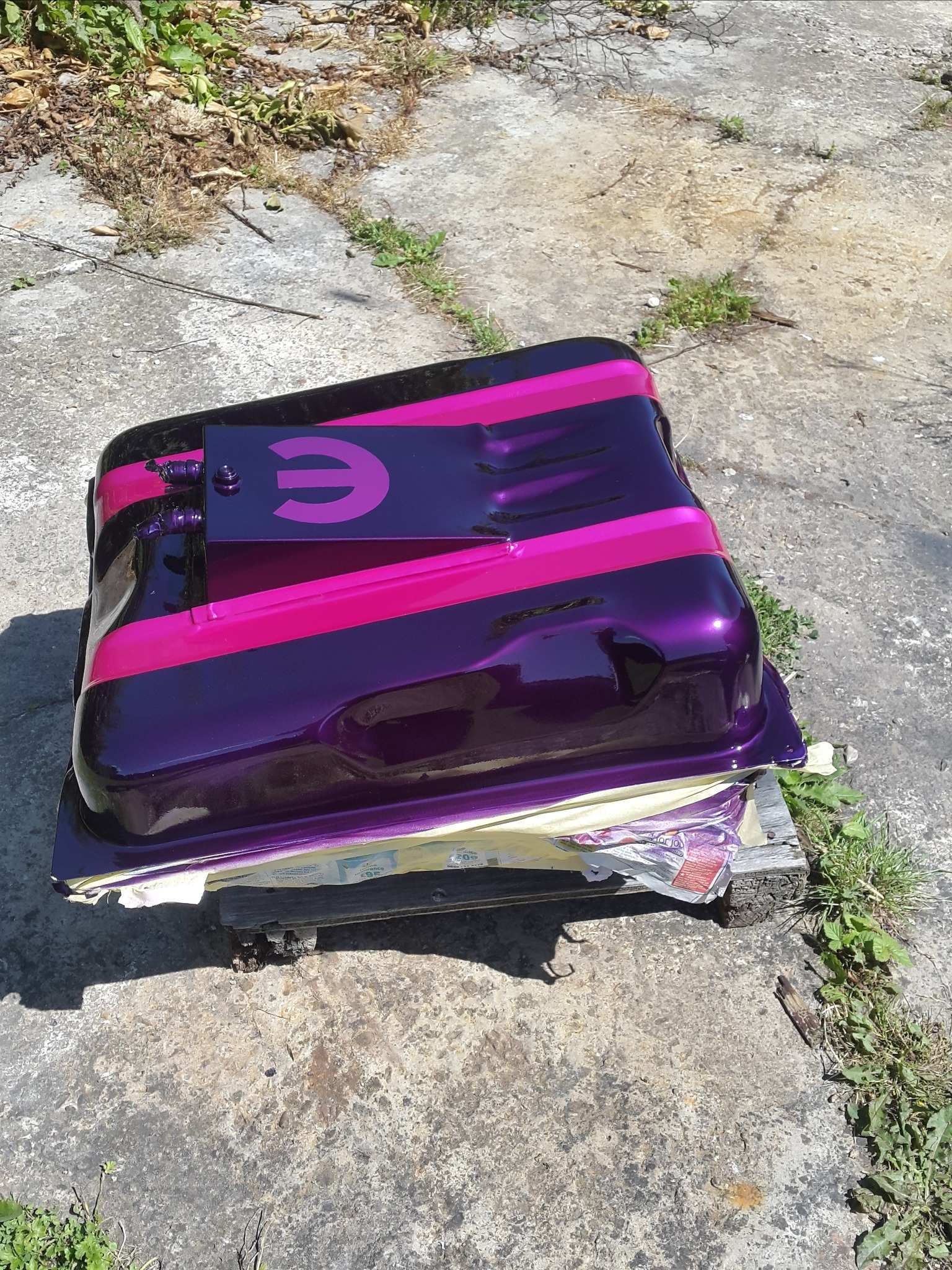

The engine is getting painted mopar red, i know it suppose to be blue but i prefer red because of the color the car is getting painted later on. Further i gatte find some valve covers prob ganne look for some mopar performance.

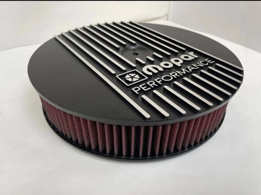

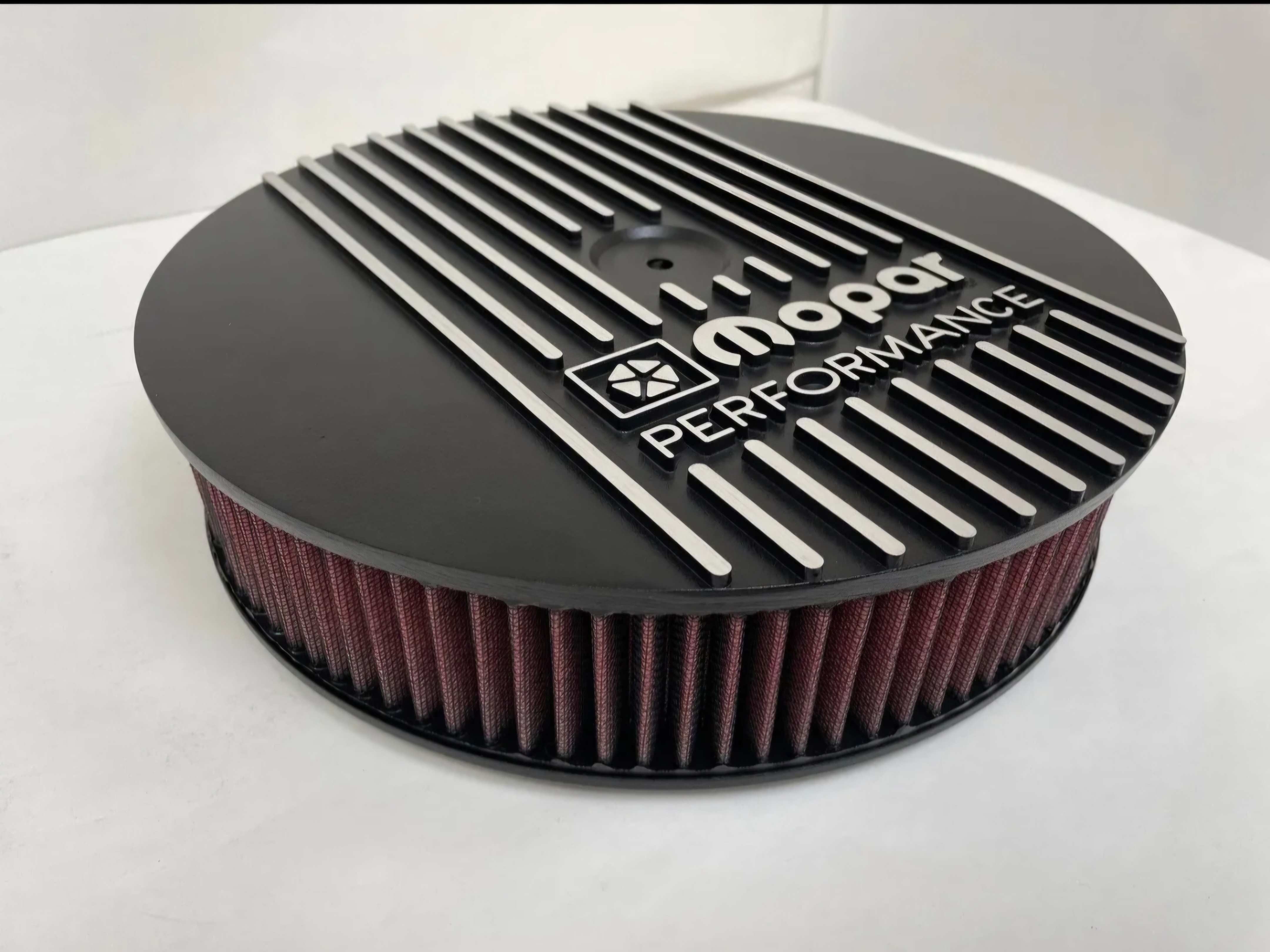

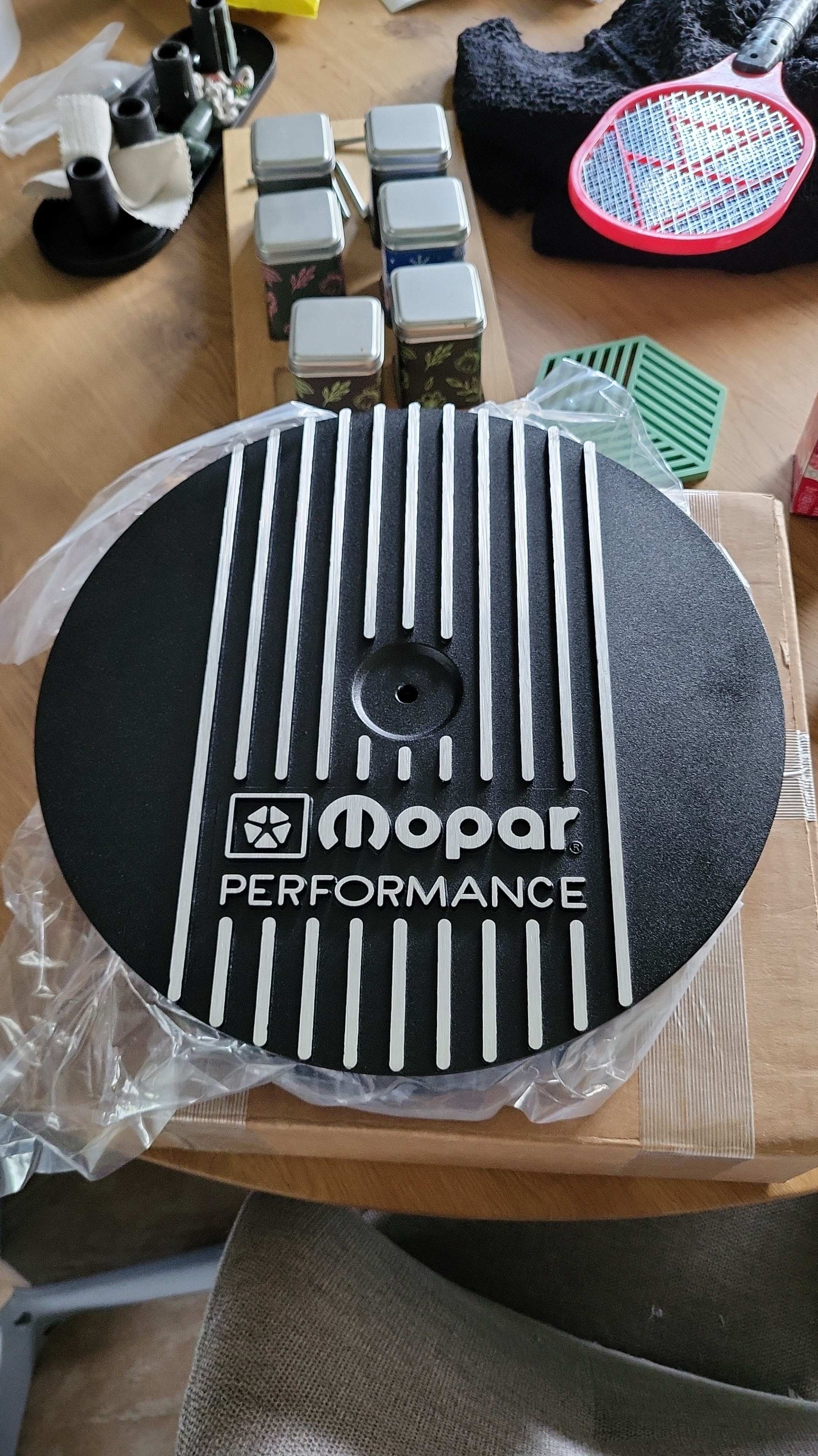

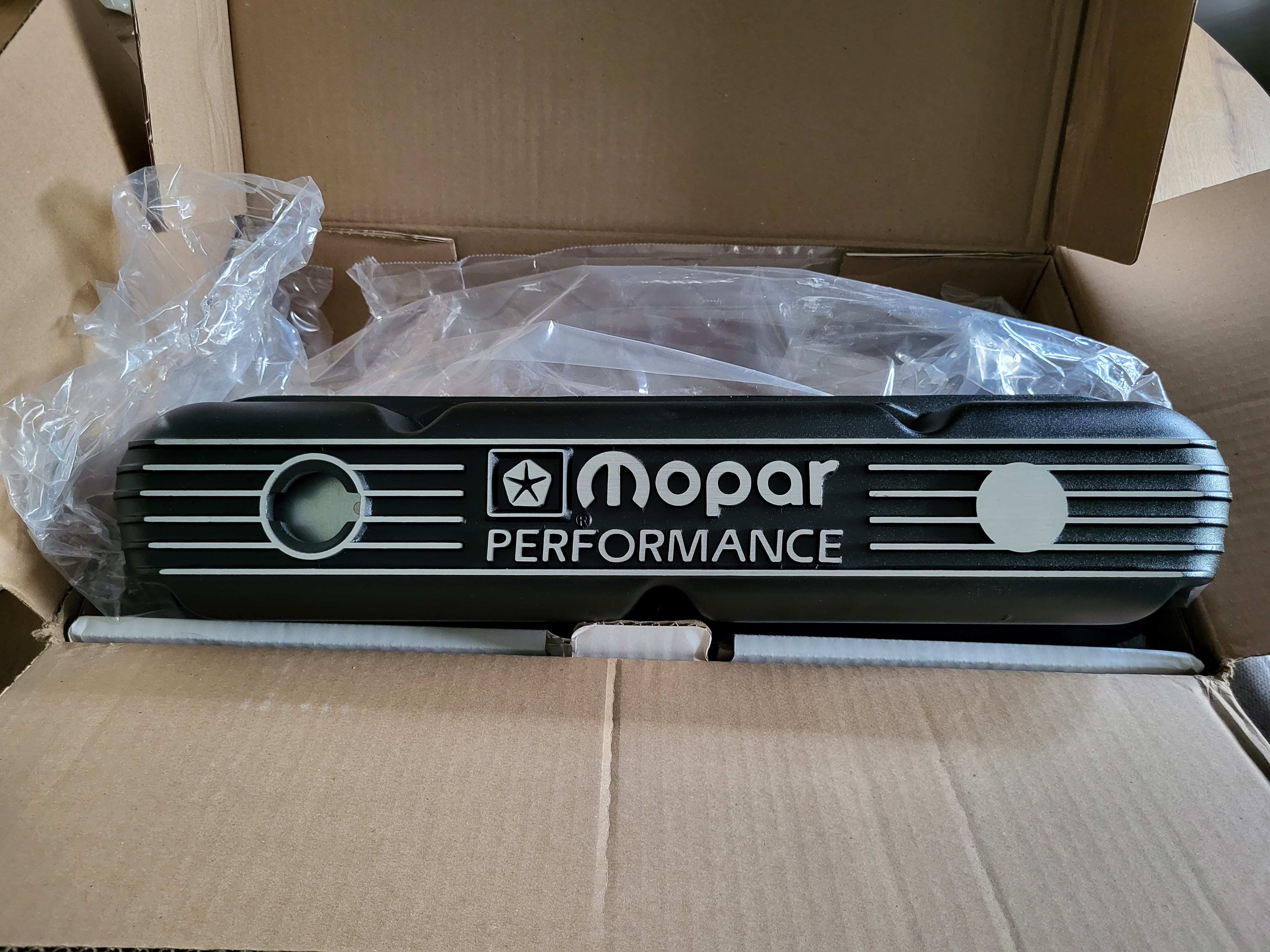

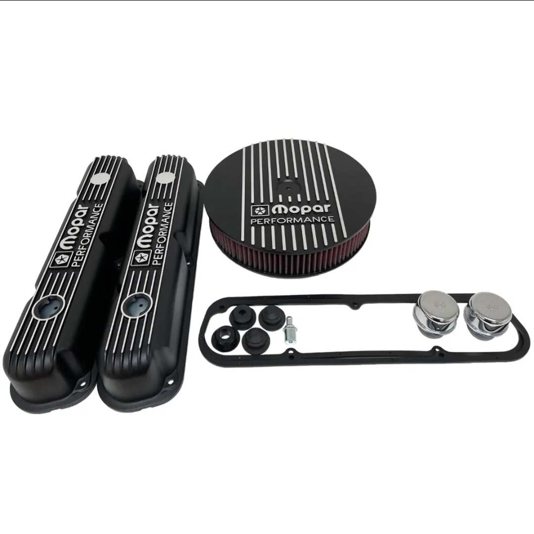

Well the air filter and valve cover set came in and can't wait 2 see how it looks on the car. I also heared from the shop that the engine is fully machined. Waiting for the last parts and the rebuild can begin20240904_181947.jpgIMG-20240902-WA0004.jpeg
