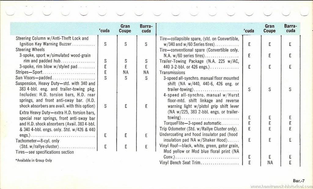

i have a 1970 gran coupe barracuda I am completely new to mopars. Purchased this car. When I was purchasing it the guy didn't know a whole lot about the car either. He was the original owner and said it came with factory highway patrol suspension. But I can't find anything on the code for that and fender tag doesn't say that. How do I know what type of suspension it has? It came with many factory order options as the owner of the dealer had ordered it for the wife but she did not want it because it did not have power windows so instead he sold it on the floor to his buddy (the original one owner) and got his wife a purple one with power windows. So I bought this off the original owner. the engine with the highest available on the gran coupe. The 383 4 barrel. Was wondering if anyone here would know what suspension this would come with? Or how to find out or differentiate which it is.

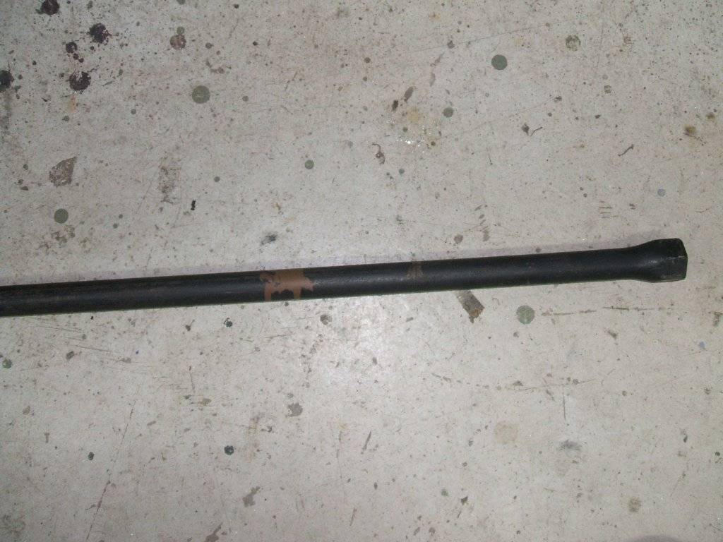

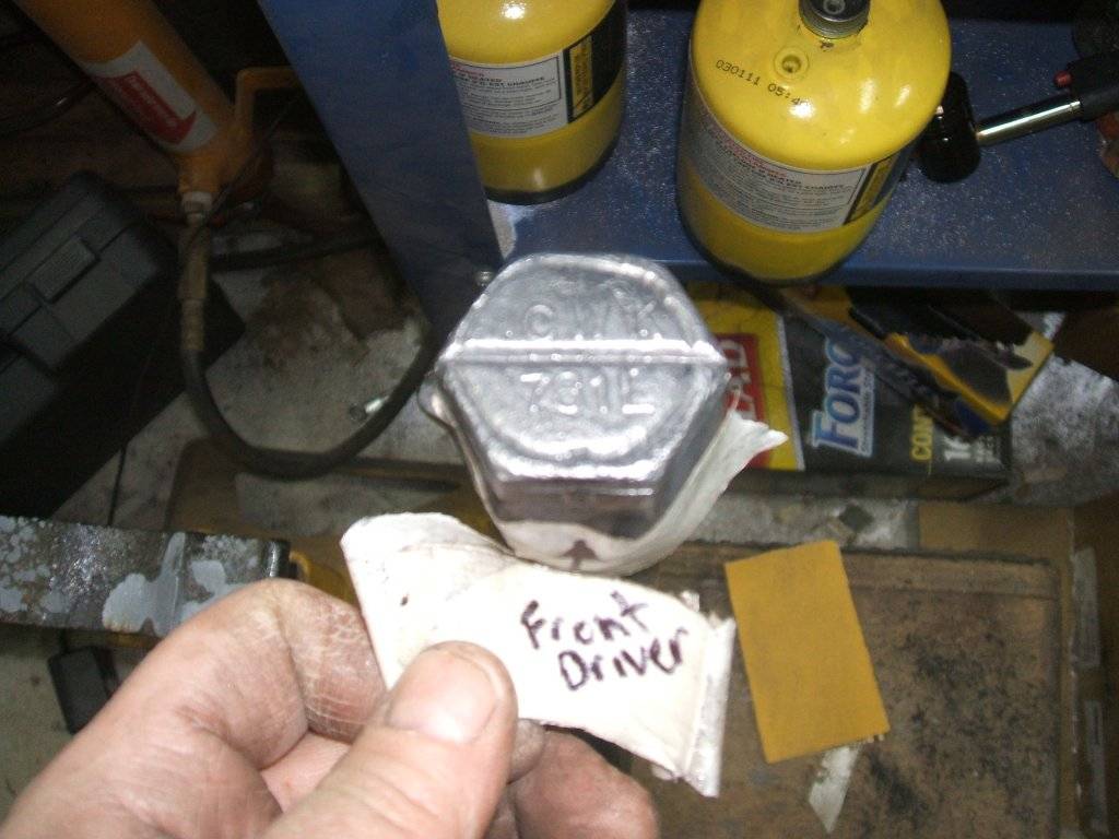

Try to clean out the torsion bar socket by the trans cross member; look in the socket with a light, on the end of the bars for numbers.. that will tell you what torsion bars are in there.
Perhaps somebody on this forum has a list, or link, to torsion bar numbers..
Does it have front and rear sway Bars? Look for a small metal tag attached under one of the nuts on the differential, it will have the gear ratio stamped on it. Does it have disc brakes up front.
Enough teasing here already, post up some pictures and let's see some of these details!
These are the torsion bar numbers and ID colors installed based on the engine and suspensions:
Bar number Body Year Eng Diameter Paint stripe
774-775
B 62-72 225 0.86 Orange
E 70-74 198/225/318
776-777 B 62-69 273/318/361/383 0.88 Green
B 70-72 318/383-2/400-2
E 70-71 318/383-2
778-779
B 62-69 383-4 H.D. 0.90 Aluminum
BE 70-71 340
/383-4
B 72 340/400-4/440
E 72-74 340/360
780-781 B 66-71 440/426 0.92 Brown
E 70-71 440/426
If your car has a 383 engine, you should have the 76-77 w a 2 barrel car and the 78-79 with the 4 barrel carb. If you are lucky, clean off the bars to see if any color markings are still present, otherwise look for those numbers.

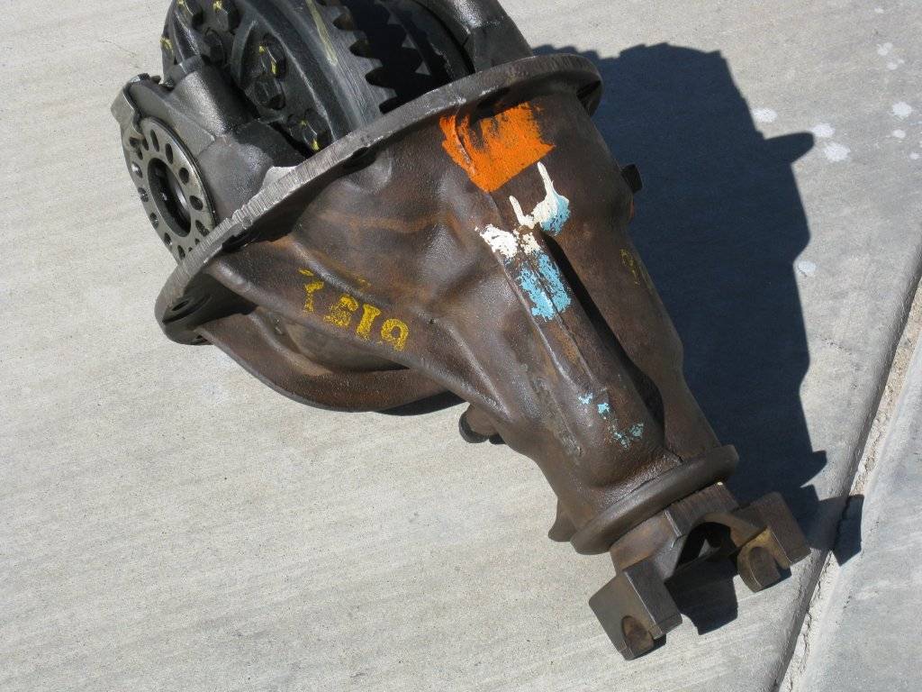

I believe they stopped using the metal ratio tag in 68-69; for 70 and up they used paint stripes on the bottom of the carrier. See attached pic. Two blue and one white indicate a 3.23 ratio. There is a reference chart somewhere on the internet but I cant seem to find it this morning...
