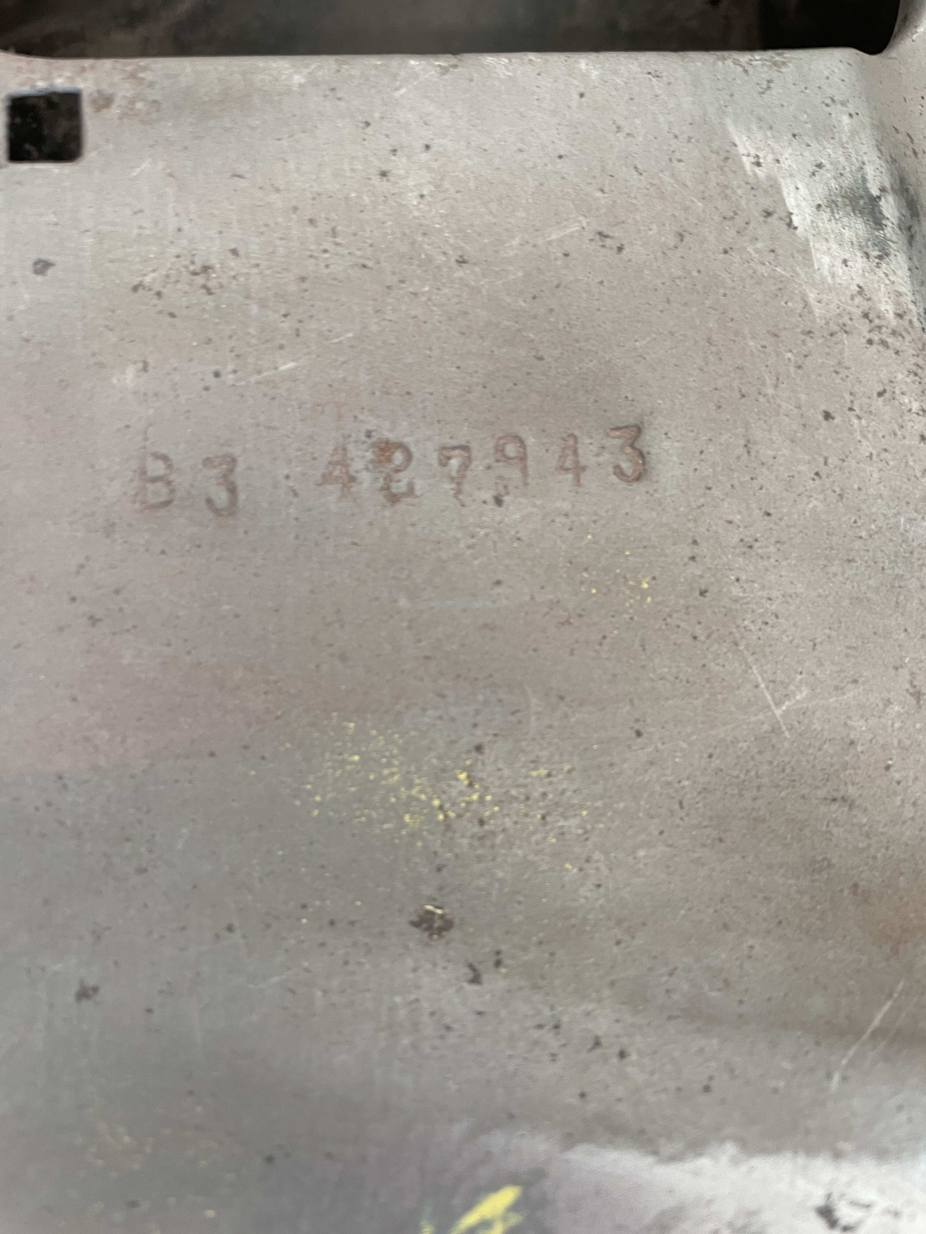

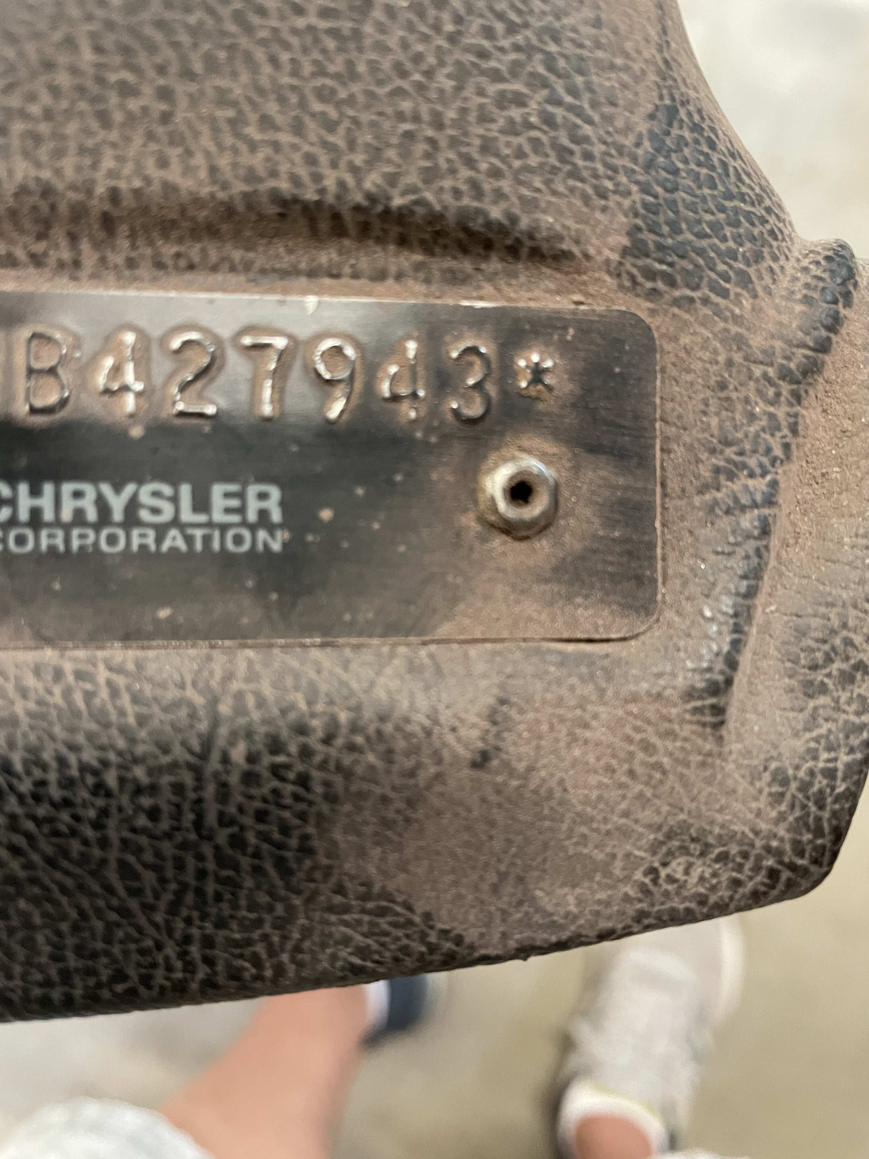

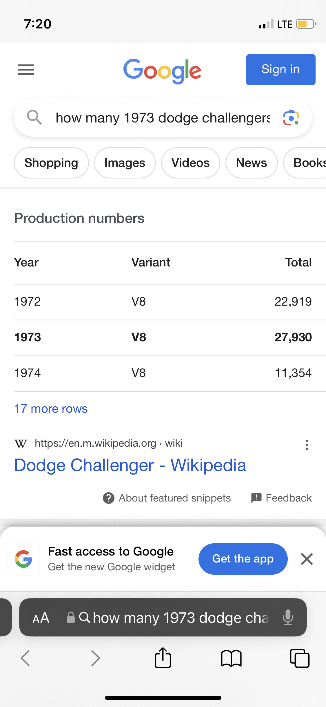

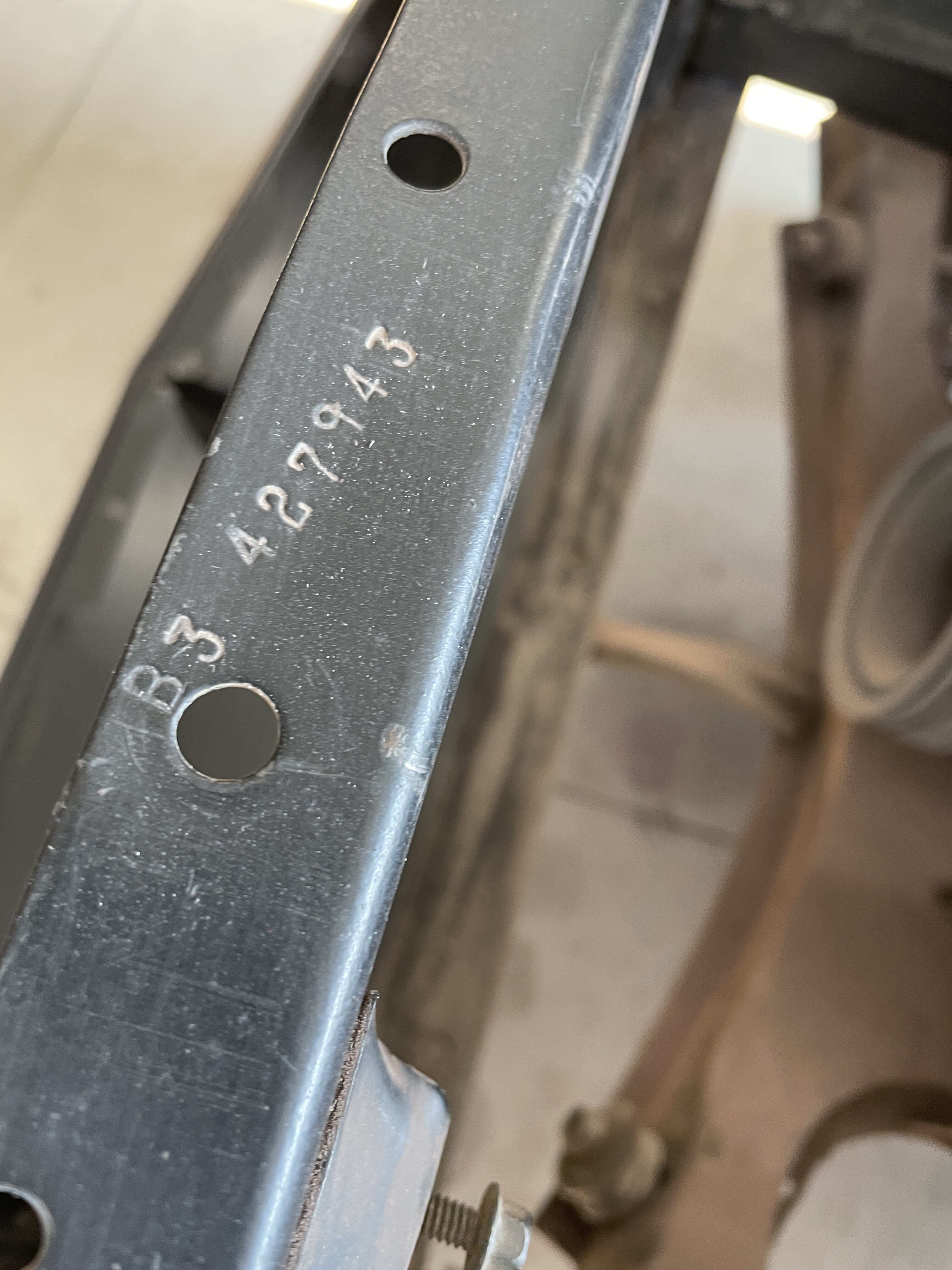

Please feel free to set the record straight. My vin serial is 27943 but according to said production of 27930 this doesn’t exist.
Yes cowl core dash and title match. Motor will be verified tomorrow now that I know where to check. Oil pan passengers side is what I was told.
Any inputs from you all would be great

Not every car down the assembly line was a challenger.
There could be thousands of non challenger cars built during the number sequence. You just happen to have a car number coincidence with the total number.

Looking at your sequence number, after responding, I realized your sequence number is 427xxx. That is 300, 000 cars made from a start point of 100001.

Ok so my last 3 numbers are out of production number sequence by 13. Can’t wait to see responses. Very interesting

As stated above the sequence is not just for Challengers but Cudas as well so the vin is not the total of challengers built , No worries the Vin is good .
