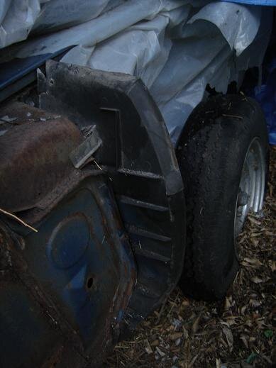

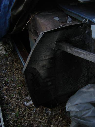

I am installing my Doors, Fenders, Decklid. I was wondering what splash shields I need to install before i install my fenders if there are any that would be easier to install prior to installing the fenders. Also what is needed to install my decklid, any plastic pieces needed. i have painted my hinges and torsion bars for the deck lid. Any help would be appreciated. If interested I can post the pictures as I go along. The car is B5 blue, as well as the interior.

There is a splash shield mounted in each fender. There is also a splash shield mounted on the cowl on the inside of the fender. My computer crashed and I don't have pics of the shields right now. I posted them once before. You may be able to find them on the site.

Can someone post the splash shields needed prior to installing the fenders/Doors. on an E body. I am trying to figure out what is needed to install my doors and fenders without removing them again.

These pics are a little dark but they might help.
