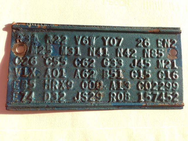

R22 would be on the fender tag for a 22" radiator. The 26" would not be indicated on the tag if equipped.
My 70 R/T 440 Magnum came with the 22" and it pretty much sucks for cooling. Modified to a 4 row core helped. It does have the R22 code.
EV2RTSE
Dec 13, 2013
409
264

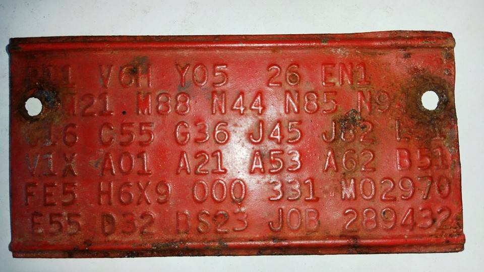

R22 is the code for an AM 8-Track Stereo. If a car gets a 26 inch rad it is most definitely on the tag - as a 26 right next to end.
challeng61
Mar 4, 2023
18
8
80534
Oops, you are correct, I have the 8track also no shaker. The 26 on the top line is the radiator.
