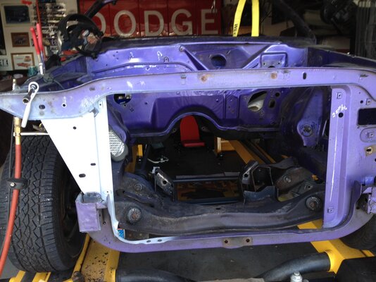

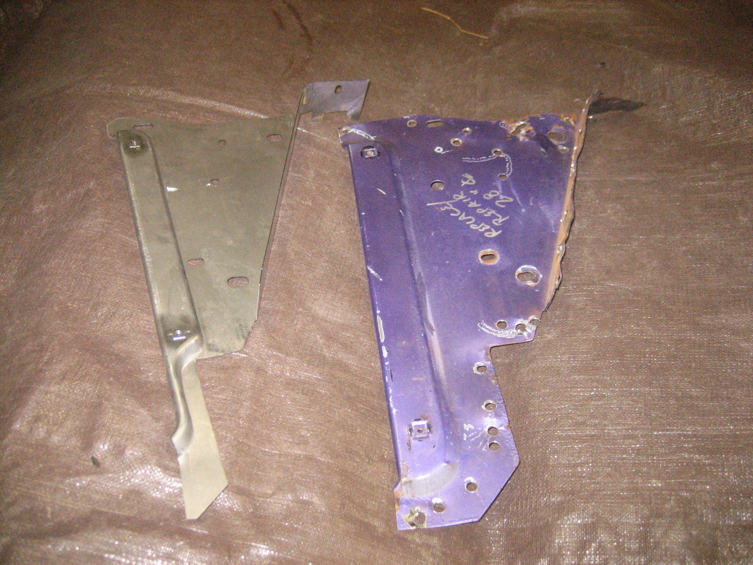

I agree with Bret Schneider posted recommendation. Pictures below are on '71 Challenger.
First picture: Original passenger side radiator support extension for factory 22" radiator
Second picture: aftermarket support extension for 26" radiator installed
Third picture: the original 22" support extension next to the aftermarket 26" support extension. Gives you a feel for width difference.
BUT - if you're not ready to cut up/weld at this point, I just made a flat sheet metal adaptor that bolted to the existing 22" support on one and and the 26" radiator on the other. Sure, the radiator was partially covered by the 22" support, but it worked fine for years with a mild 440.
