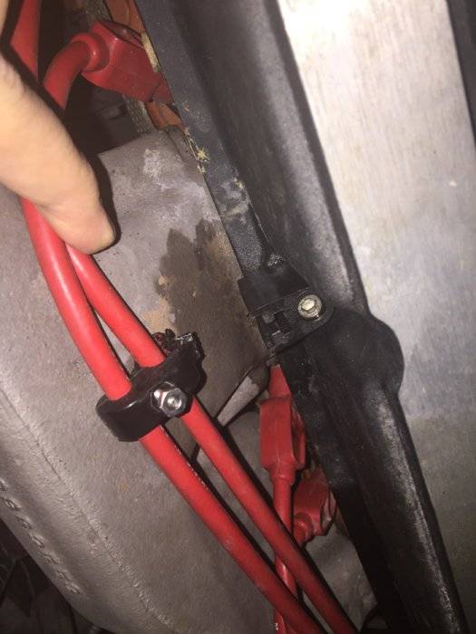

Bought my wife her favorite MOPAR growing up, 72 Cuda with a 340 engine. Starting to evaluate the overall condition of the vehicle and have found that the driver's side outside center bolt for the valve cover into the head is leaking coolant. Went to pull the bolt and before I even got it completely out coolant was freely flowing...
Can anyone help with some information on WTH is going on? Know about the header bolts and the coolant jacket, but at the valve cover?
TIA!
