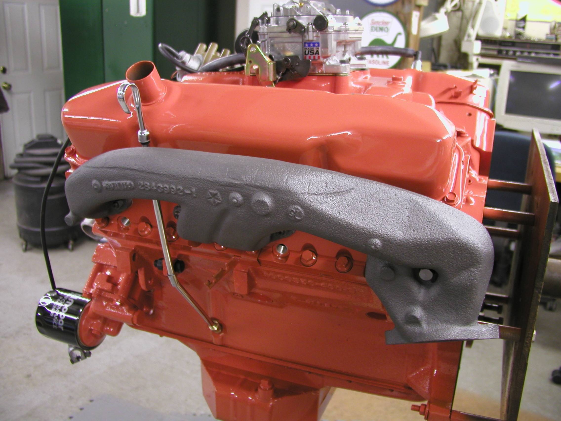

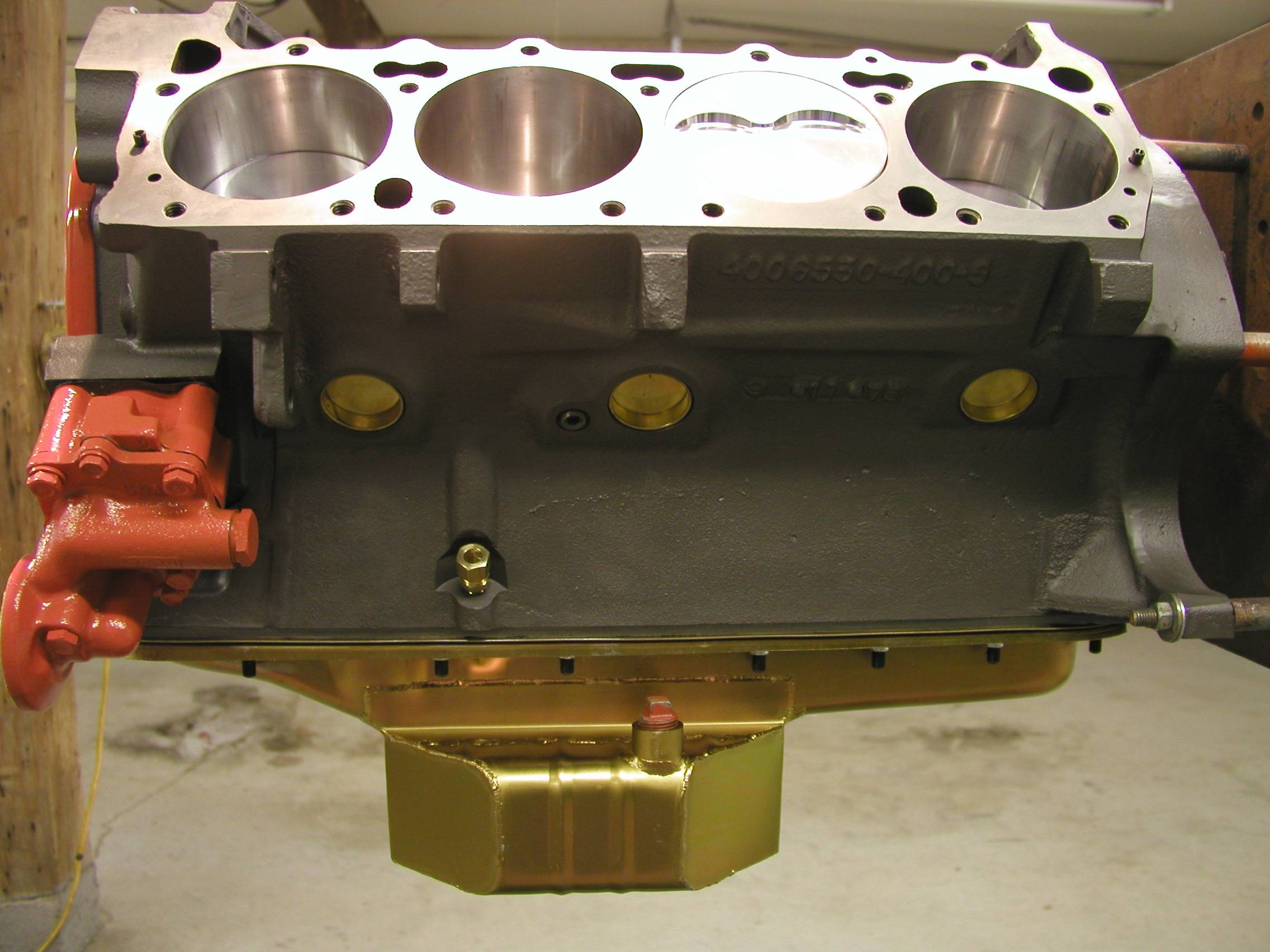

An alternative to the factory method is to use an adapter fitting on the block. It has pipe thread on one end to thread into the block (you have to tap the hole in the block). Then the other side of the fitting is a compression fitting for your dipstick tube. The dipstick itself may need to be slightly modified to fit properly and measure oil level correctly, but it isn't rocket science.
Here are a couple photos of one of the engines I modified for this tube fitting. Also a link to Hughes Engines where I got the compression fitting. You may be able to get the fitting at your local hardware store as well.
