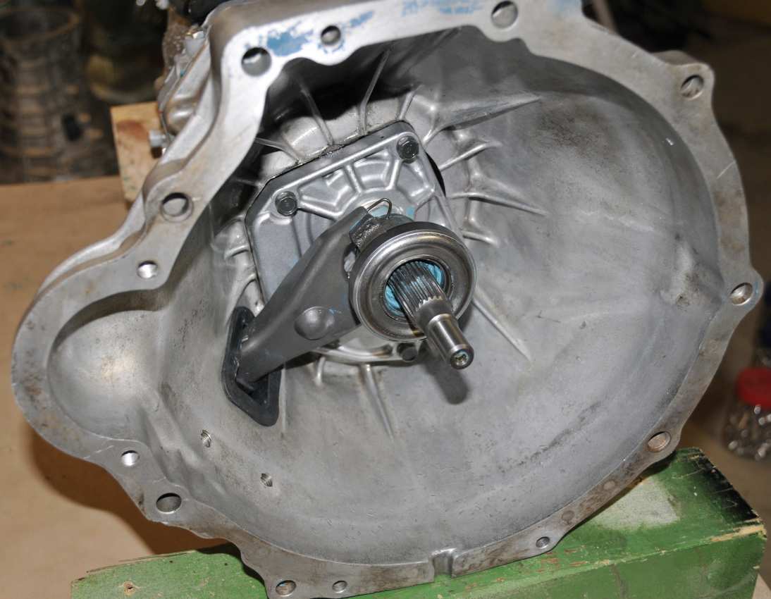

Hi all
Maybe Im doing something wrong
I installed my 4spd trans in with throw out bearing on
Im trying to get clutch fork on but I cant slide it behind the throw out bearing and into the clips. The throw out bearing is already up against the clutch
Am I supposed to back out tranny now and assemble this clutch fork on bearing and then slide tranny on?
Thanks
440WB
May 30, 2015
469
56
Michigan
yes install
on to the bell housing
for me - it was some what difficult to get clutch centered inside the pressure plate to slide trans pilot into it
