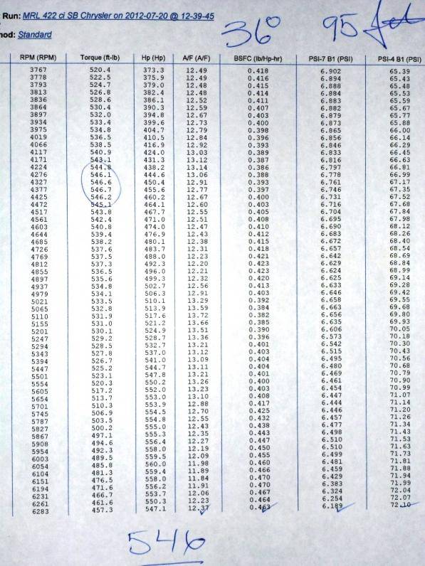

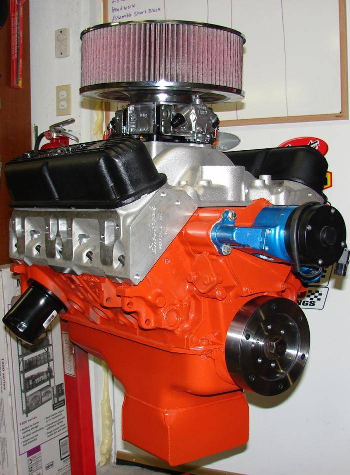

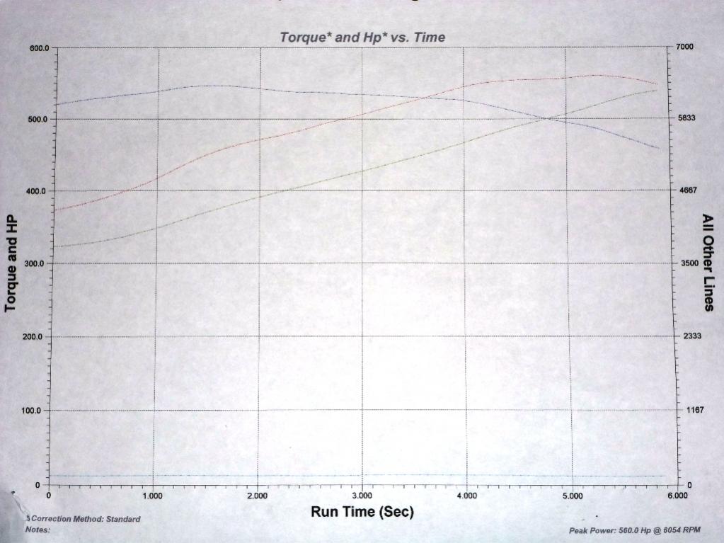

Ok, here is another one ready for dyno testing. I know you guys like to guess the power, so here we go.
340 block 4.100" bore 4.00" stroke 422ci
RPM heads Stage 2 ported w/2.055/1.60 valves 63cc measured
Comp dual springs/locks/retainers
Diamnod Flat Top Pistons 12.4 to 1
SCAT I beam rods/crank
Coated piston skirts/valves/bearings
Custom made 3/8 pushrods(made in house )
PRW 1.6 stainless roller rockers w/ billet hold downs
Comp XR286R solid roller cam
MRL Solid roller lifters
Weiand Stealth Intake(special mods )
Holley Ultra HP 850
Proform electric water pump
This is a rather smallish cam, and yes its a Comp Cam. They had it, so Im using it. I would rather use a Voodoo, but money was tight and Im working the best I can with what they got.
So how much power will it make????????
Well I always lean on the low side , that way the customer is impressed not disappointed , it also depends what dyno you are using as no two are close , Mustang is tough Dyno Jet always reads much higher & what altitude you are at etc . the real # is the Timeslip
with the actual weight of the car & driver .
