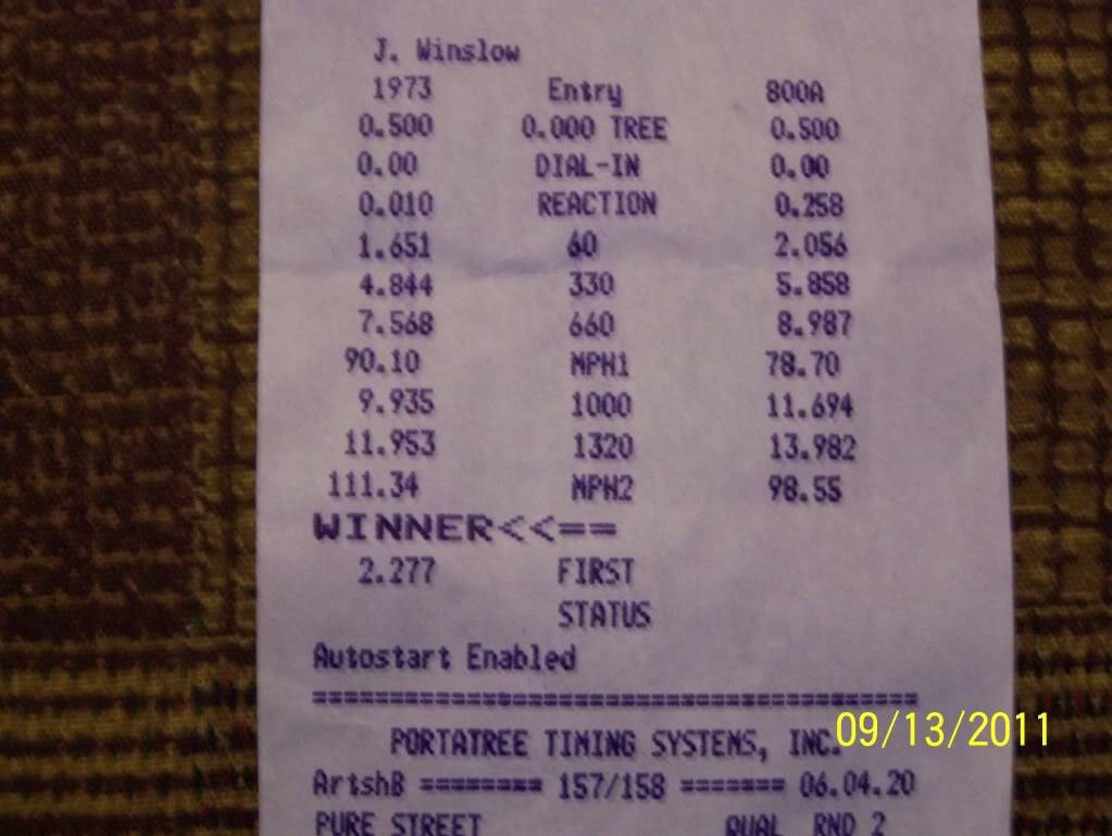

I am not trying to start a fight. I was just quoting something that I read in a book once. I am a six-pack man and always will be. I was really trying to keep the guy from going with the 650 cfm carb.
This is mine... Built with a lot of advice from Chryco Psycho.
P.S. Don't look at my oil filter, it's going in the trash. I bought a couple of WIX filters for it.
