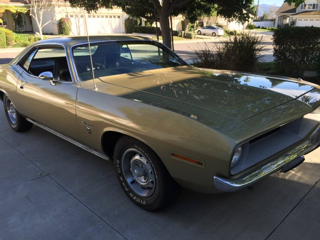

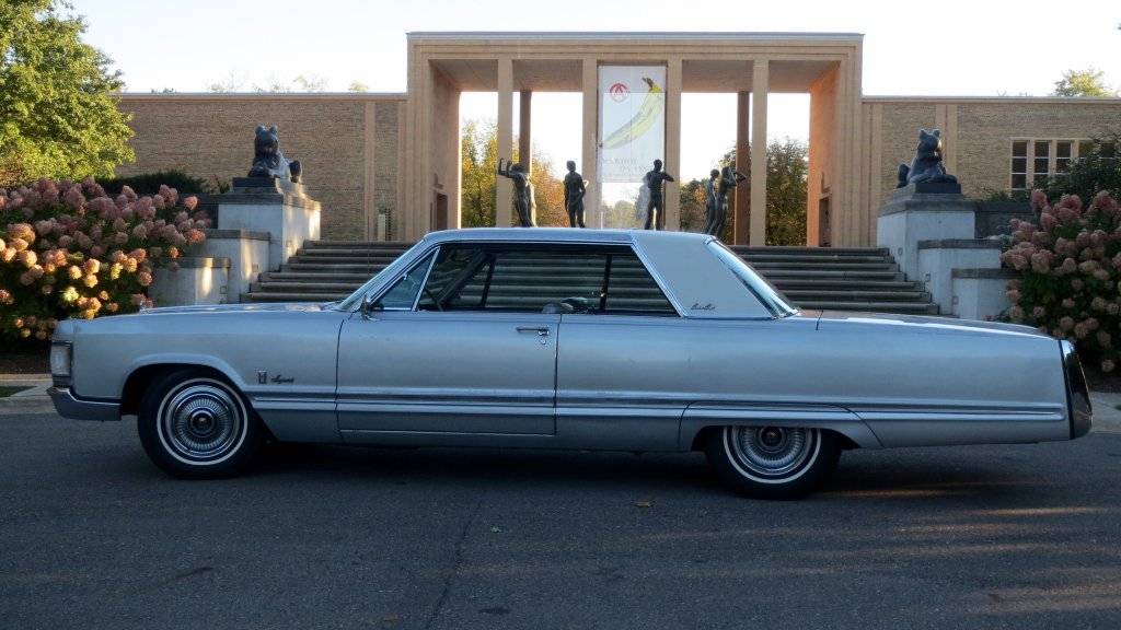

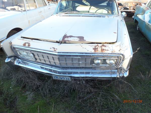

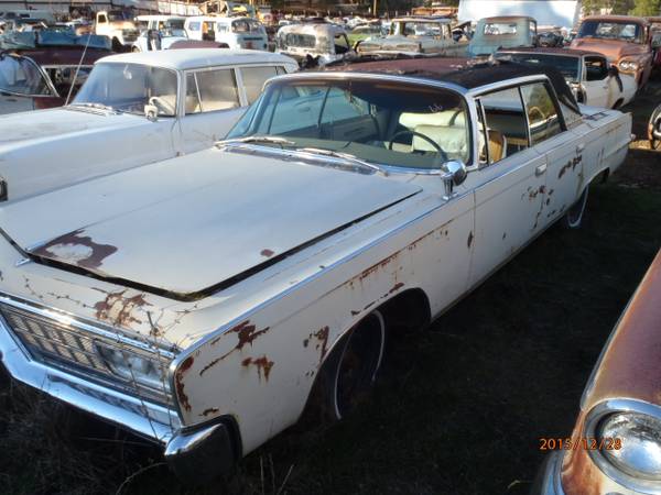

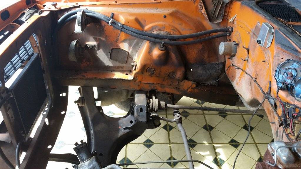

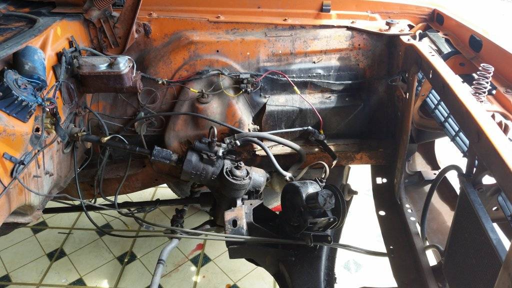

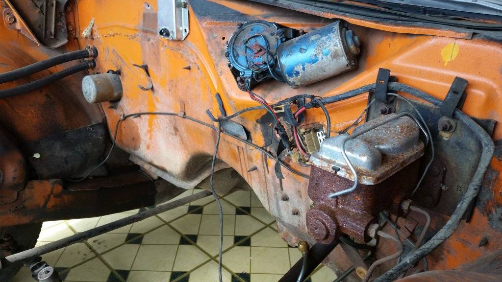

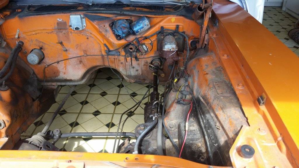

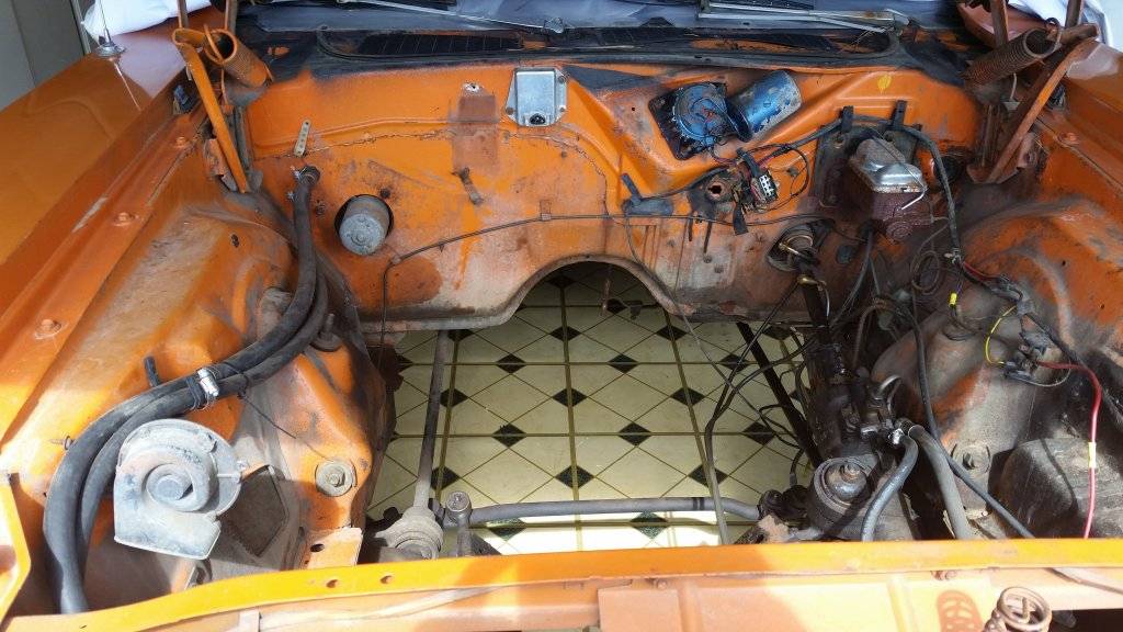

Hey guys how's it going? So I bought my dream car a couple weeks ago. I bought a 1970 Barracuda gran coupe that is missing its motor and tranny so I plan on dropping in a bone stock 440 and 727 in it for the time being (still in college so I might not be able to finish the car for another 30 years haha). I have currently found a 1966 Chrysler Imperial (D-body) that comes with a 440 and 727 and I am considering buying the entire car since my barracuda is looking a bit bare. So my question is exactly how much of the imperial can I reuse (temporarily) in my car? Other than what is shown in the pictures below, i have a driveshaft that the previous owner threw in. Will I be able to use the headers...etc? I apologize for the rather vague question but I figured it was a decent starting point. Thank you for all your help in advance.

I don't like hearing about turning Imperials into donor cars or any of the C body cars for that matter. I realize how easy it might be to have a known running and driving drivetrain that can virtually be plucked from one car and installed in another. I would rather see the Imperial offered up on the market first and if there were no takers and it was headed for the scrapers or the derby idiots then go ahead and use it as a doner first. The Imperials are amazing road cars and I drive the heck out of mine. Last I knew they aren't making them anymore....

I agree. I would like to have a 66 Imperial. Basically all that could be used in the Cuda is the engine and trans. The engine and trans should be available separately, somewhere, without you having to part a car. I have an extra 440 and trans, but I am in Fl. I'm sure you will find one. Post some pics of the Imperial.

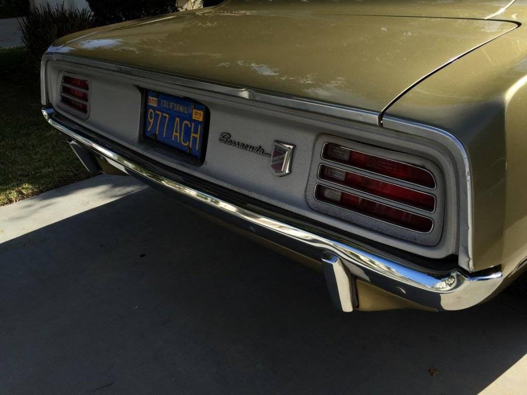

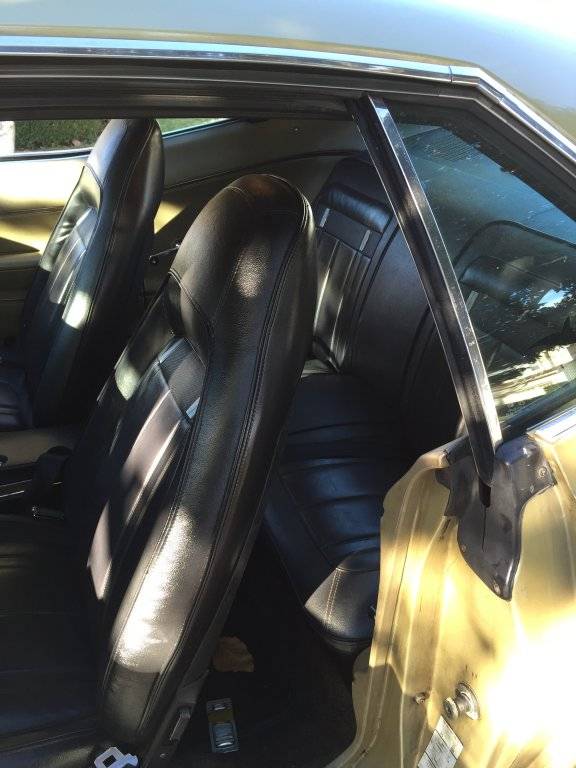

My mistake for not giving any info regarding the Imperial's condition. It is a complete parts car that hasn't been run in 10 years and has no title (has a lien against it). The owner was selling it as a whole car a few weeks ago but recently changed to parting it out, but I was interested in just buying the entire thing in case I need anything else from it. Believe me, I wouldn't have the heart to tear apart a perfectly fine car. Knowing what I wanted to do with my project, I previously passed on purchasing another barracuda also a '70 gran coupe because it was in too good of a shape for me and my plans (ill post pictures of both the imperial and the barracuda I passed on).
As for the parts, So only the motor and tranny correct? Thank you for your time.
