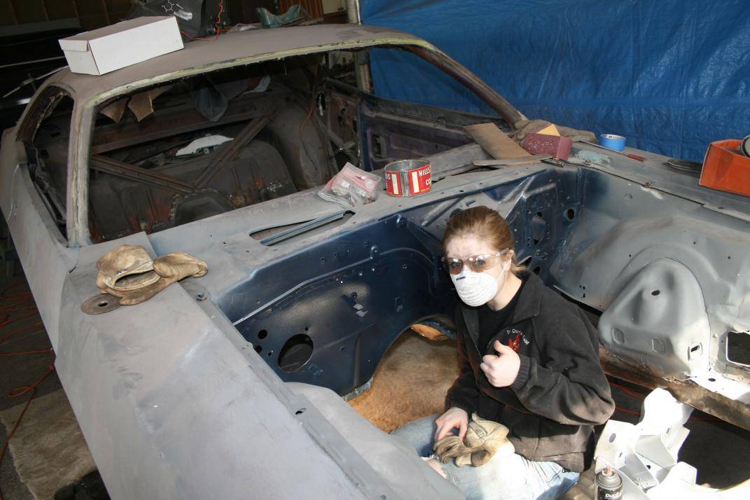

Hey guys my 440 is leaking coolant from the oil pump where it connects to the block. the engine is rebuilt and were just getting the 70 challenger road worthy after a 3 year restoration. (kinda frustrated to say the least). It's a daddy daughter project. No coolant seems to be getting into the oil right now and it only leaks when the car is warmed up. Can this be easily fixed? Any input would be awesome.

Thanks again for the help. I've been working 3 years to drive this heap. Seems a little fast for the Daughter to drive, oh well it will take some daddy driving school time, Priceless..
