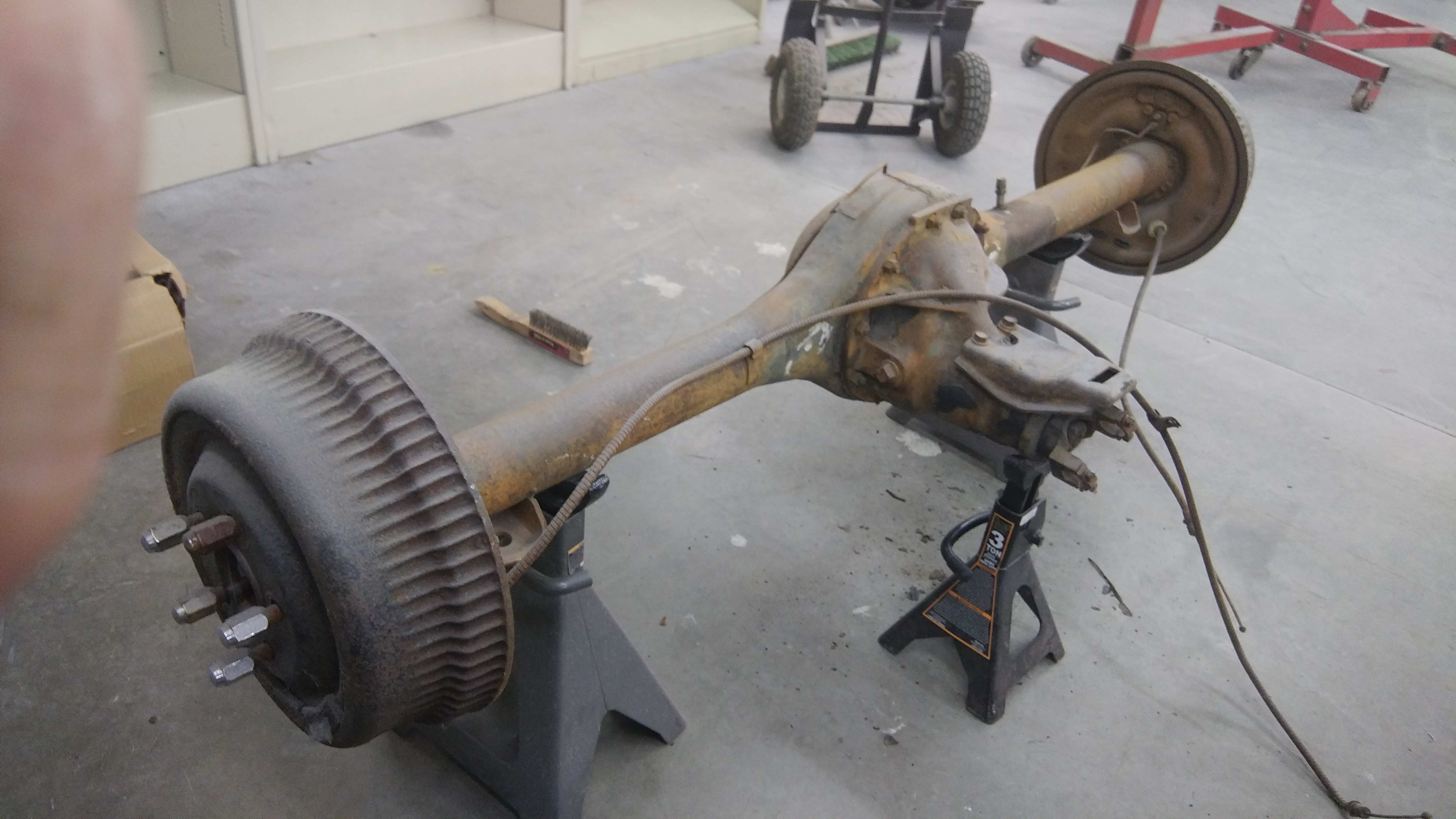

I have a complete 70 Challenger 489 diff, with 3.55 gears, big brake drums, and e-brake cables. I would like to sell located in Wisconsin.

Thanks for all the replies. I will look into getting mine rebuilt. A new complete center section would cost about $1,800.
Should be cheaper to rebuild.
Rich Followell
Jul 12, 2020
147
89
What are you asking for it?
Well I was asking $800.00 for it. but some people thought that was to much. It came out of a low mileage Arizona car and was only removed to be replaced with a 9 inch Currie diff. I think you could replace the brake cylinders, and paint it then install it. But I have to ask how would you ship it or would you be willing to drive this far to come and get it?
