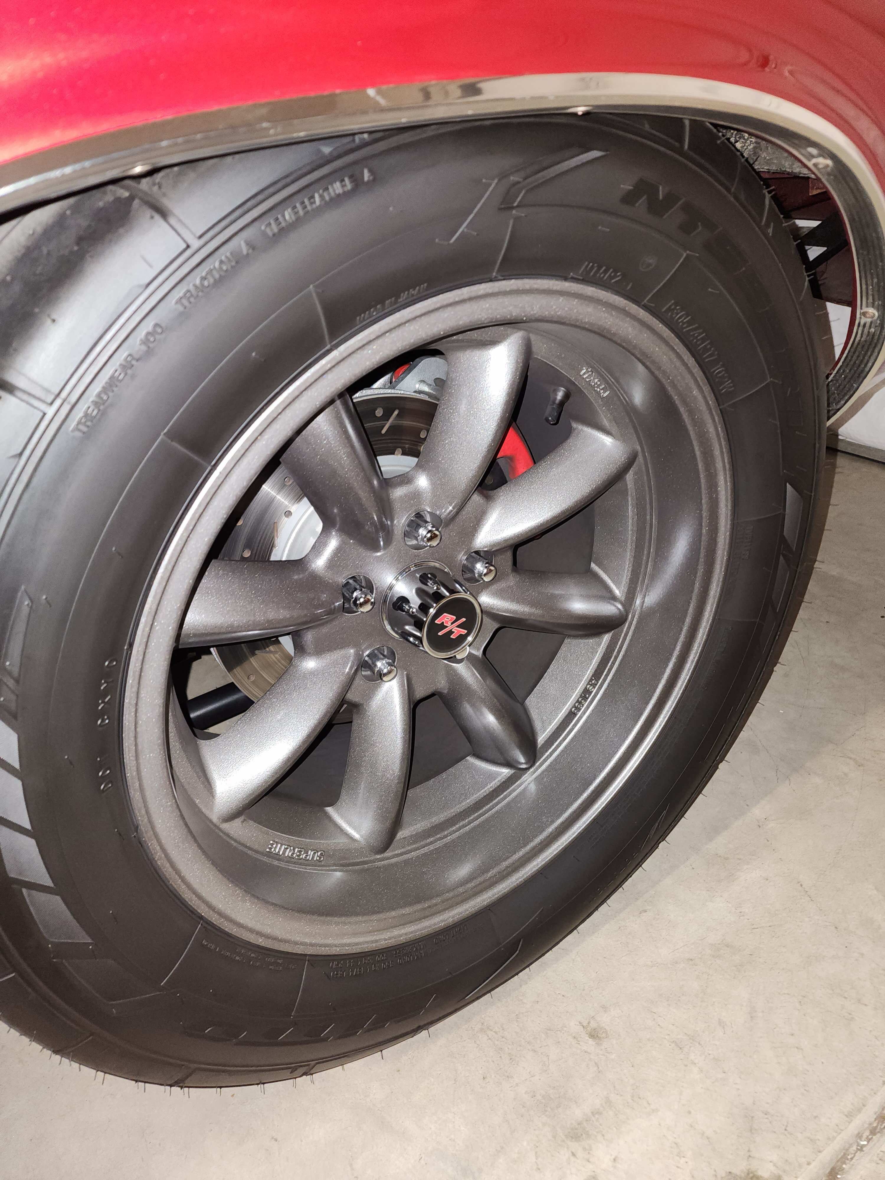

New setup, I just finished completely updating/upgrading the suspension and brakes. 17"'x 305 DR's.

Thanks! I'm pretty happy with it.
What rims are those? Do they have "R/T" on the center caps? They look really stylish. I think you have it really going on with this one. A full build profile in another thread would be nice. Too bad they don't have those magazines with the centerfolds for cars anymore.
