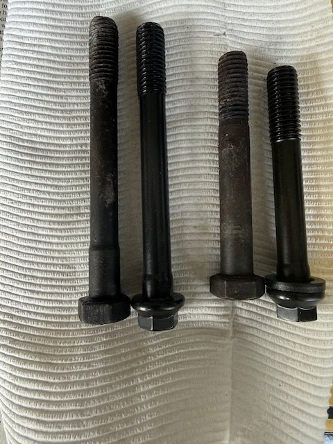

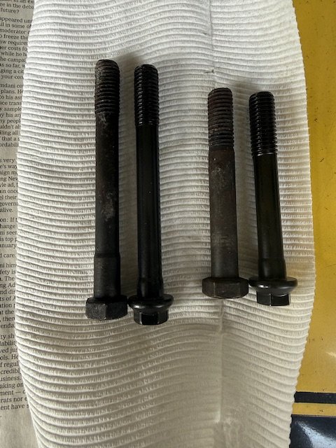

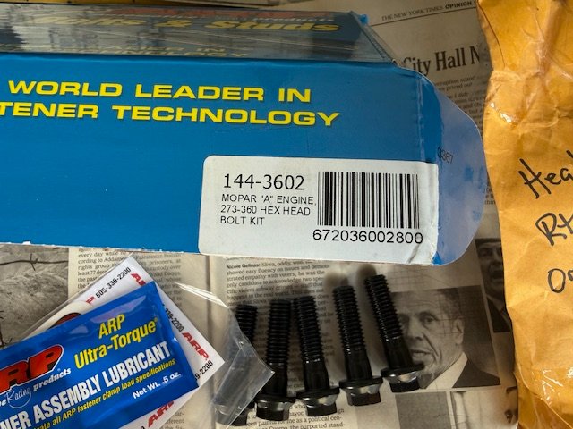

Could use some feedback for my own A66 vert. Rebuilt the 340 engine and installed the Edelbrock heads designed for the high compression, above deck pistons along with an LD 340. Ran great with this combo; decided to go back to stock with the original cast iron 2.02 heads and stock intake. I have the original head bolts but bought a set of ARP head bolts 144-3602 designed for A block installation (non aluminum heads) The new bolts are slightly shorter then the stock bolts and also come with washers. Original head bolts do not use washers! QUESTIONS; Should I use the ARP bolts with or without the washers? If I do, they would be even shorter then stock. The ARP bolts already have a large flat area below the head. Has any one used ARP bolts as replacements on their 340? Thanks for anyone's thoughts! Phil

Don't throw out the ARP. Contact them on their tech line and find out from the horses mouth.
They design, test their products. Trust their opinion first.

The reason I suggested using the stock bolts is they can only be used with iron heads.
The washers on the ARP allow the soft aluminum head to be protected from the fastener as it tightens.
ARP makes good stuff.
You could sell the ARP bolts to someone who is going to use aluminum heads.
Side note: Only one complete thread holds all the torque. Strange, but that's the way it is.
