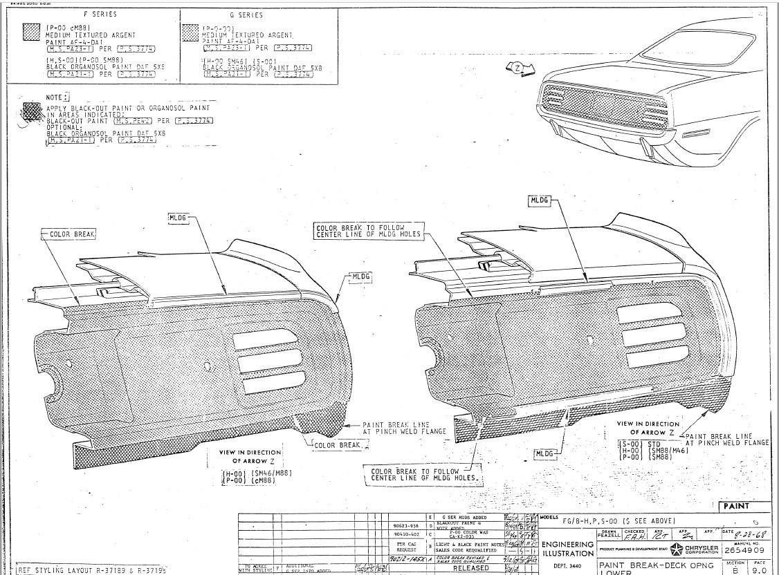

The below graphic shows the three available tail panel treatments and the engineering drawing for the BP & BS models for paint.

Thank you MCG! Exactly what I was looking for.
I have a BH27 L code. The BH example is exactly what I want.
