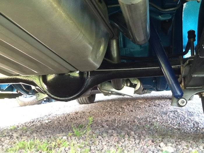

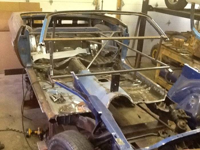

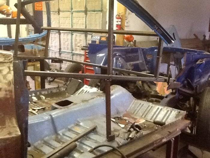

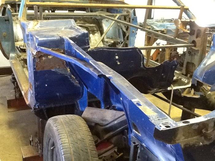

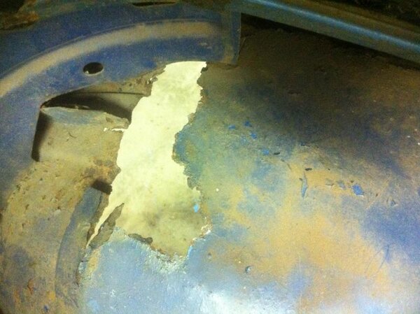

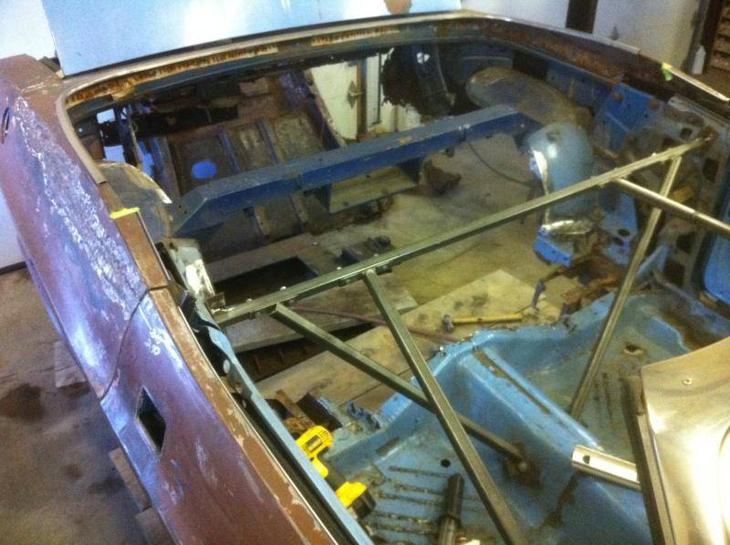

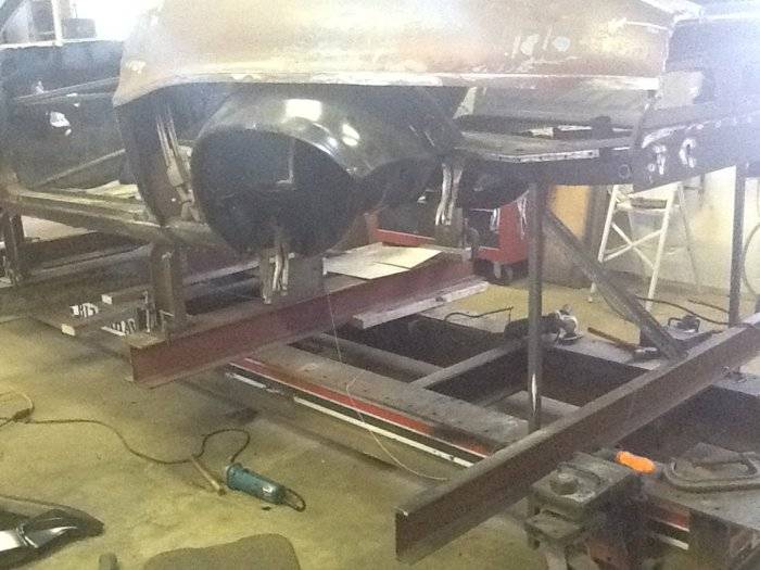

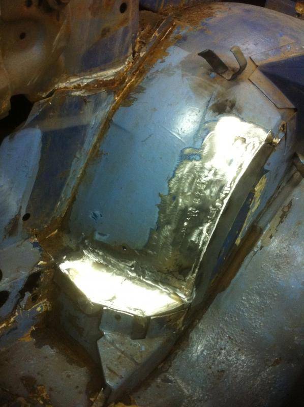

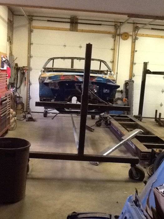

May 22, 2019 #3 4 4sixty2fairlane Active Member Joined Jan 28, 2013 Messages 30 Reaction score 5 Location eastern Canada I forgot about starting this build post. Had to scramble to find allot of the parts but it goes to show almost anything can be built. I wouldn’t recommend trying something like this without a frame jig. I got the car finished a few years ago.

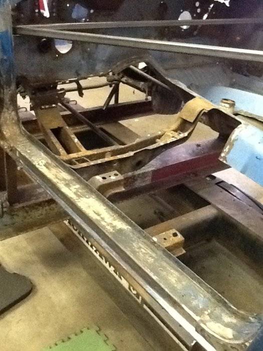

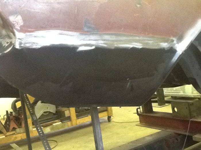

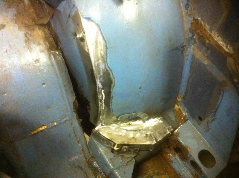

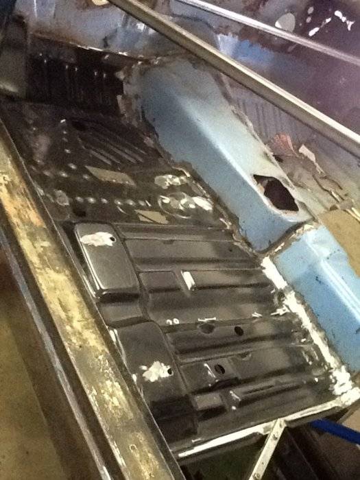

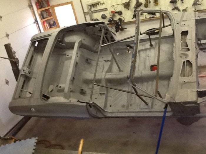

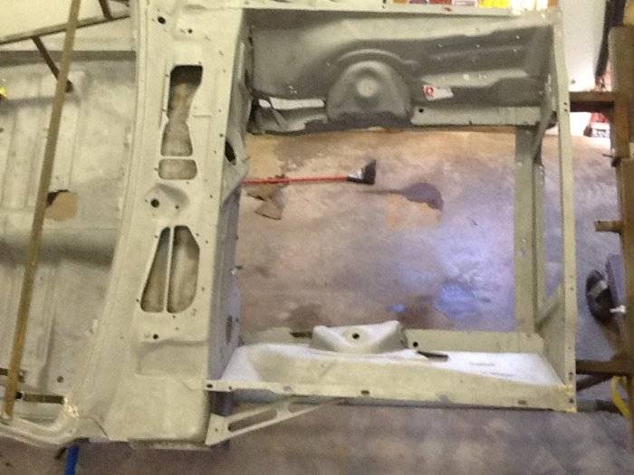

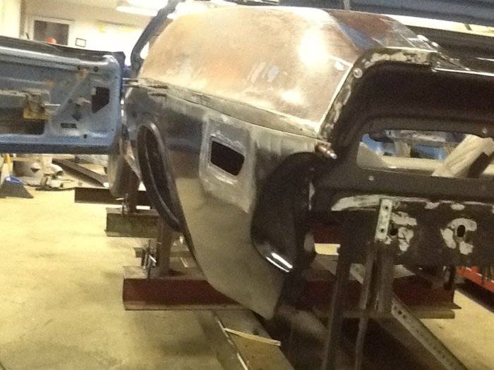

May 22, 2019 #4 4 4sixty2fairlane Active Member Joined Jan 28, 2013 Messages 30 Reaction score 5 Location eastern Canada The only floor pan that wasn’t replaced was the front passenger side

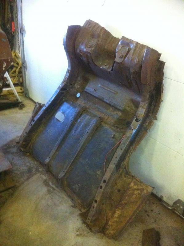

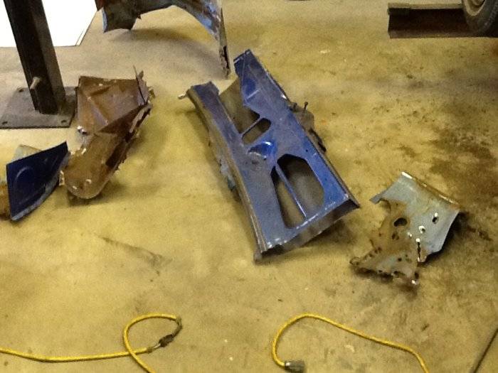

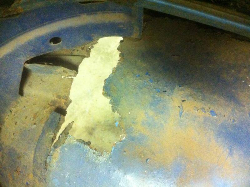

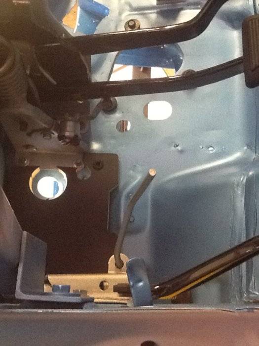

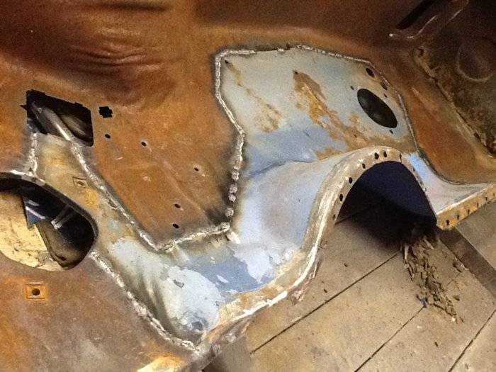

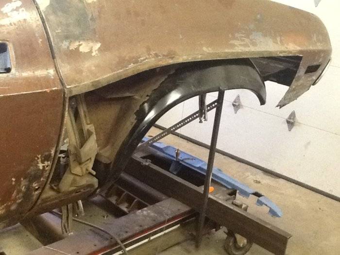

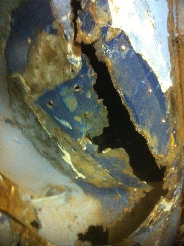

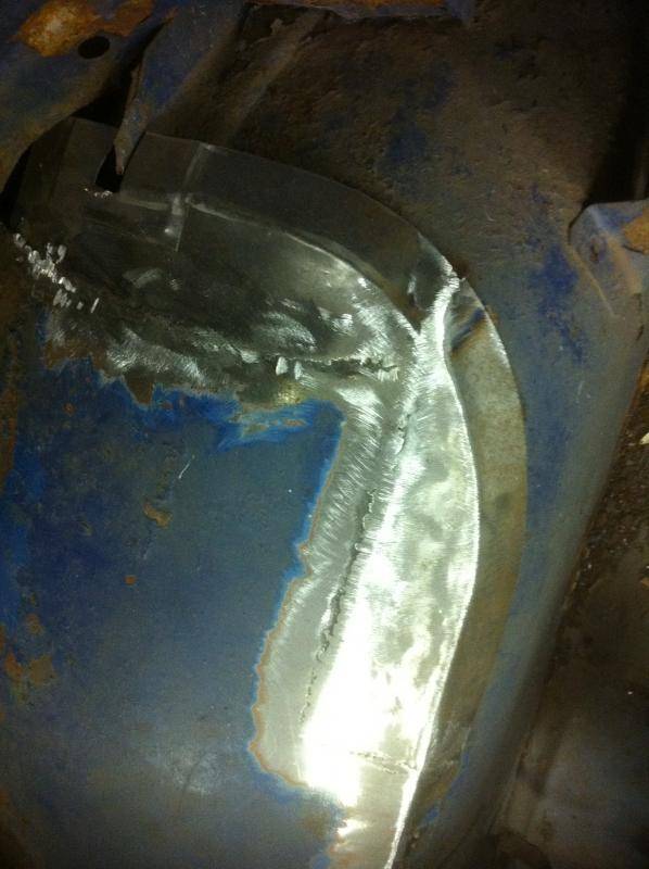

May 22, 2019 #5 4 4sixty2fairlane Active Member Joined Jan 28, 2013 Messages 30 Reaction score 5 Location eastern Canada Firewall and door hinge area was swiss cheese. Ordered one from Desert Valley. It was out of an ac car so i had to graft the two together.

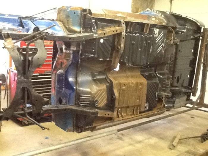

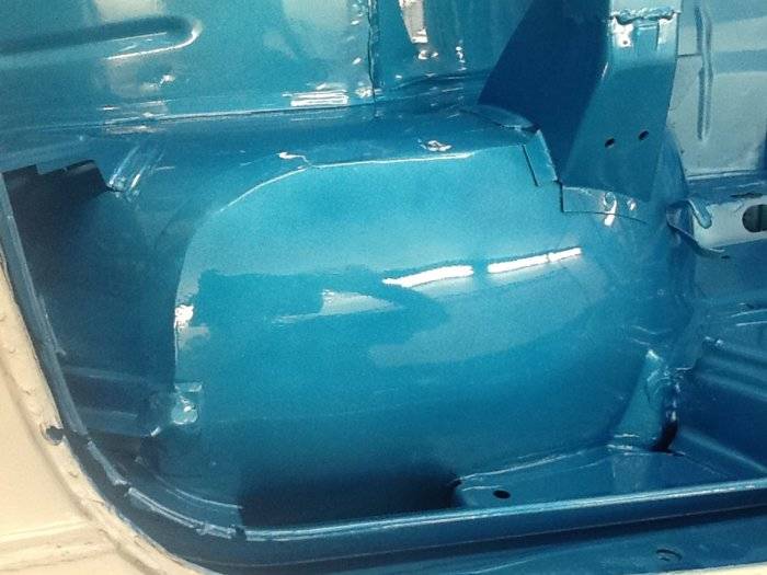

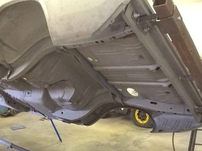

May 22, 2019 #6 4 4sixty2fairlane Active Member Joined Jan 28, 2013 Messages 30 Reaction score 5 Location eastern Canada Obviously this is the quick version. The owner took tons of pictures.

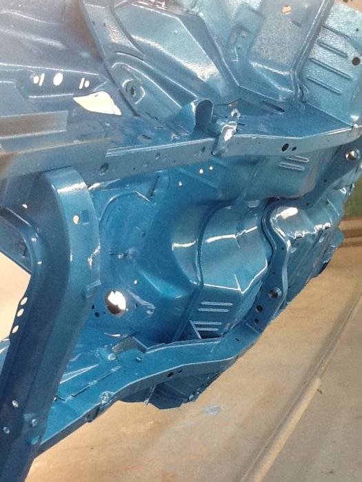

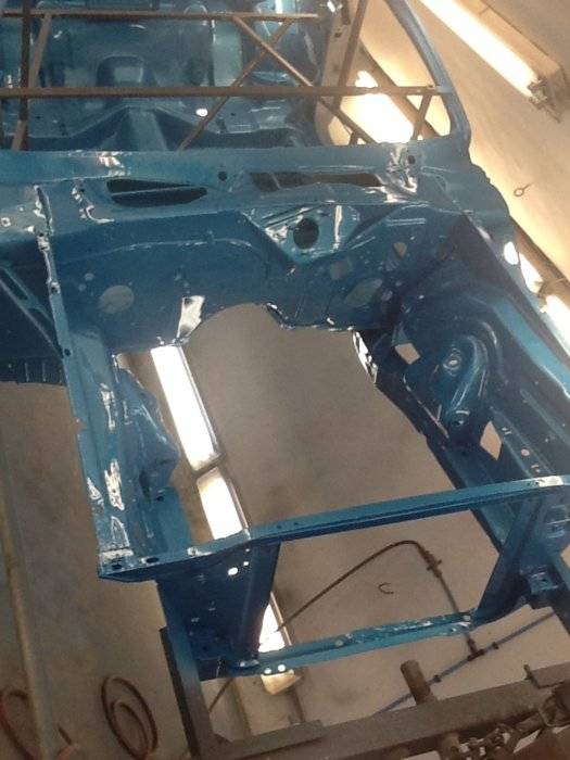

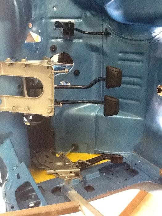

May 22, 2019 #7 4 4sixty2fairlane Active Member Joined Jan 28, 2013 Messages 30 Reaction score 5 Location eastern Canada B5 blue.

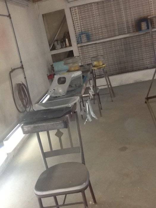

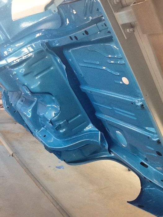

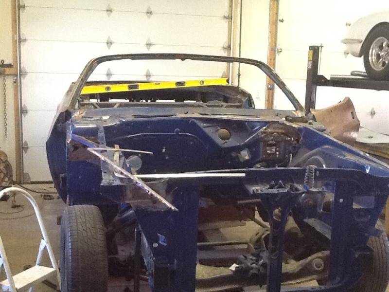

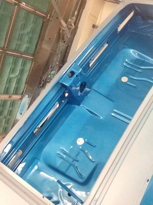

May 22, 2019 #8 4 4sixty2fairlane Active Member Joined Jan 28, 2013 Messages 30 Reaction score 5 Location eastern Canada Seemed like a never ending booth full of parts to paint. It wasn’t a 100% accurate just off the line resto. Just wanted to look clean.

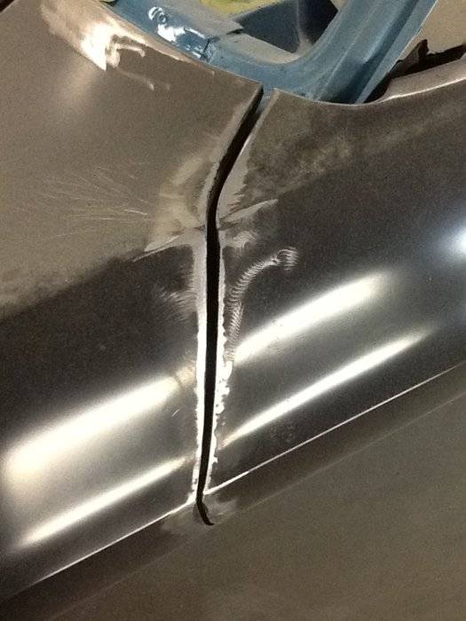

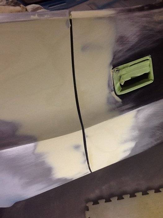

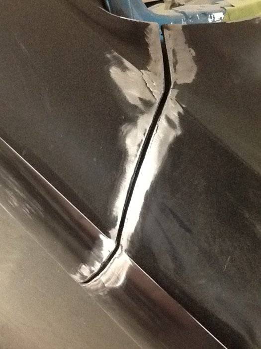

May 22, 2019 #9 4 4sixty2fairlane Active Member Joined Jan 28, 2013 Messages 30 Reaction score 5 Location eastern Canada Typical gapping issues.

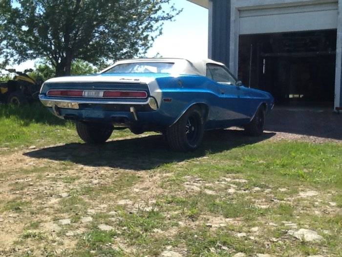

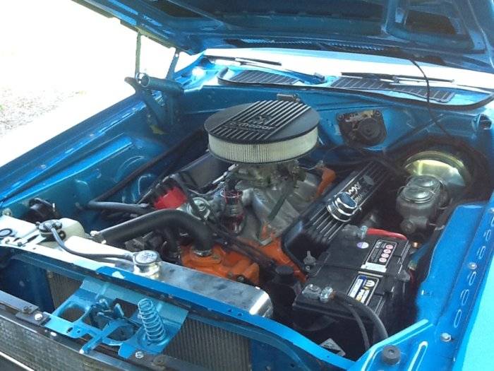

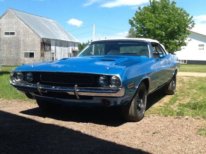

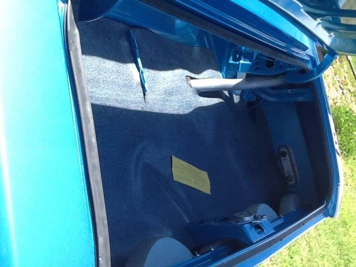

May 22, 2019 #10 4 4sixty2fairlane Active Member Joined Jan 28, 2013 Messages 30 Reaction score 5 Location eastern Canada And just like on tv it’s finished.
