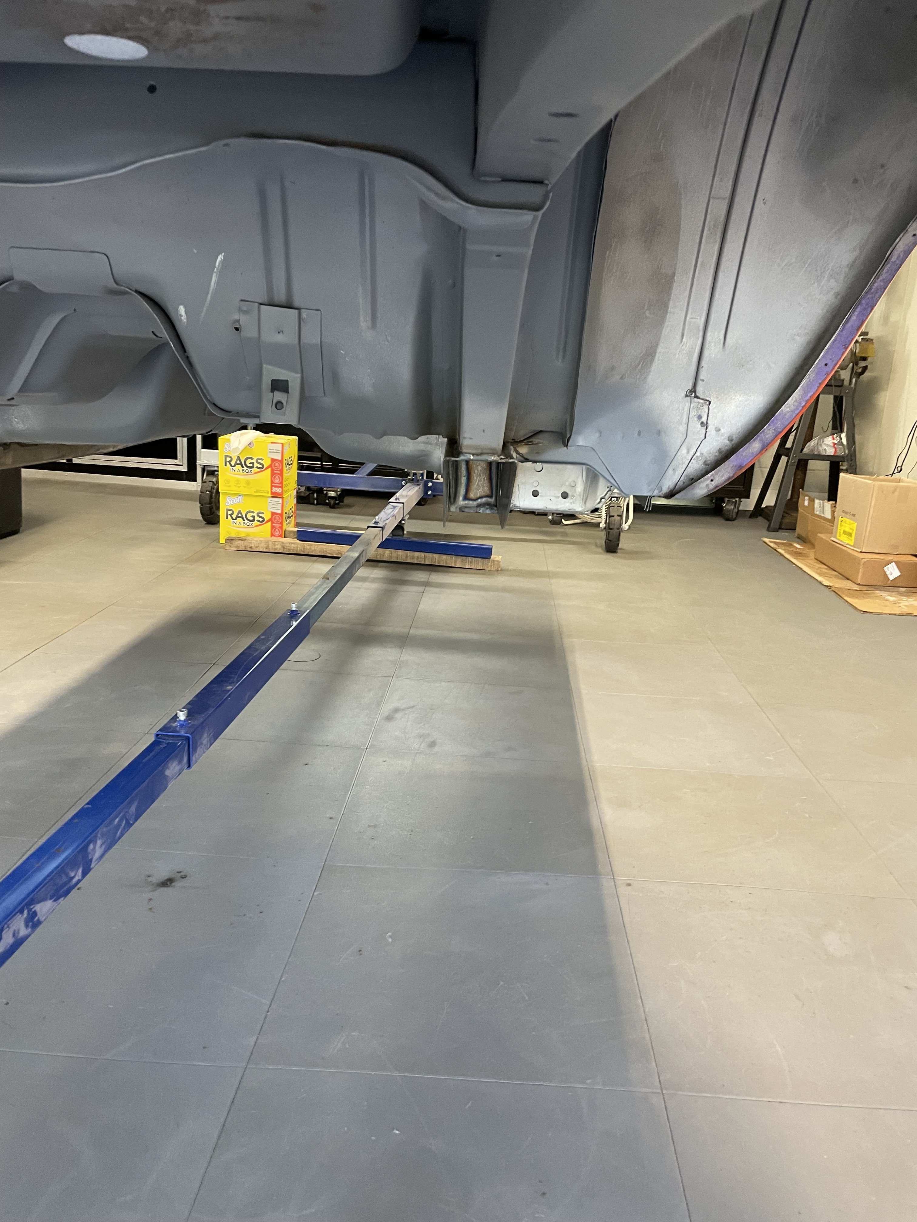

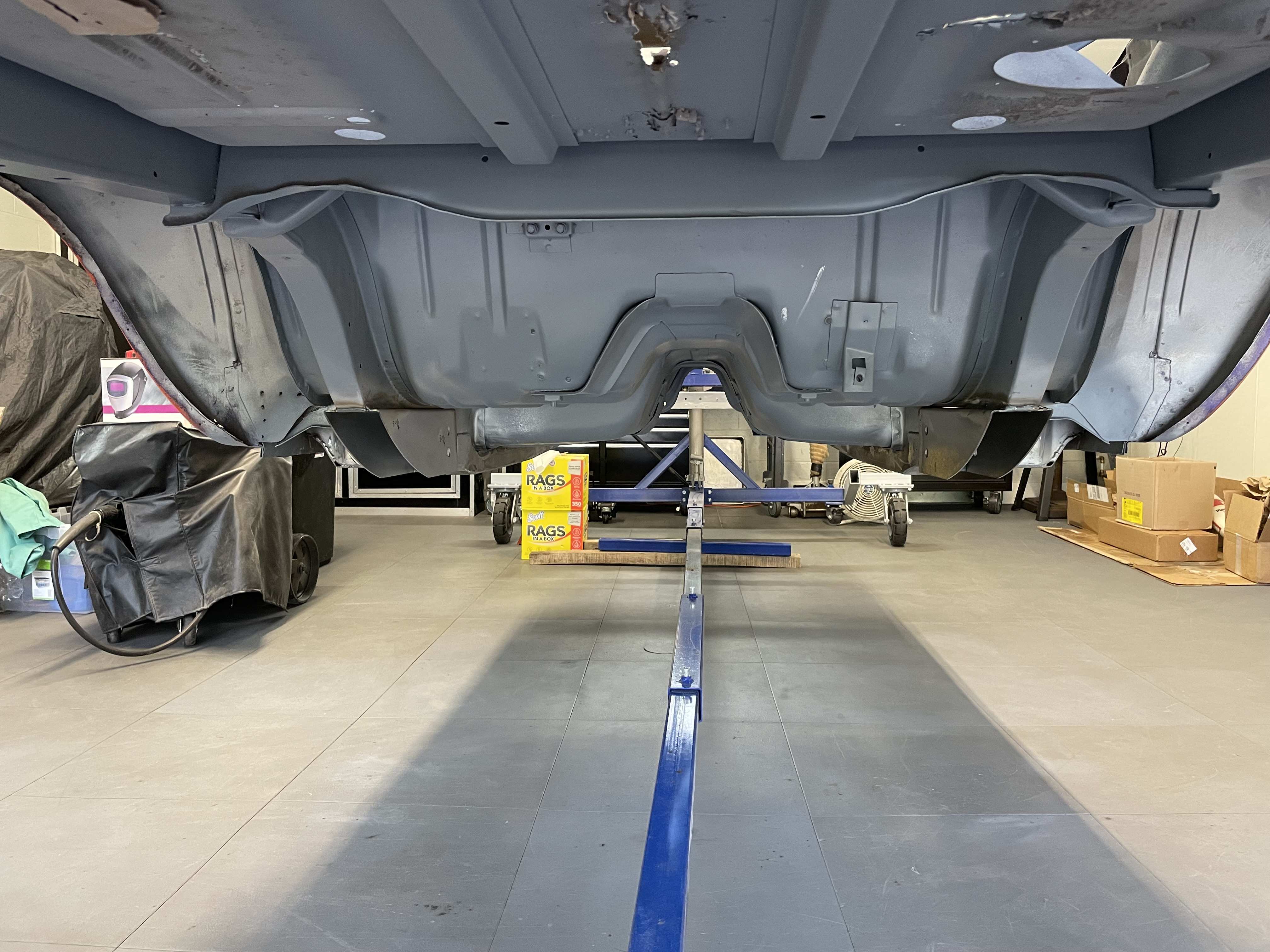

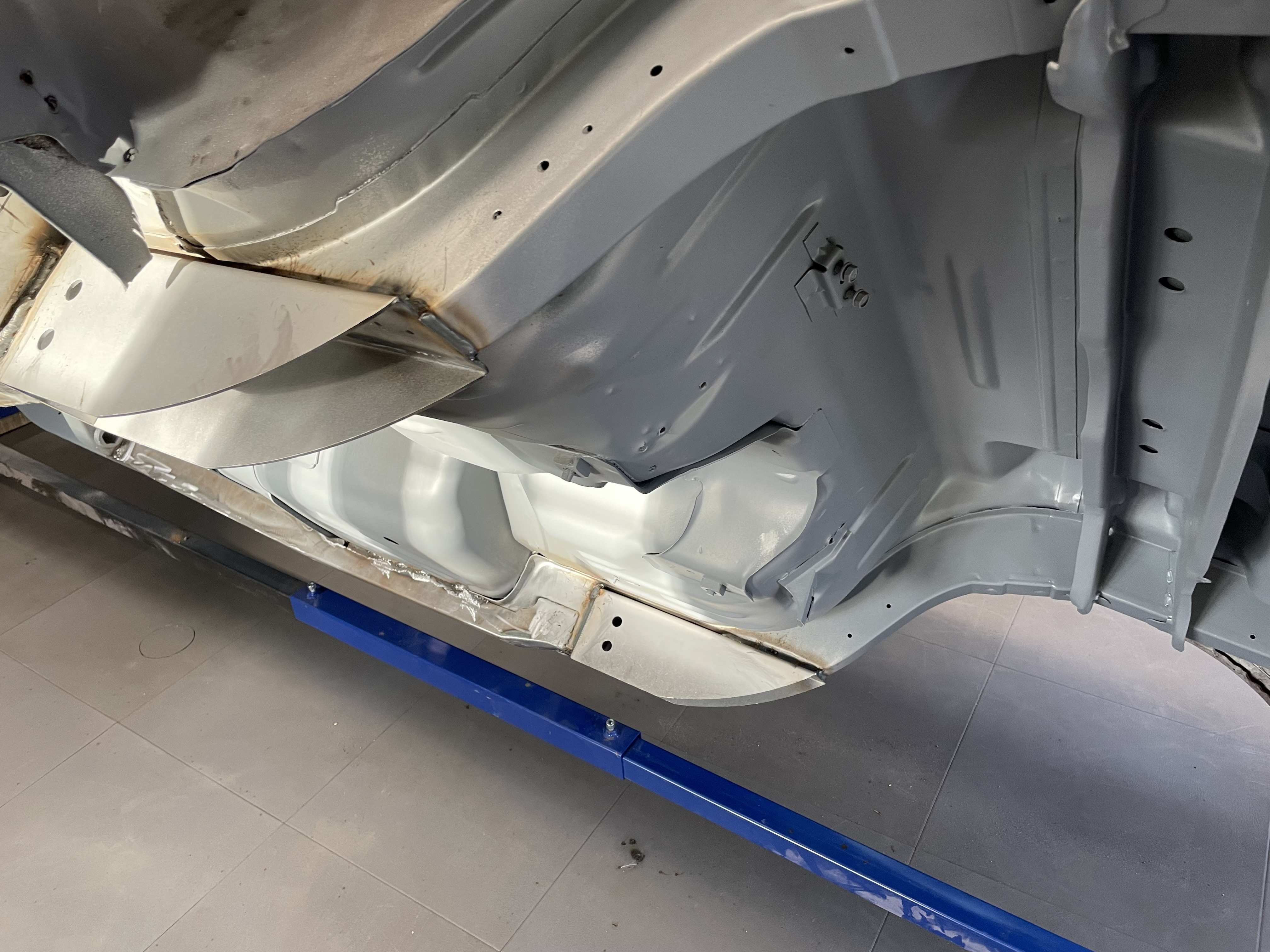

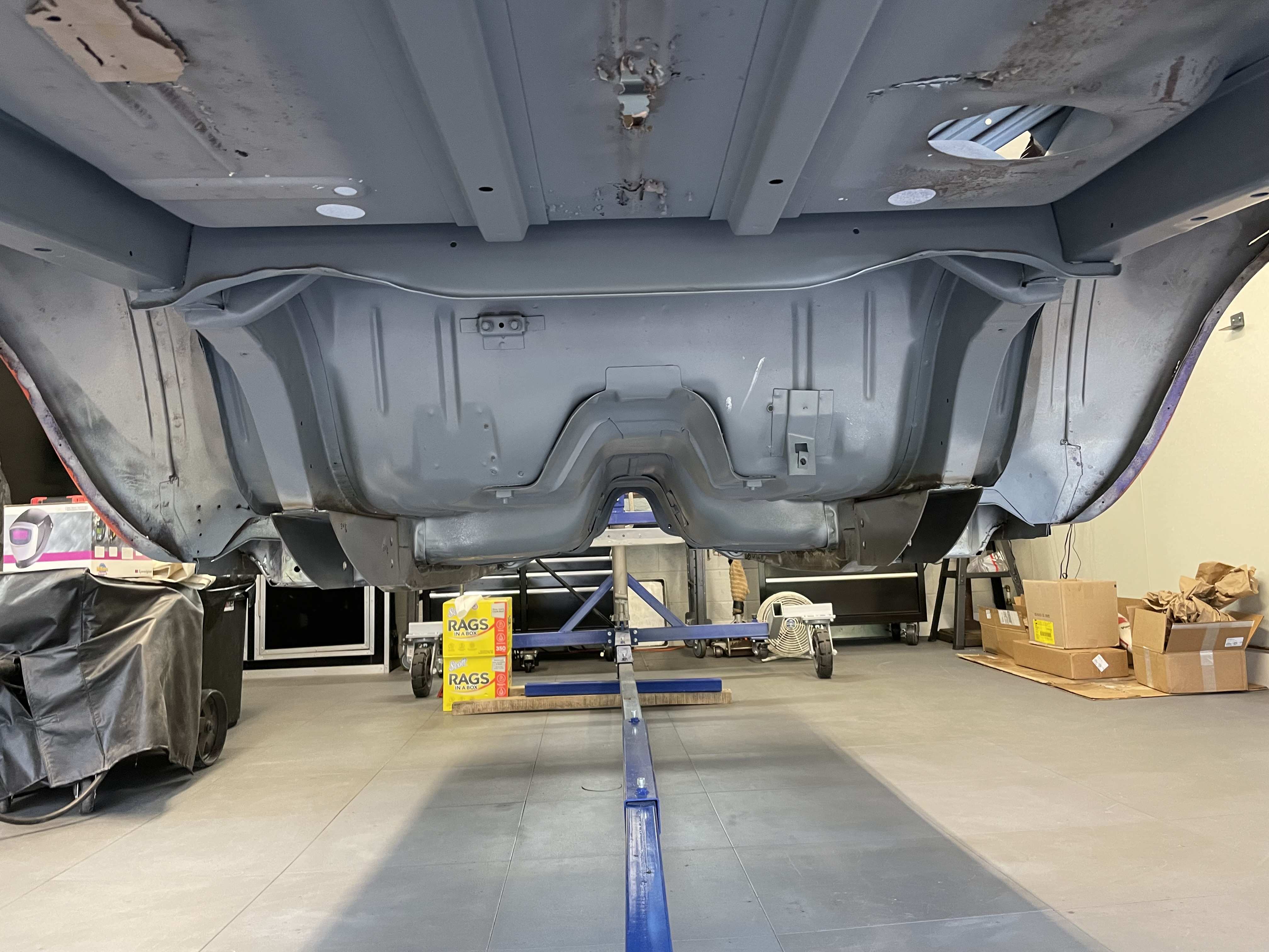

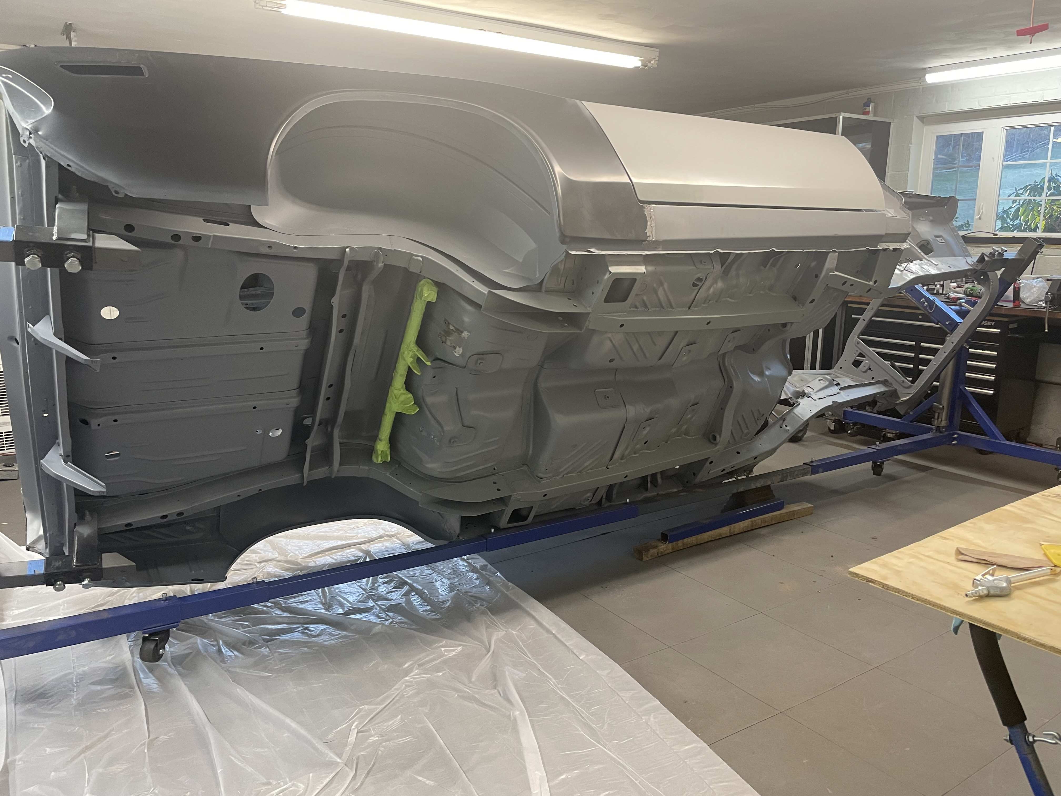

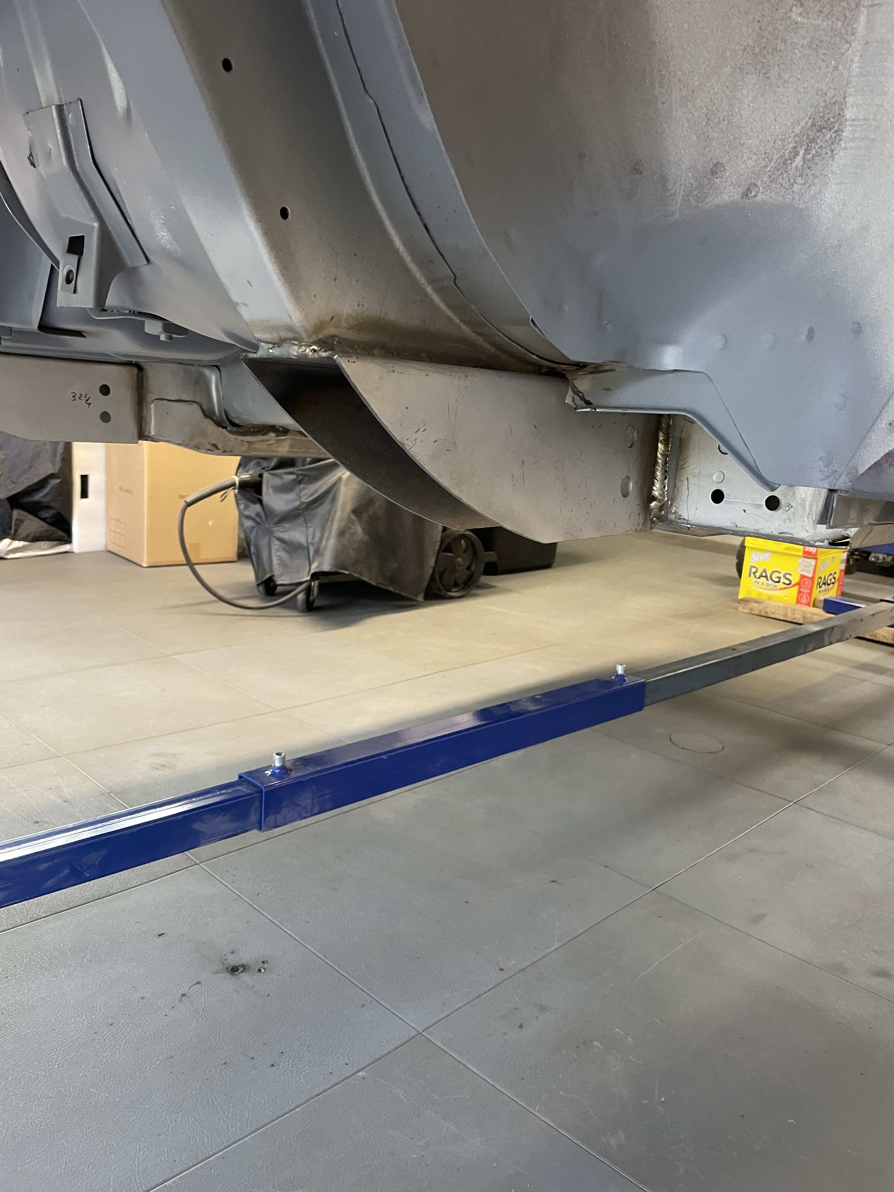

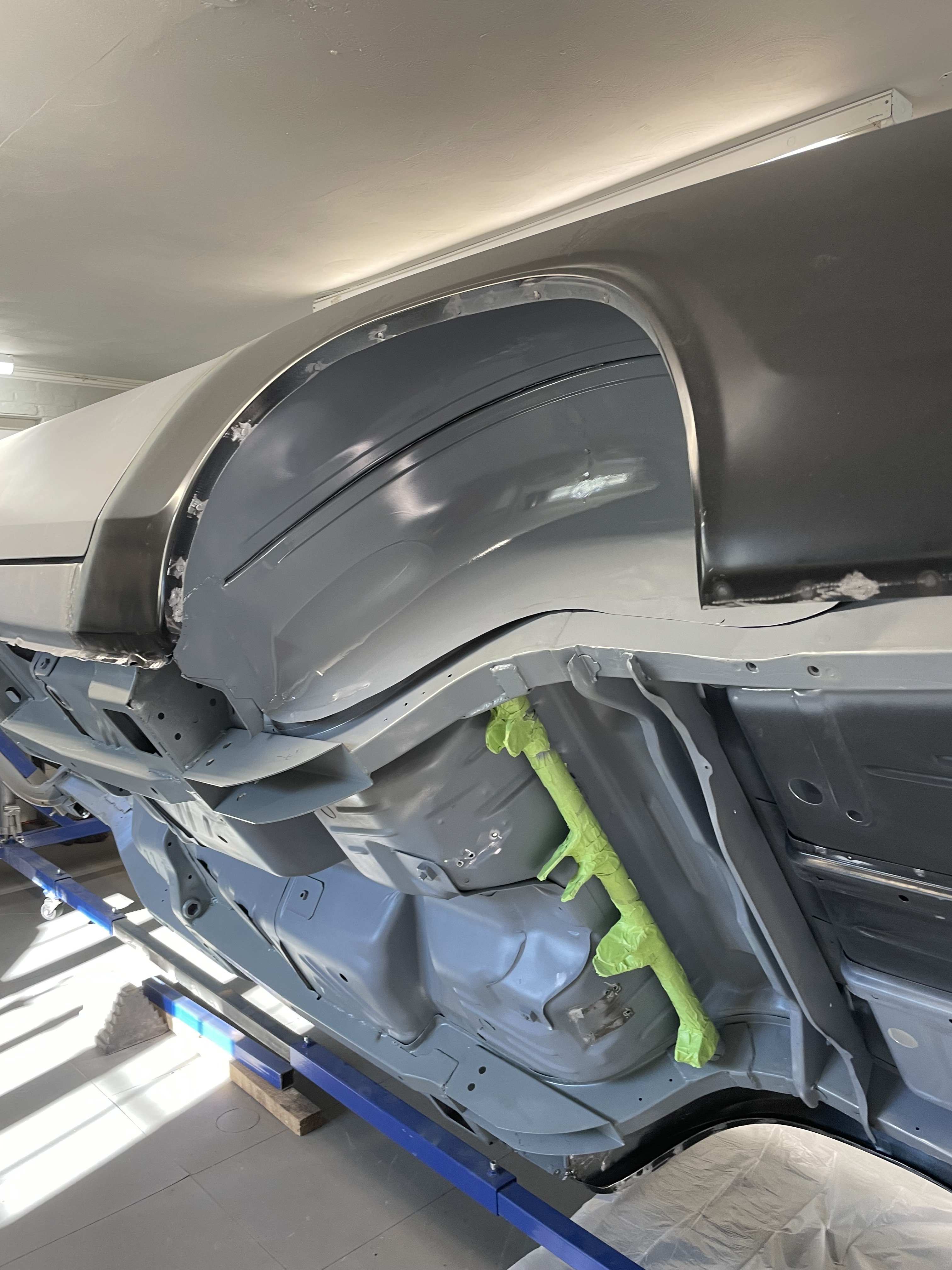

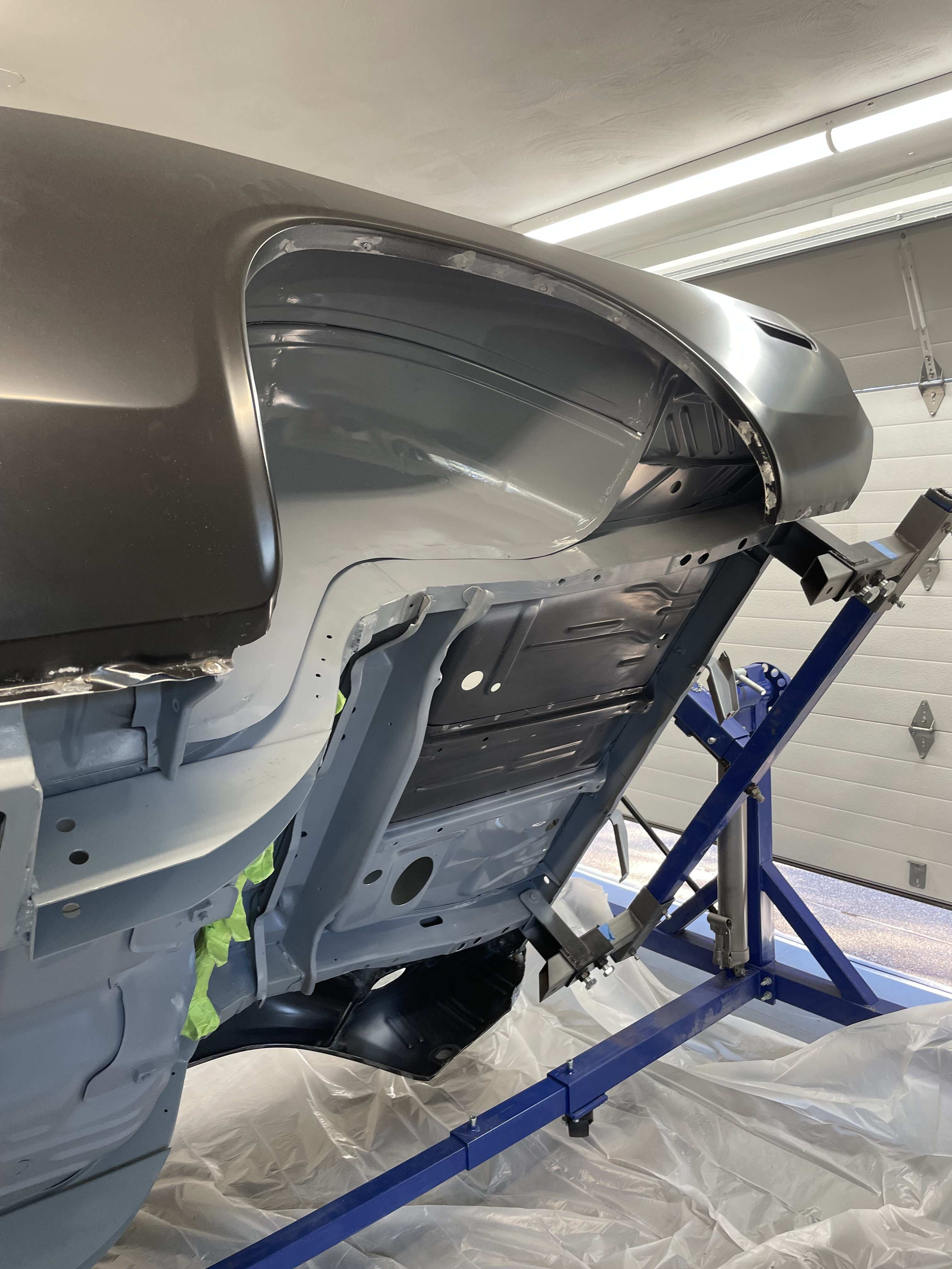

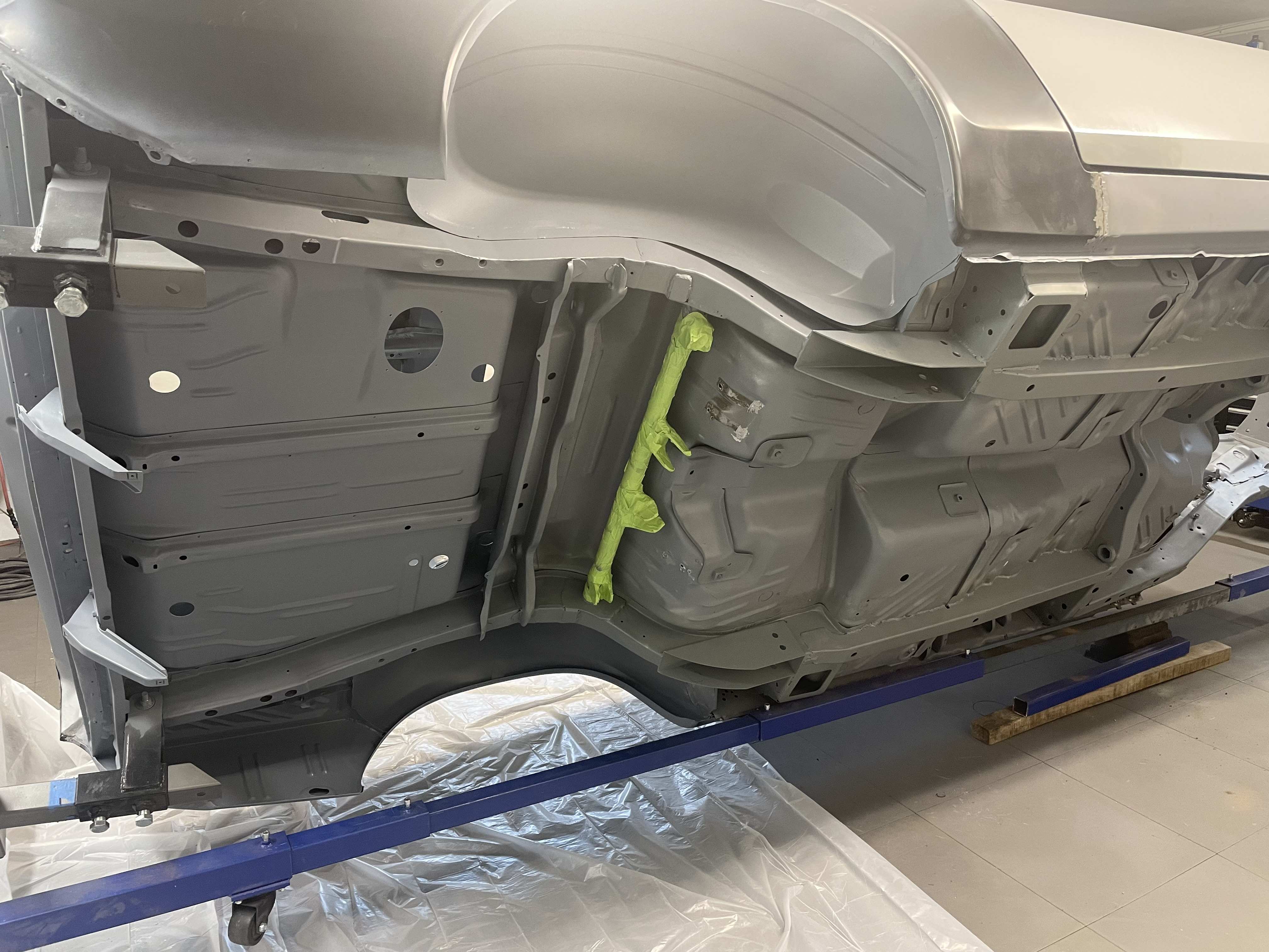

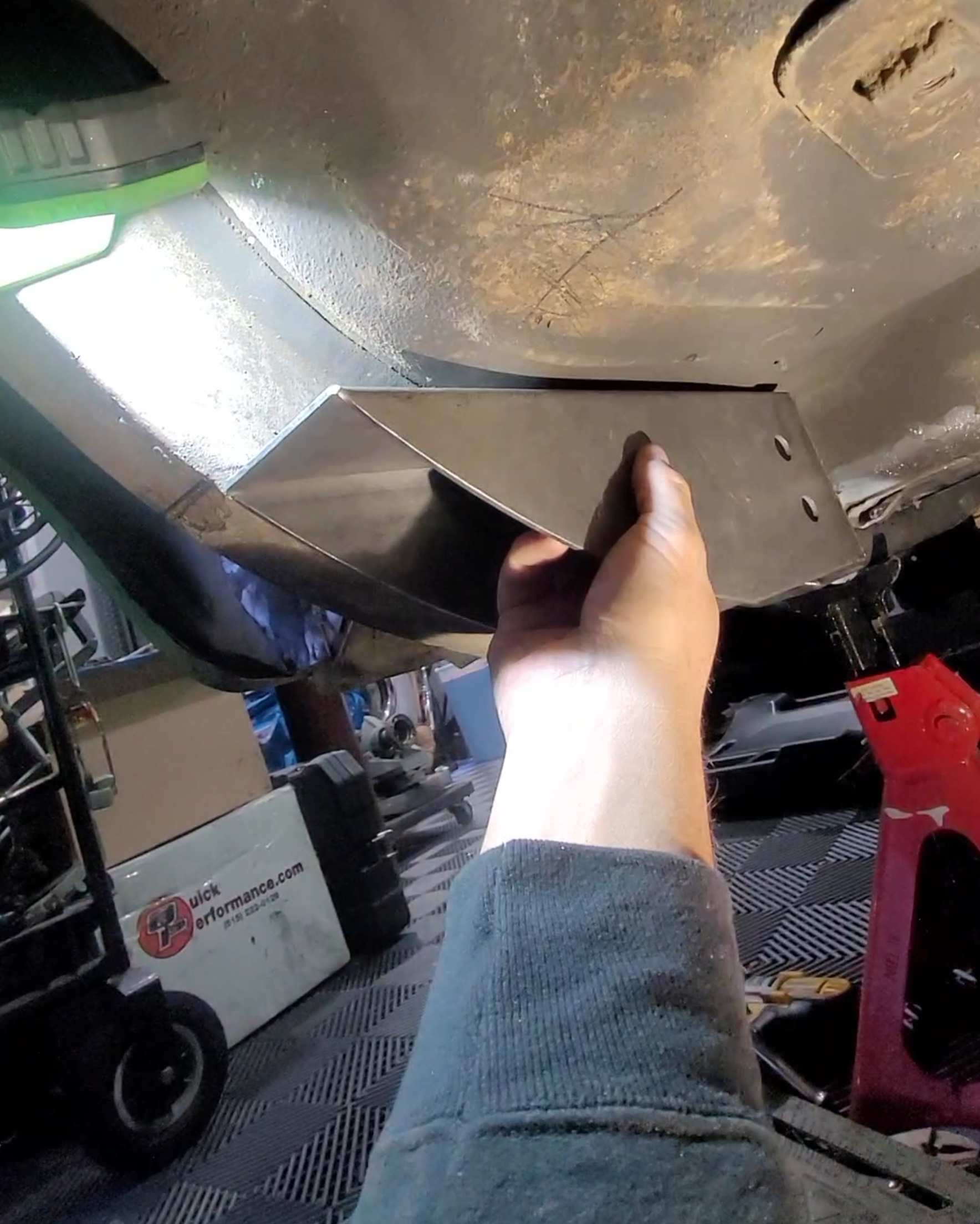

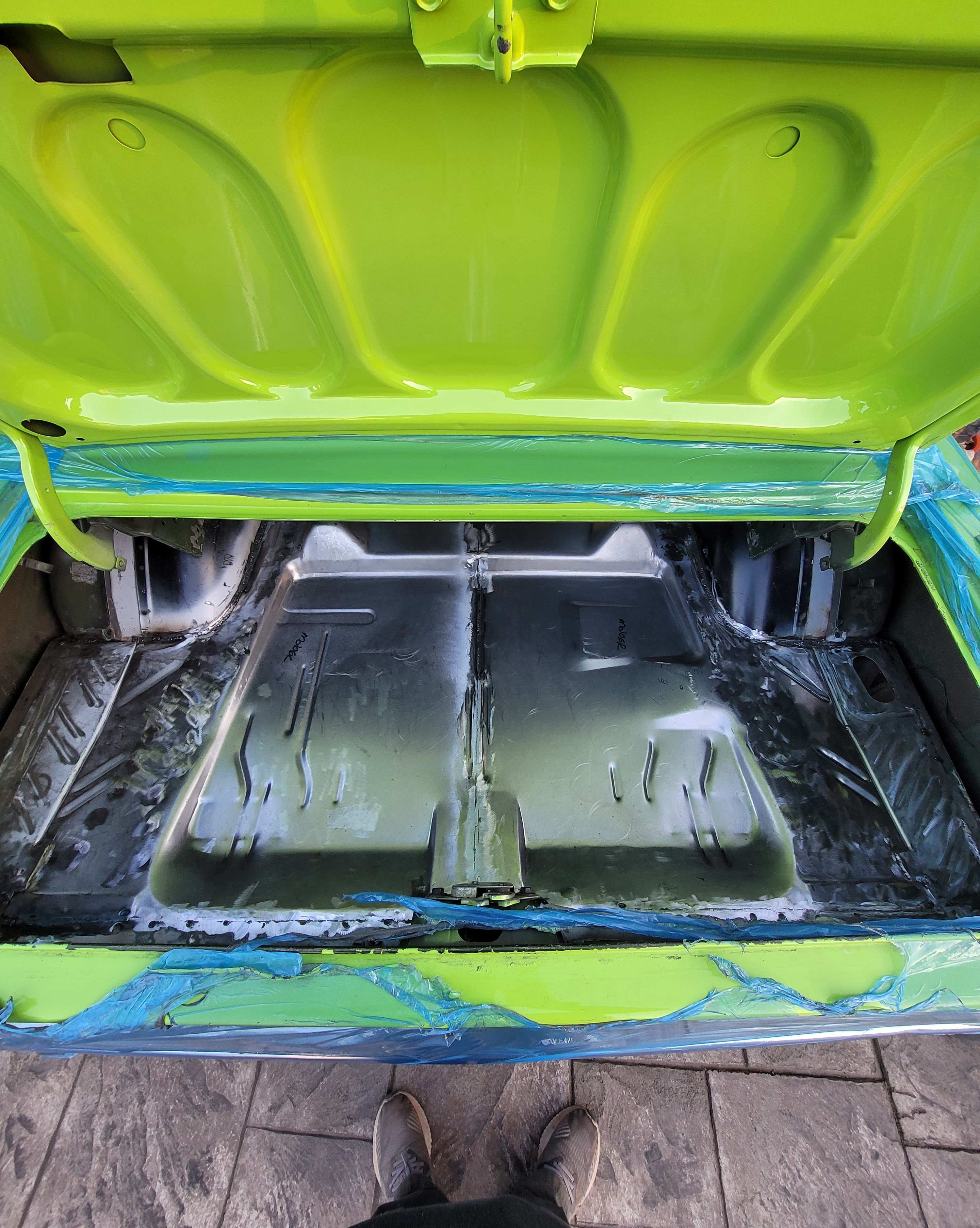

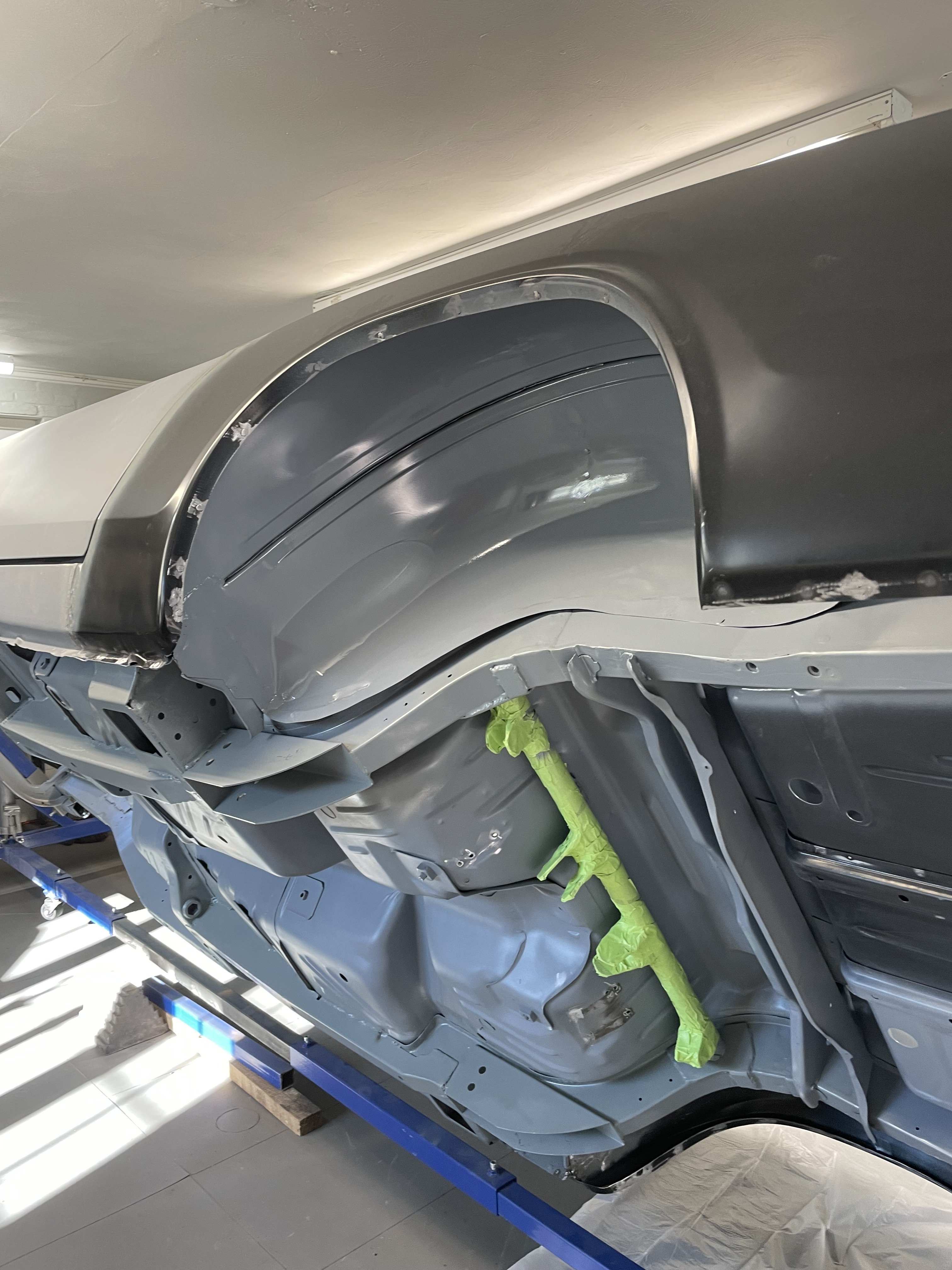

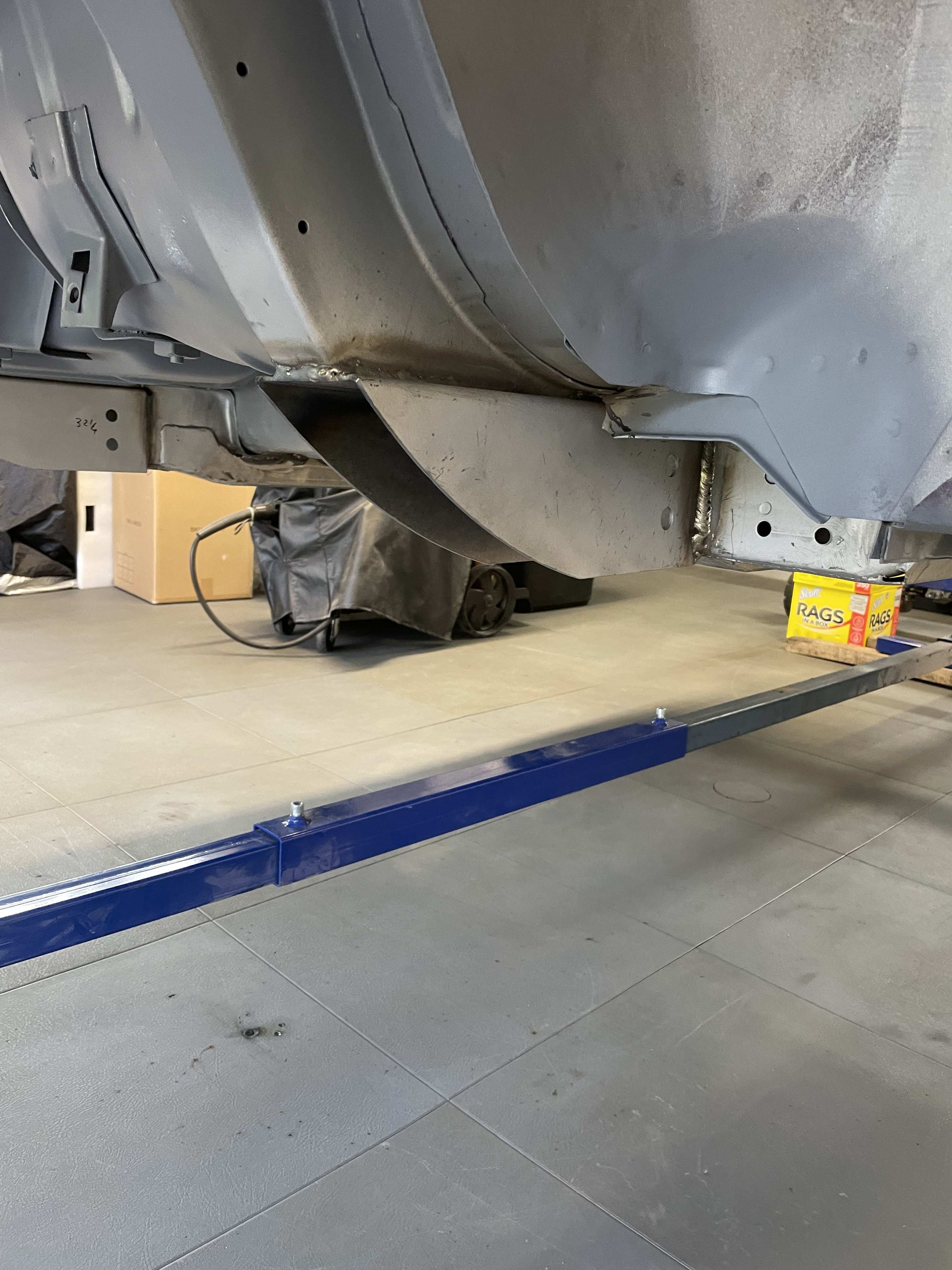

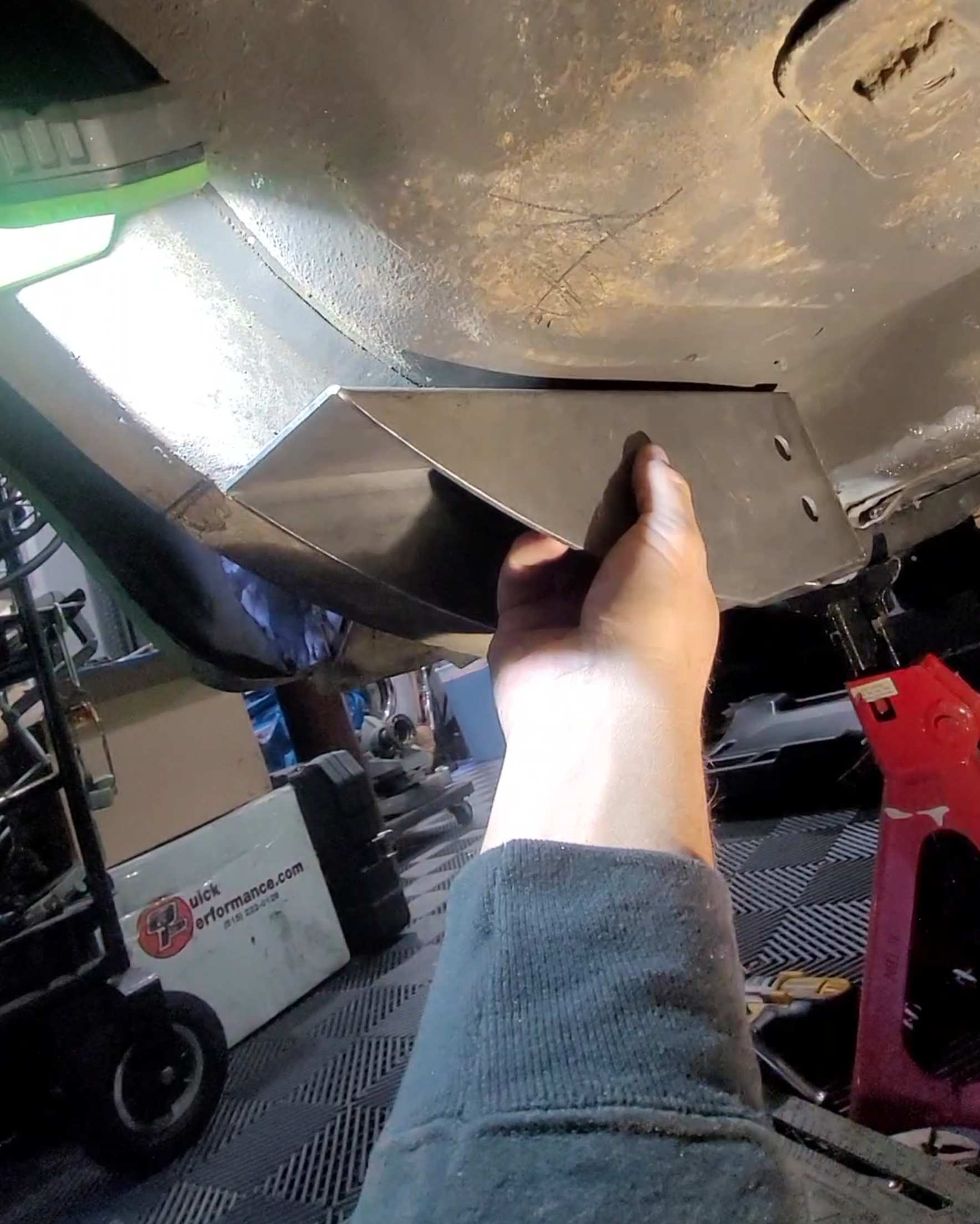

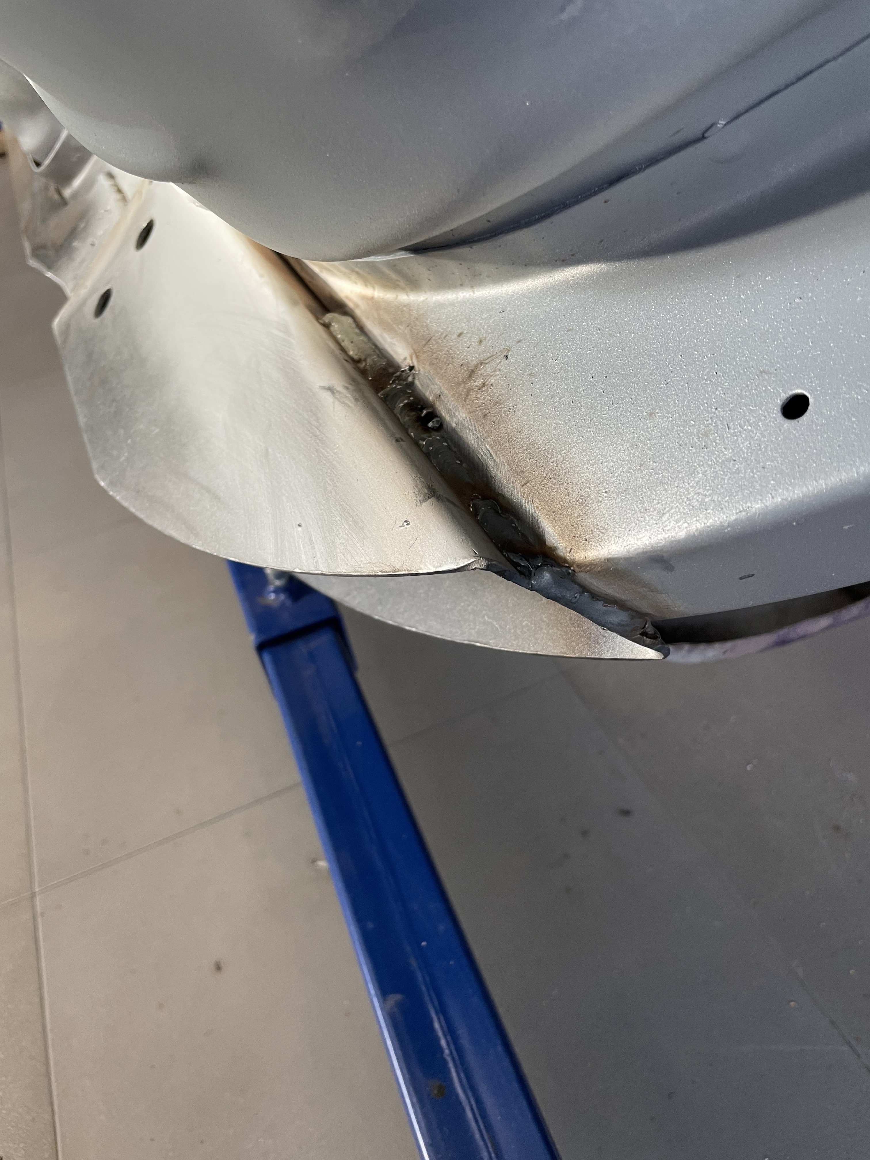

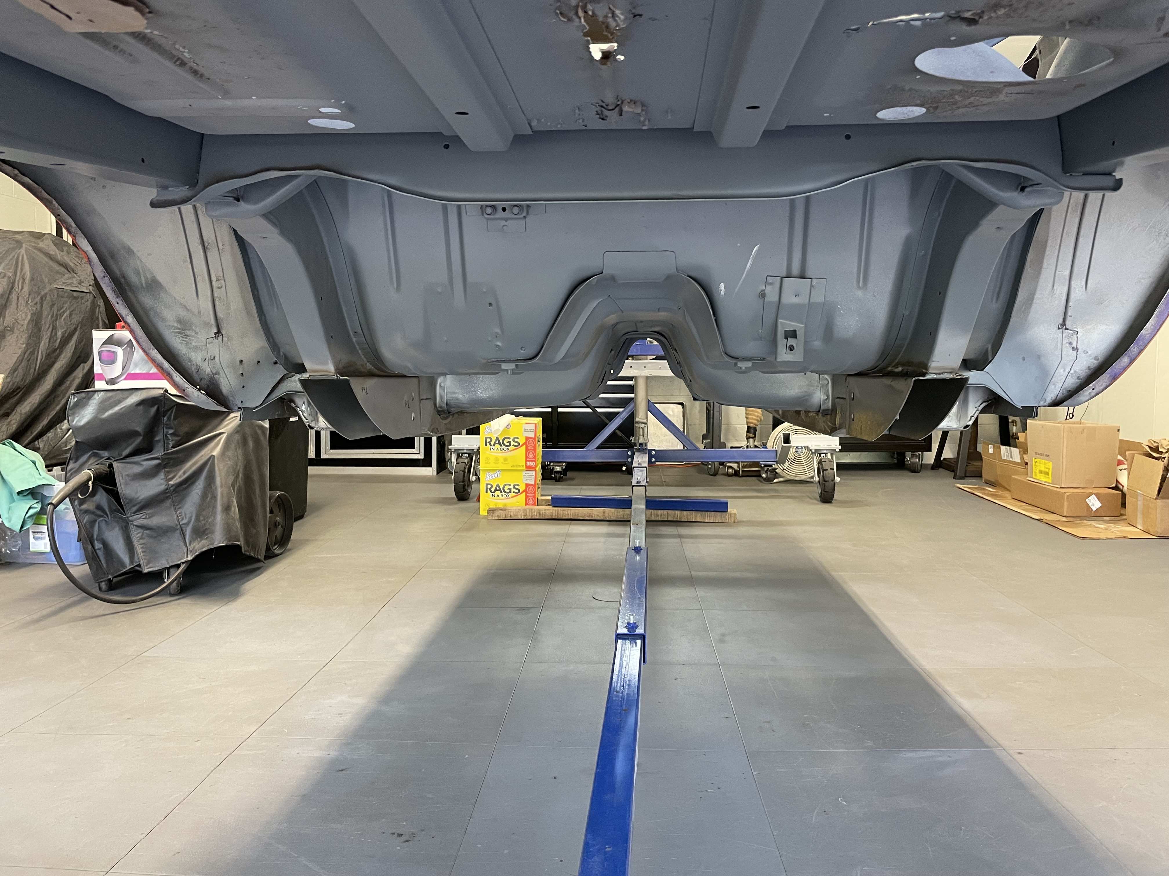

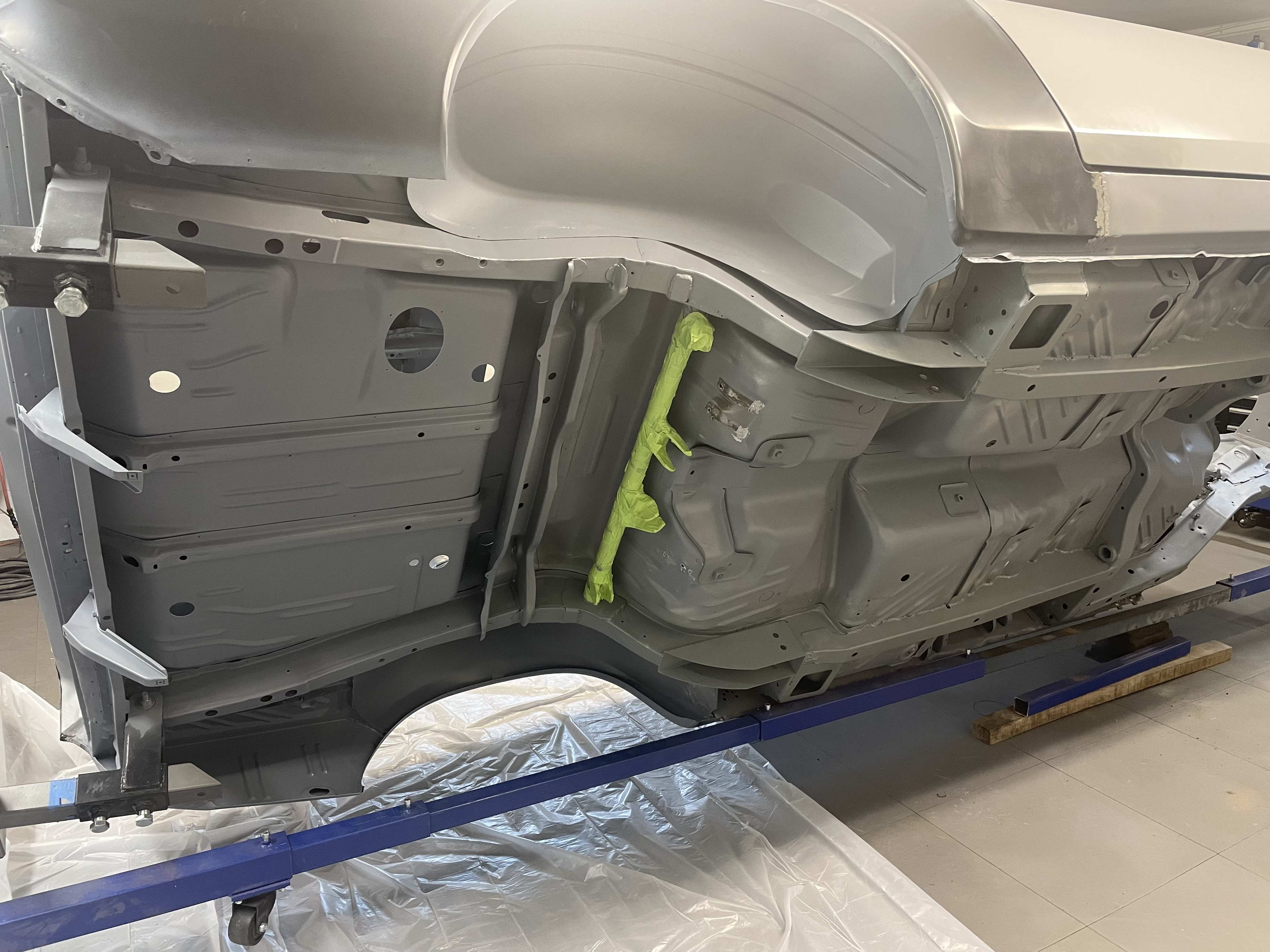

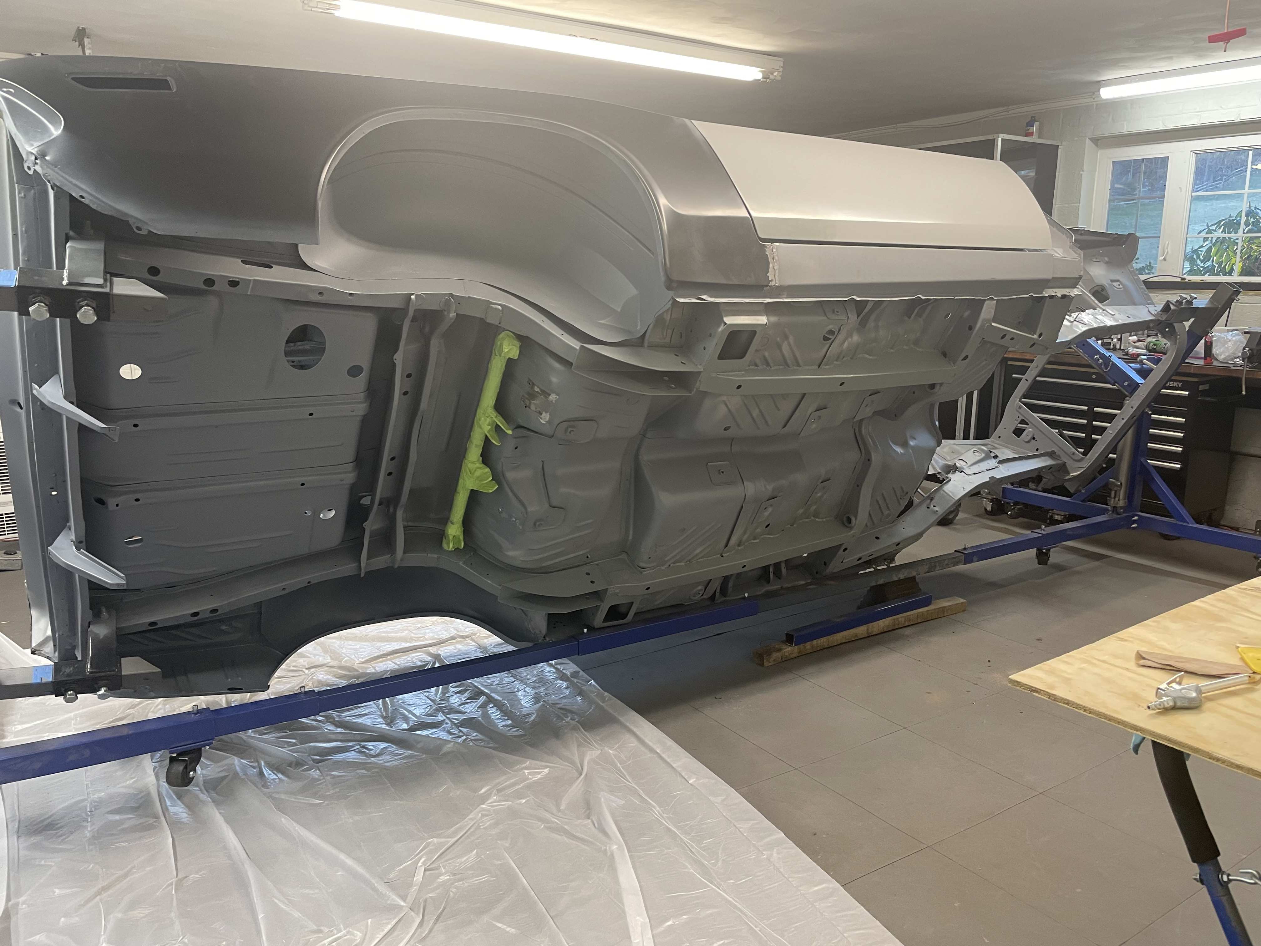

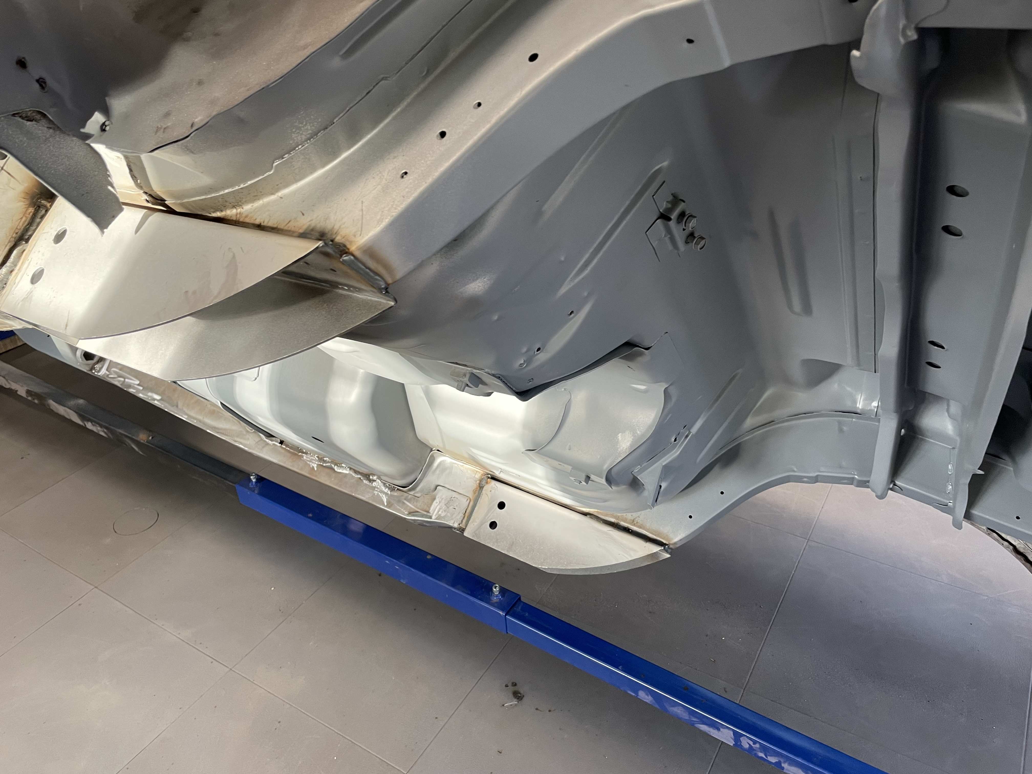

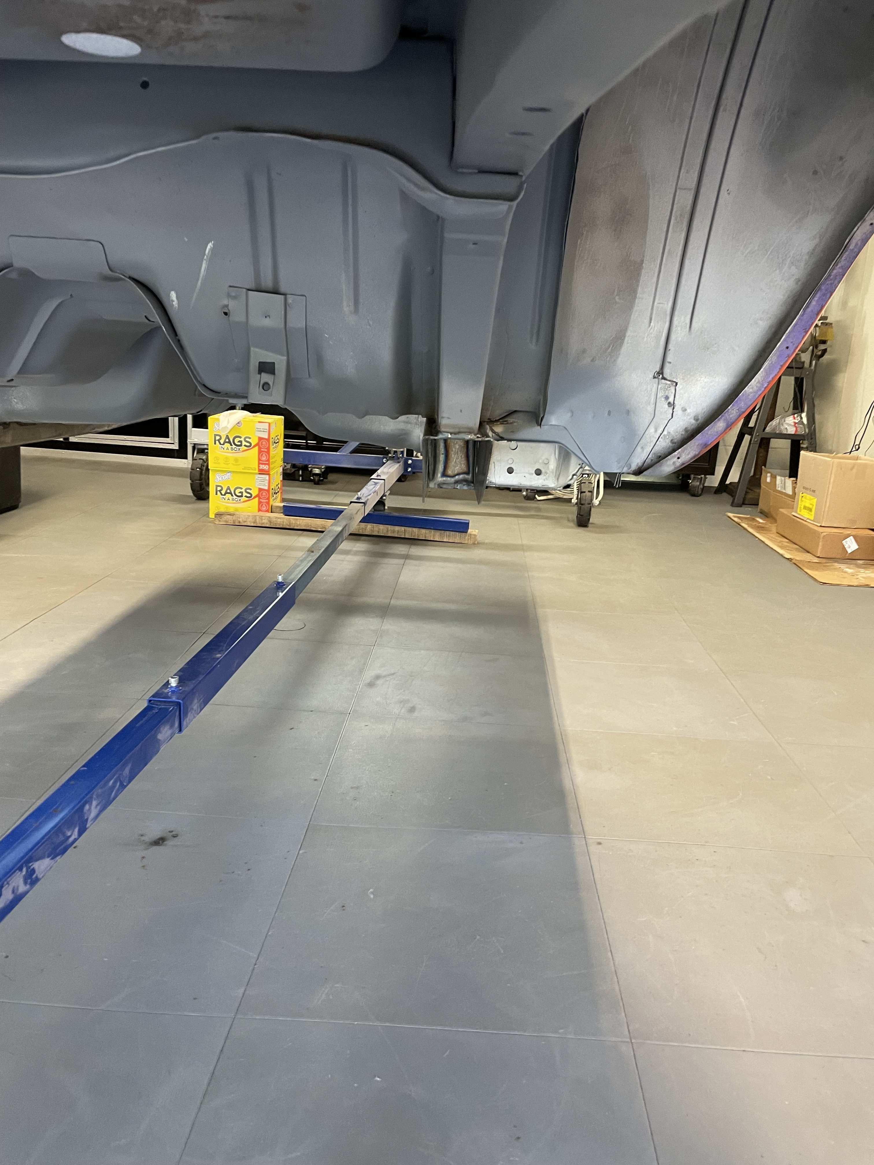

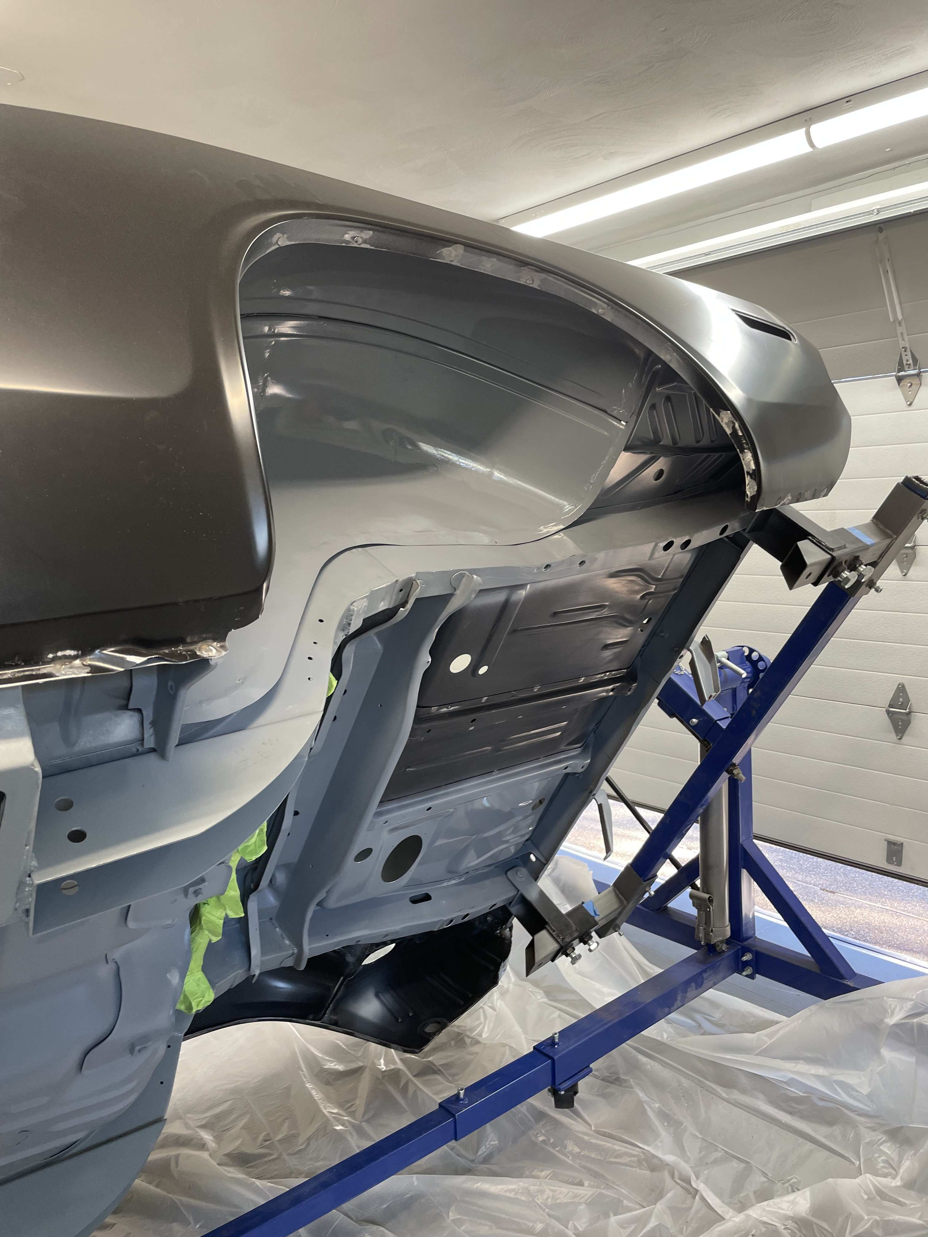

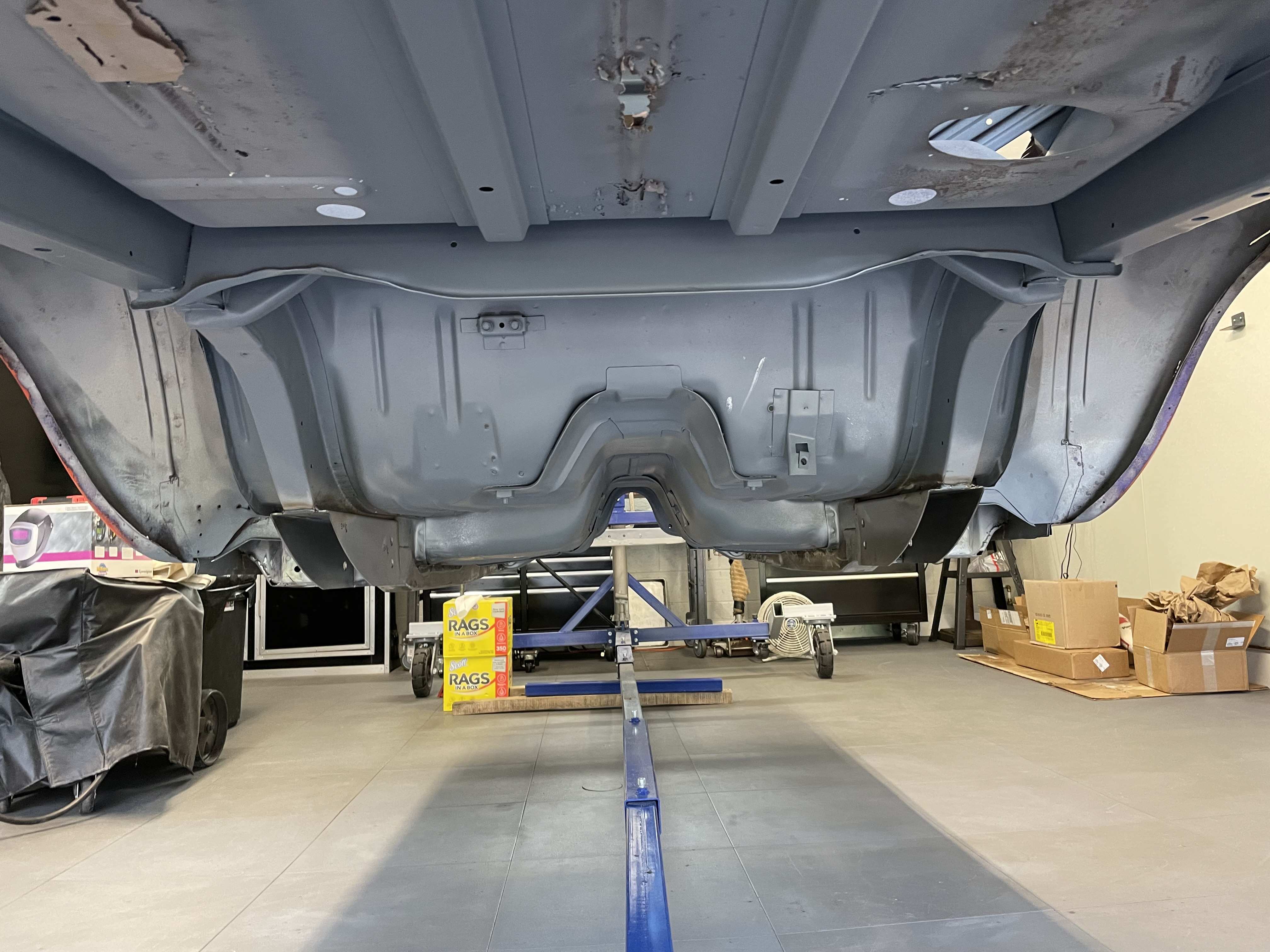

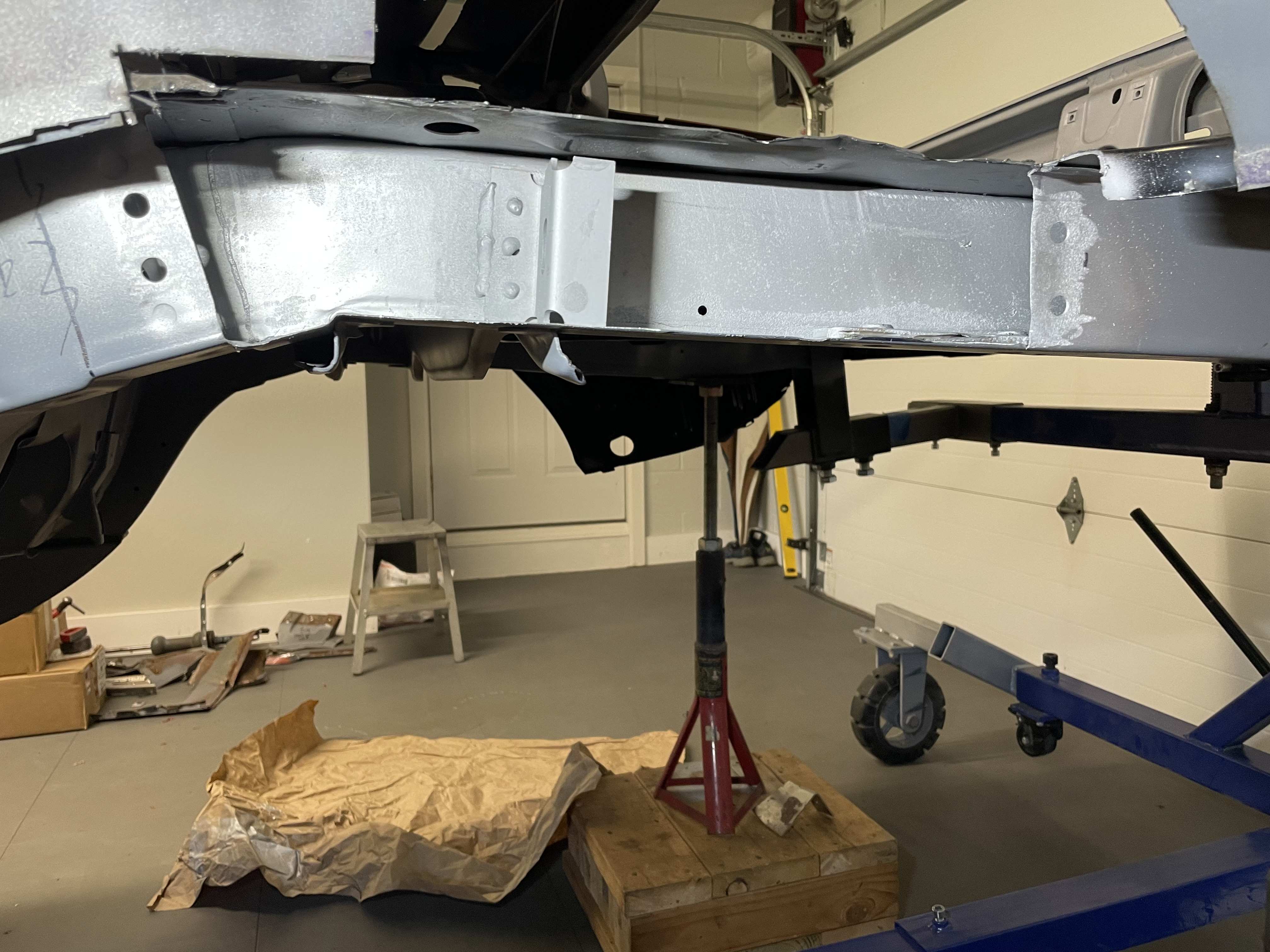

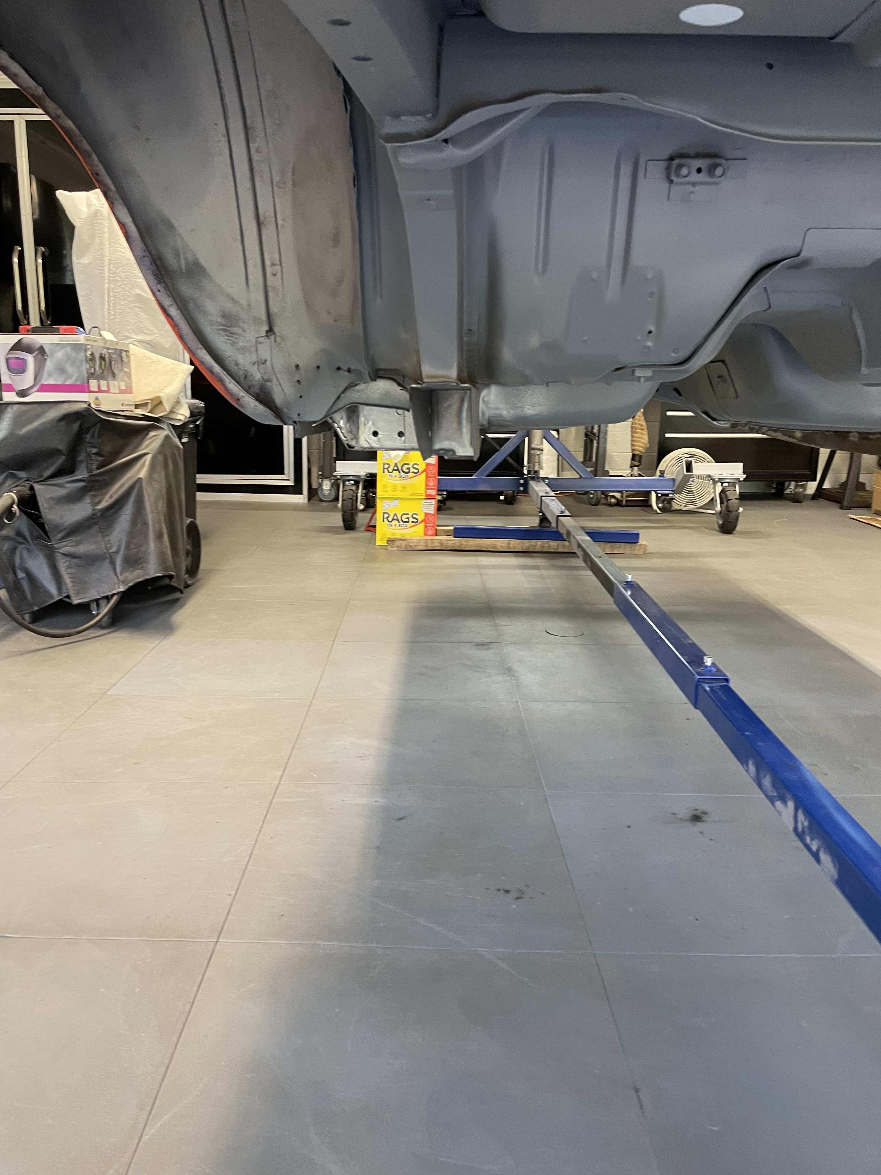

Well, I finally finished the trunk pan, mini tub and Frame notch. Next up is the rear suspension and subframe connectors. I'll be posting videos on my yourtube channel if you guys want to follow along. Thanks for all your help so far. I'm sure I'll have more questions along the way.

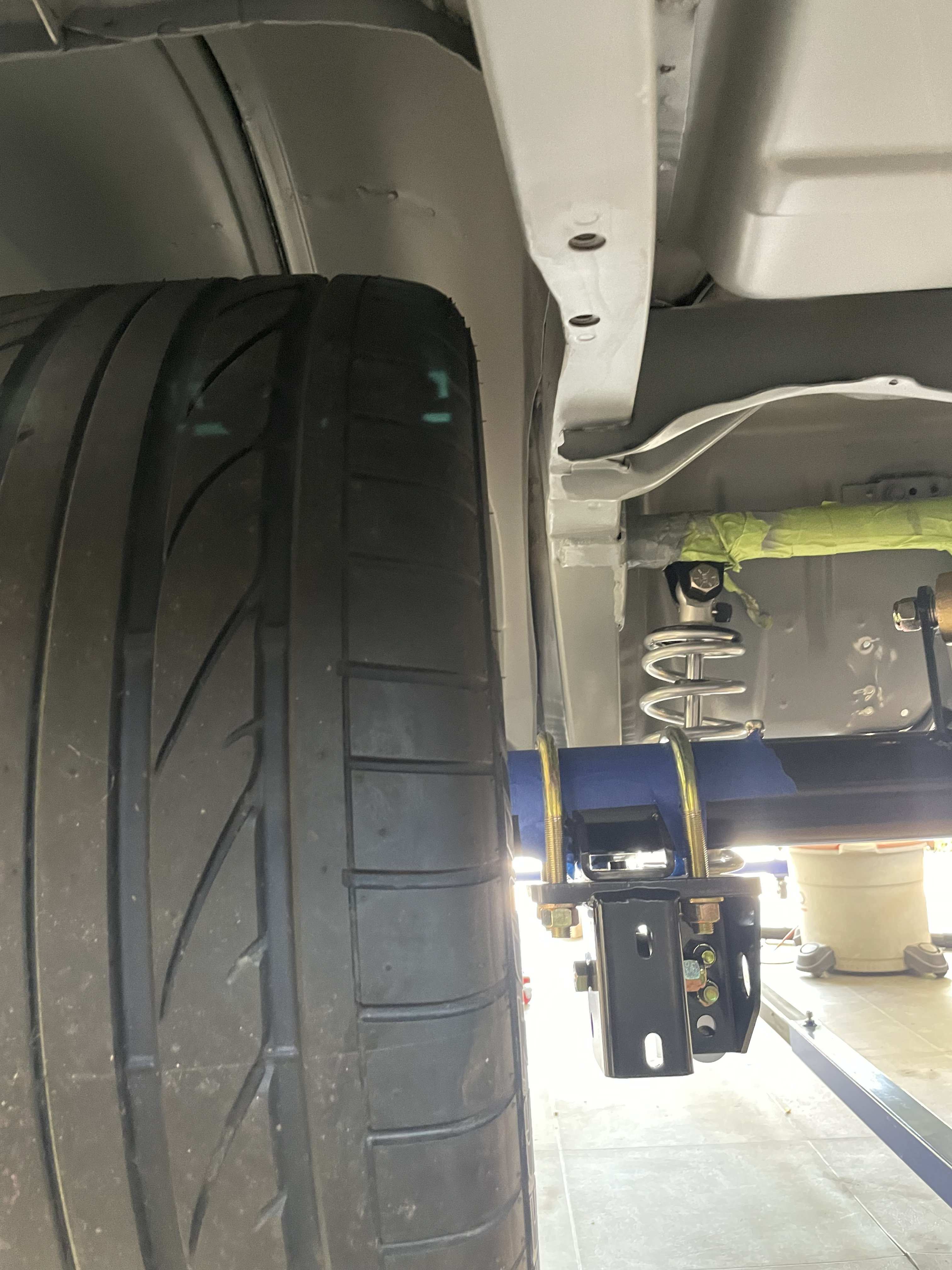

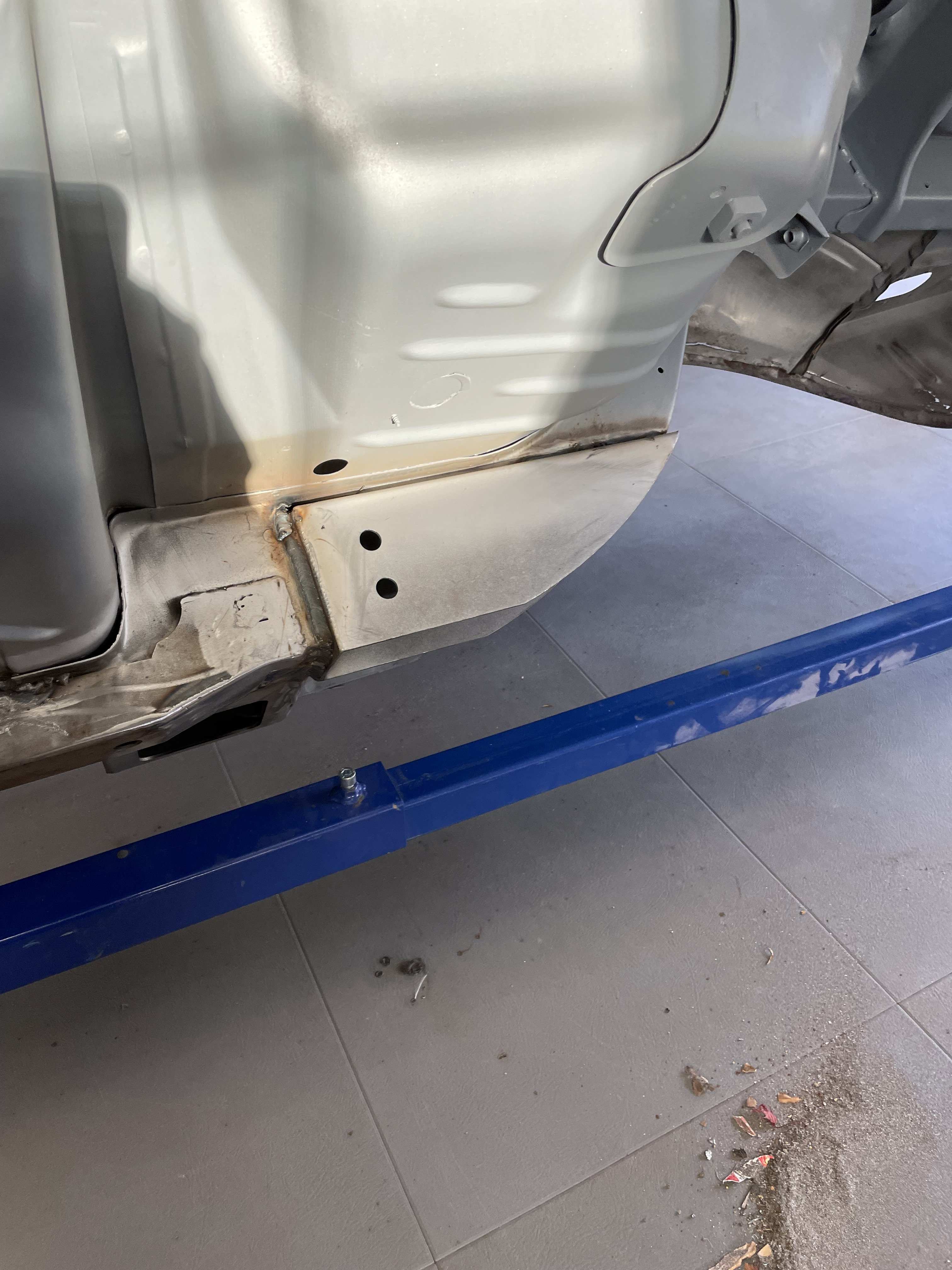

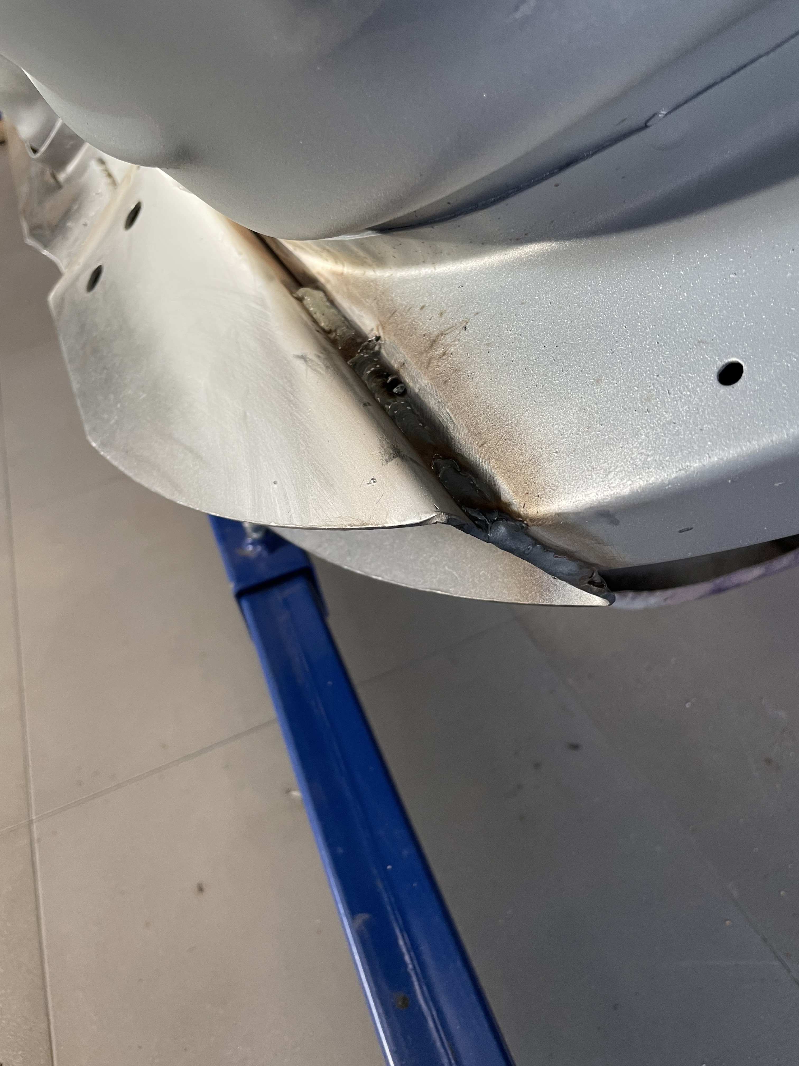

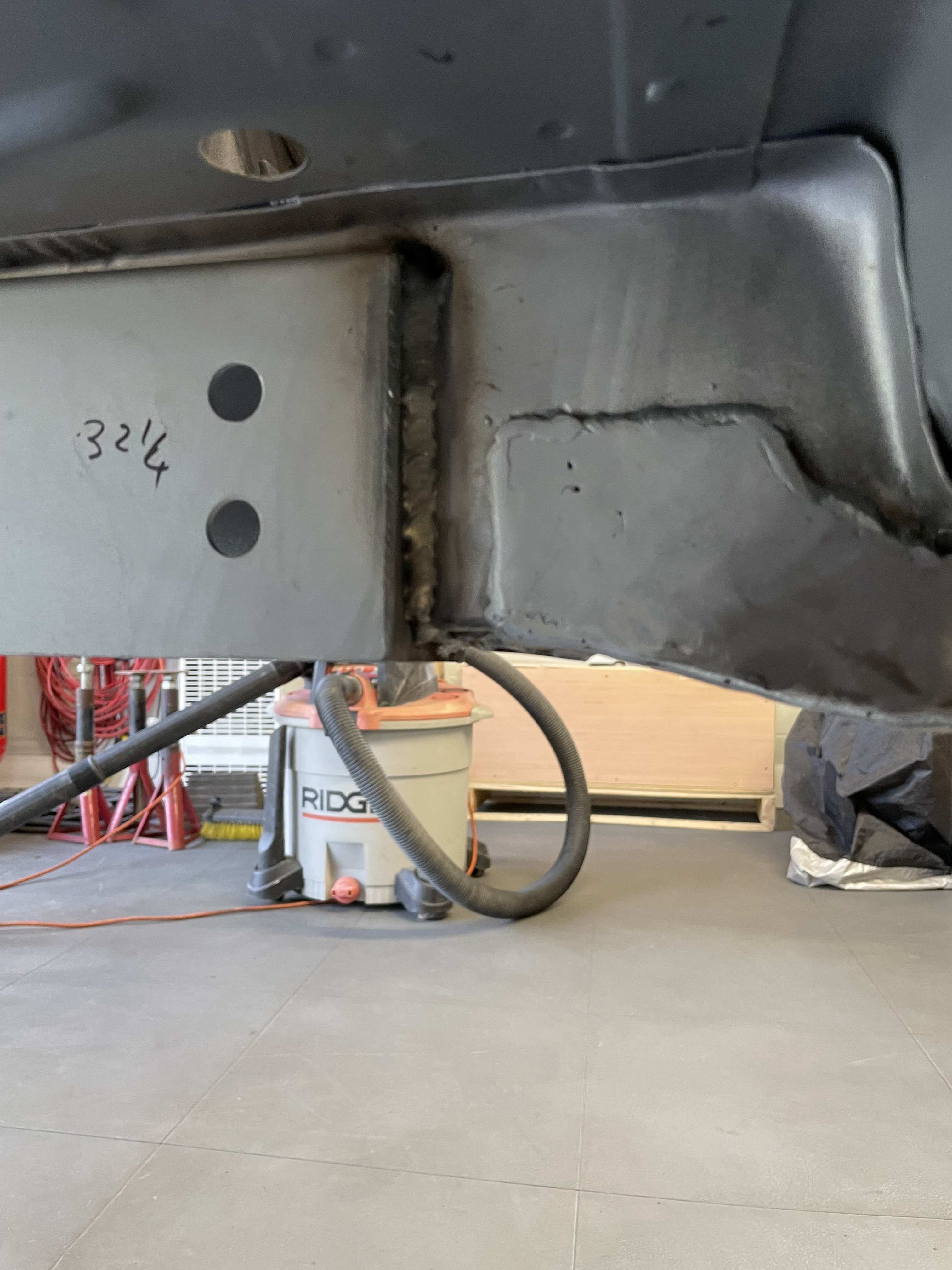

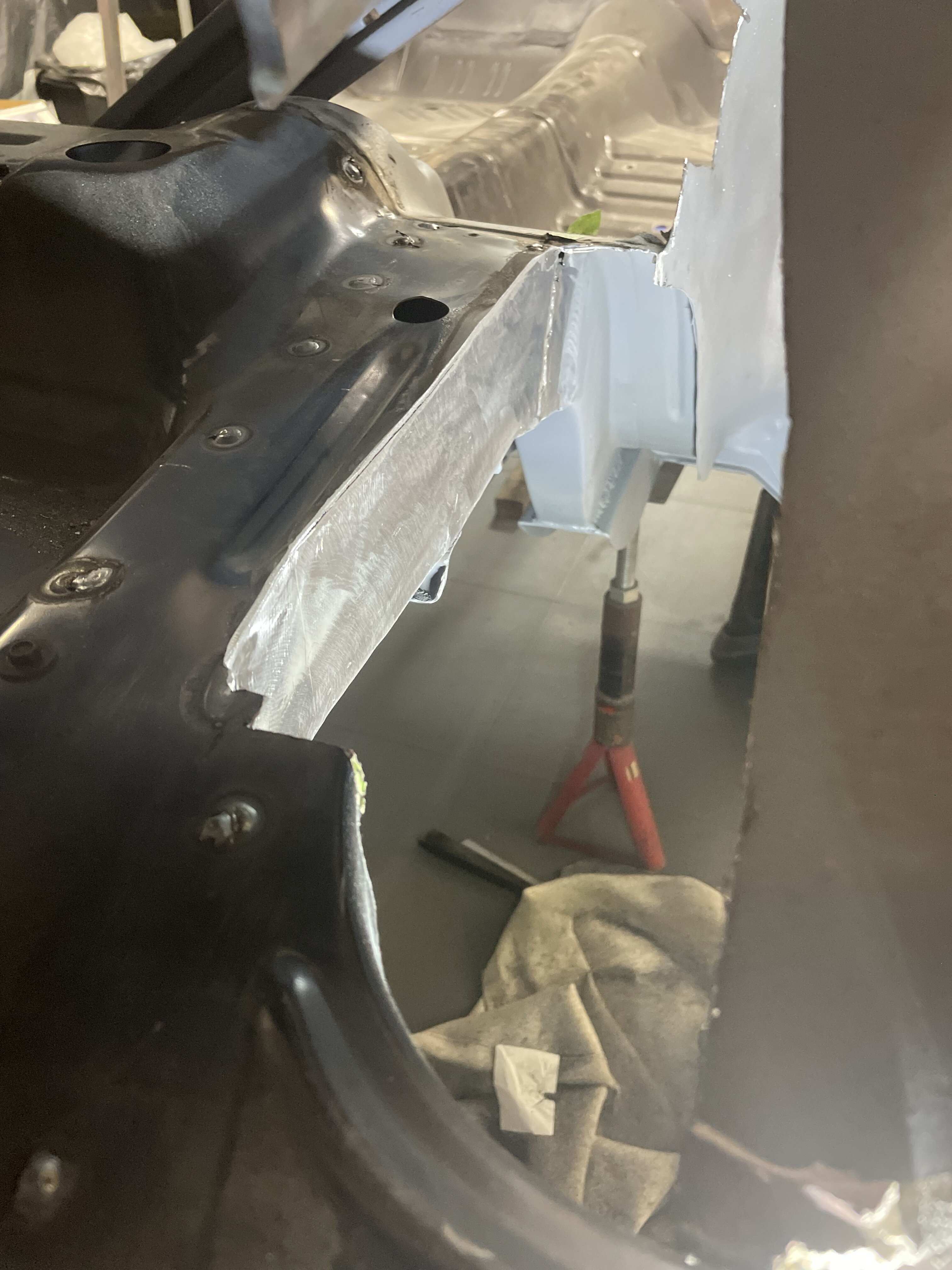

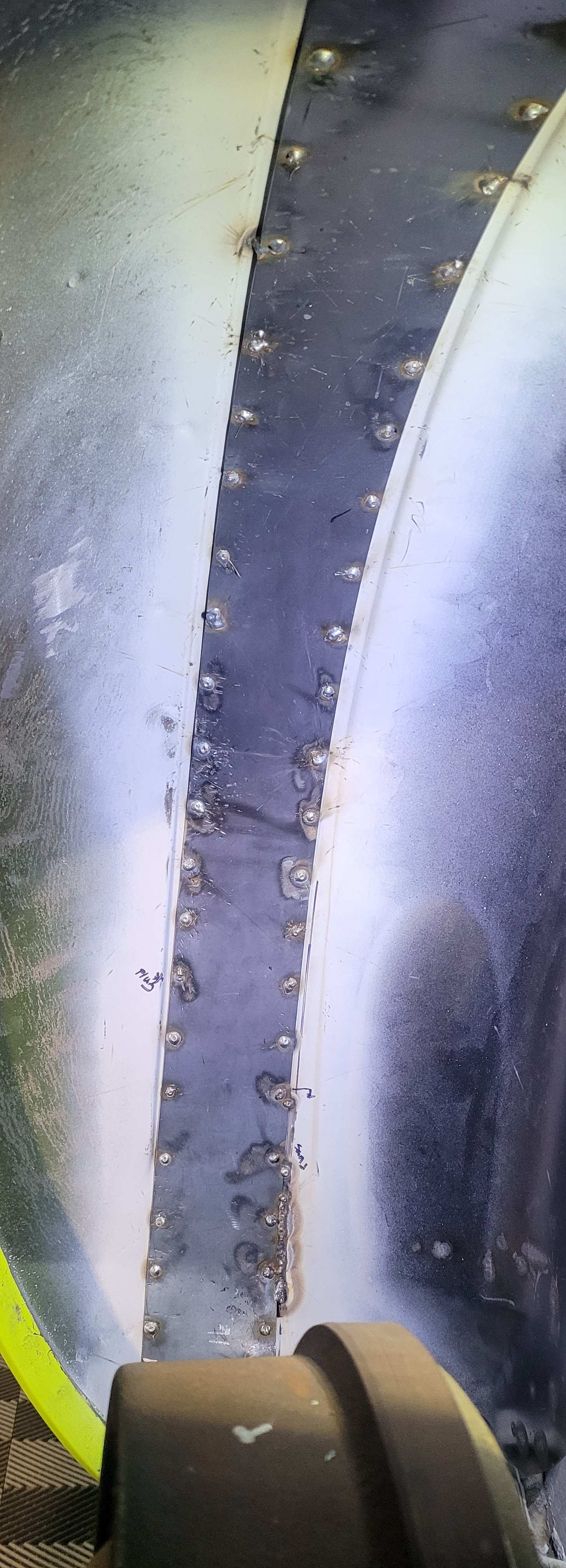

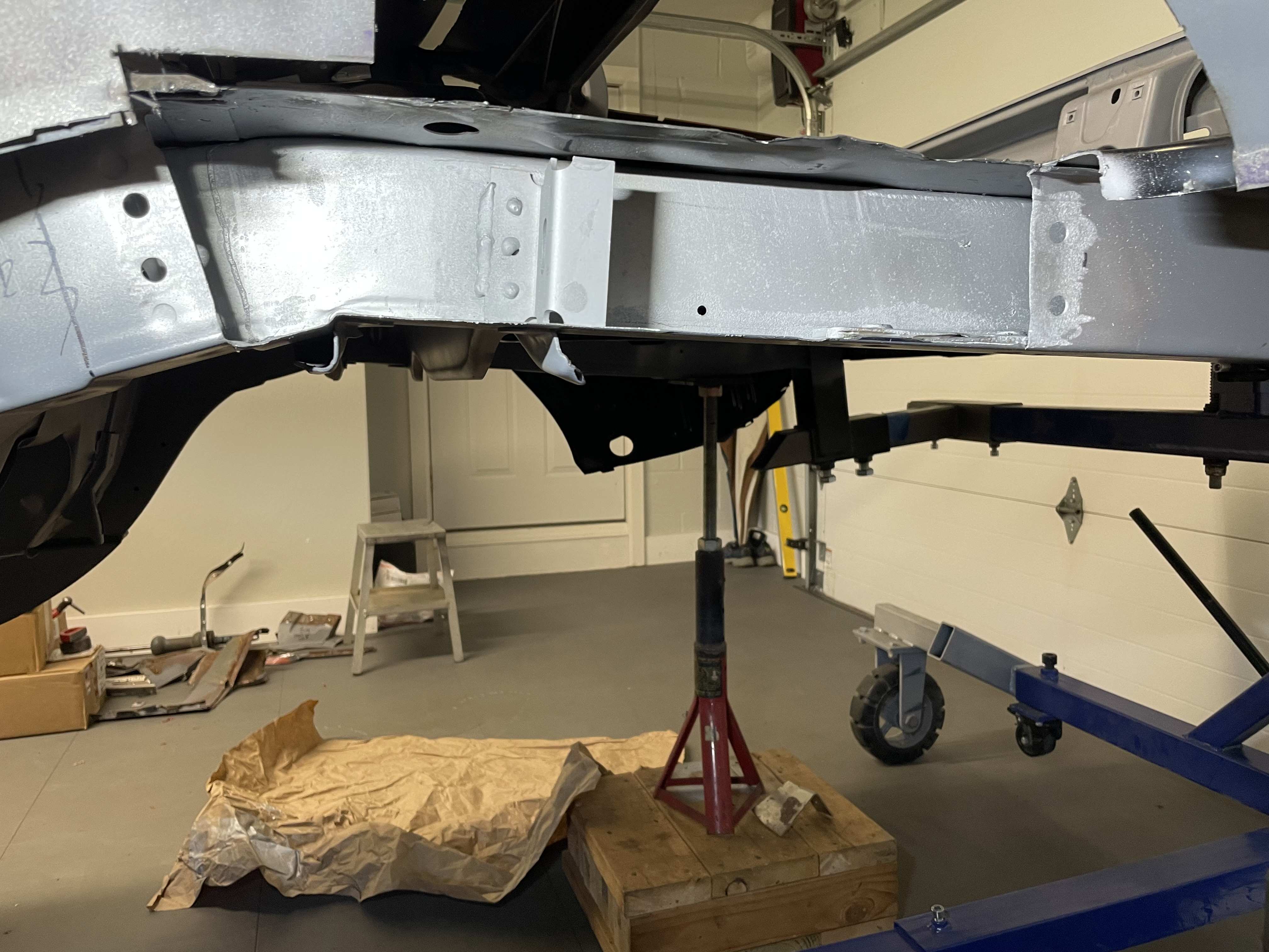

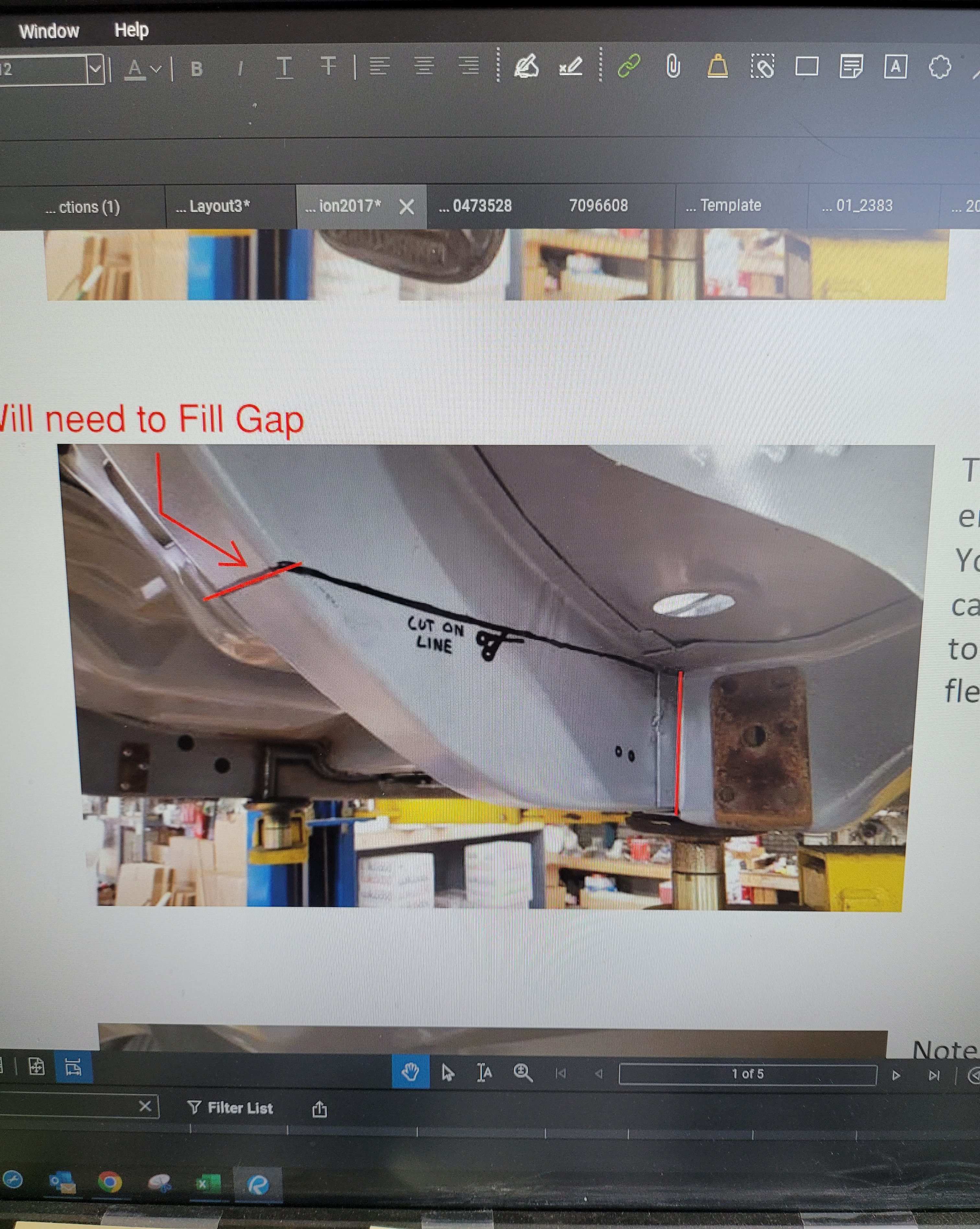

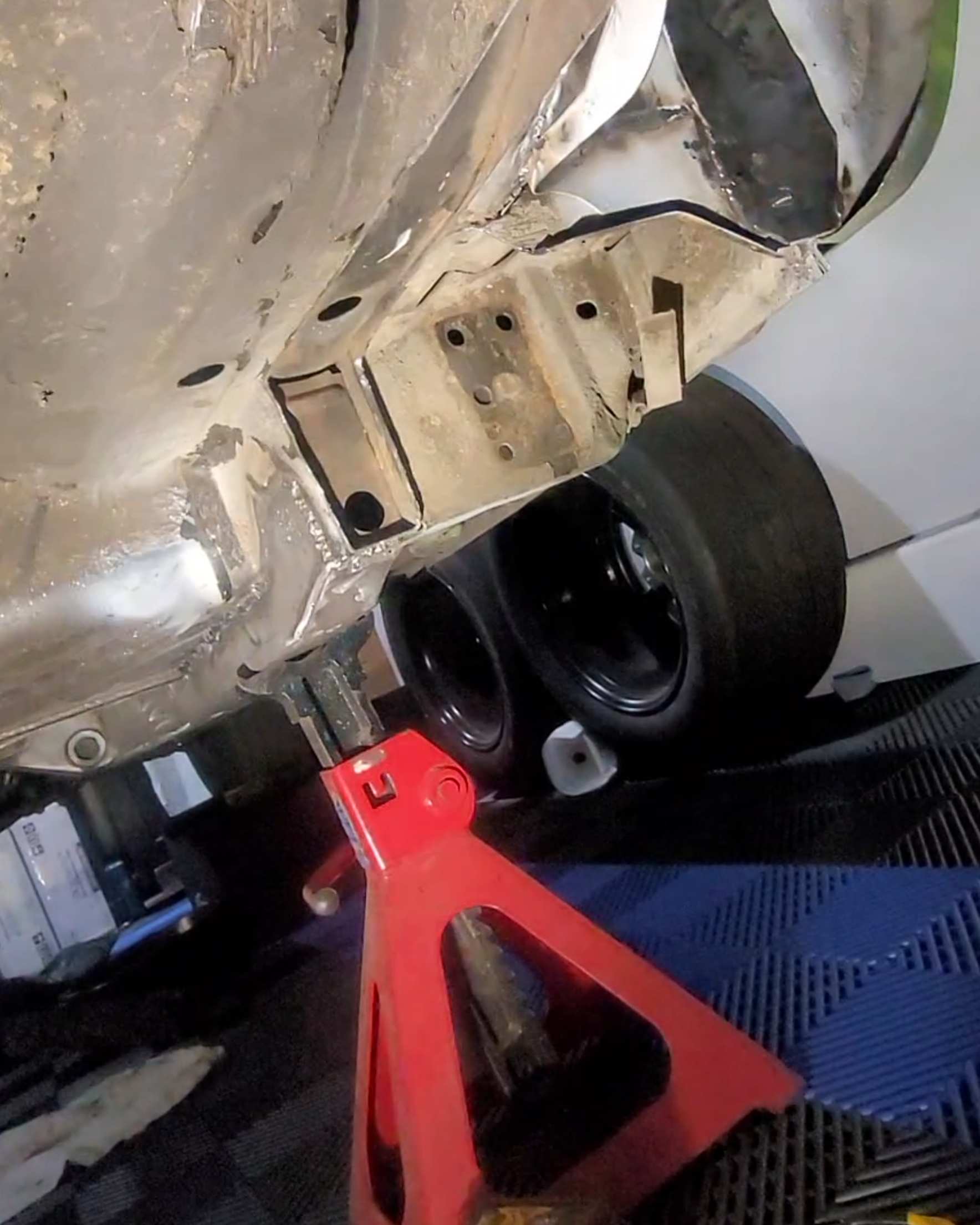

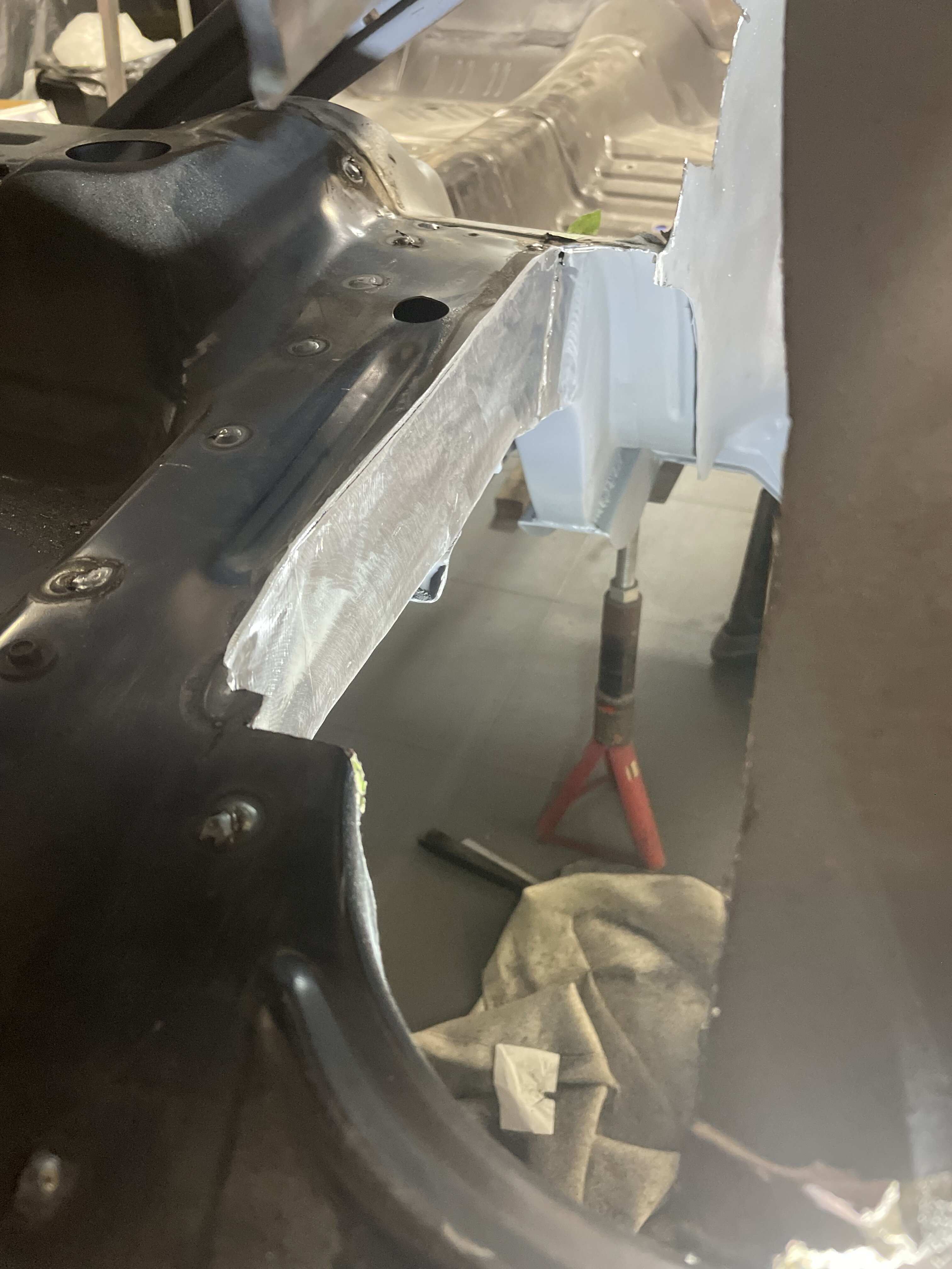

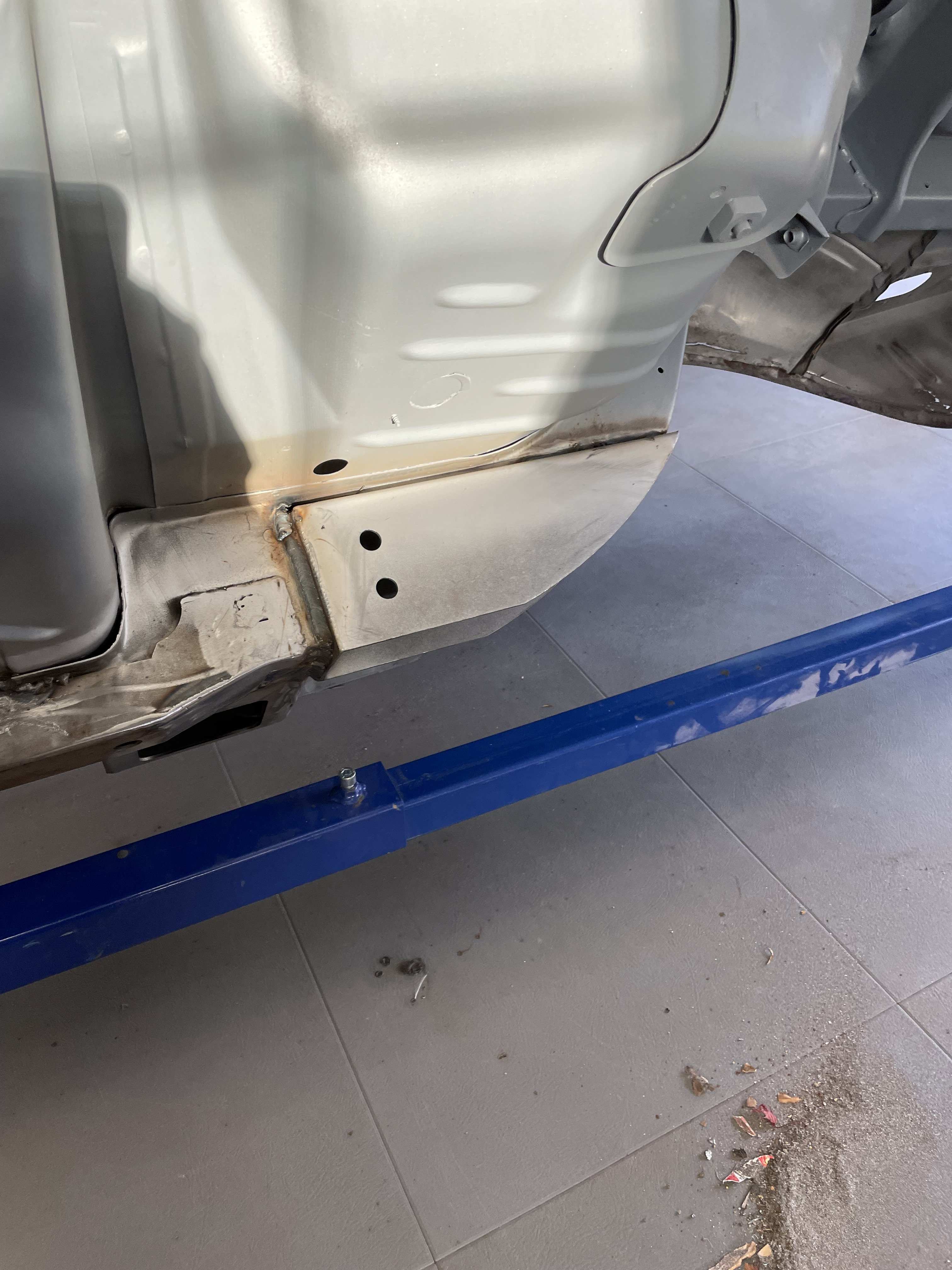

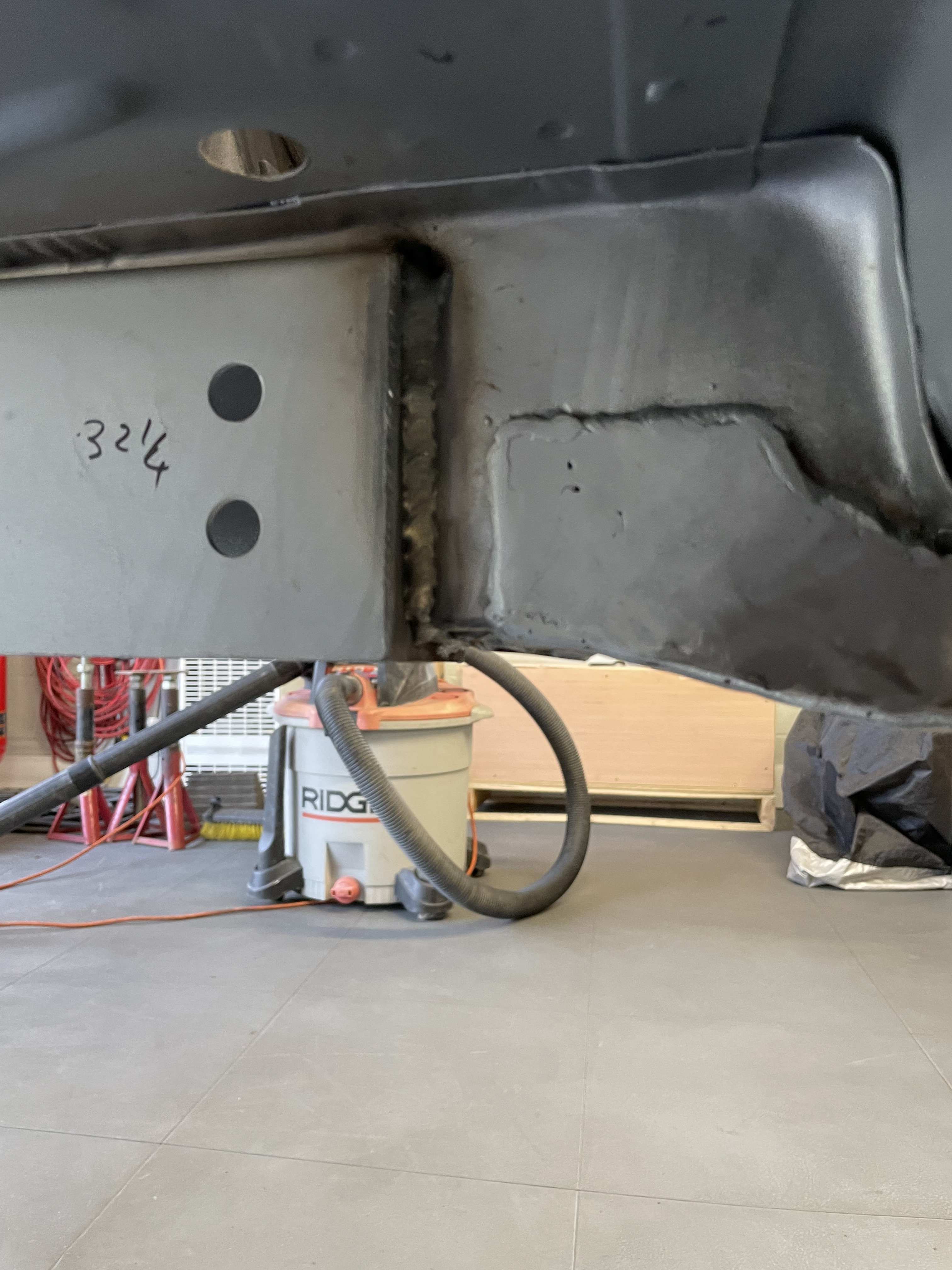

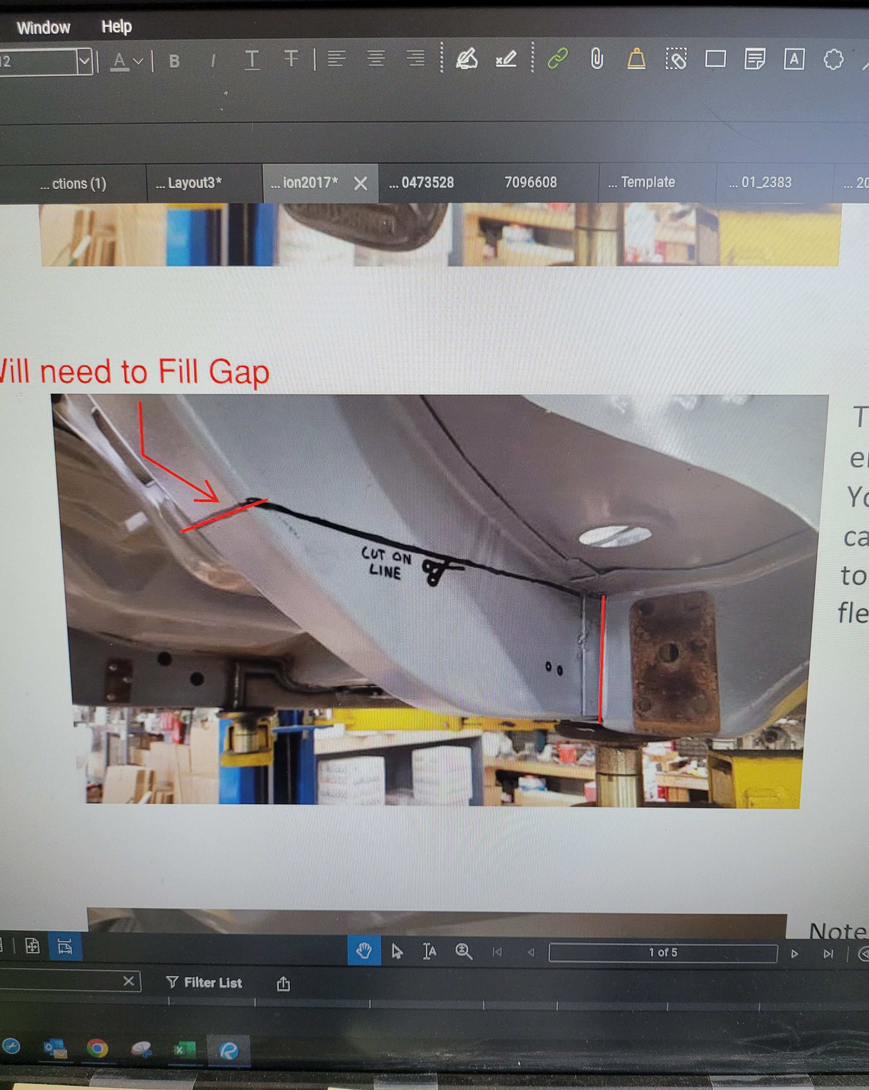

It’s hard to tell from the pictures if you look at the bottom of the frame rail there a two bolt holes that a factory bracket bolts to I believe it was used to secure the car doing shipping from the factory that’s where the notch ends you need the frame rail to parallel the inner tub

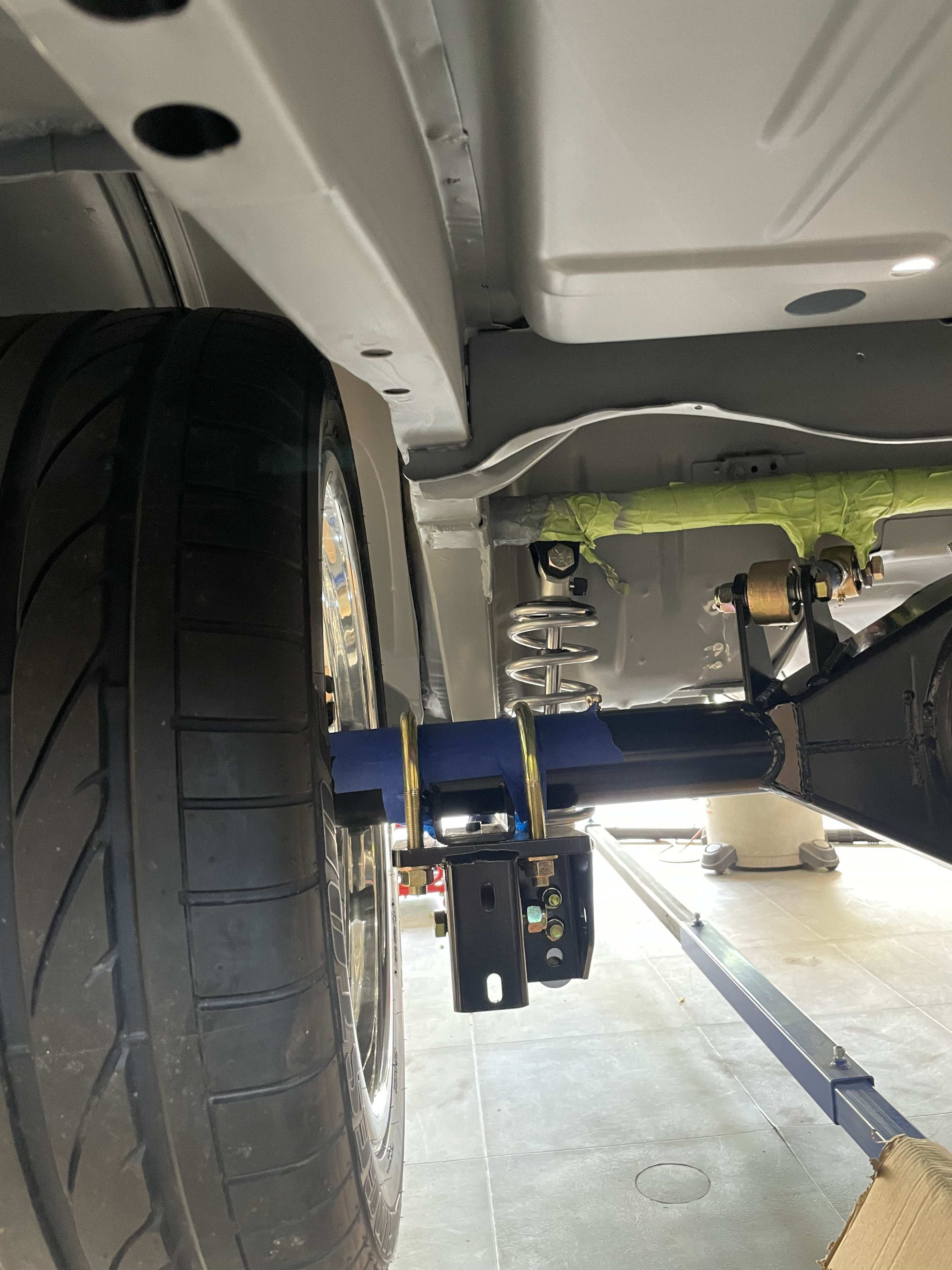

Any install photos of your inboard spring mounts?

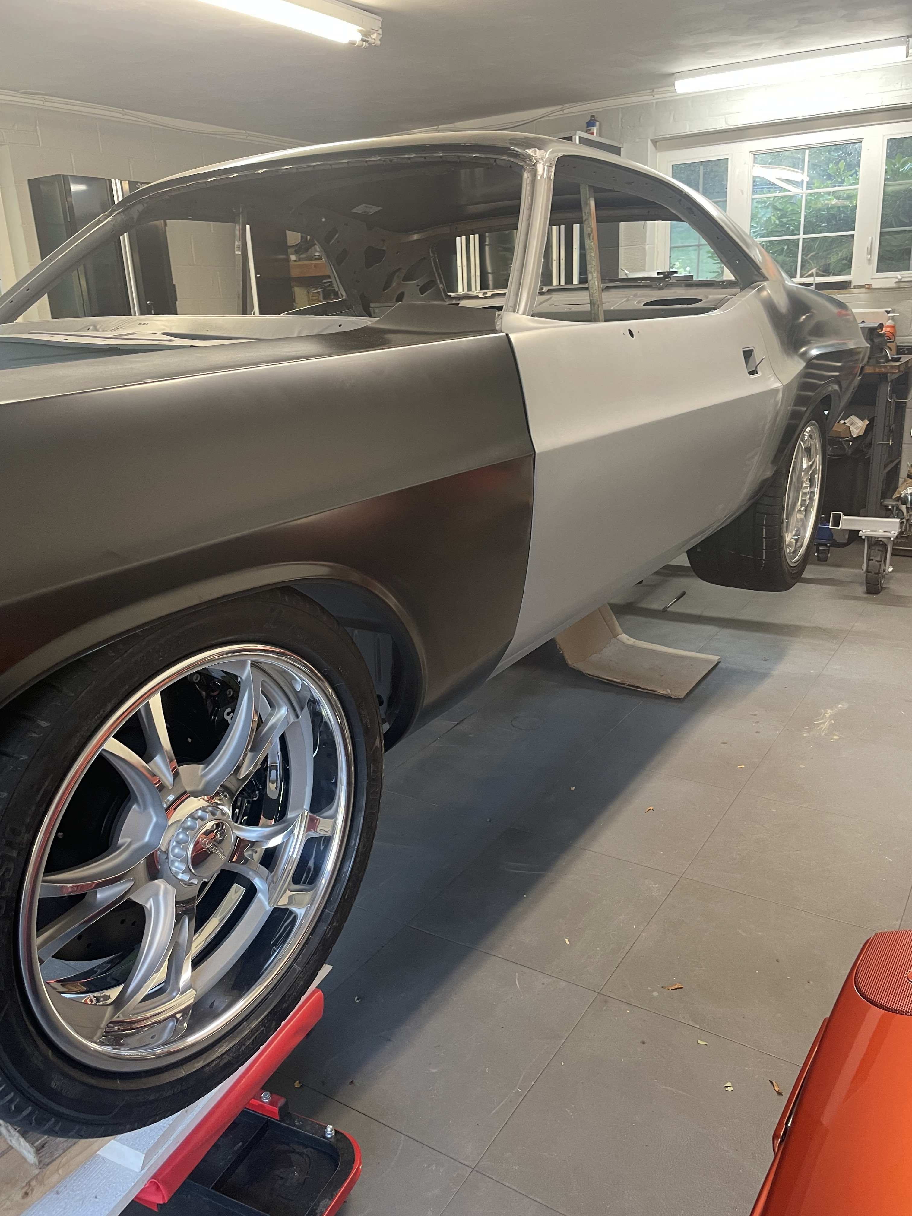

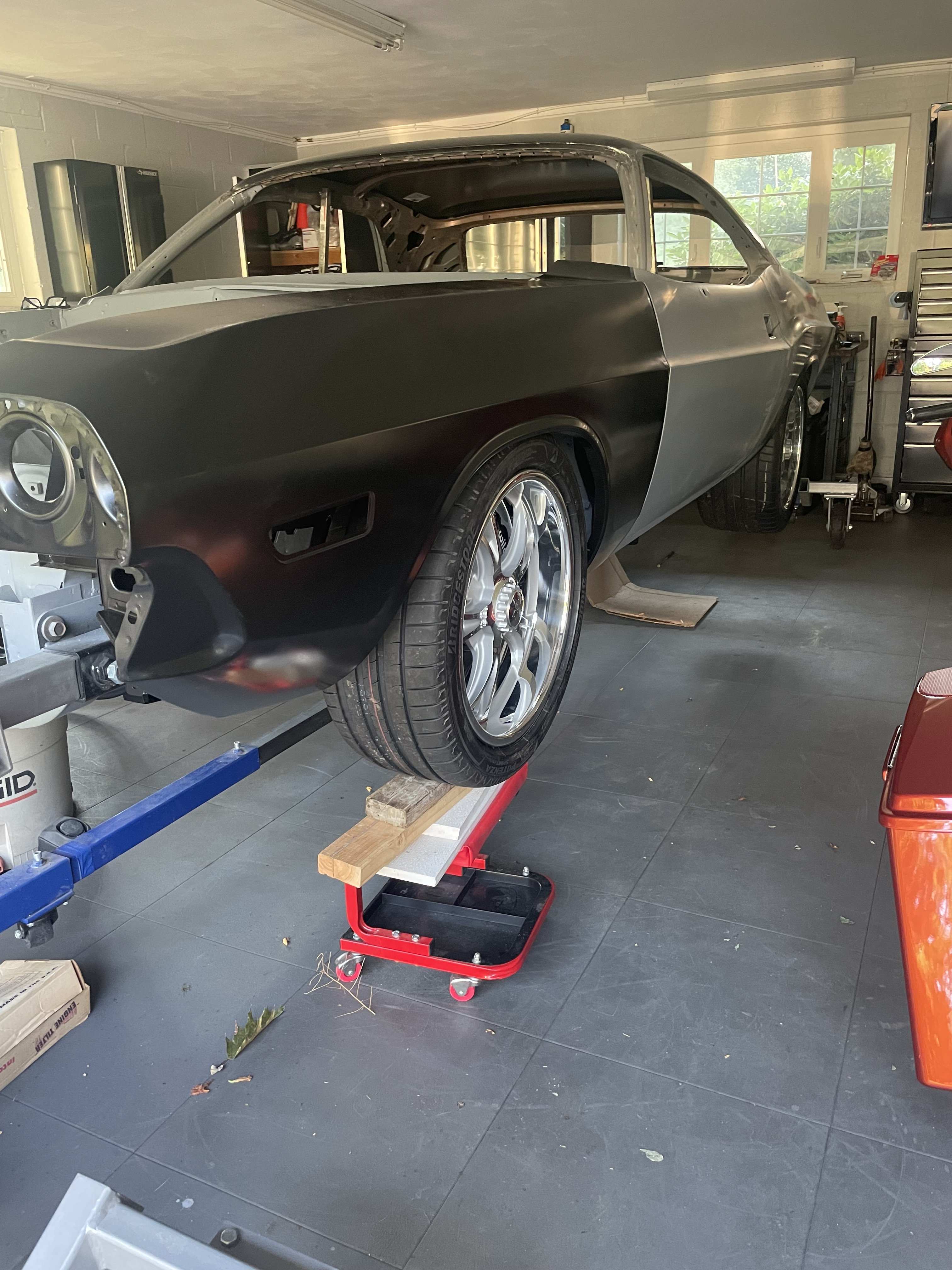

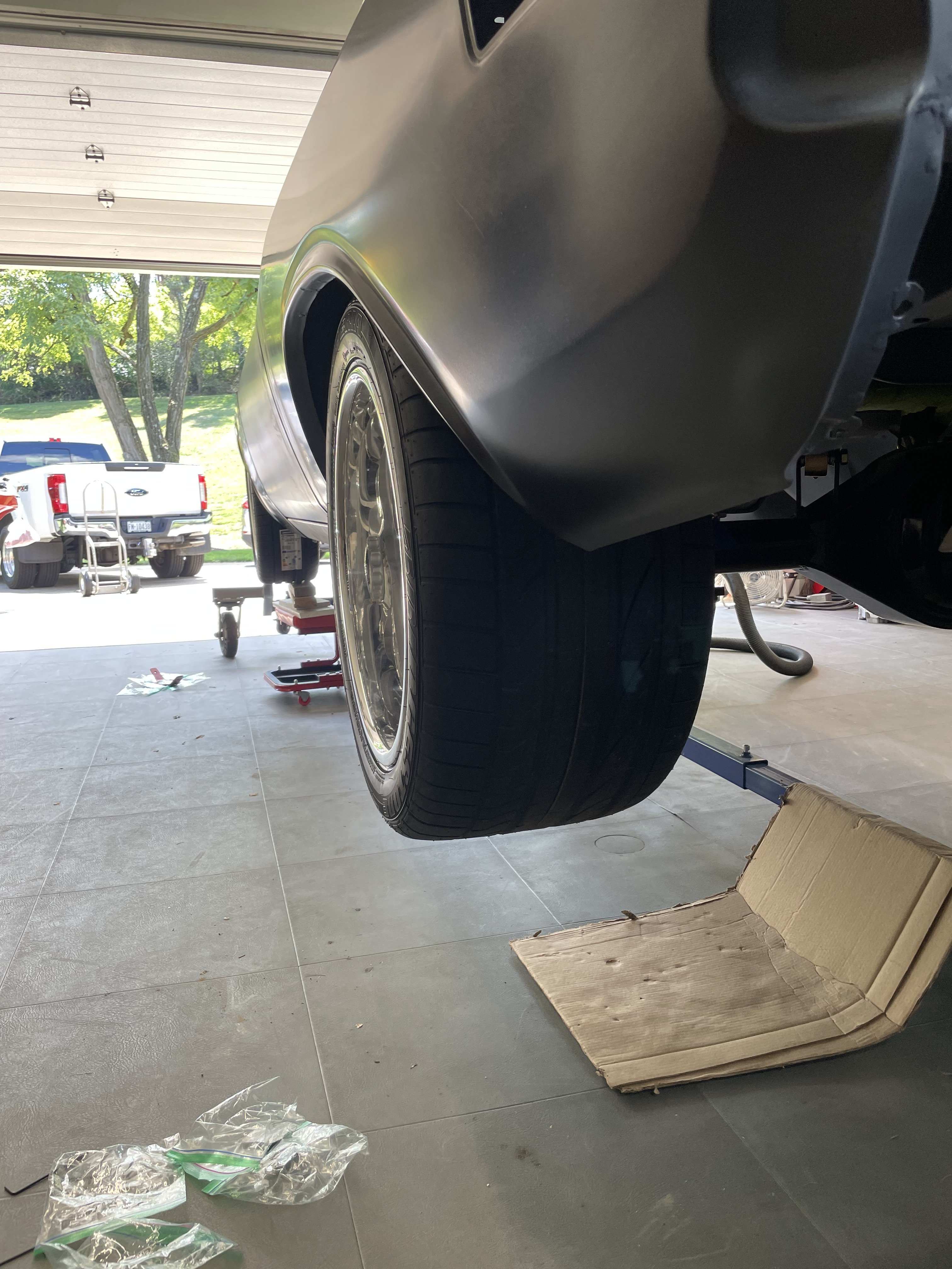

Wheels finally arrived everything fits nicely
Rear 19X12 with 345/35 6-1/4”back spacing
Front 18X12 with 245/40 5”back spacing
