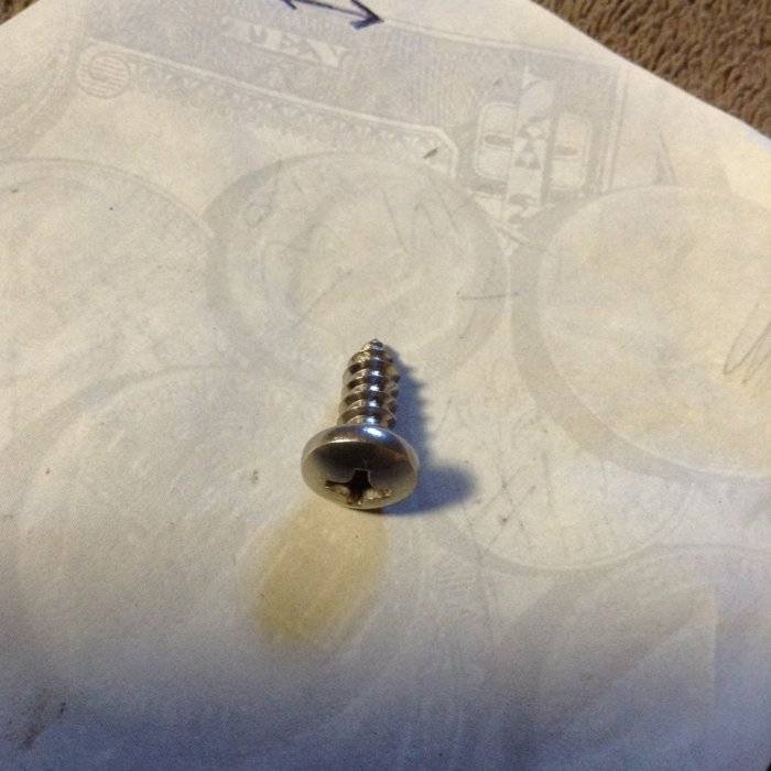

On the car I am working on the screw appear to be a #10. IM wondering if they were hogged out or something if you are certain about them being a #6

Had my filler off last year and looked like it had never been off before. All the screws measured the same and ran the calipers on them to be sure. As for the body color, I've never seen anything but the same color. I don't think they did anything different from the factory on an r/t than a standard model. If they did, maybe another member can let us know!

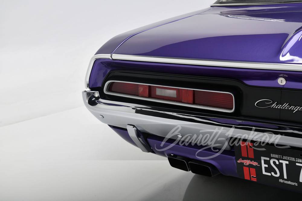

It has me stumped. I see the rear black out like this one and get the feeling that if its body color it would show oddly. That is what make me think its supposed to be black??? Hoping someone with an original paint R/T might know?

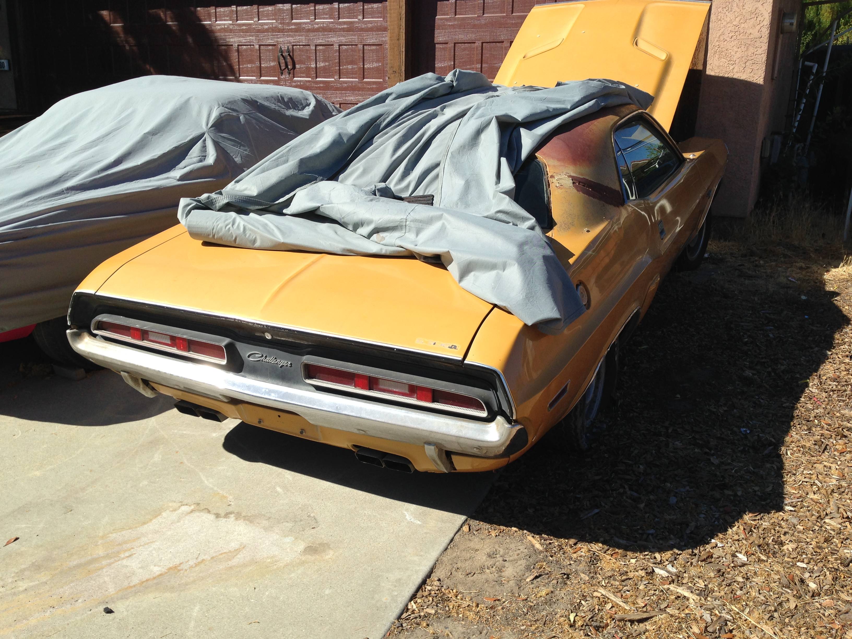

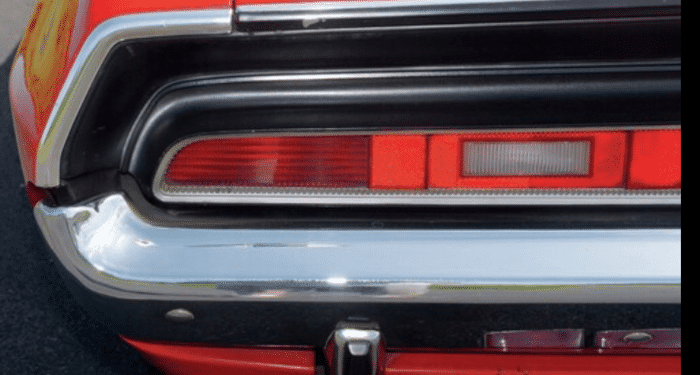

The red car is a 71. It is not properly painted. It should be like this. The bumper filler is part of the tail light bezel in 71.

I have a 71 RT that had original paint - attached photo shows the tail panel. The trim above was also painted black on the lower half (below the crease line)
