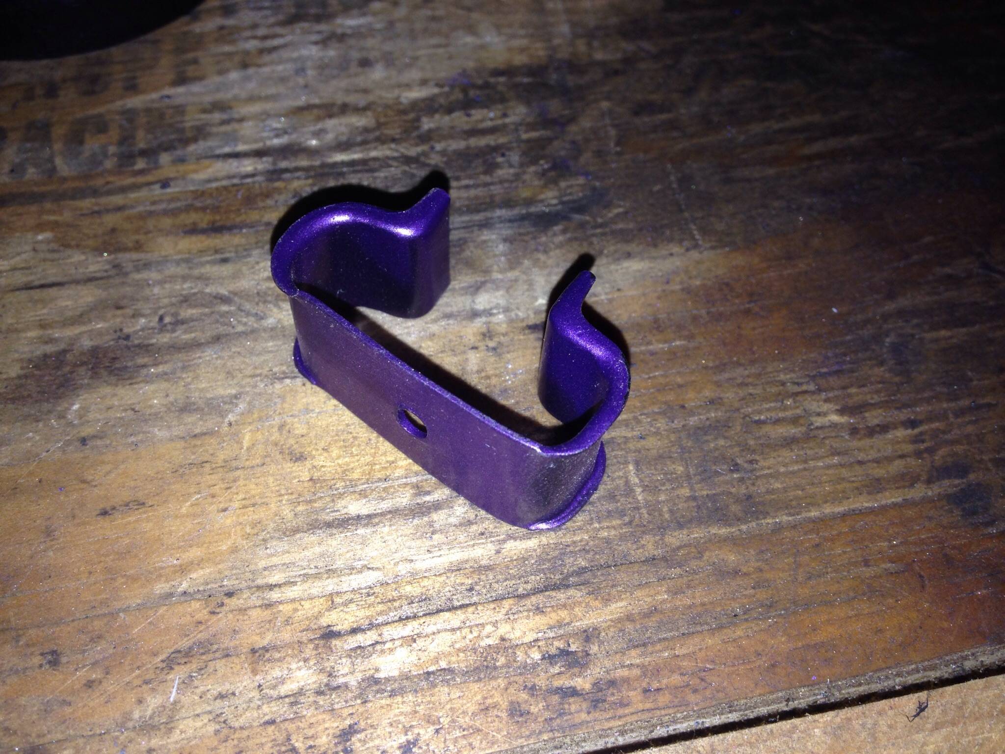

70 challerger,what is this part? See photo

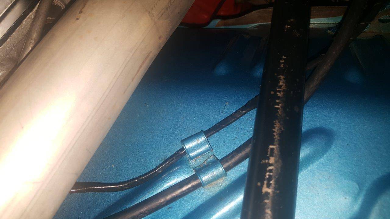

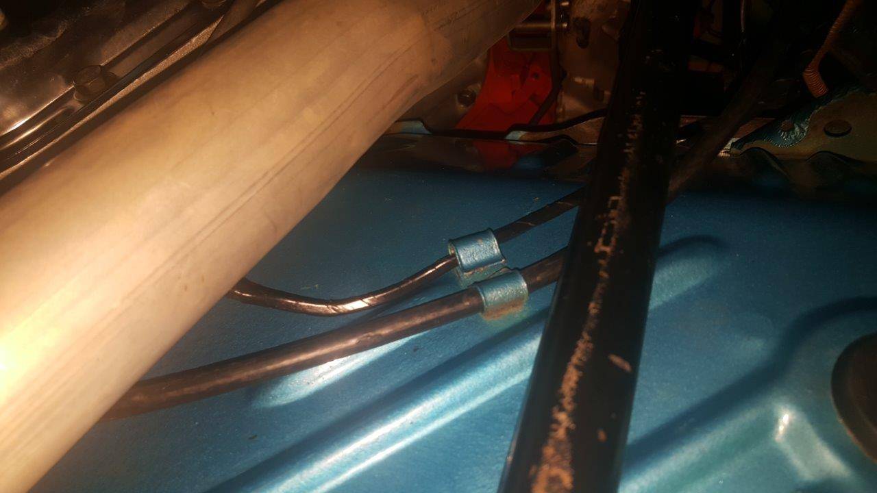

Its the Speedo cable/Neutral switch cable support to stop the cables touching the exhaust fits under the floor towards the front the originals were welded
It also comes as an extra part with the handbrake cable support kit on the 70 Challenger
i used a low profile rivet as the carpets had already been fitted

Hi thank you for the reply. I was wondering if you snap a photo and post it here as to the exact location.
I can weld this piece in.I'm just finishing up with welding a new floor
Thanks in advance
Jim

See pics fits on the floor just as it leaves the firewall
