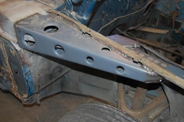

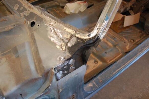

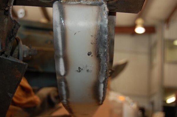

Well here is my stab at the Cuda. About 4 years ago I bought this 1 owner 1970 318 powered Barracuda. Ran and drove and I was on top of the world. I couldn't believe how complete the car was it was really only missing a chrome moulding on the grille! I brought it home and started taking it apart as my plans were to do a rotisserie resto with a Hemi swap. In my opinion it had little rust. Due to the vinyl top the typical rust at the base of front and back glass and some small rust on the trunk floor. It sat in my shop for a few years but I am back on the project. Thanks for all the great info that is shared on this forum! DSC_0198 (640x425).jpgDSC_0210 (640x425).jpgDSC_0321 (640x426).jpgDSC_0328 (640x426).jpgDSC_0383 (640x424).jpgDSC_0455 (640x424).jpgDSC_0459 (640x424).jpgDSC_0460 (640x424).jpgDSC_0471 (640x424).jpg

If you are doing the frame off then be sure to change out the support panel the radiator mounts to so there is the wider opening for the required larger radiator.
Easy to miss until after car is painted. :oops:
That is one of the things I always see forgotten when people drop the big ones in and attend car shows.
Mike.
Where did you get that support piece that you welded in?
I am not changing mine out for the larger opening unit because my car is in good original shape. It is tight but I am working my changes within the confines of the existing opening. Sticking with the small block I will be able to pull radiator off of the core support towards the engine and mount using adapter brackets. No cutting here...
This link has the whole core support. I didn't see option for smaller opening version like yours/mine or for just the single panel.
I have no experience on their products though. There is also a thread on here about produce selections.
https://www.autometaldirect.com/sto...E-Body-71-72-B-Body-Radiator-Support-Assembly
Mike
High perf cars had a larger (26 in wide, I think) radiator opening, I would really reconsider changing it out now, even if staying with a small block. Look how small the radiator is in the first photo. More Hp will = more heat. Besides why worry about originality when you put in those boxed supports (very cool). I have had very good experience with AMD panels...
Thanks Adam, I had no idea about the wider radiator opening. I don't remember seeing that when I ordered the radiator support reinforcement. I will definitely look into that and re-do that for sure. Where I live heat is a massive factor.
Yes, that is why I mentioned it earlier.
Would not be happy time to find out more chopping would be necessary AFTER paint and reassembly. Typically the radiator is one of the last things to install.
