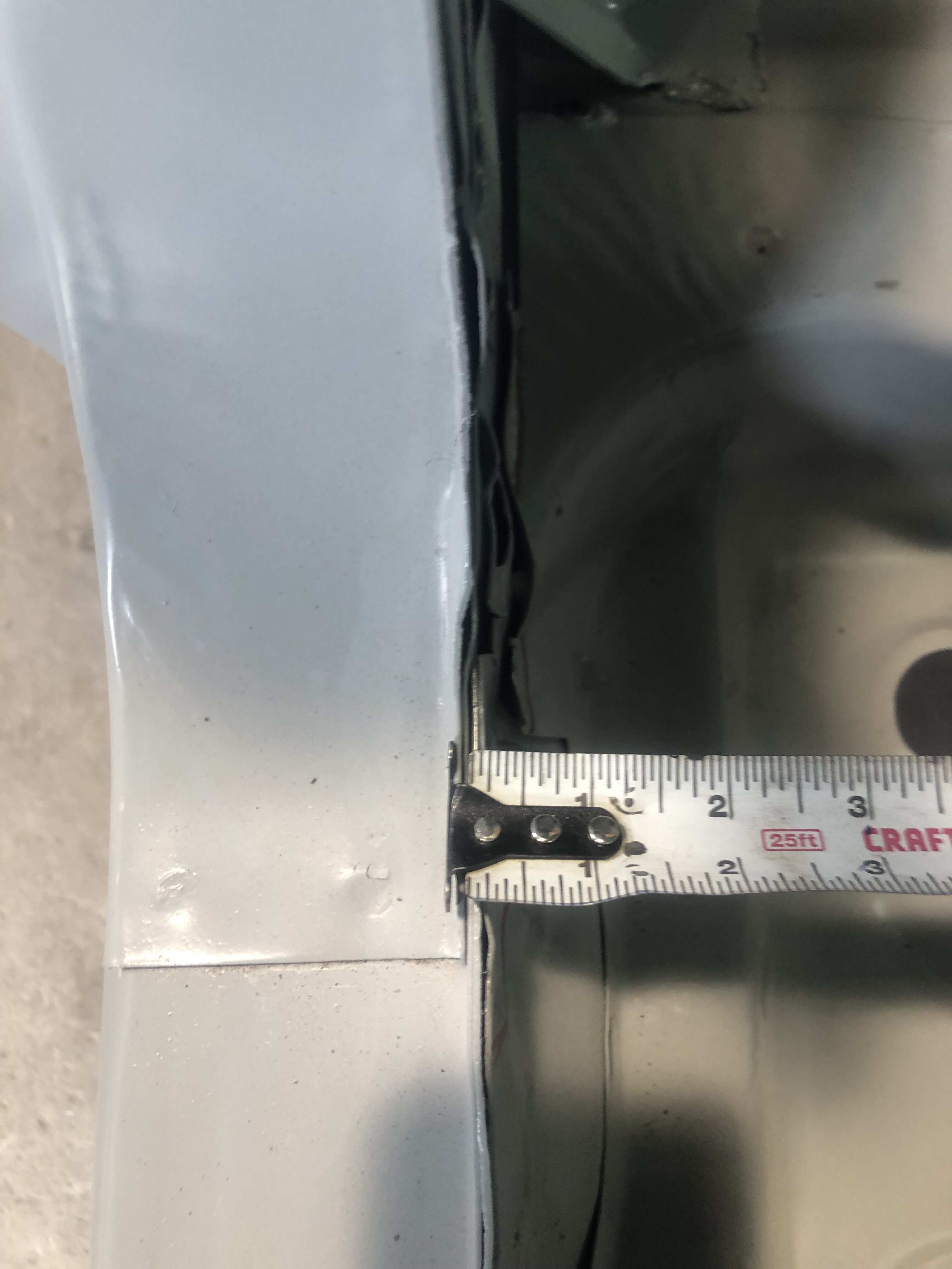

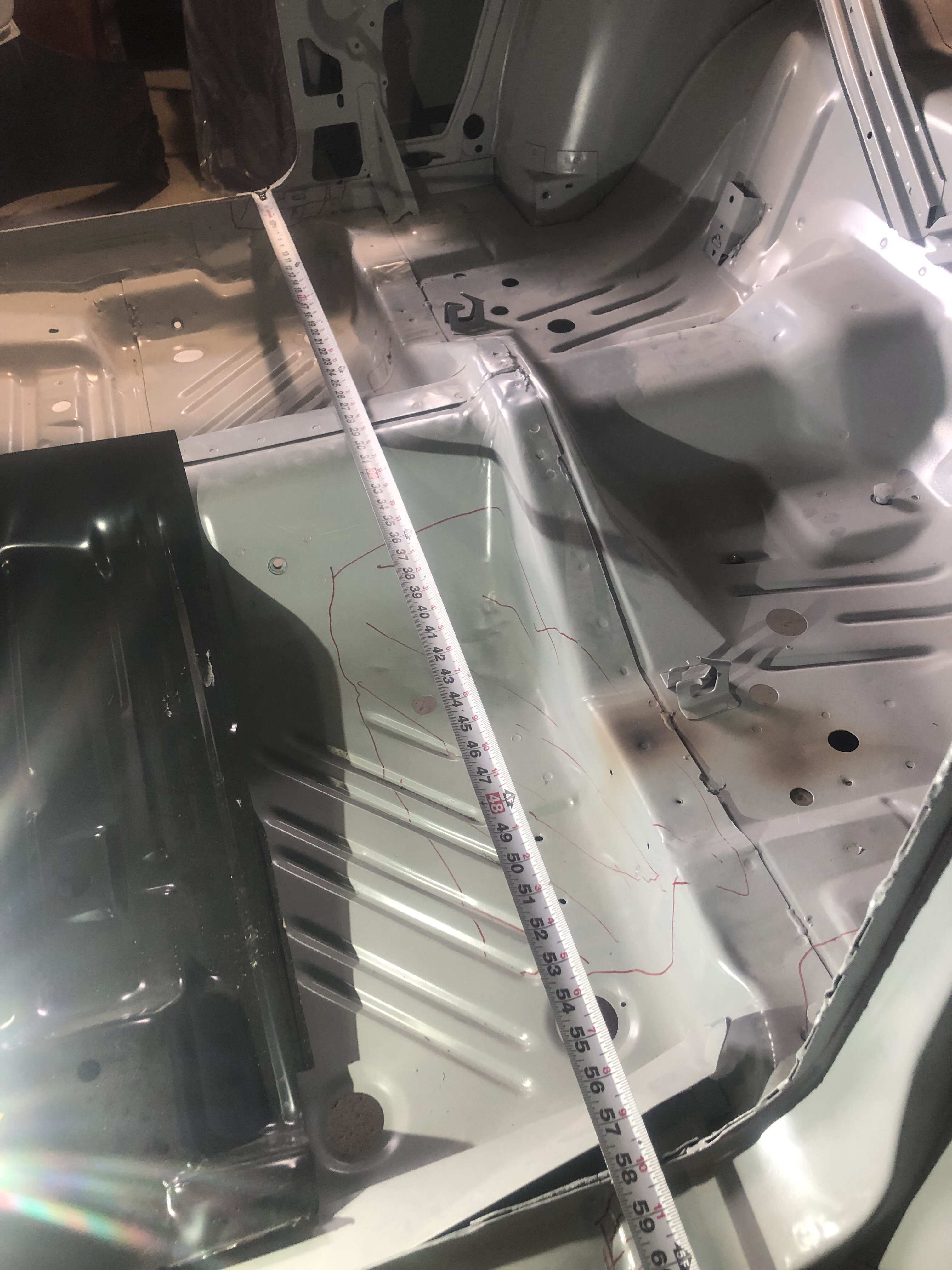

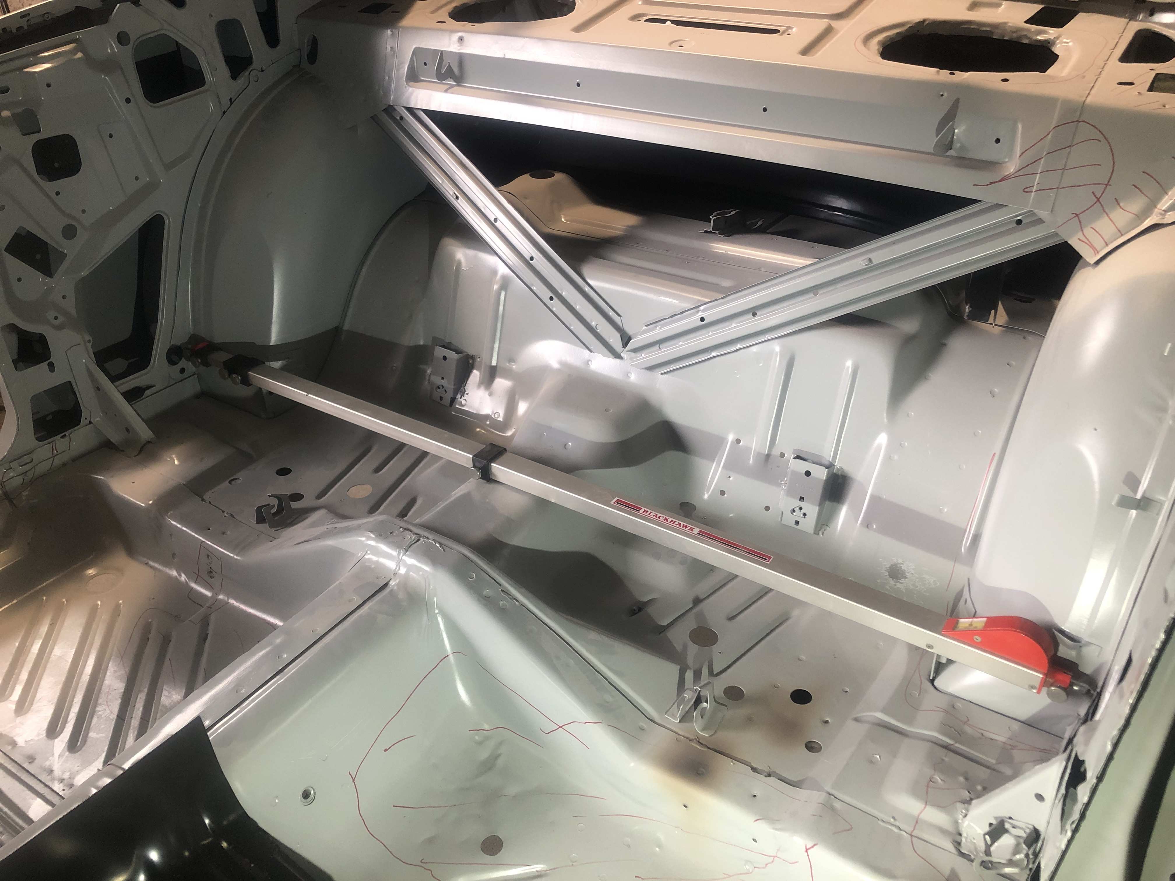

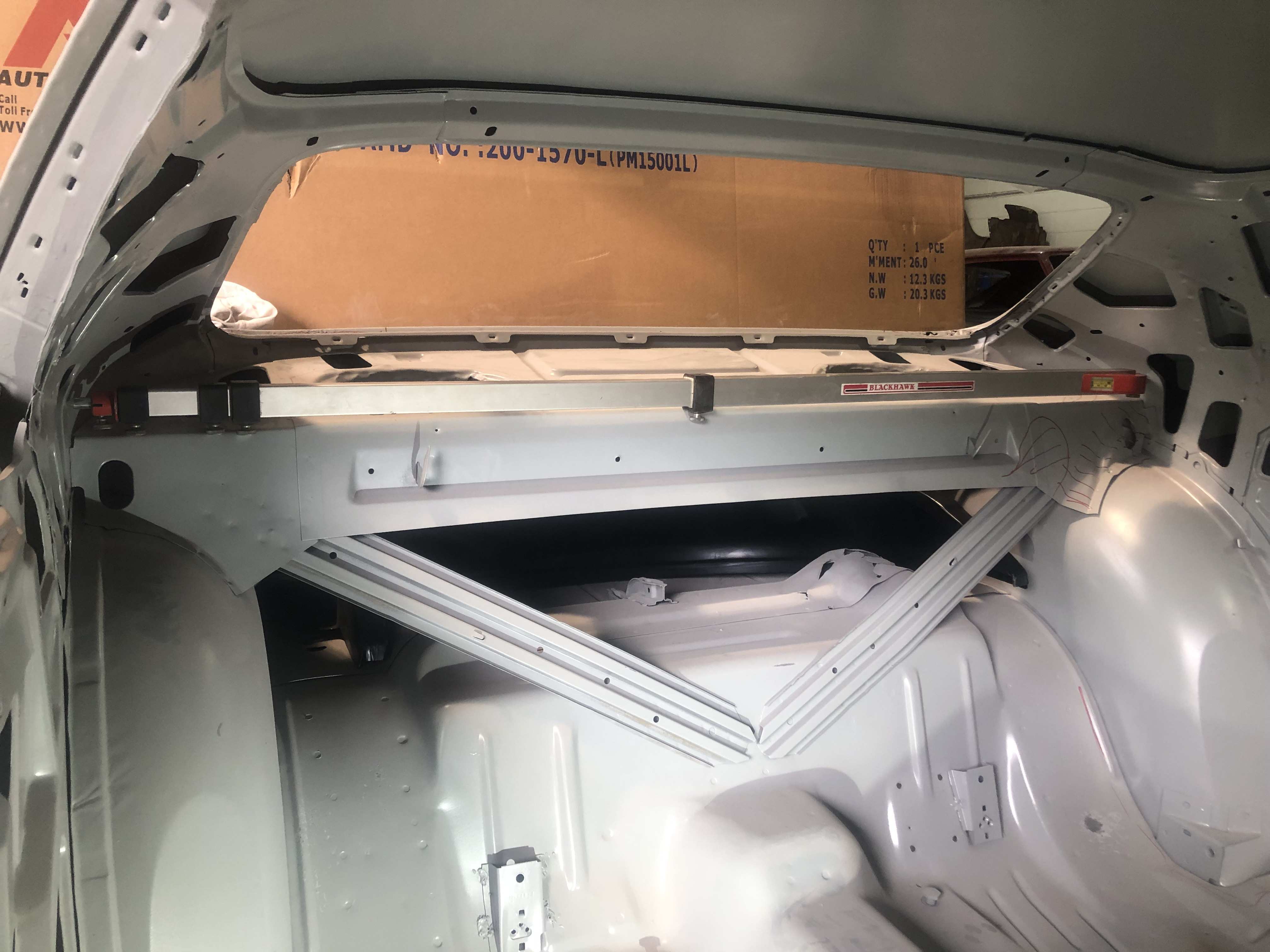

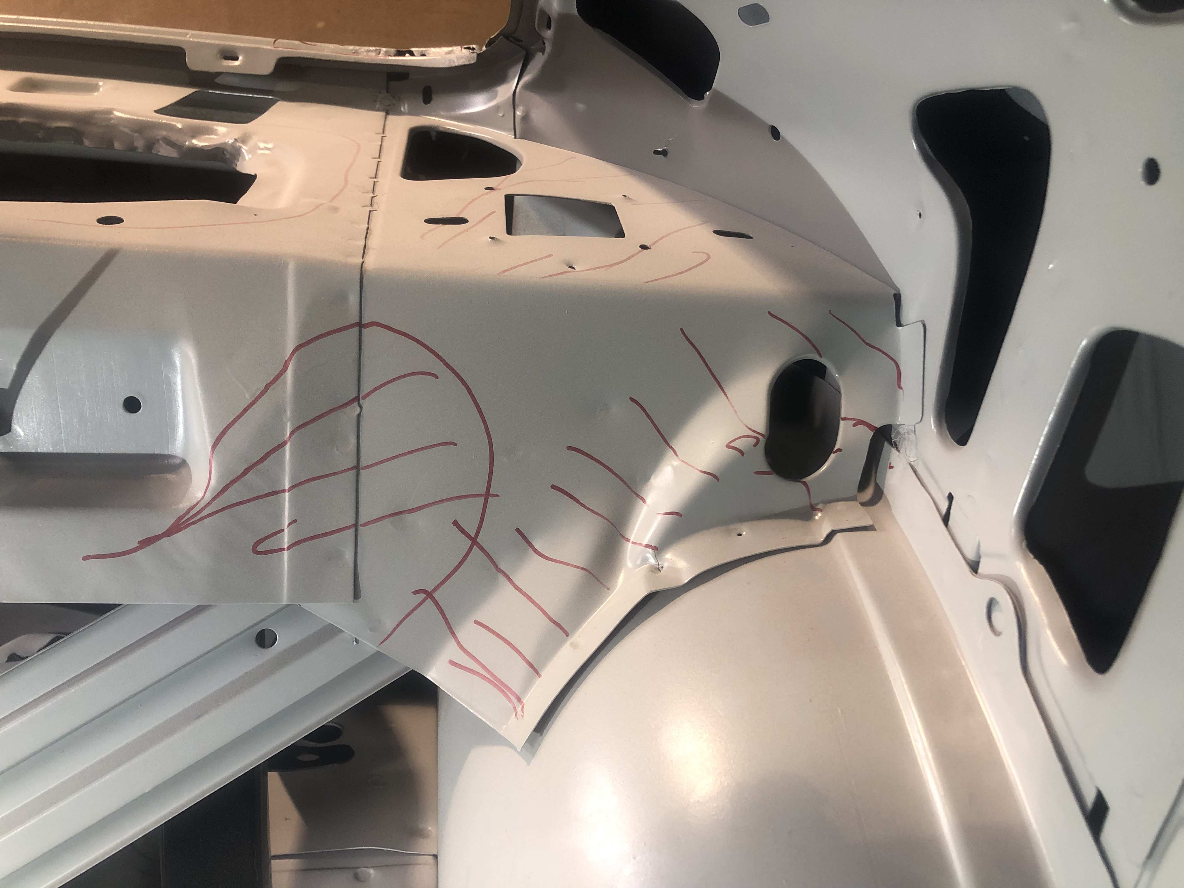

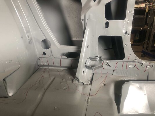

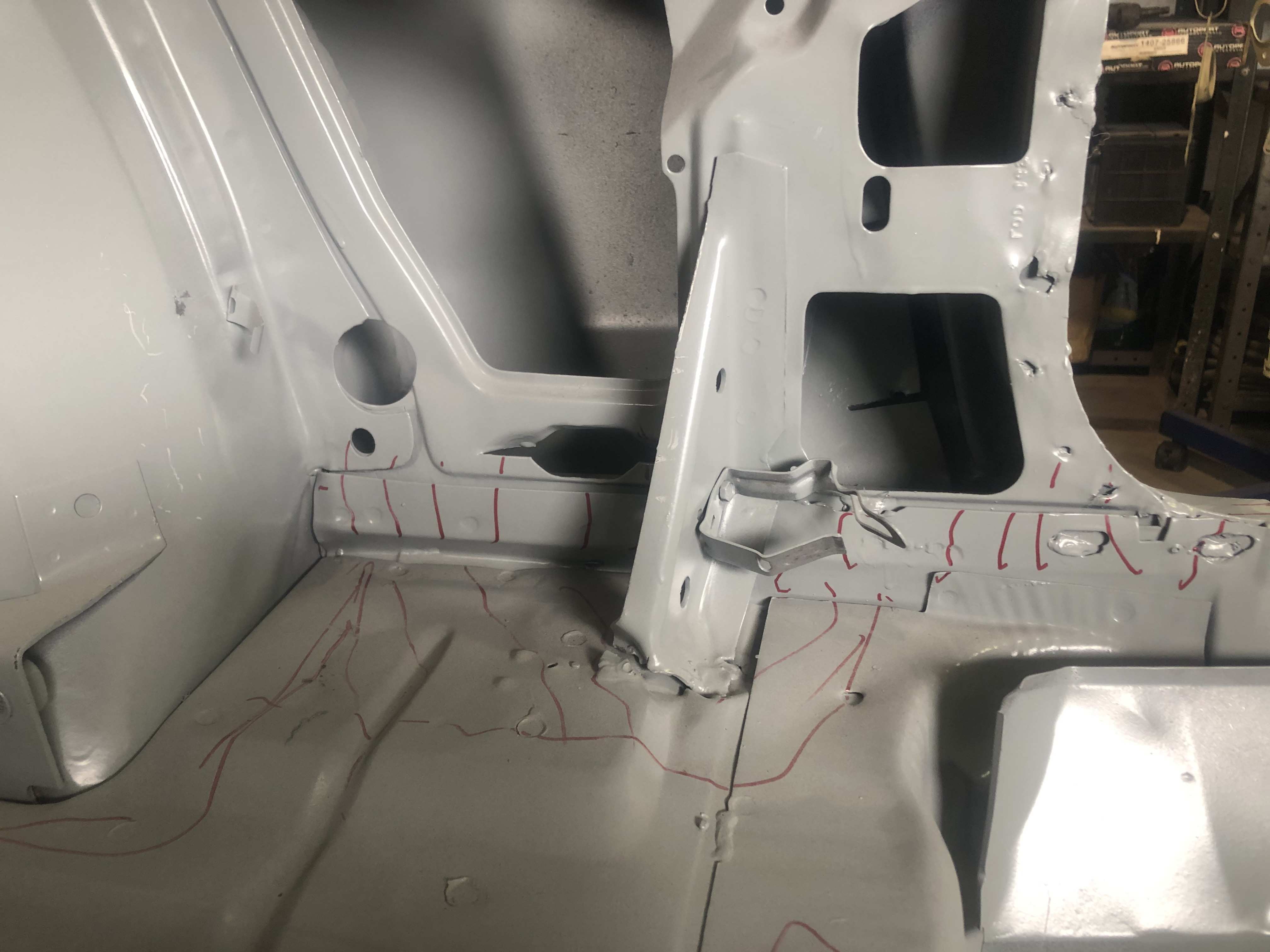

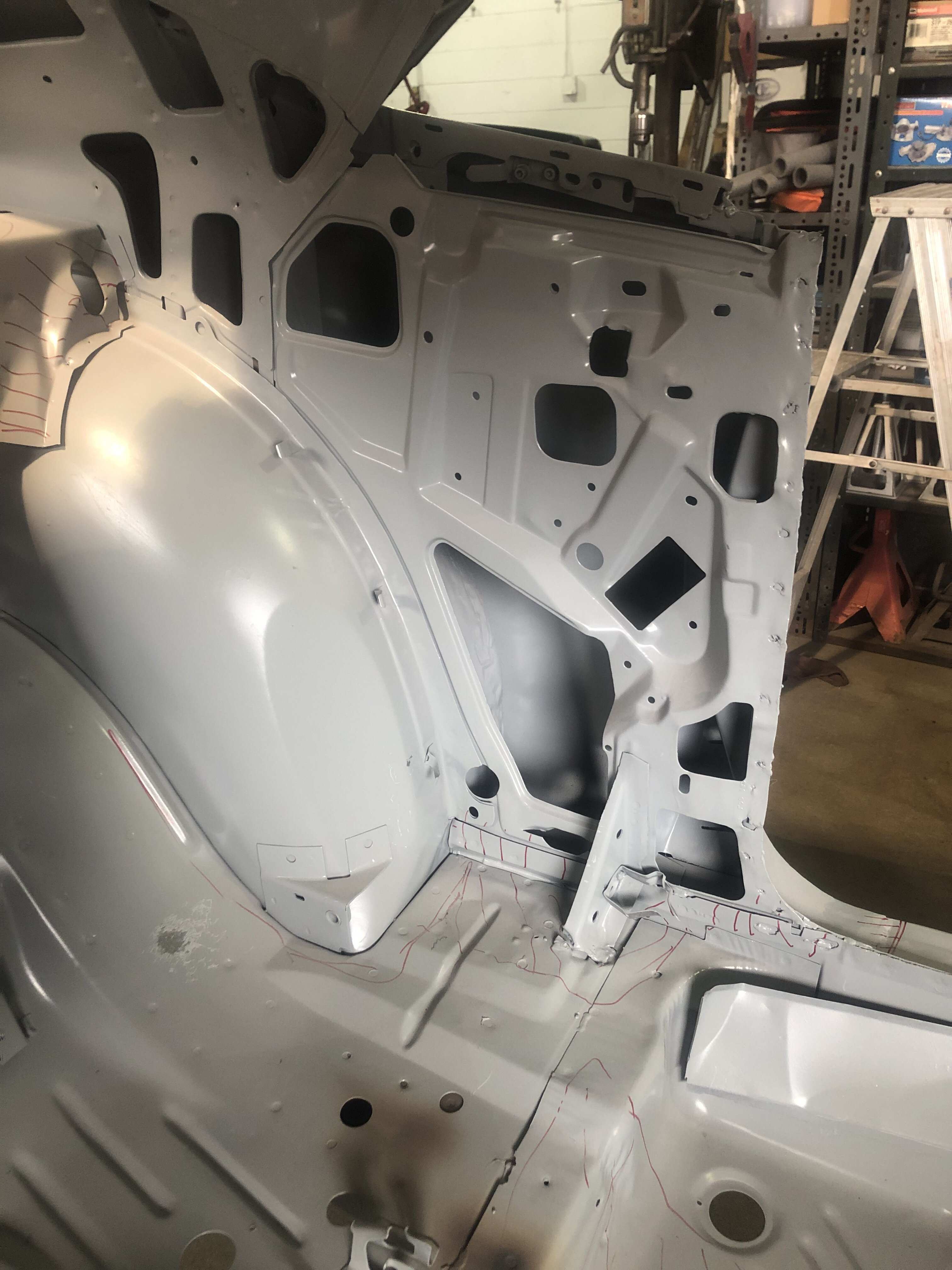

Hey guys so I'm hoping to get some references pictures and measurements for a 70 cuda I'm working on. The car was T-boned at somepoint in its life. and was repaired with a donor ds b post and quarter, most of the secondary damage was left untouched. I'm in the process of replacing the previous repair as well as any rust issues. However the car still needs to be pulled to get the secondary damage repaired before any new sheet metal is replaced.
The pictures below are the secondary damage areas that were not repaired. Any pictures of these areas would be appreciated.

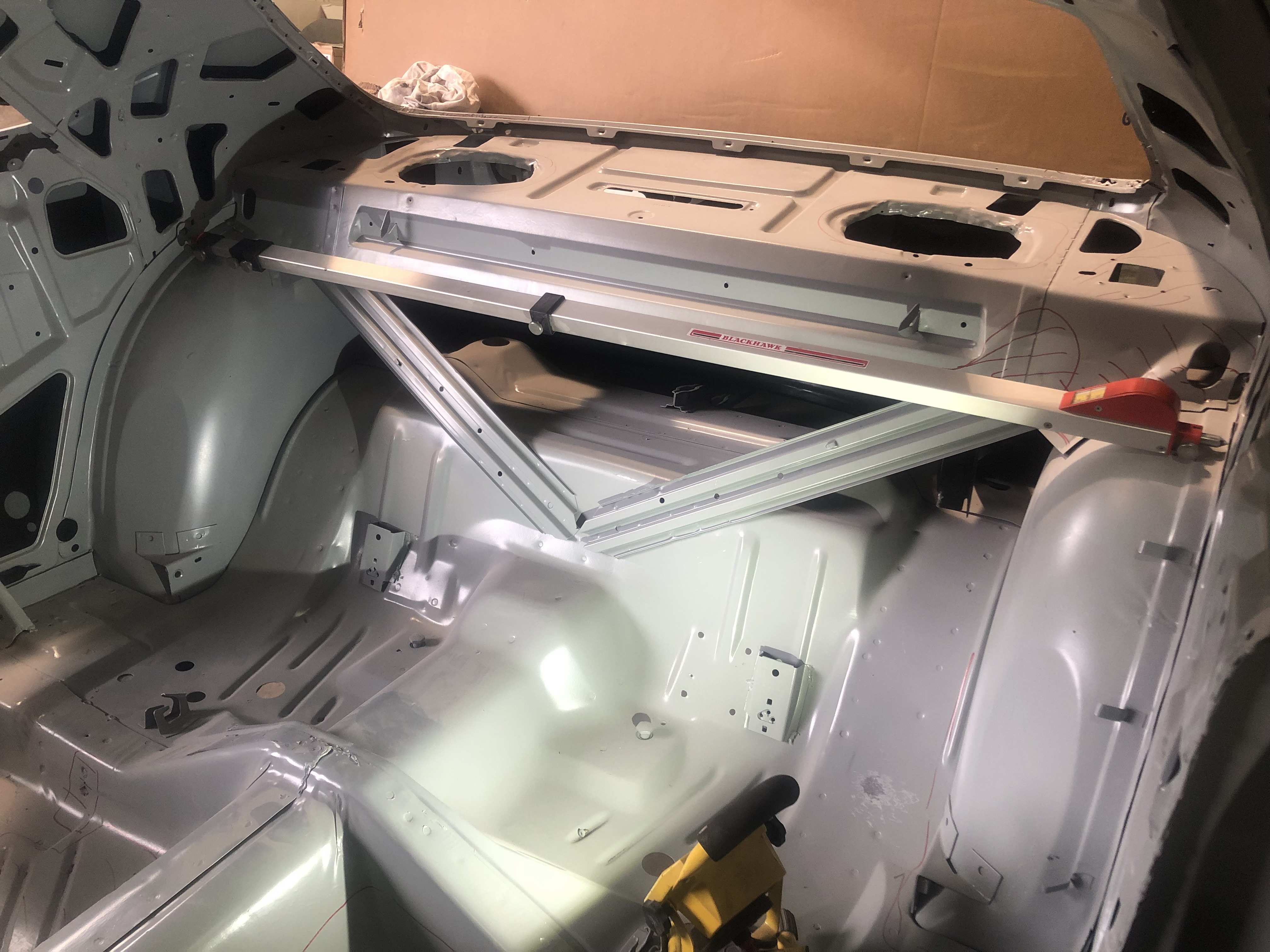

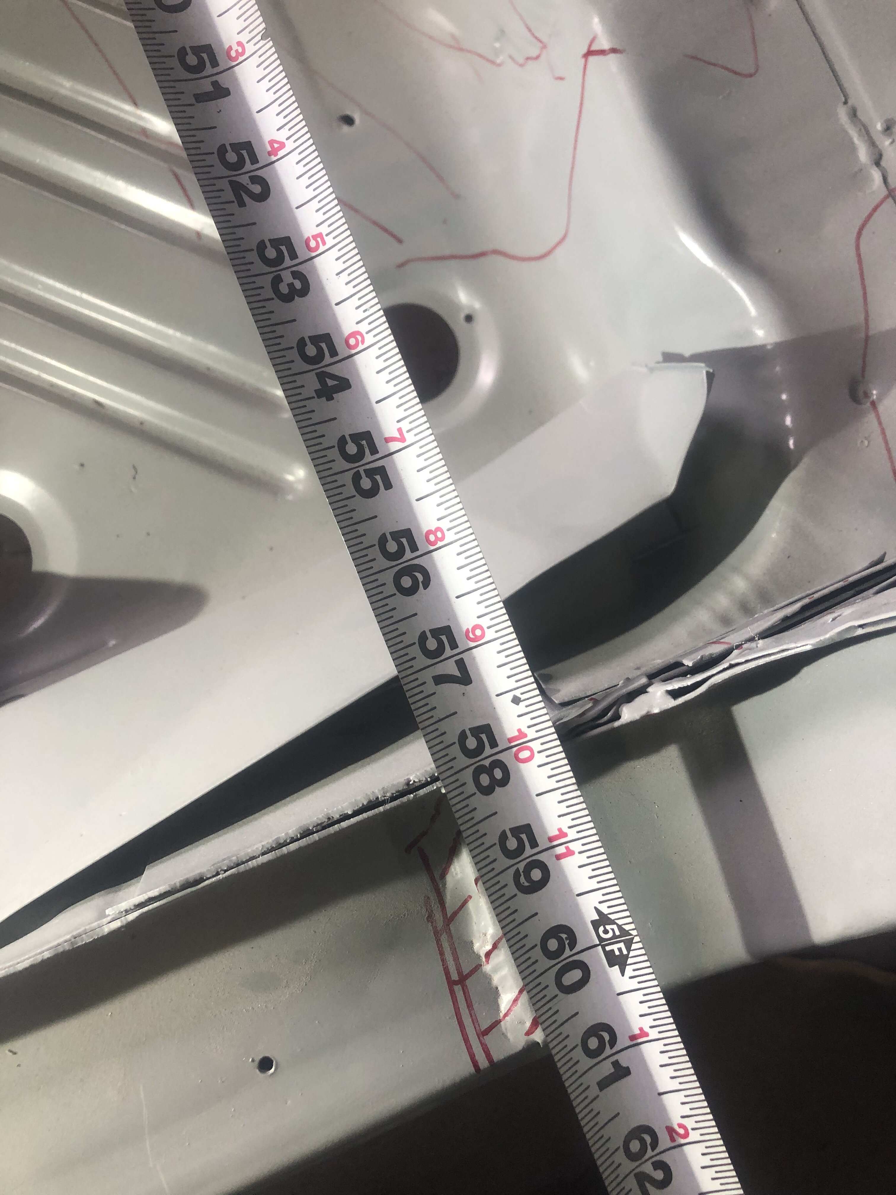

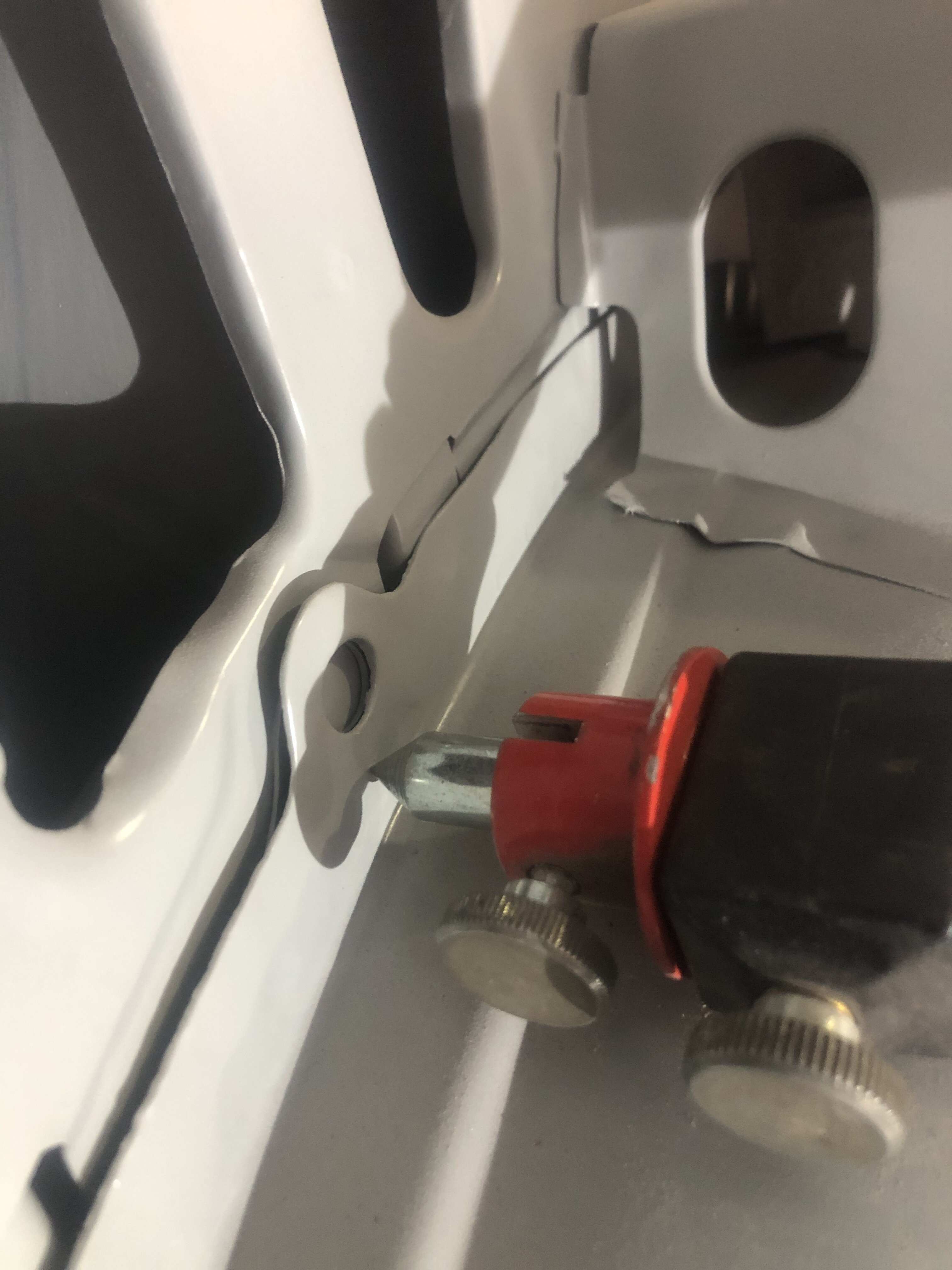

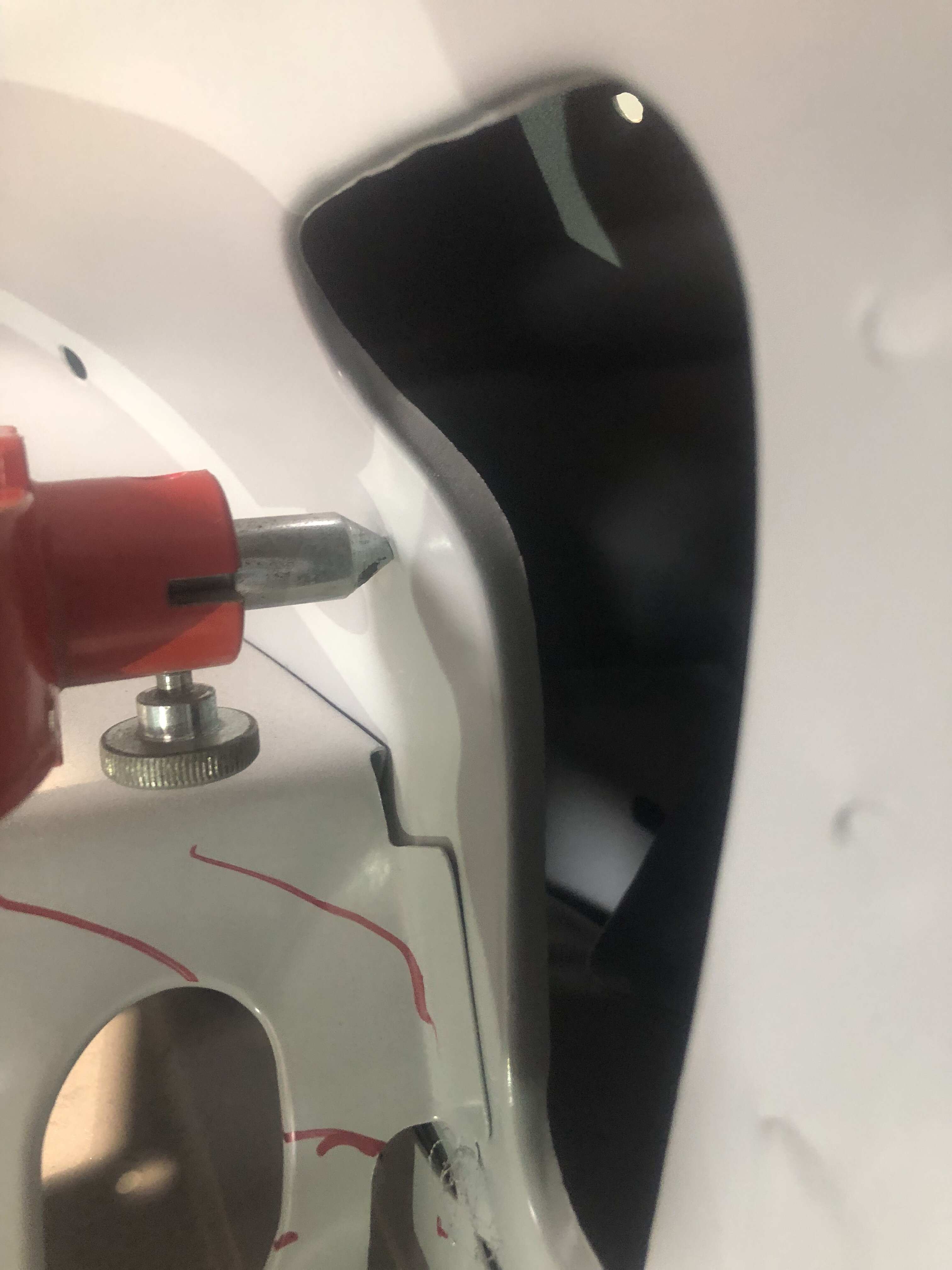

Also I'm looking for measurements in these areas

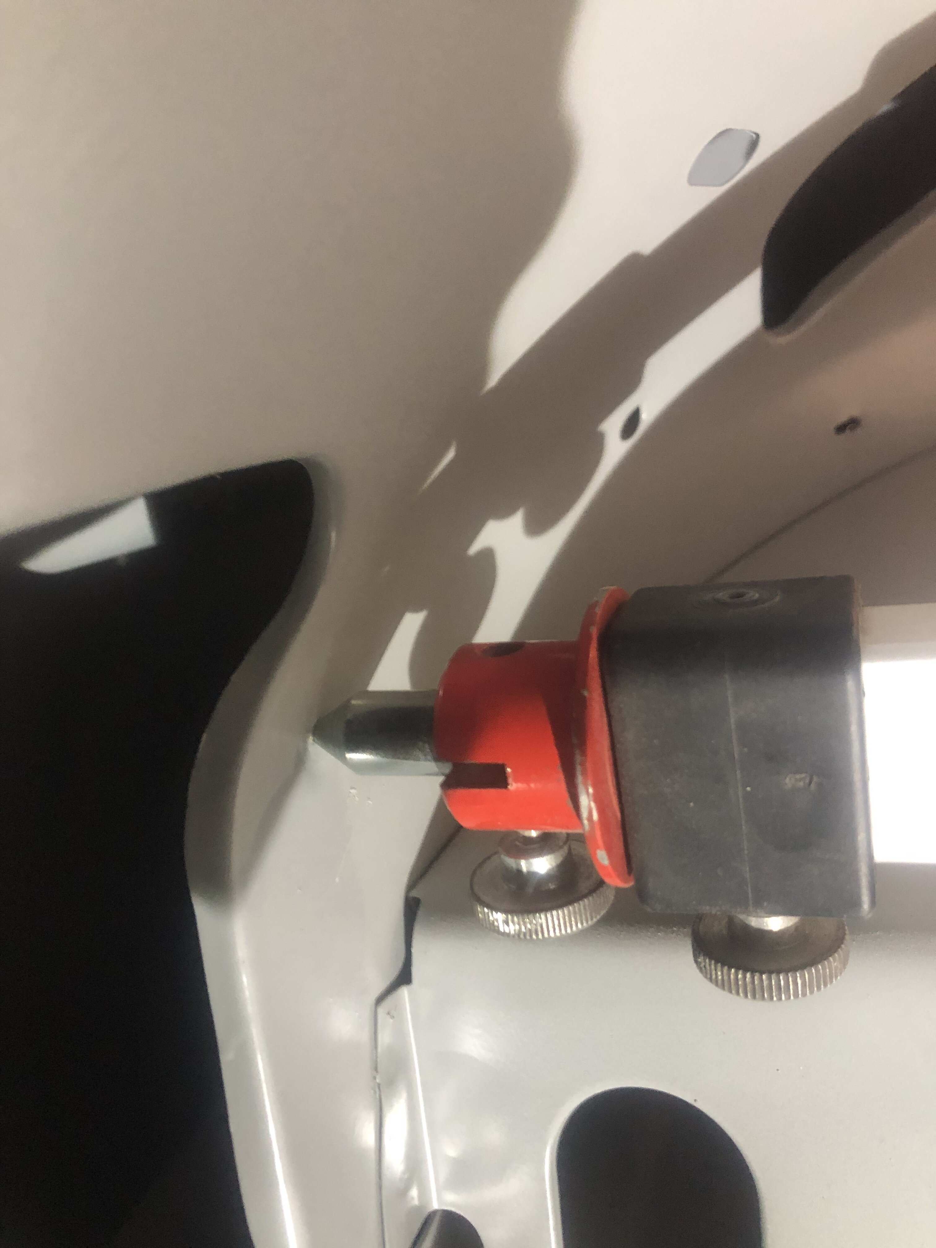

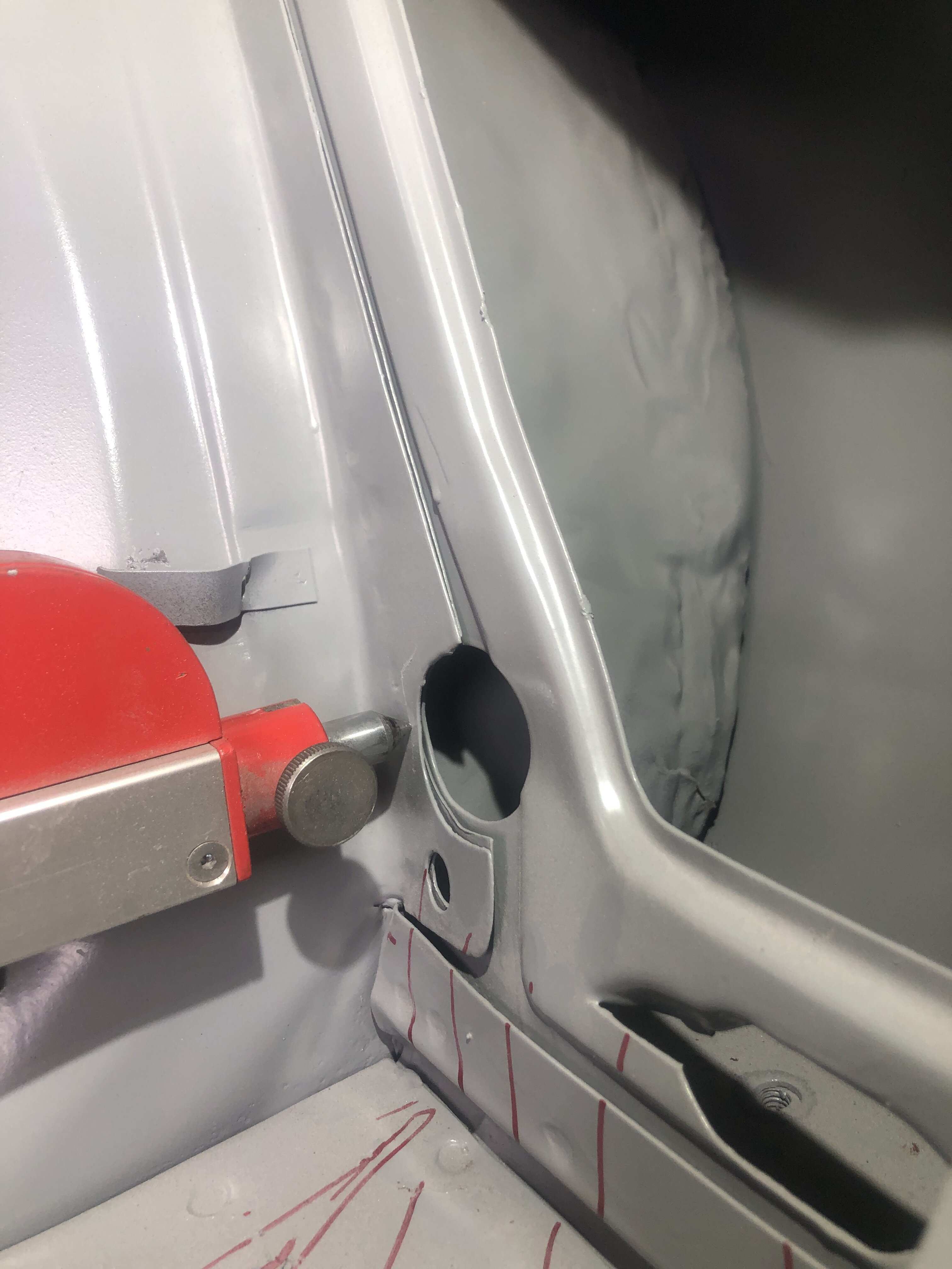

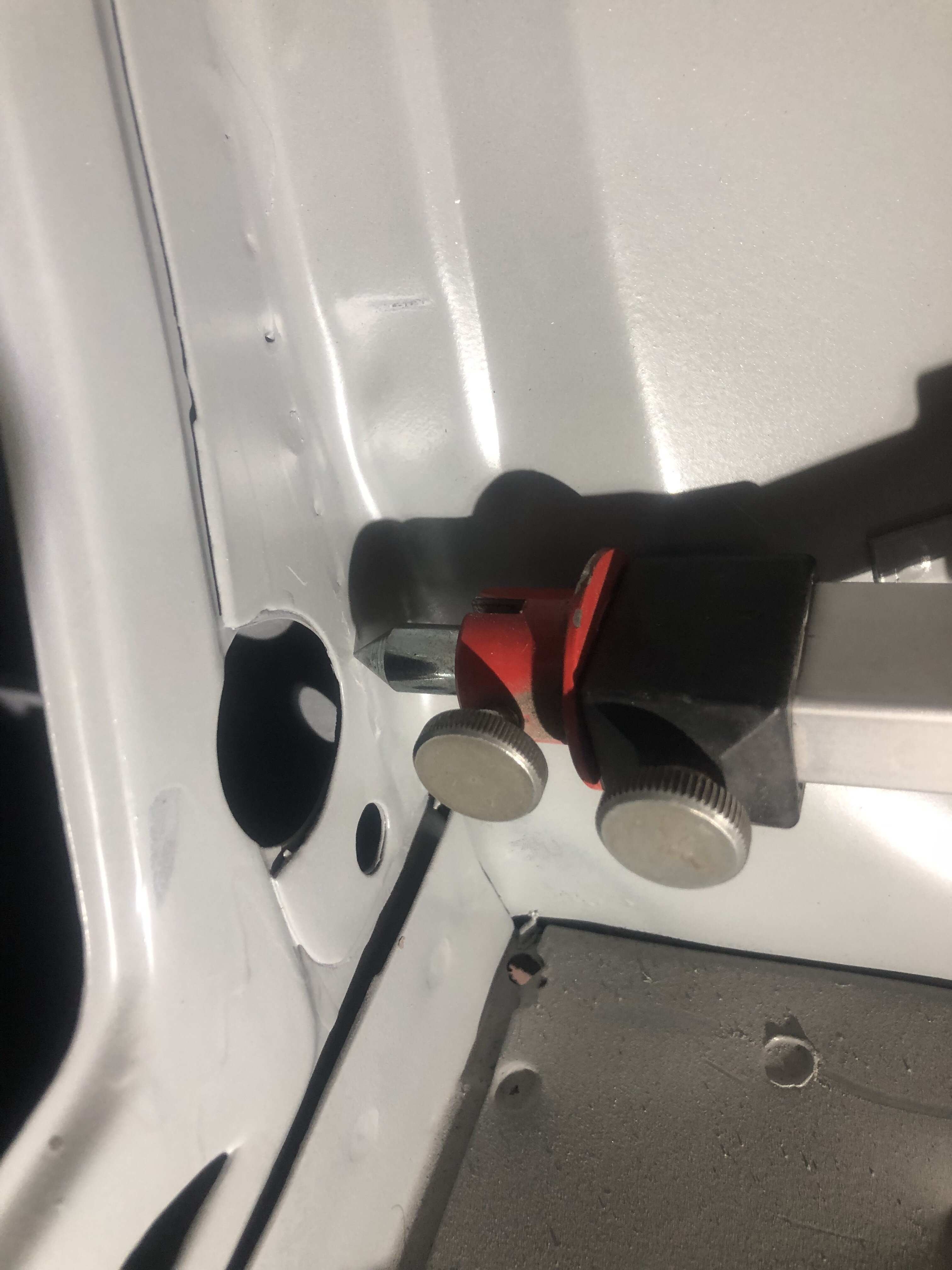

Measurement #1 overall measurement between the wheel well flanges at the upper alignment holes
Measurement #2 overall measurement between wheel well flanges at large lower hole
6pack2go
Aug 27, 2023
7
Toronto
Measurement #3 overall width of package tray

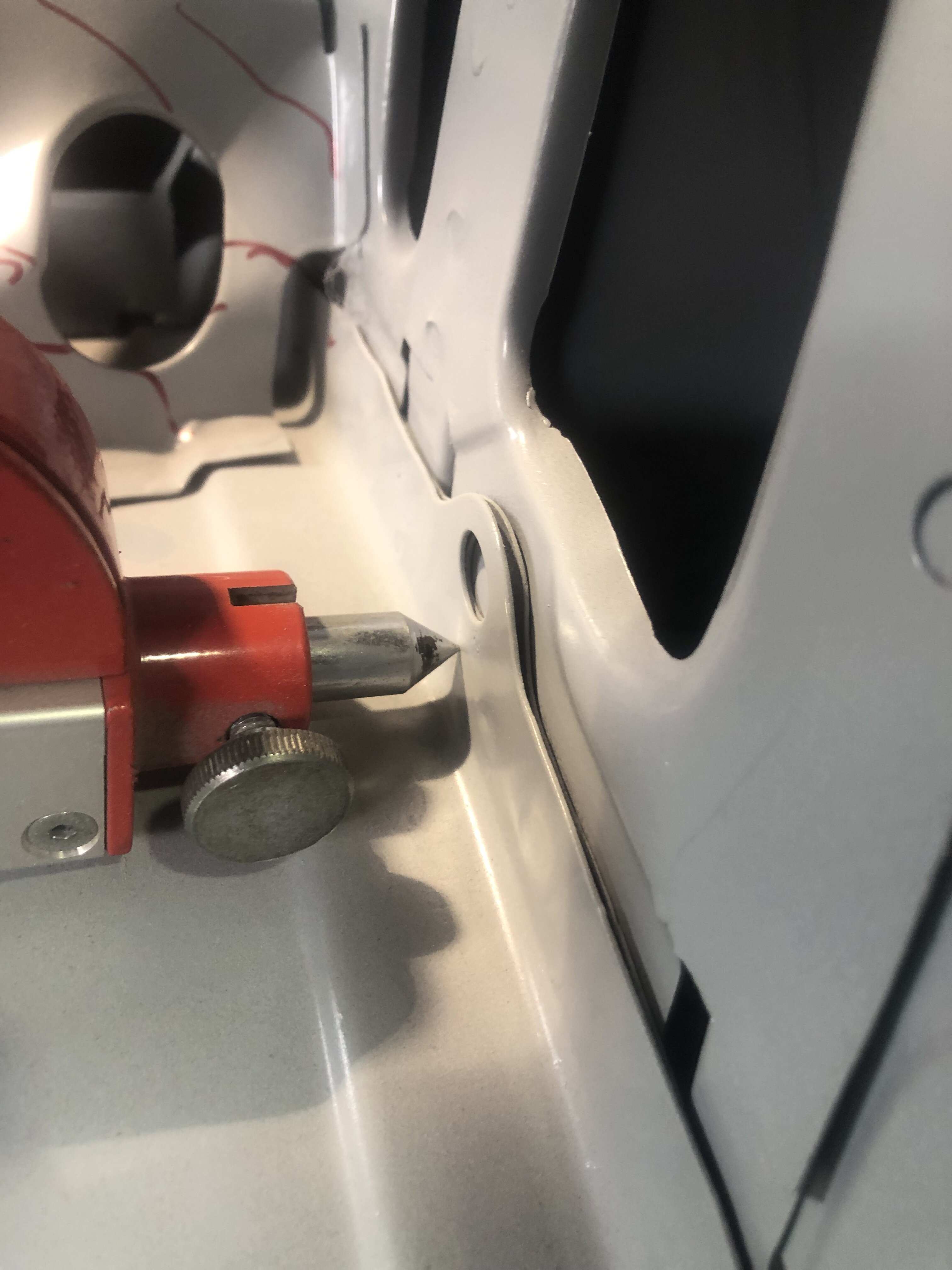

Measurement #4 overall measurement between top rocker pinch weld at edge of b post

Here are my measurements, I don't see any evidence of my car having been hit. Although I think a couple of different car measurements would be better.
#1 59 1/4
#2 58 1/8
#3 59 1/2
#4 58
