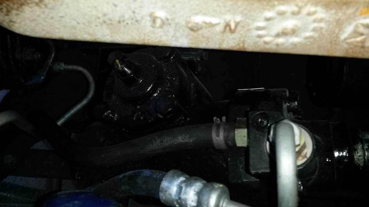

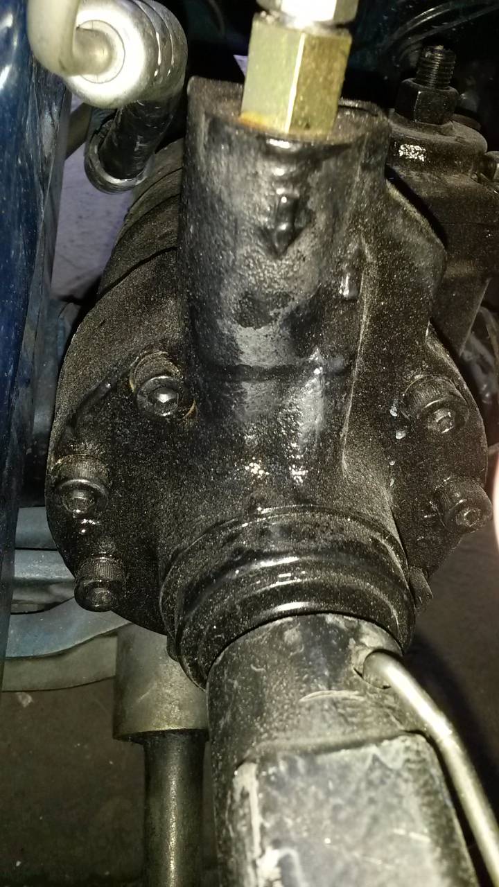

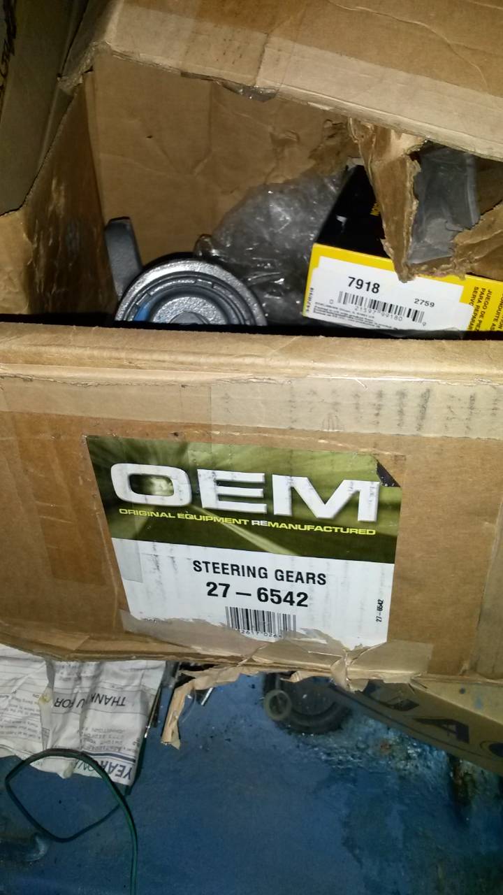

If you box is original keep it and give them another core or just pay core charge.Any core. shop.advanceautoparts.com/p/cardone-steering-gear-27-6581/10314420-P?searchTerm=steering gear $149. used discount and perks it was about $112.This is the 1 1/4" good replacement until I rebuild mine.
