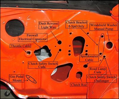

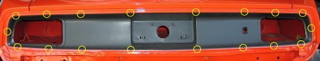

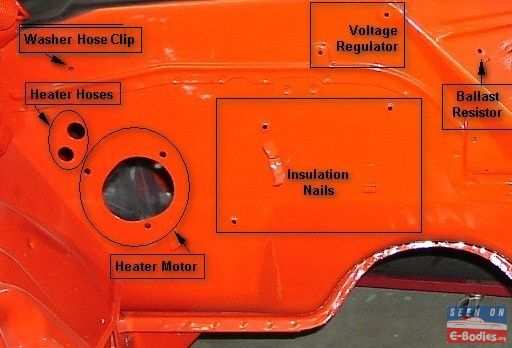

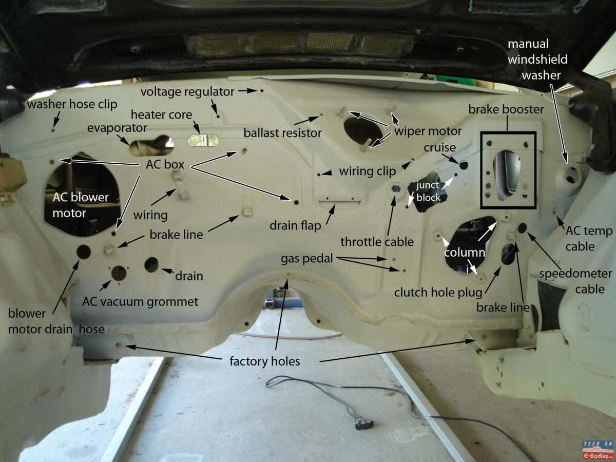

Getting ready to send my 71 to the body shop. Has new 1/4 tail panel Dutchman trunk floor. Anyone have a diagram or measurements to where the tail panel trim clips go, the by plymouth emblem, vinyl top, and rear window reveal studs get welded on. Also the firewall holes want to weld up any extra holes before paint.
