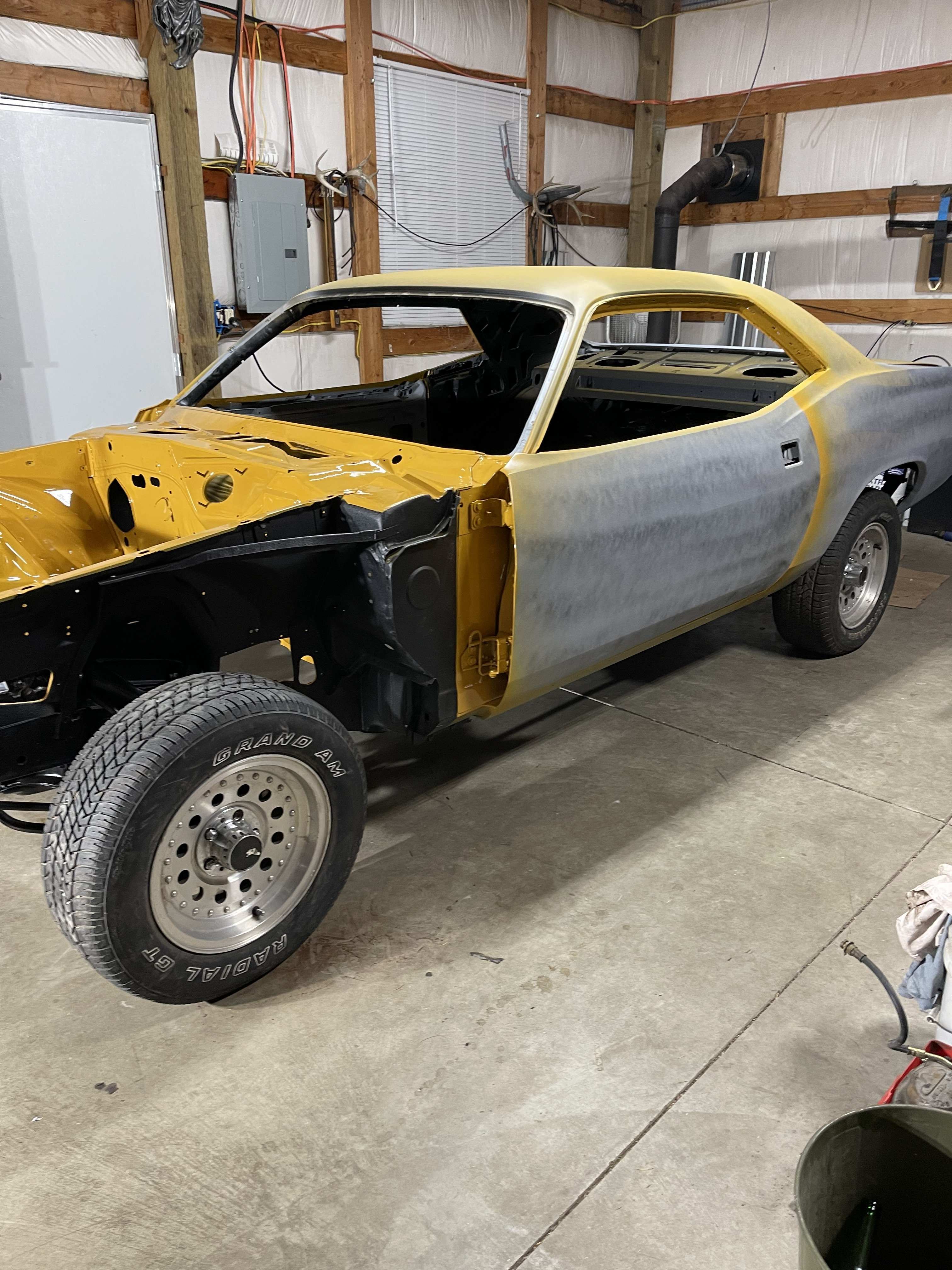

What is the correct carb for a 71 cuda with 340 and automatic transmission

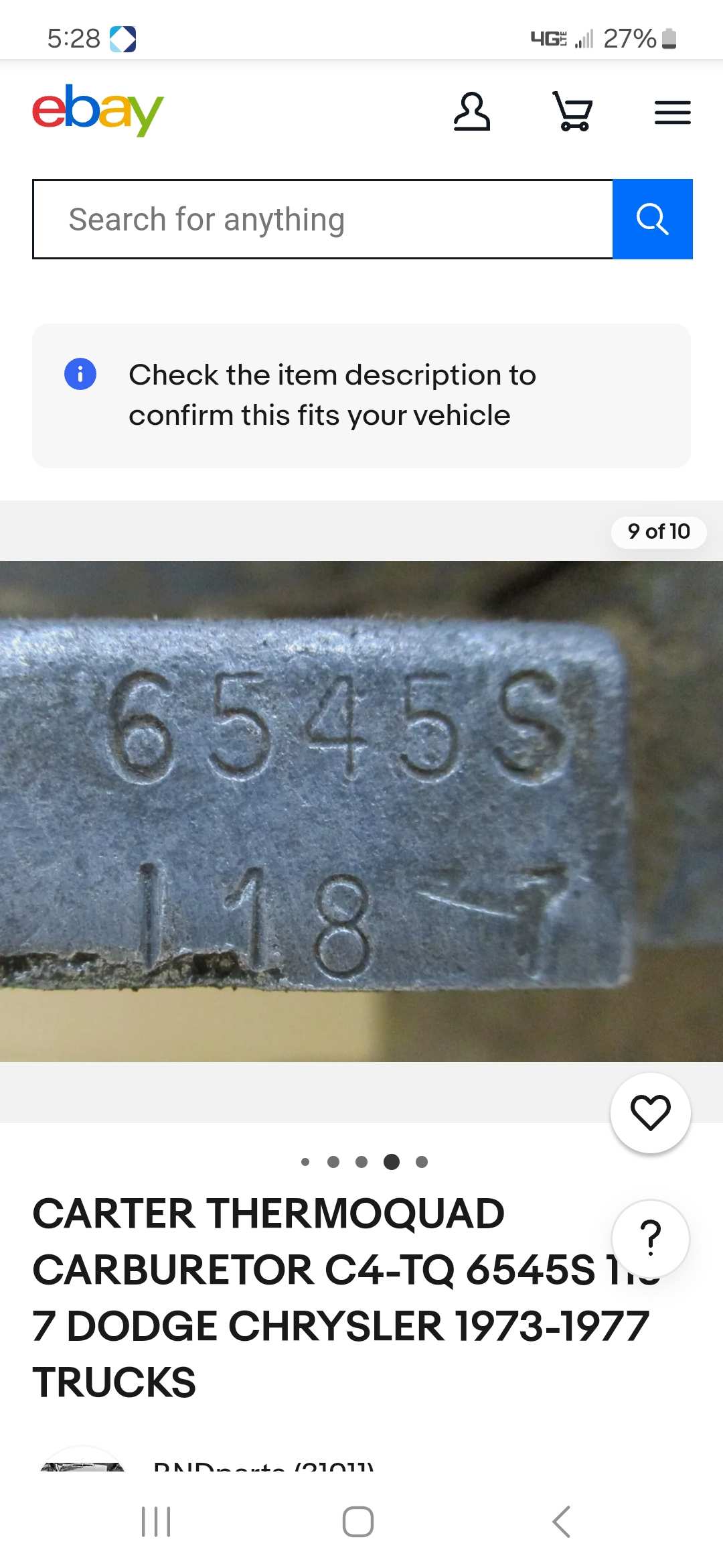

yea everything if for this thing. Thanks for responding do you know what this one is for 6545 and what it might be worth rebuildable. there is no s after the numbers and they are crooked

Mr Cuda
Jan 26, 2022
309
158
North of Seattle
There's a dirty, bent vent tube one on ebay for cheap, but to quote joe biden, and I usually wouldn't
"Don't"
I find that the 71 air bleed carbs work better than the later ones, but maybe I got lucky, or later ones are just too lean.
