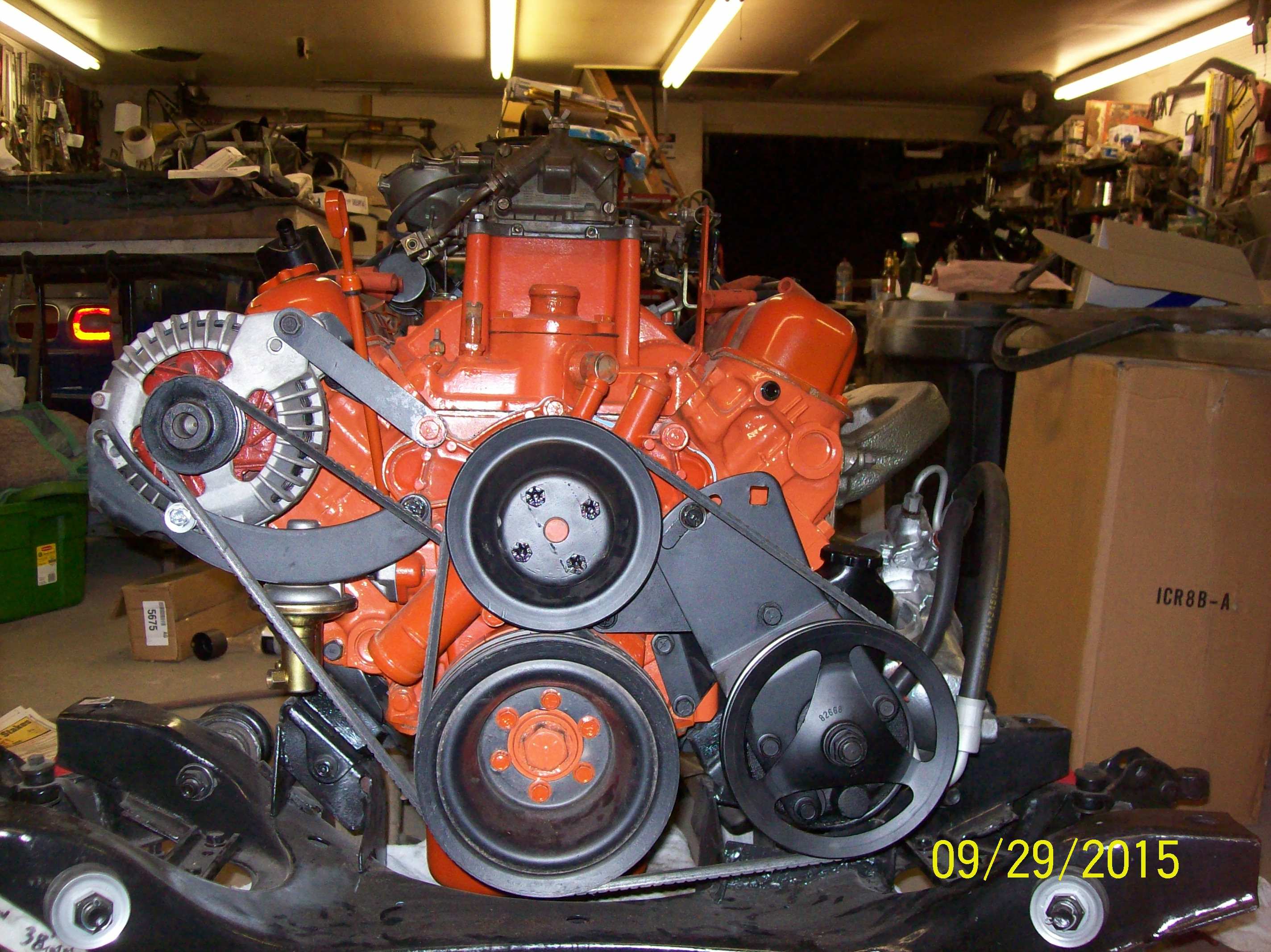

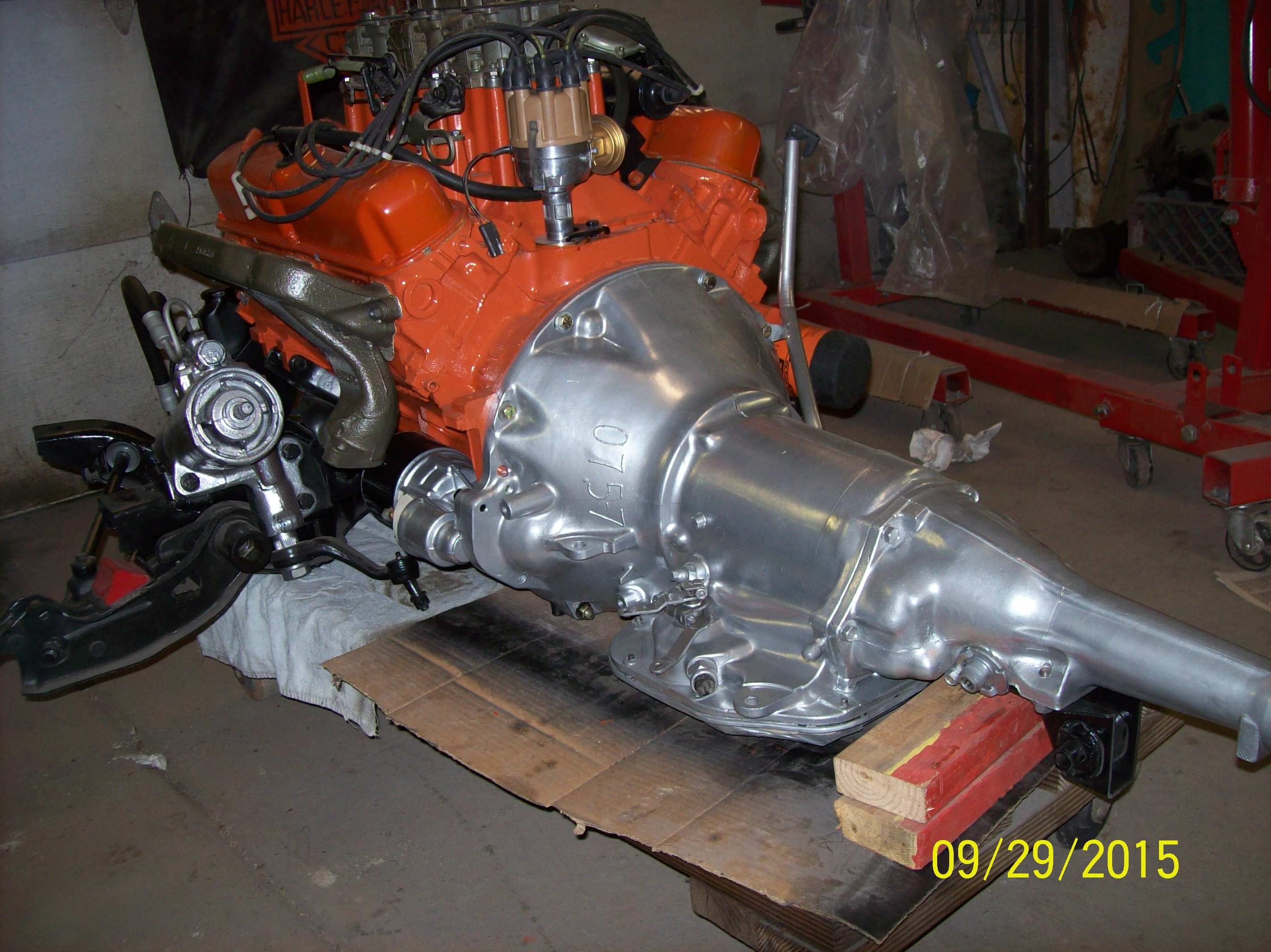

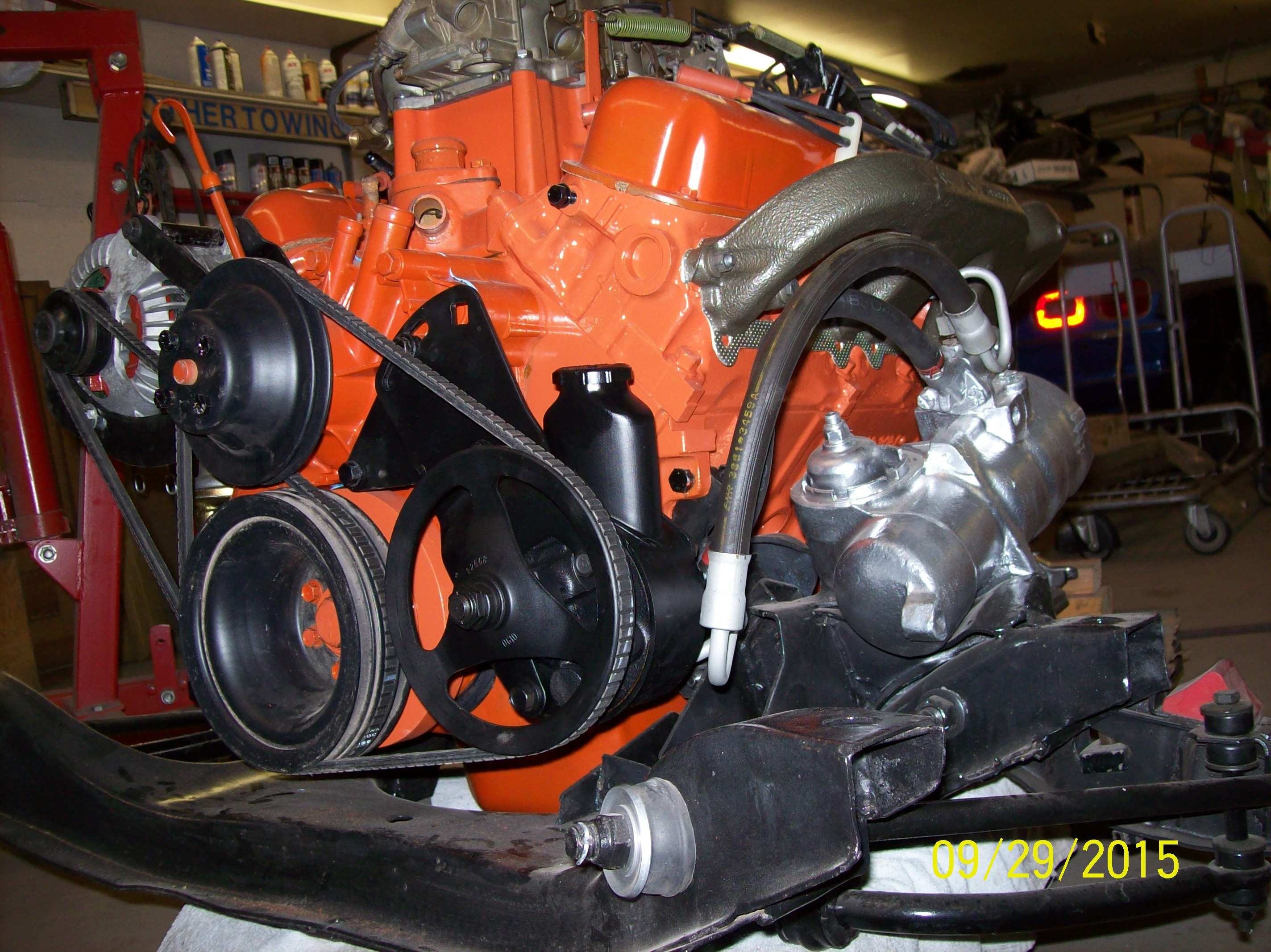

Best way is to drop the K-frame and install the engine on it like it was in the car, then lower the body over the compete assembly. Reinstall 4 K-frame bolts, upper balljoints and trans mount. No scratches, dents or dropped engines.

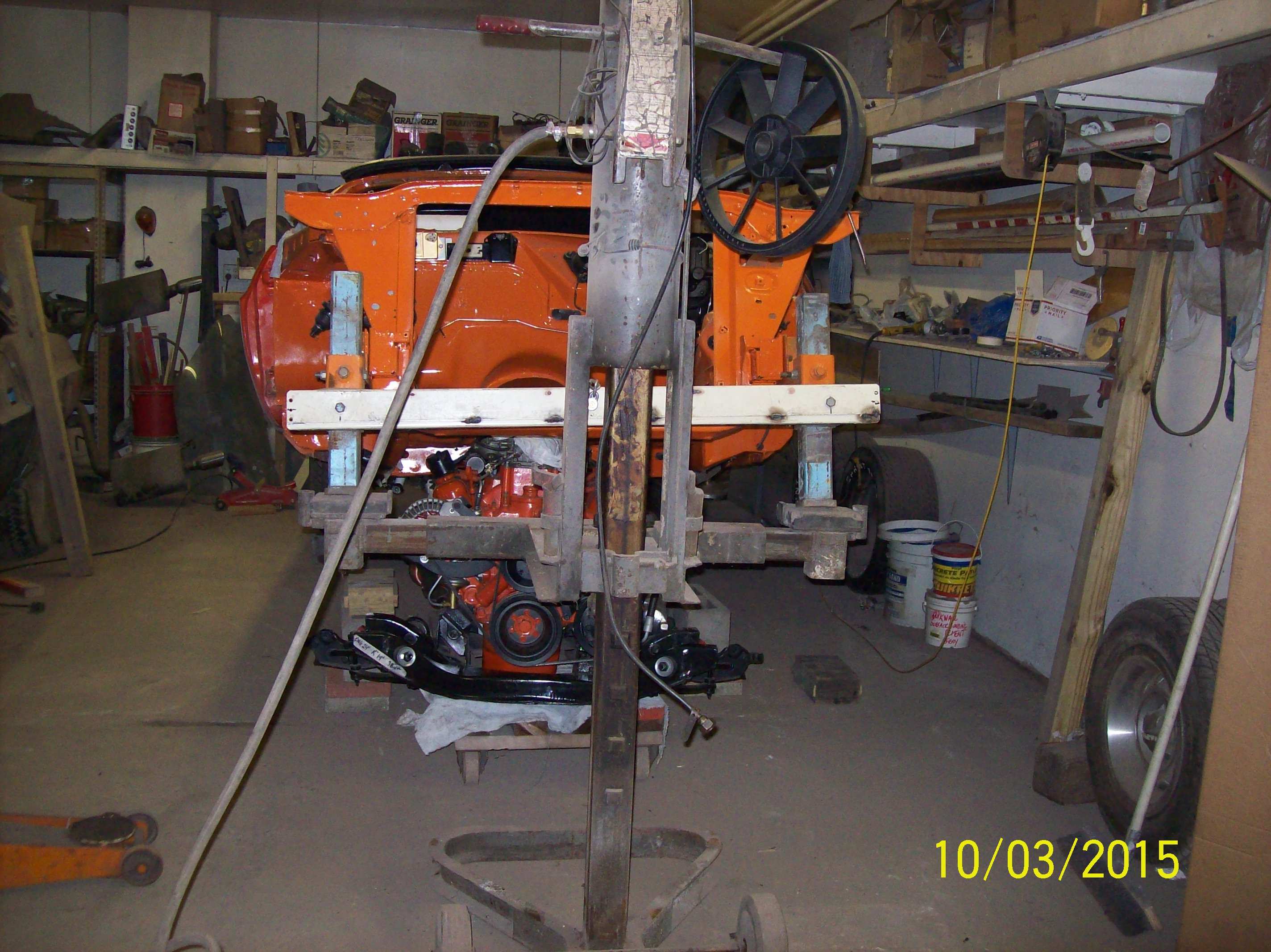

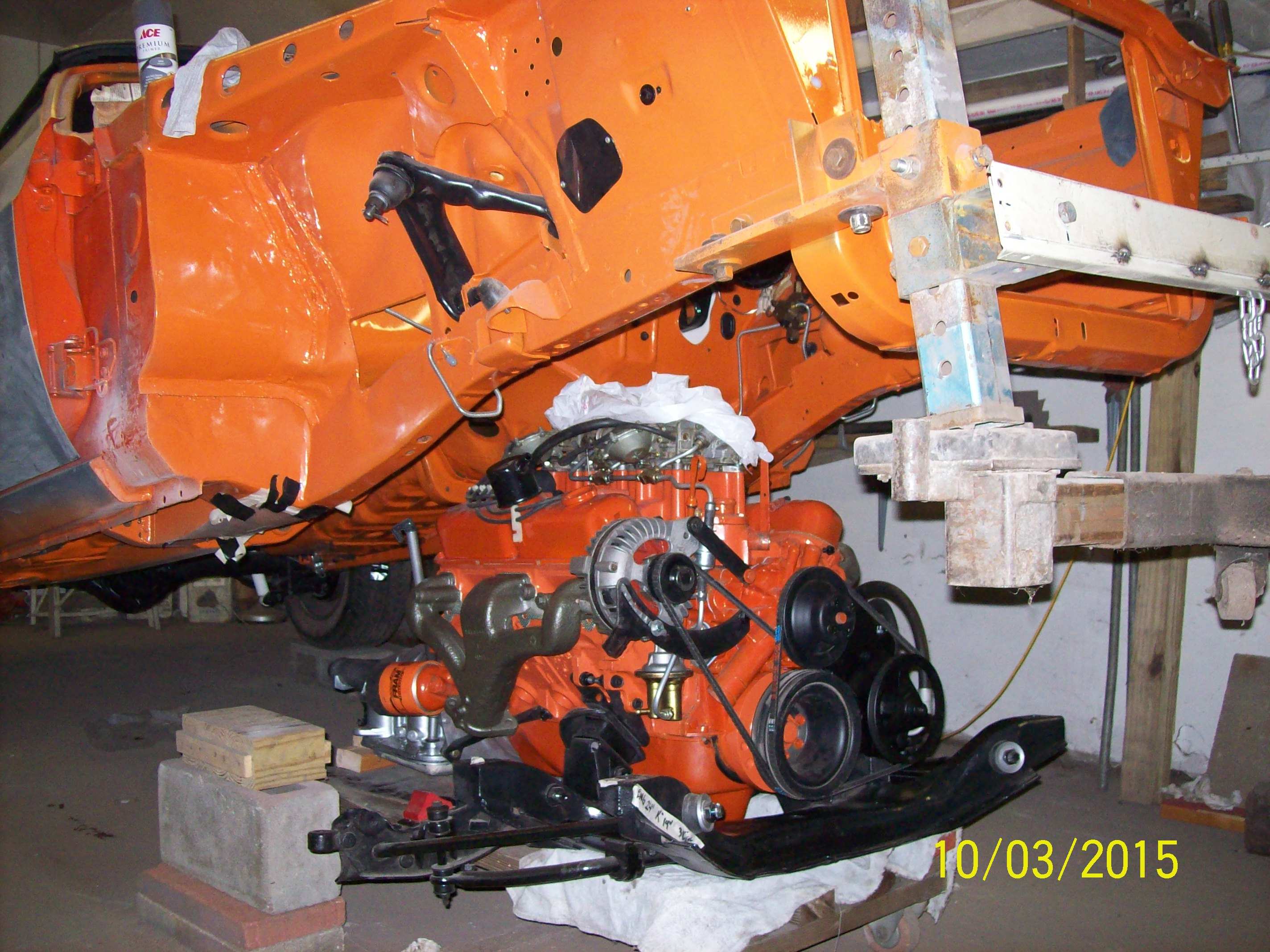

I did mine from below, lowering the car onto the eng/trans and K-member. It was super easy with no problems and I didn't have to remove the hood. I used rectangular tubing to bolt to the front bumper bolt holes and obviously a chain and engine hoist. If I had to do it again, that is how I would do it. Either way, be patient and take your time. Also, add as much to the firewall as you can. Once the engine is it, it's way more difficult to install the brake lines, proportioning valve and wiper motor amongst other items.

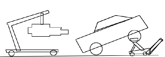

Another option is to raise the rear of the car to cut some of the assembled angle.

I had thought about take the front wheels off to drop the front end as much as possible. Looking at your diagram of raising the back of the vehicle might may provide a nice entry angle!

I built a dolly for the motor and transmission and k frame. raised the car and rolled the dolly under, lowered car and installed. One person Job.

i haven;t seen one of those old air bumper jacks in some time they were pretty handy
