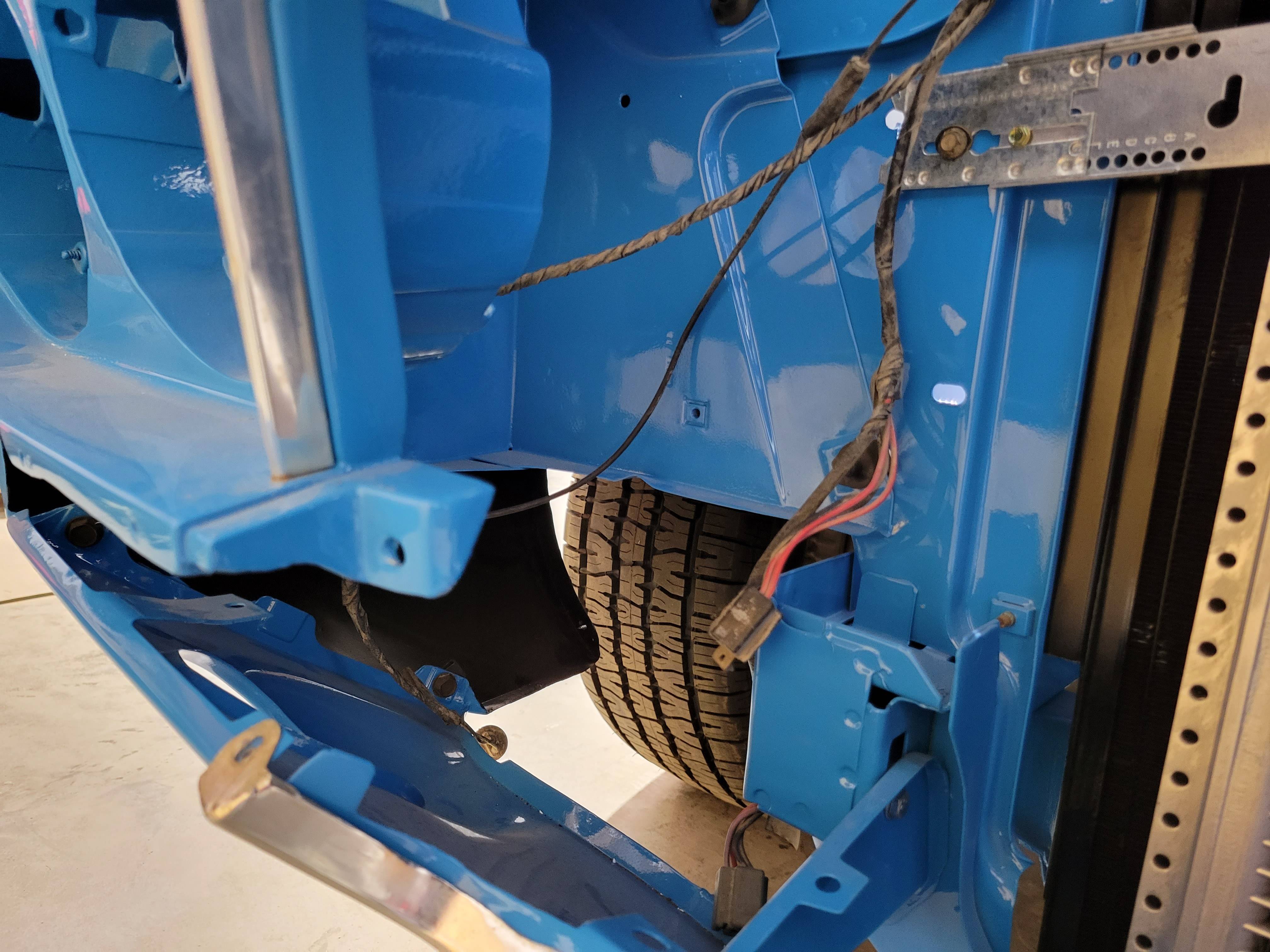

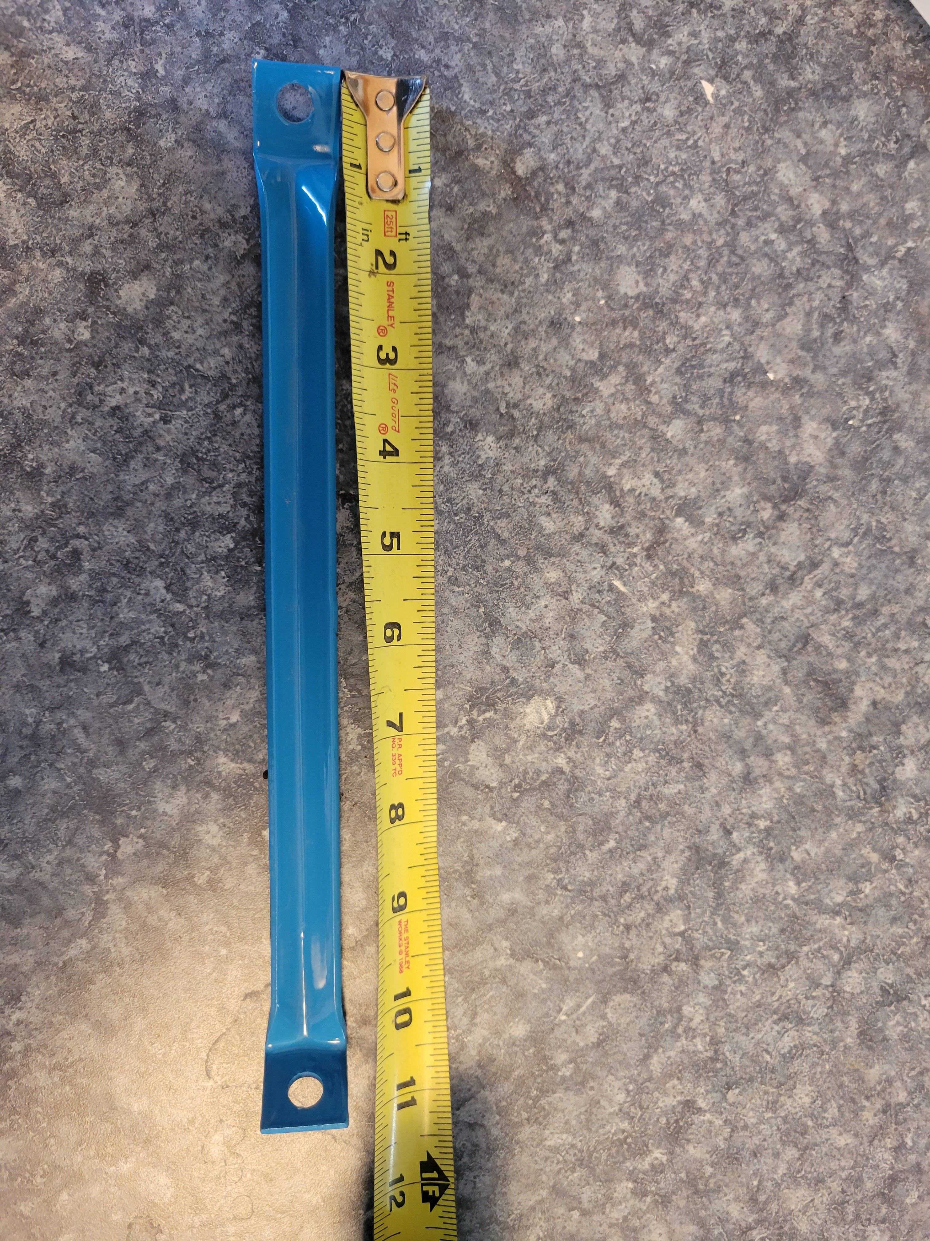

Nov 11, 2022 #1 M my72Challenger Member Joined Dec 26, 2020 Messages 13 Reaction score 5 Location Panama, NE I remember this brace being attached to the front of the fender, but what does the other end attach to? The service manual shows it attached to fiberglass part. Mine does not have the second attachment hole.

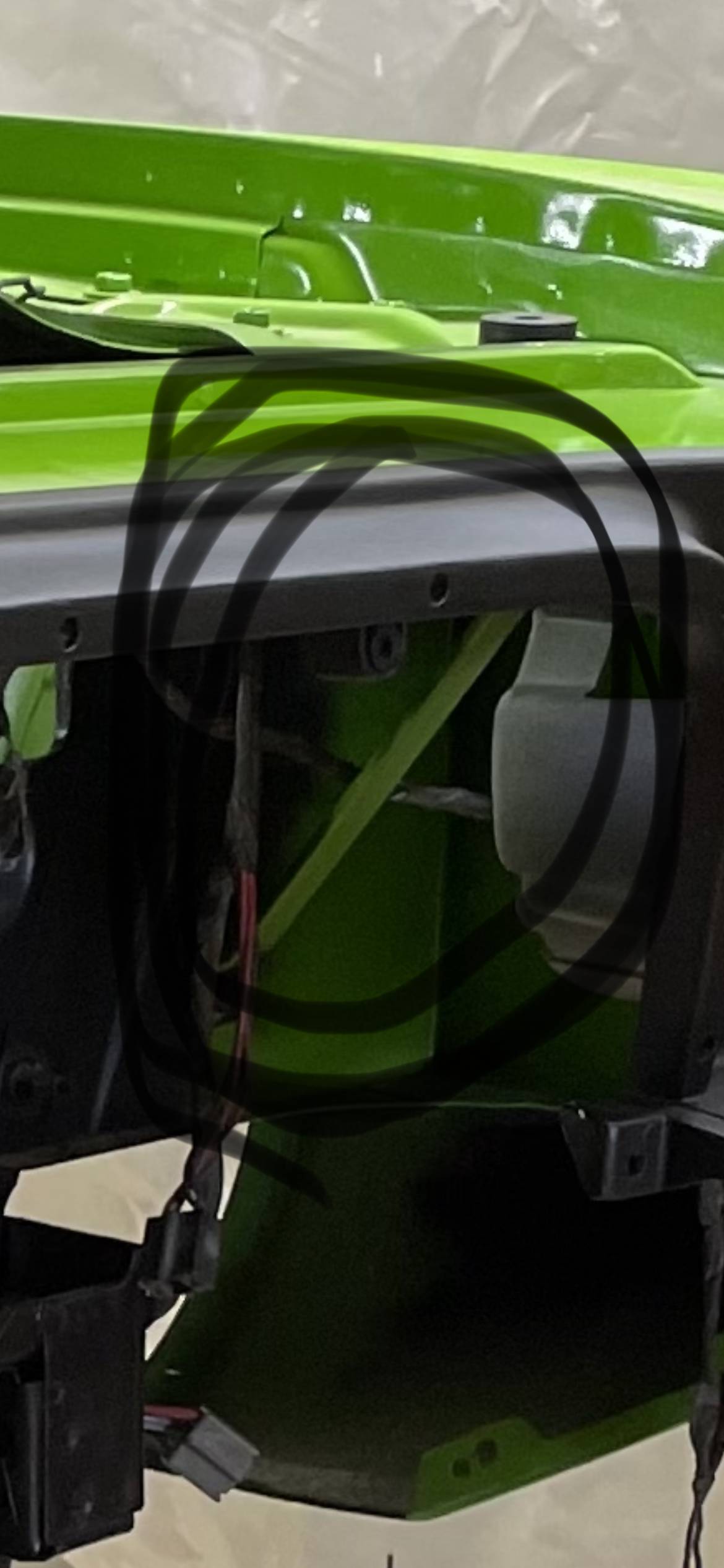

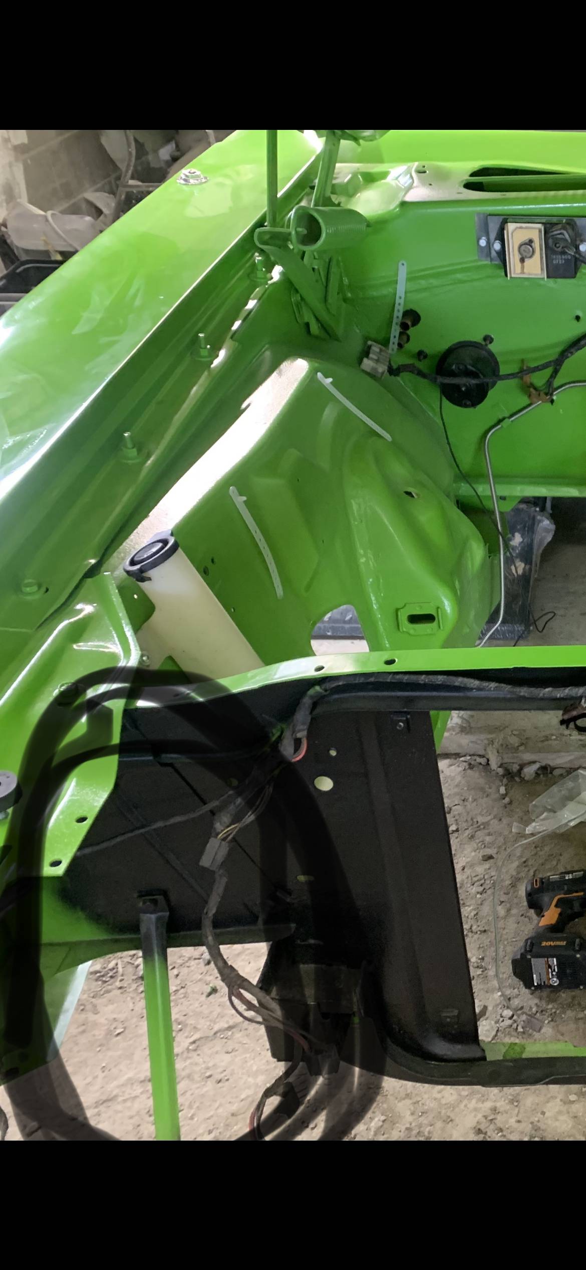

Nov 11, 2022 #2 7 73Machine Well-Known Member Joined Oct 16, 2017 Messages 65 Reaction score 8 Not a good picture, but going through my build pics the best I have of that part.
Nov 11, 2022 #3 7 73Machine Well-Known Member Joined Oct 16, 2017 Messages 65 Reaction score 8 Another
