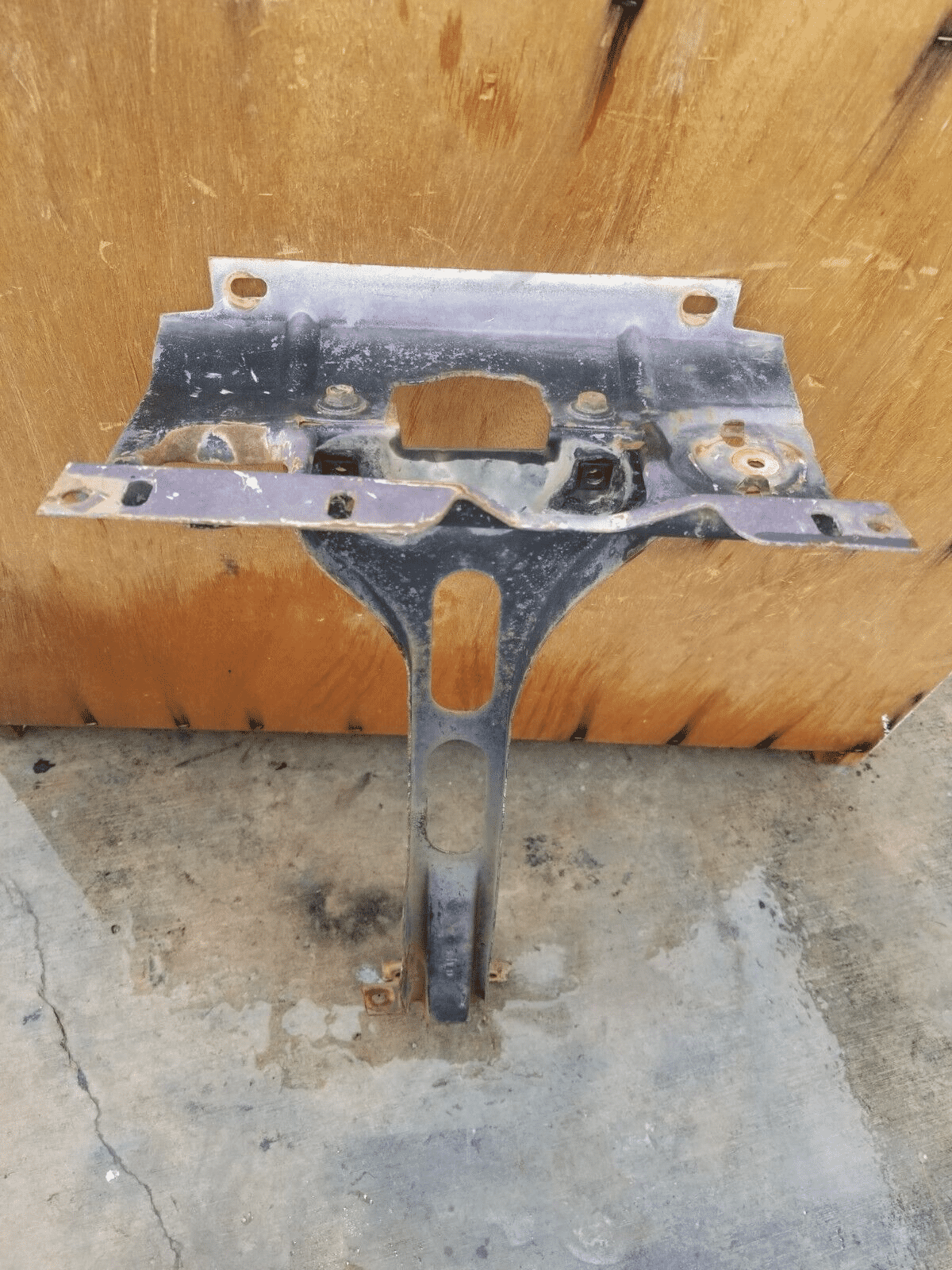

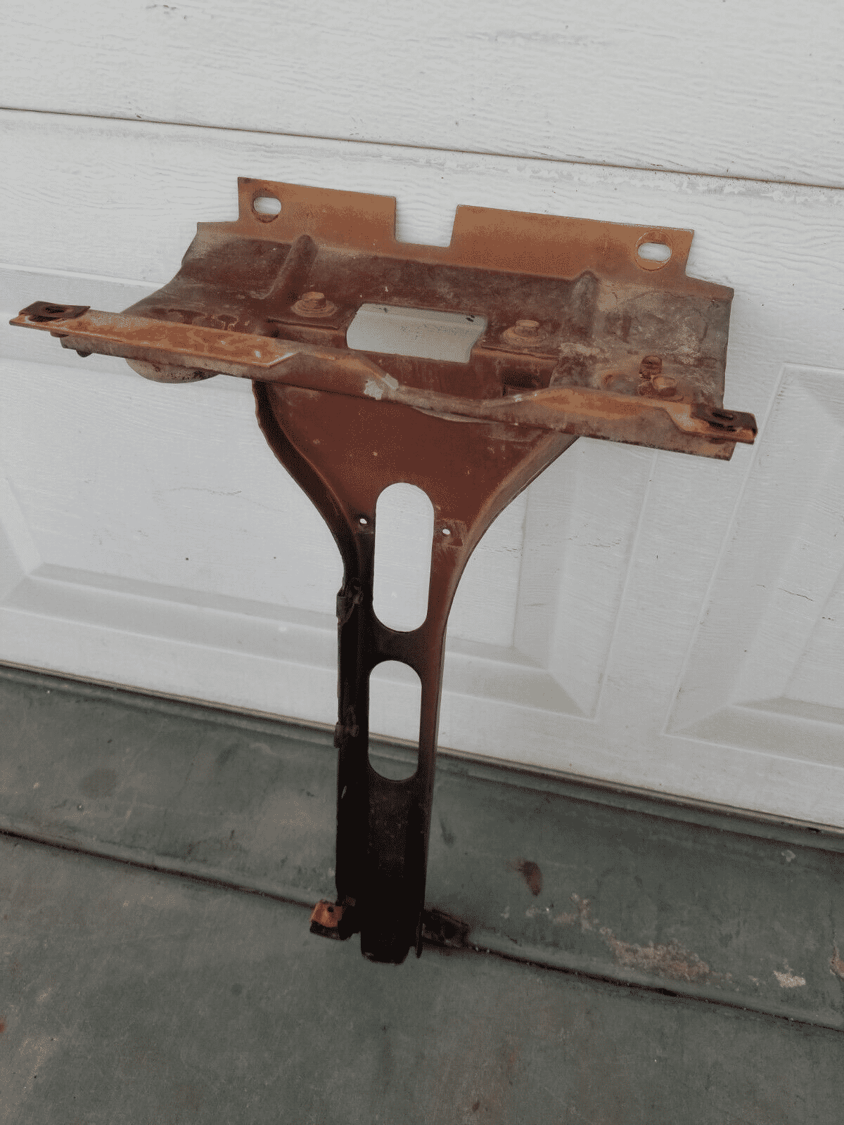

2.....The center yolk section is slightly different with the 70's having an extra mounting hole slot on the pass side top section and the 72 having a small cut out section on the rear (top section)
3.....The main yolk is pretty much the same for both

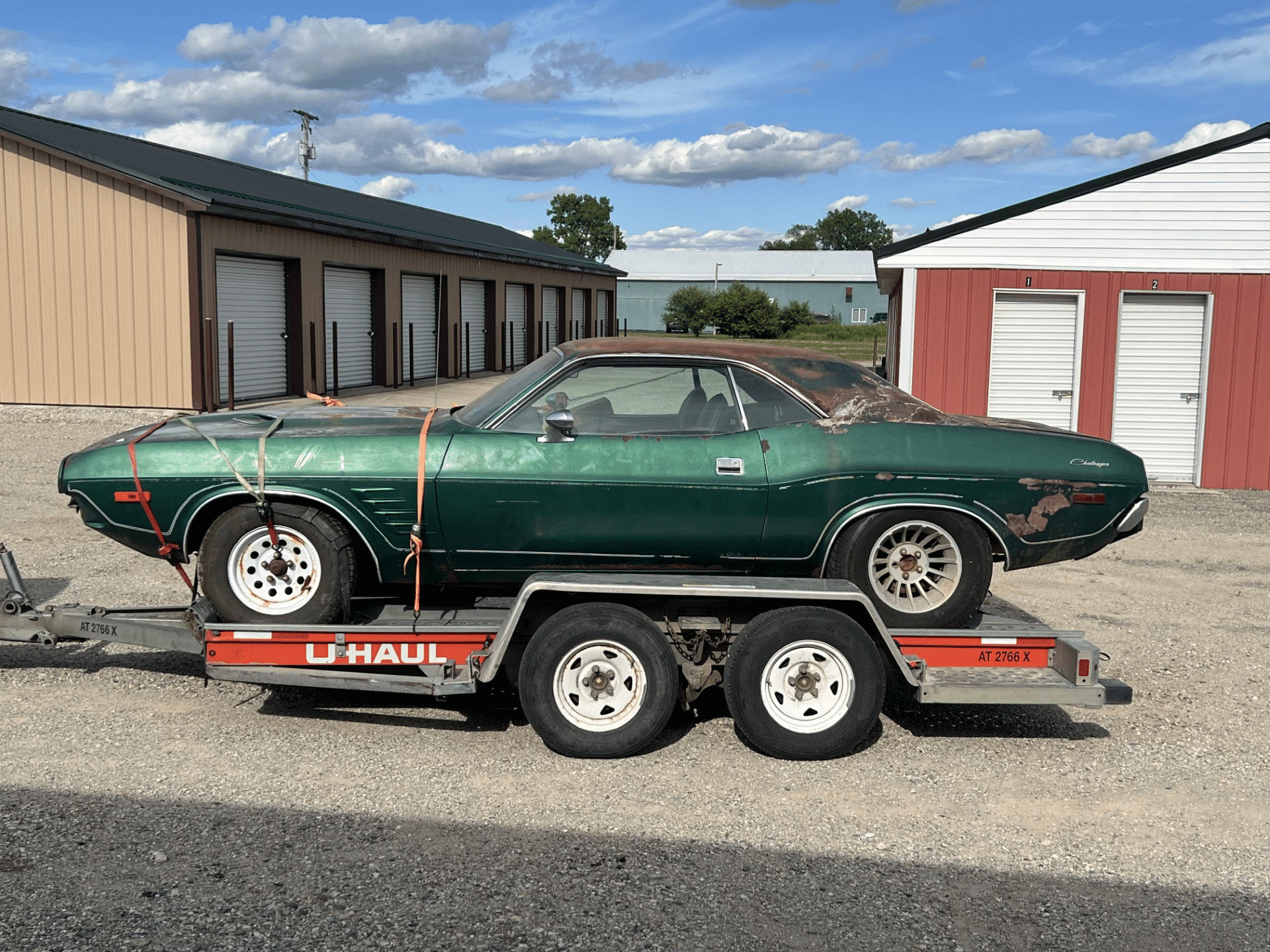

Forgot, this is the car that the changes are being done on:

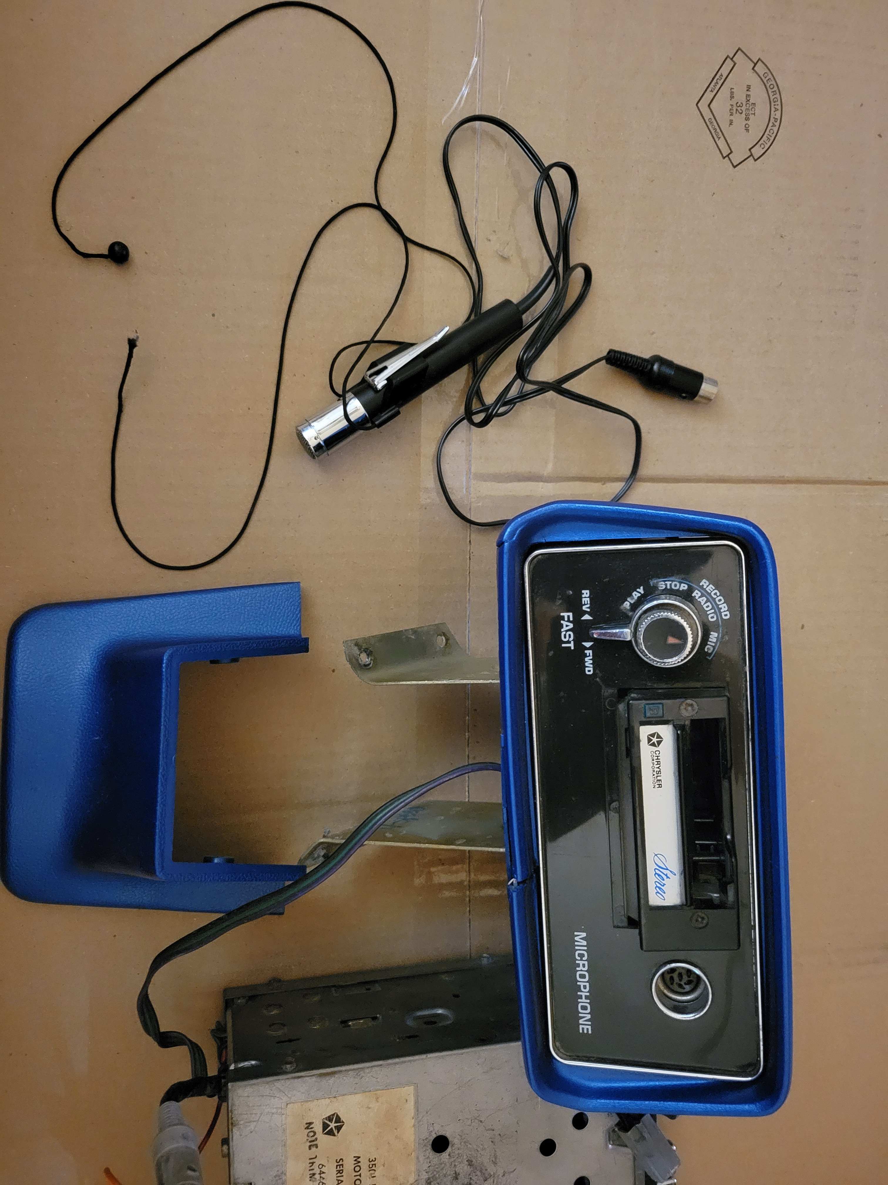

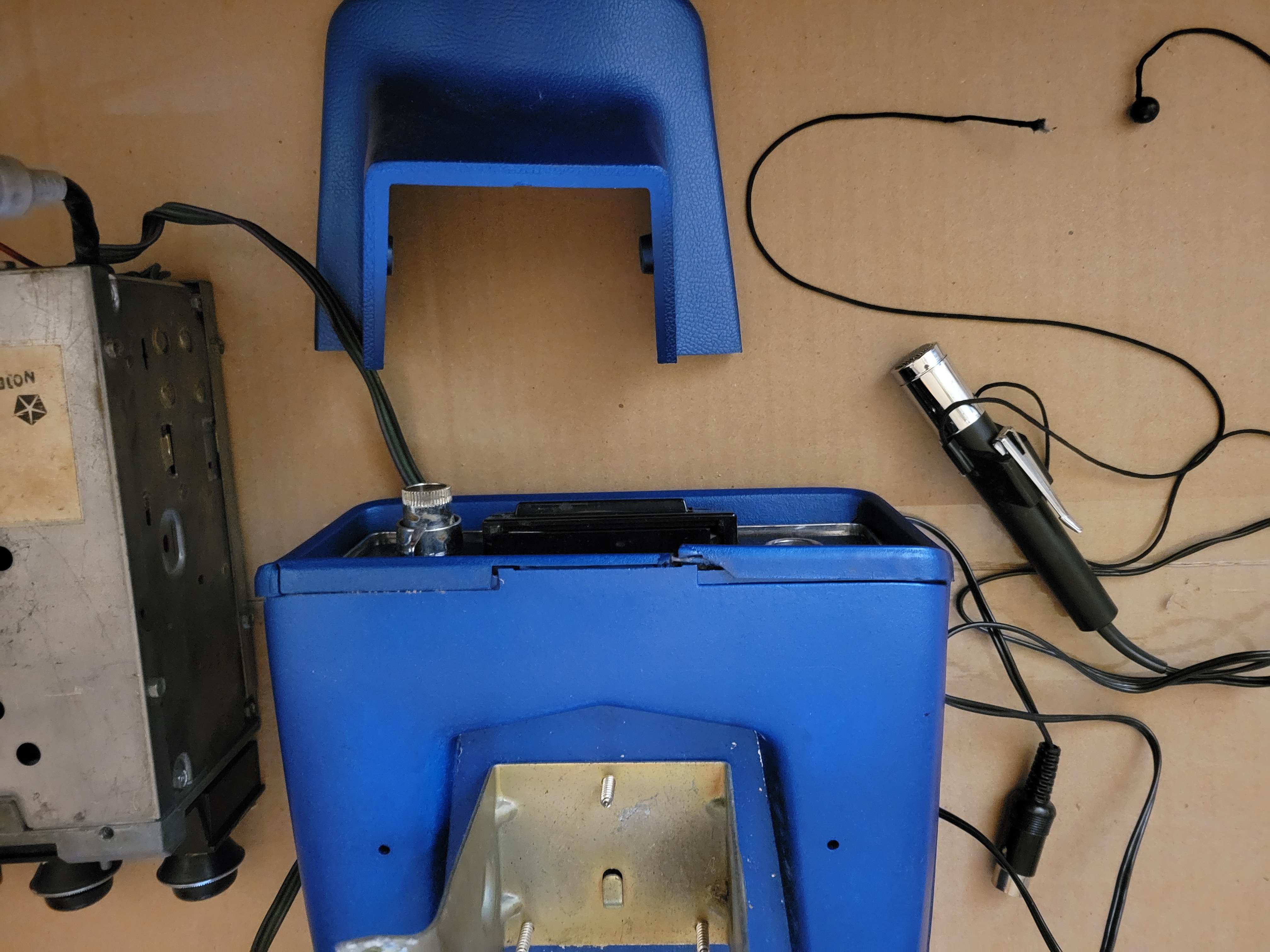

Don't see many with the cassette option still in there.
I thought the same thing, enough so that I just bought the mic it was missing to make it complete. No idea if it even works, but it will start conversations.

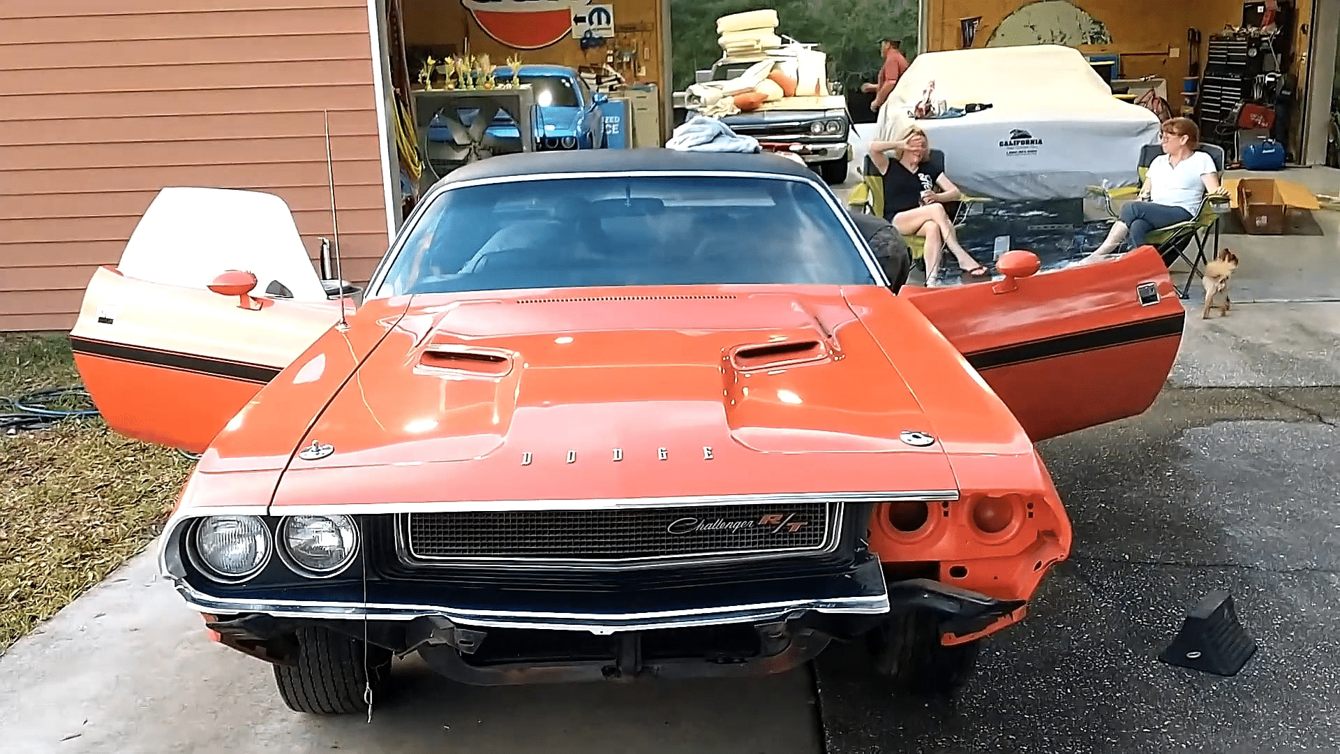

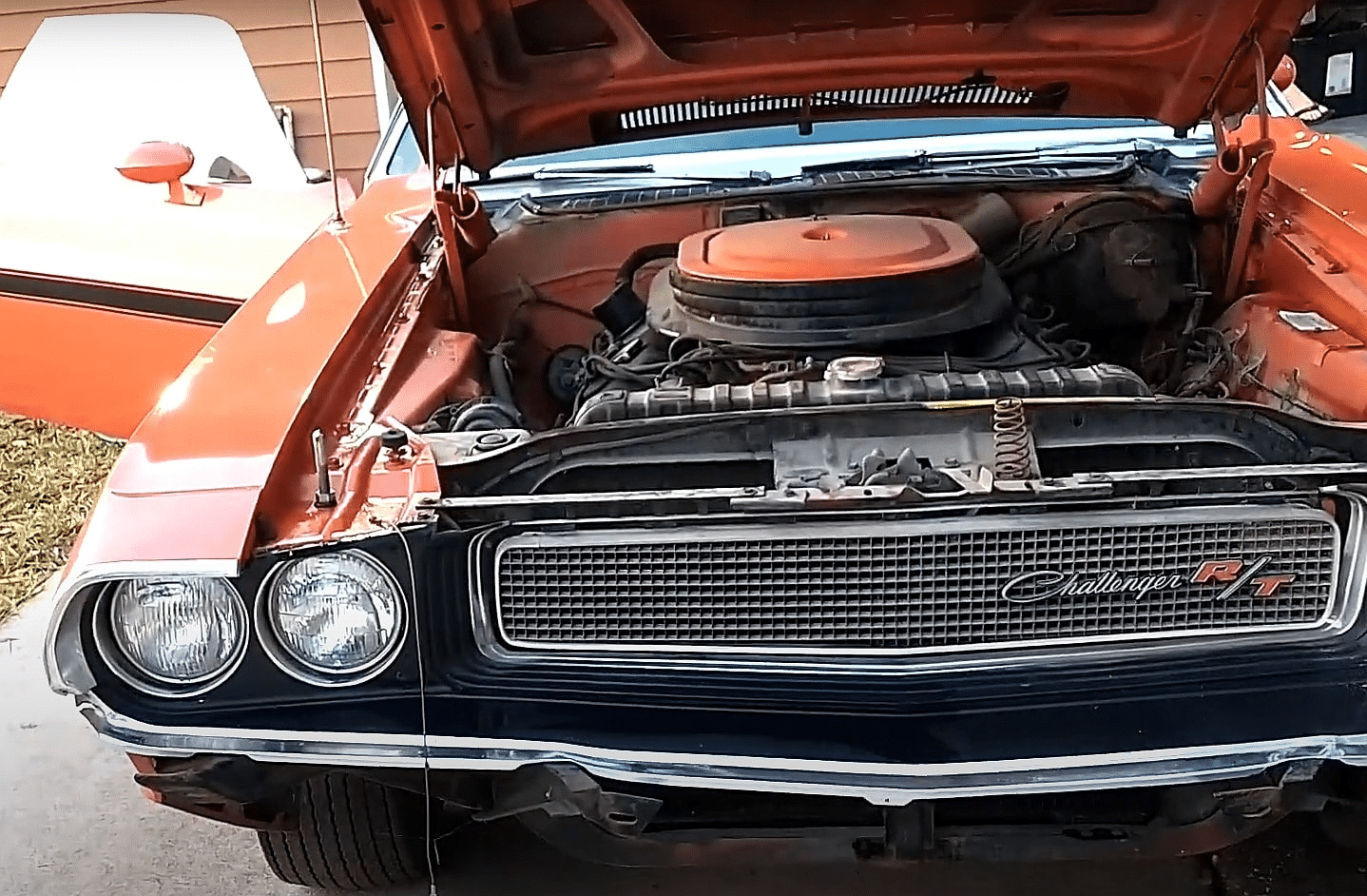

This pic is reportedly from an unrestored 1970 Hemi Challenger so I now know the mounting location of both the hood bumpers and hood pins.
I got a whole set up sans the connector from the radio to the cassette. Original mike with it. They had straight cords. A nice thing to have. I'm going different route though.
Saving it or selling it? I have seen asking price for the complete unit (less the radio) of $900. Go figure!

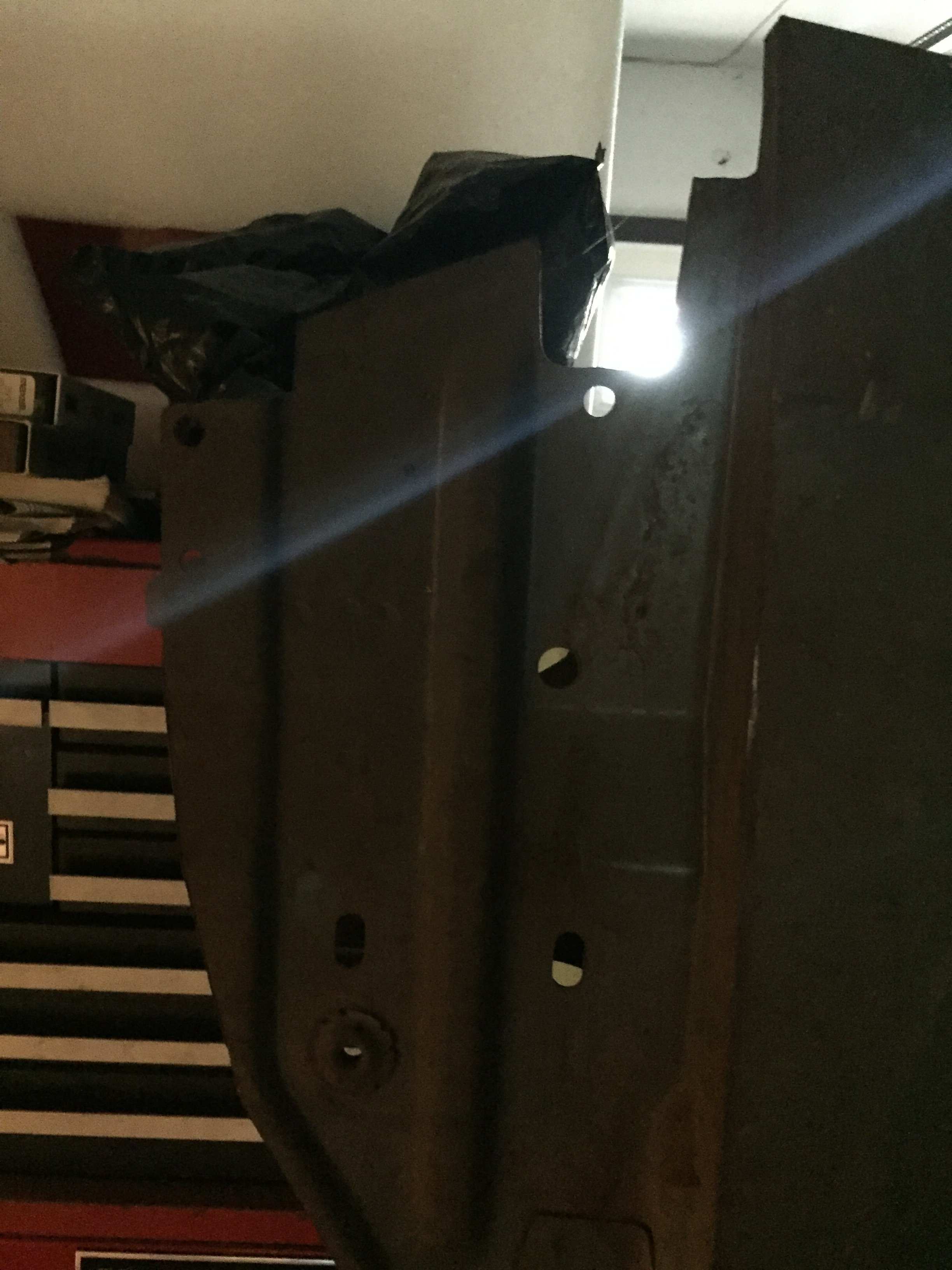

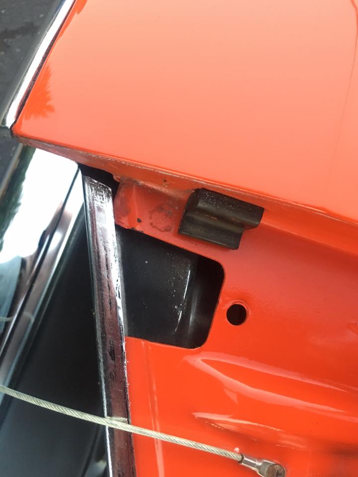

Also a 1970 and early 1971 fender does not have a rectangular notch in the fender where the hood pin cable screws on to the fender. It was a mid-year change in 1971. But a 1971 fender will look just like a 1970 fender if you didn't know.
Selling, radio, cassette player, cassette cover, mounting base and microphone. The radio is an AM one with the plug on the back.
Terry W.
Have a pic of this?

1970 no notch; late 1971 fenders and later factory replacement fenders for 1970 and 1971 were sold with the notch (pic of an NOS fender I purchased in 1980.
So if I am understanding this correctly, in the top photo, the hood pin cable should have been screwed into the notch area and not into the painted fender, for this variation of the fender.
Makes sense to me as that location will not mess up any paint.
