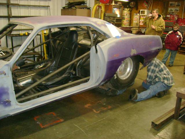

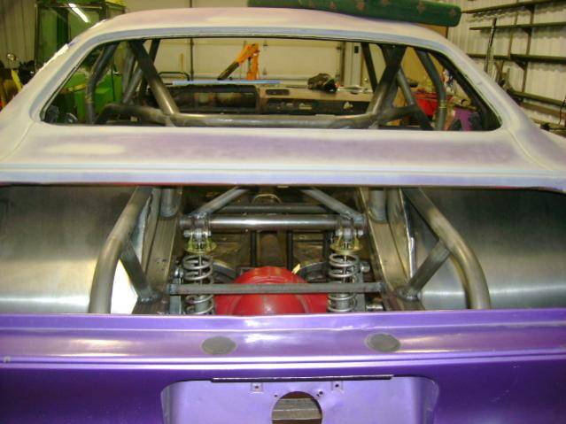

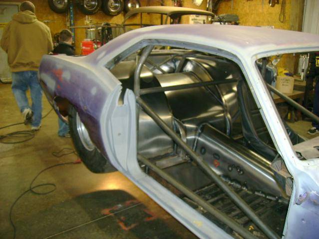

Here's a couple of pics of my friend Chris dragcar.72 Cuda with a CM chassis.Should easily cert. to 8.50.He has a 800 + motor for it built by Compu-Flow.Car chassis was done here in OH. by Chad Cox.Went to TX.Thought I would post a few pics.

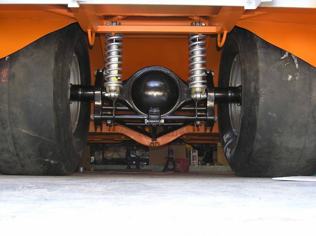

motor is a 499 ci with 325 Indy EZ cnc'ed heads.Has Comp .660 roller Indy dominator intake topped with 1150 Dominator.Tranny is a TranzAct built with pro brake and a Continental 4500 stall converter.Rearend is 8 3/4 with 4.88 gears liteweight spool.Has 4 link with wishbone and anti-roll control.TTI headers.Car will be painted orange.plans are for low 9's.Chris said he might try a 250 shot of nitrous to go into 8's.Wilwood brakes on all 4 corners.Won't be ready till maybe fall or for next season.A long way to go.He has another 70 Cuda I sold him about 3 yrs ago that he runs.

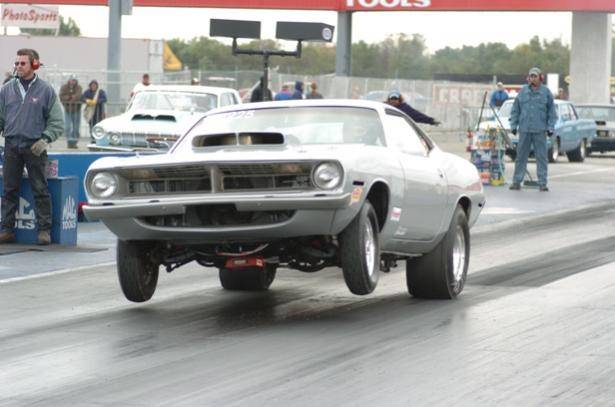

Yeah he's all excited about it.Here's a pic of the Cuda I sold him.It runs mid 10's 451 ci iron headed motor with small roller and an 850 Demon carb. has 4.56 in a 8 3/4.Leaves at 3000 with a trans brake.2nd pic is his son who race's a bike.It's in TX now.

First I would like to thank Mark for helping me in my absence get this car to what it is today. Second, I want to Thank Mr. Chad Cox, the Chassis Builder ( Ohio ). He does awesome work. Take a look at the car, it speaks for it self. A bad a$$ Custom roll cage back half. He completed the job in less than 5 weeks from tear down to reassemble with little to no help. My appreciation couldn’t be more gratifying, Thanks for an Awesome job Chad.
Now it’s my turn to complete the body, front suspension, brakes and drop in the drive train and get at gunning down that opposition. The body will look nothing like what you see now. Use your imagination when you look at the next pic. the paint will look something like this except the hood scoop will be raised 6/8 inch's. If you see me at a track near you, say hey, were all friendly people

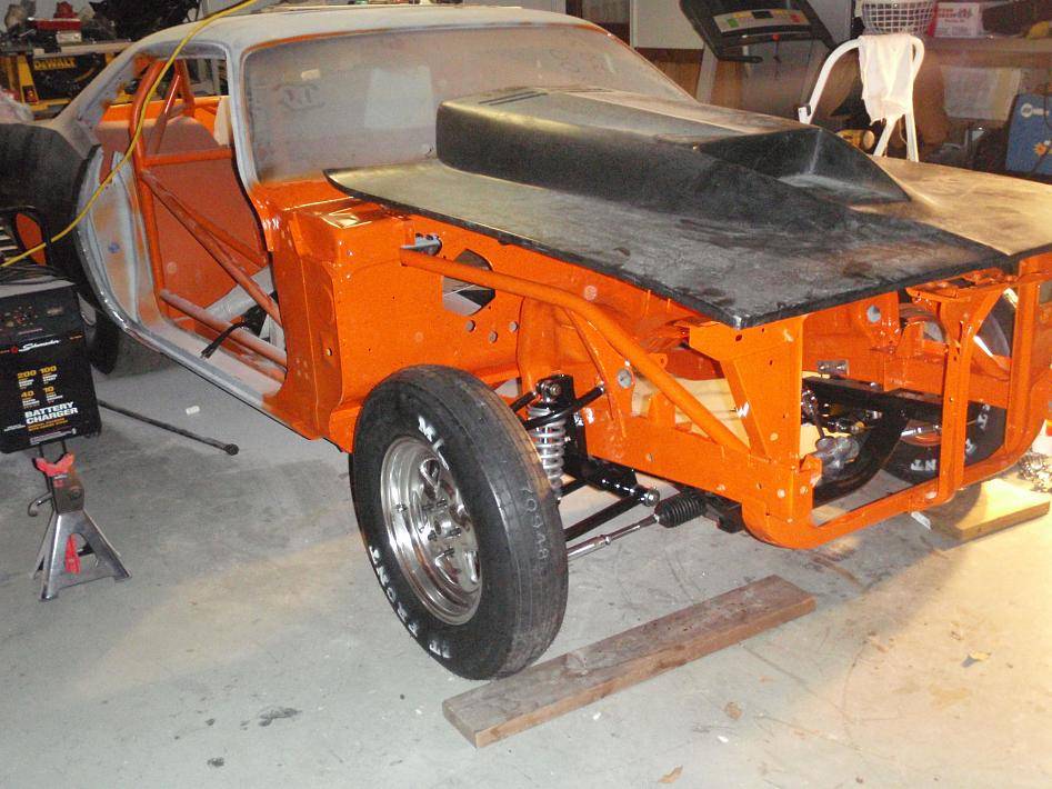

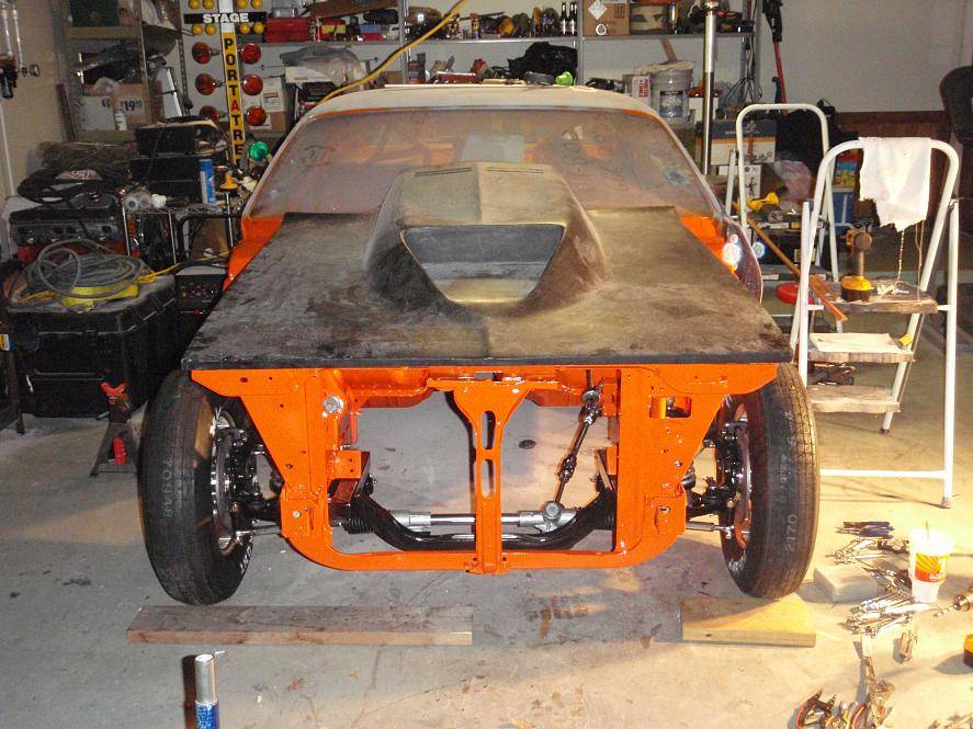

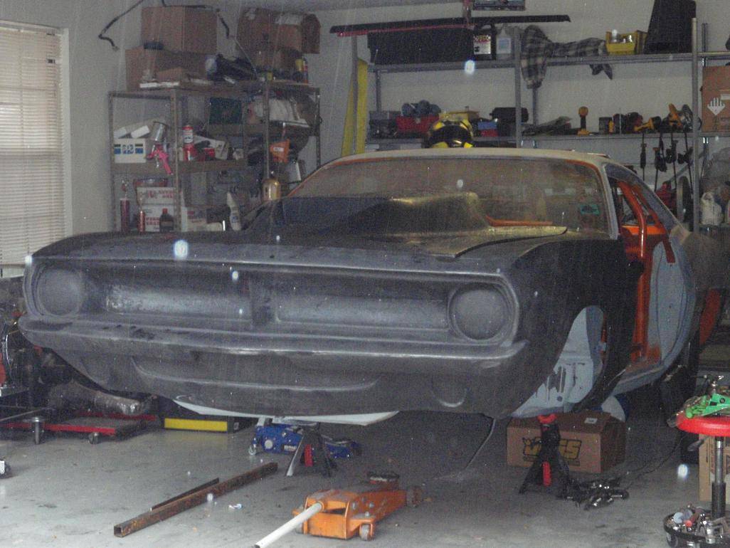

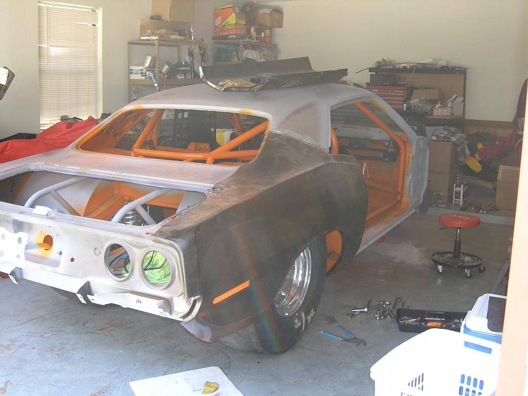

updated pics. plugging right along. should be finished by feb 2010

Nice Cuda. To cert at 8.50 I believe the doors are going to need to be X braced.
