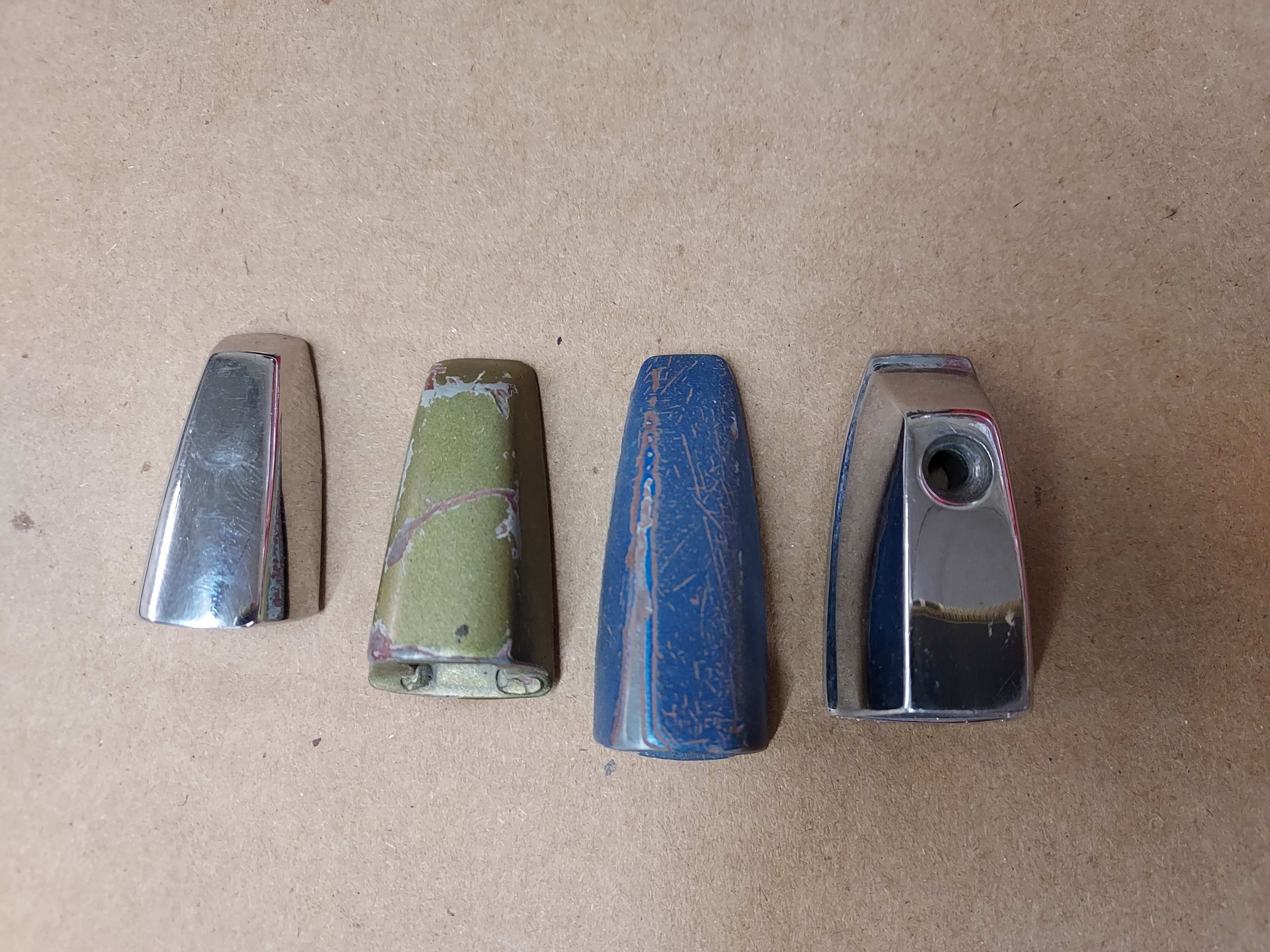

moparmarks
Dec 15, 2020
441
75
Western Colorado
72 Cuda uses the small chrome ones shown.
71 Cuda uses the blue painted ones shown.
70 Cuda used the green painted ones shown.
The big ugly ones with the screw through the top are 73-up all models.

Copied from moparmarks:
"72 Cuda uses the small chrome ones shown.
The big ugly ones with the screw through the top are 73-up all models."
Thanks for clearing that up, I edited my post. Great picture too.
